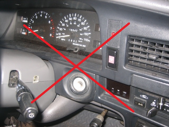

RAY....STOPPPPP, I fixed it!
One of my so-called "mods" was the culprit
Do you remember me doing this retarded thing? putting a 4runner column/key light in and hooking it up to the headlight wire on the ignition column?? I was going to remove my combo switch and came across it, I just had a intuition that this might be causing something stupid since it was a stupid mod. A matter of fact it was you who told me I shouldn't hook up anything to that wire and do it some place else, as well as the door buzzer thing. Of course I never followed up on your advice and here it was biting me back in the ass! So anyhow I just snipped all the wires and took the wiring out and resealed the original wire with liquid electrical tape, fixed!
Anyhow, lesson learned, no more stupid electrical mods without checking with you or someone else who is competent in electrical stuff first Amazing that tapping into the wrong place can cause something else down the line.
I hope you didn't waste too much of your time looking into this, apologies.
Glad, you got it figured out. Hope you're happy with the outcome.
LOL! Yeah, I remember. So that connection you put there was somehow jumping together the control inputs to both relays which are supposed to ground only one relay at a time: grounding pin 1 turns on low beam relay, grounding pin 2 turns on high beam relay.
No worries, all I had done was verify pin-outs of the H4 connector which I needed to do anyway.
Yeah - clean and robust is the only way to do mods for long-term
It's still good to have that lighted ignition key, though. However, biggest benefit from it is when you first get in the car and trying to find the switch in the dark. That would require a circuit that comes on when you first open the door, and before you even have the key in ignition. First thing that comes to mind is a timer circuit that:
1) Comes on when you open the door (controlled by door open detect switch)
2) Stays on for a few minutes to give you chance to find the keyhole.
3) Most logically would tap power from dome light circuit
Cheers, guys!

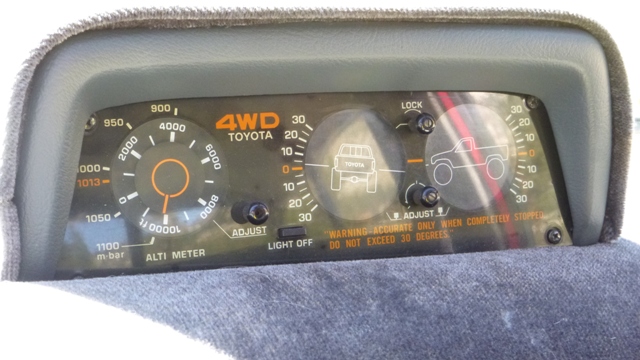

Was able to calibrate my altimeter on this trip...
