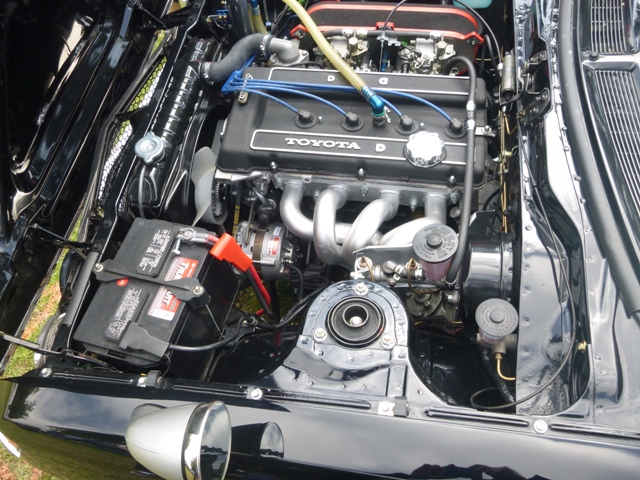

This was my favorite and had all kinds of attention throughout the day.

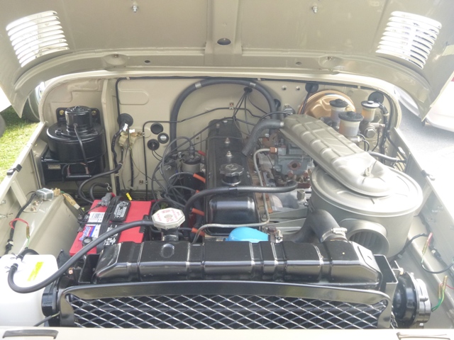

More Pics
Awesome Crew Cab Hilux, was just parked in the lot.

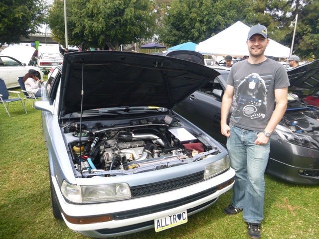

This guy is Charlie...real nice helpful guy who answered all my questions when I was restoring my camry. He took 2nd Place in the Camry/Cressida division with his 88' All-Trac w/3sGTE swap

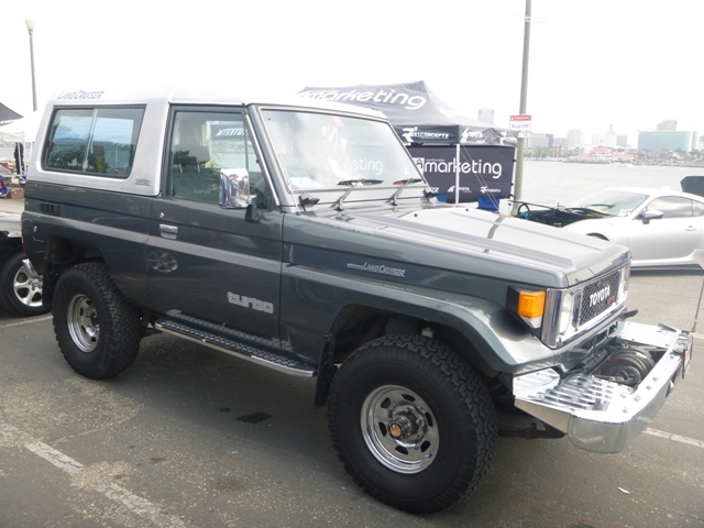

Badass landcruiser

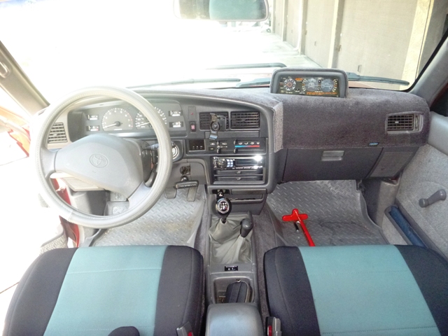

Finally replaced my old 21+ year old dash cover! Looks brand new underneath, highly recommend one of these things. Plus it keeps thing from rolling around on top. Look how much it faded, started looking blue after about 17 years or so.
New compared to old
Brand new underneath

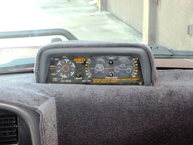

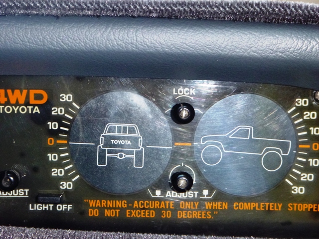

One of the reasons I changed it out also was because I wanted to finally install my 85' inclinometer I had found at the yard for $12.99! I also purchased an 85' dash cover for the specific reason of cutting the clinometer cover out so it would look custom fit on my dash.
I hated that vehicle image on the clinometer, everytime I saw one it reminded of an outline of those old corolla FX's So I grabbed the template off marlin crawler's forum, and then I customized it even more and added the "TOYOTA" to the tailgate just like my truck. No one's seem to have posted even the basic template on this before on this site, but maybe I didn't search hard enough.

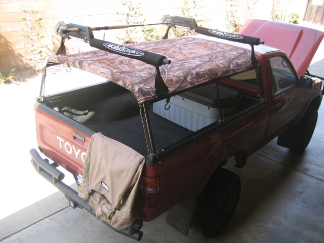

Finished my kayak and fishing rod rack setup. I'm using ski racks for my rod holders, works great!

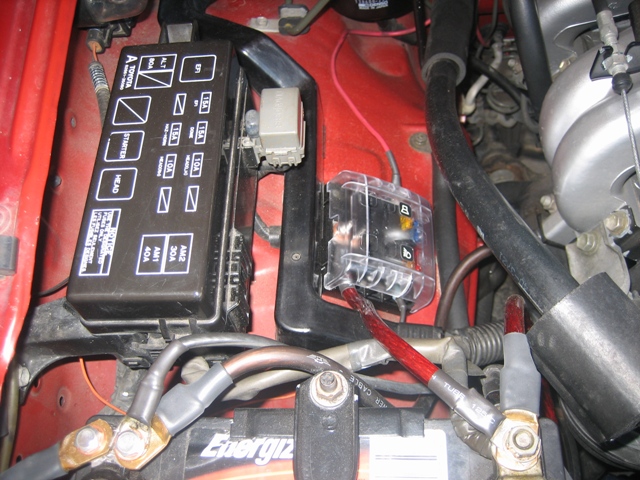

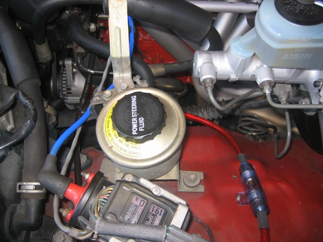

Installed a 120 amp alternator, a distribution box, and did the Big 3 upgrade...actually added more ground wires than that though. Used 4 gauge all around and left a few of the original connections in place also.

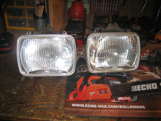

Do NOT buy those GE Nighthawks....I put them in just over a year ago and one went out already. Found other posts complaining of the same thing. Finally upgraded to Hella H4's...so much nicer and brighter.

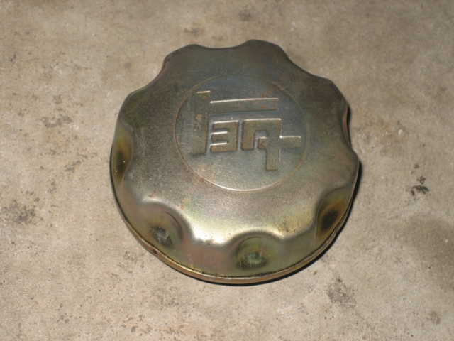

A cool find at the yard...a metal TEQ oil cap. From what little research I did they are pretty rare. Something about they use to use plastic triangle shaped with TEQ stamped on them, then for a year they went to round metal with the TEQ, then went back to round again but plastic. Going to polish it up before install, the 2000GT had one on it's engine but chromed!

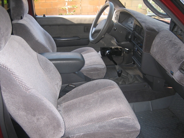

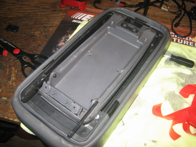

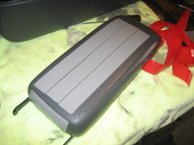

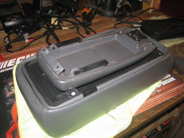

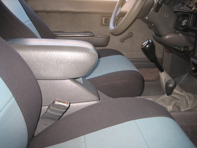

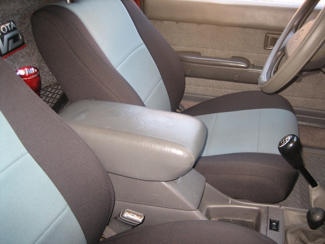

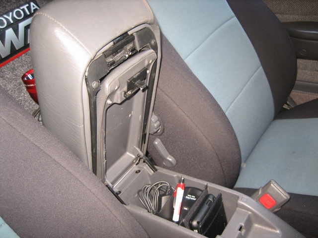

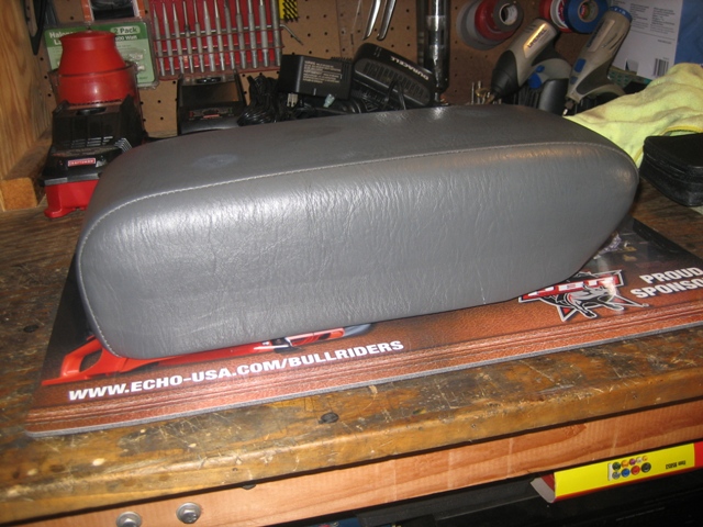

Here's a cheapo mod I put in the junkyard thread on the open forum. This has got to be one of my better interior junkyard mods....cheap ($7 + double sided tape cost), fast (45 Min), easy (screw driver, pliers, dremel tool), and a long term driving comfort benefit.
When my window is up with the AC running I like to rest the right side elbow/arm while driving and have noticed that our center consoles are too short to do that without putting a crook in my back.
98' Camry Wagon center console arm rest pad.
Just placing the original pad inside the new pad so you can always revert back if I wanted without any permanent damage. But after driving around a bit like this, this thing is staying in PERMANENTLY!!
Cut out the plastic so it fits inside and removed the locking tab.
Use some double sided 3M tape
Placed it inside
Looks a little unclean/funky from underneath, but nobody sees that anyhow. I might clean it up later.
Pure comfort!!! my arm is at shifter level now. This kinda helps my lower back out also because I can relieve some pressure while leaning on it, like sitting in an arm chair.

And my new seat covers came in. I liked the neoprene, but it just didn't "match" my interior I gotta have matching stuff, it irritates me
These were $140, caltrends, oem velour grey. Custom fit. I couldn't get the head rest on without removing the stock covers first, so just foam underneath the covers.

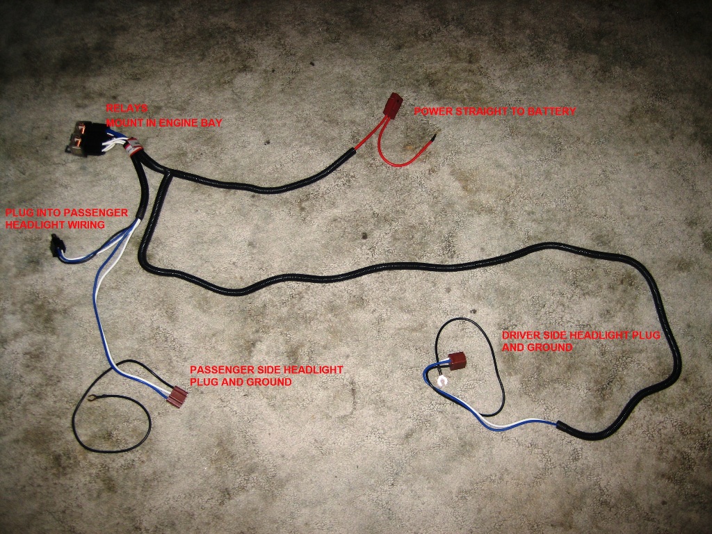

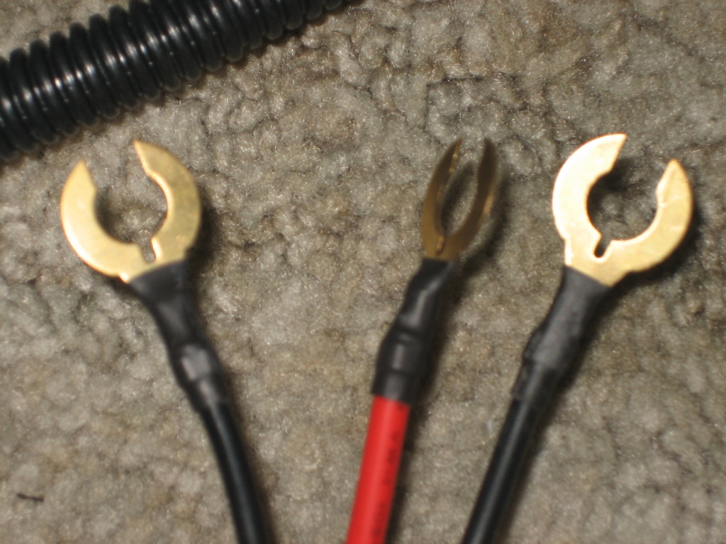

Saw a post on the open forum and after digesting it for a few days I figured out this is what Ray (RAD4Runner) was doing! I'm a little slow electrical wise! I figured out this would compliment my new Hella lights. So I checked with one of our local yotatech electrical engineer gurus (Ray - RAD4Runner) the other day to make sure this was what I needed, and then ordered it yesterday...and it came in today! Fast shipping, but granted the guy is located only about 45 minutes from me.
Here's the post, scroll toward the bottom where "RSR" posted his ebay harness find:
https://www.yotatech.com/forums/f131.../#post52106589
Here's the ebay post, Manufacturer Part Number: 7X6-CR-9003-1. The price is now $49.99??? I got it for $29.99 and $7.70 shipping,
http://www.ebay.com/itm/330813121438...84.m1497.l2649
It's seems pretty easy, everything plug and play, I labeled the photo to show where everything goes.
Some initial notes, the power wire is 12 AWG, the rest of the wires seem to be 14 or 16 AWG, the in-line 30amp power fuse holder is cheap (but I'm snipping that off and connecting to my fuse distribution box), the end connectors for power and ground are kind of thin but at least protected by heat shrink wrap (I'll probably snip them off and put better ones on and also solder the connections before putting heat shrink wrap on again.
Hopefully get a chance tomorrow to hook it up.
