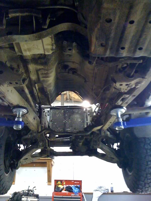

Finally started on the swap. Got the 22RE and A/T yanked out and the 1UZ in for a test fit.
Once it was in, I decided to replace the rear main crank seal and install the flywheel. Turns out I didn't notice that the damn ring gear was missing.
At trip to my friend Steve's house fixed this. We ground off all the welds from the ring gear to the flex plate and removed the original ring gear.
The flywheel has a machined surface to accept the ring gear, so currently, the ring gear is in the oven, and the flywheel is in the freezer. Wish me luck.
The engine sits too low with these mounts, so I think I'll order up some engine lift mounts from 4Crawler and get it another inch and a half higher.
Currently, the Tundra manifold are hitting on the steering column and the fuel line. Plus, the O2's hit the torsion bar mounts at the upper control arm. The center steering link hits the oil pan too.
I also found out just how eff'd my radiator support is, since I have an inch or so less room between the engine and the radiator support on the right, than I do on the left.
One hurdle at a time... Still should have it running in a month. Hopefully...
