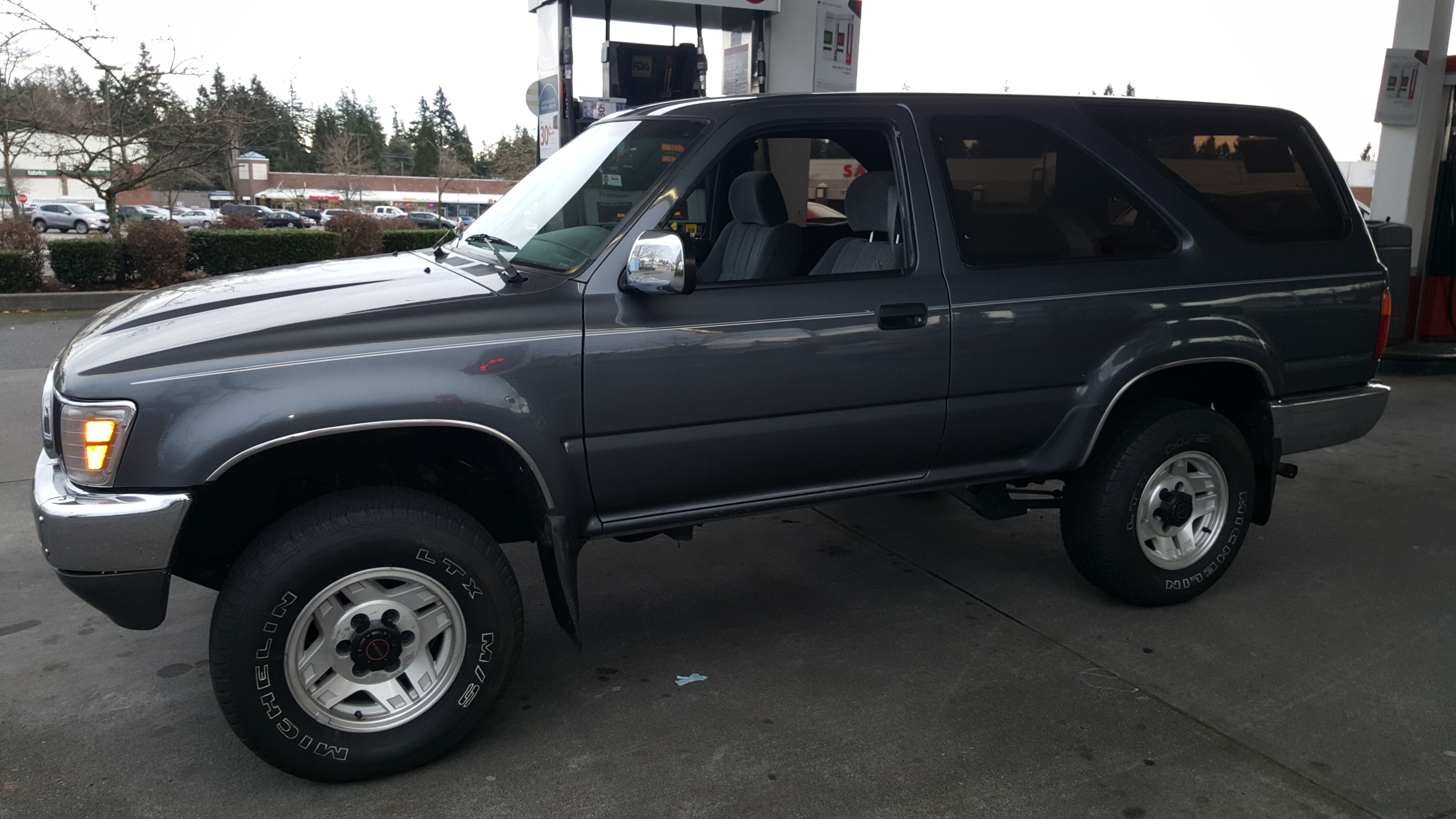

I'm back! This time with an even cleaner two door.
I'm going to do another UZ swap on this one too. Wahoo!!

I'm pretty sure this one is a keeper. No bondo, no accidents, local history back to the original purchase.
Money is tight right now, hence it may be a slow project. However I have no problem skipping meals to get truck parts. Haha!
A 2016 UZ Run sounds awesome!!

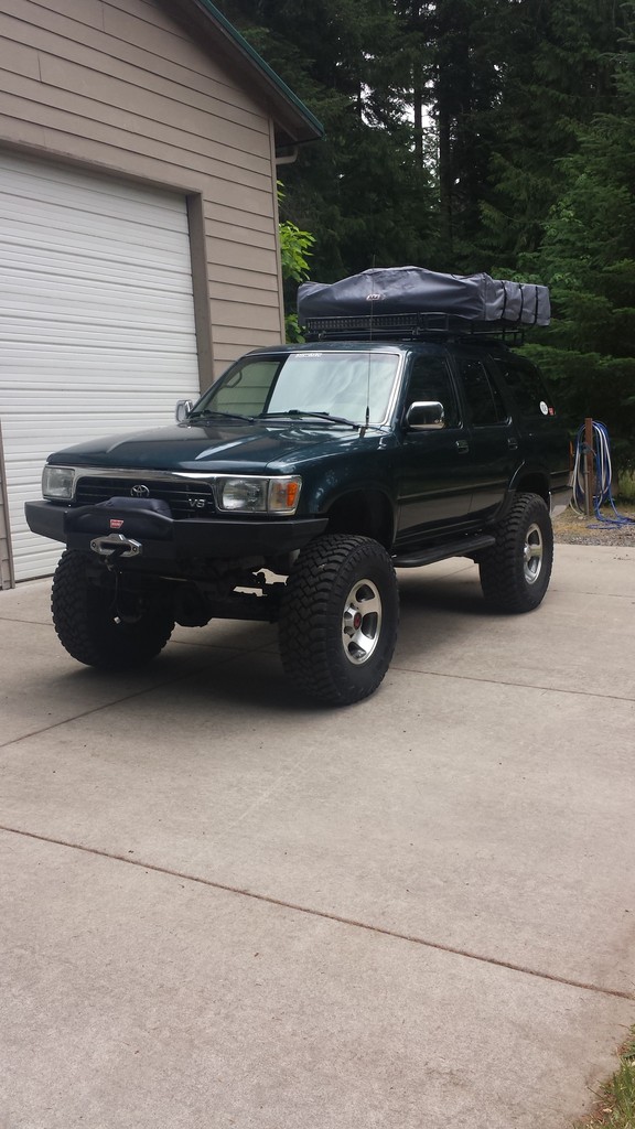

I did update my thread, so your welcome to stop by and say hi if you like. Things in the family did drastically change and were extremely hard, but I pulled thru and I parked the rig for a while so that I could keep it to completion. It runs like a dream. I have set it up for expedition travel so it has a small SAS on it, ARB roof top tent and awning, ARB fridge, hp elocker up front and Tacoma elocker rear. Over all I love this thing.
I did end up starting a company selling all the parts for the 1UZ swap after I did it and I figured out how to make it easier for others to do too.

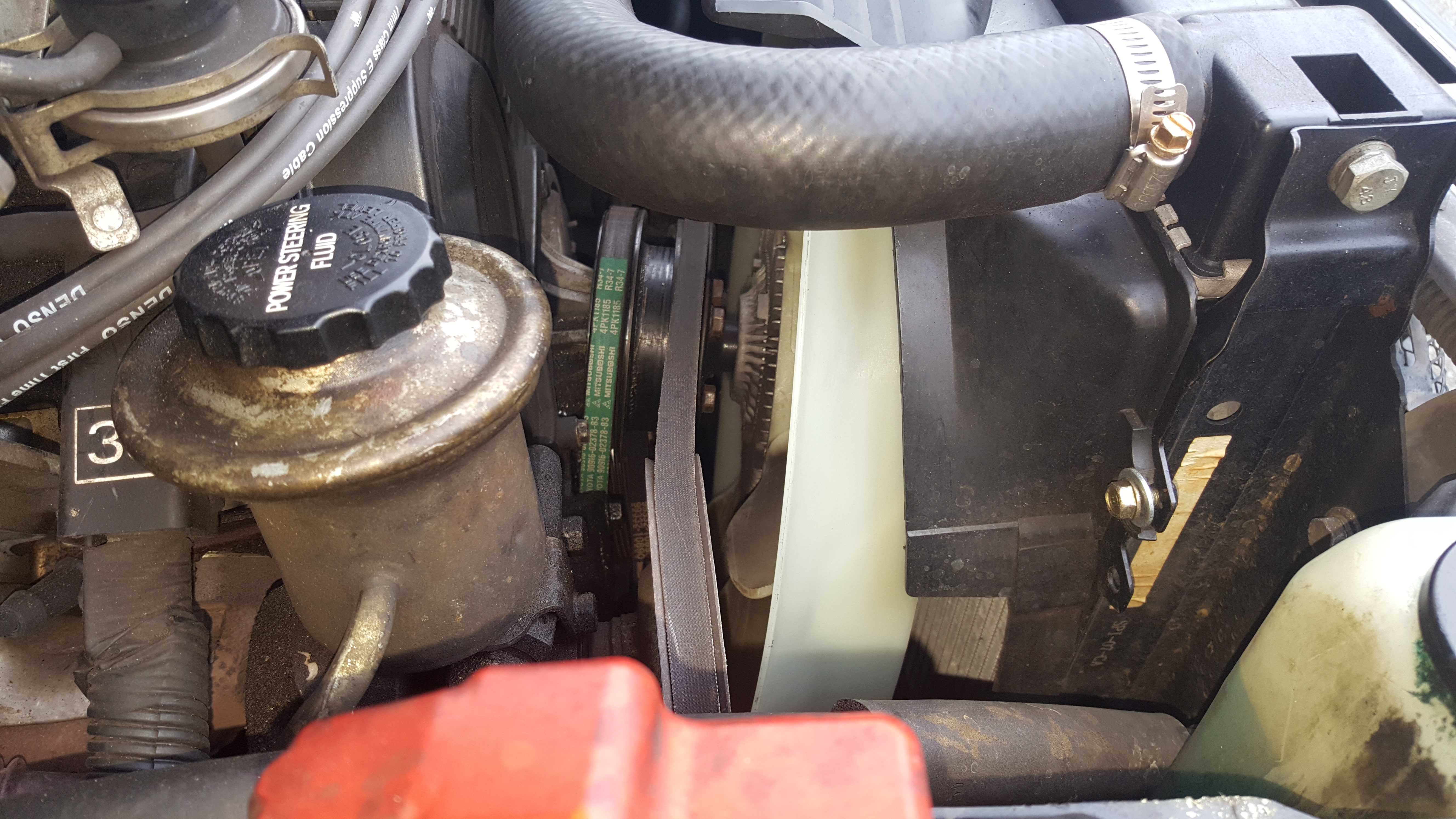

Well, 300 miles into owning my first 3VZ-E and the fan bracket bearing craps the bed while I was on the freeway
Got it replaced the next day after a tow home.
I found out at that time that both cams were retarded one tooth, and that caused the ignition timing to be at 2°.
Reset everything properly and advanced the ignition timing to 14°. Wow, what a difference.
I also removed one throttle return spring and lubed the throttle cable. These things are like pushing a block of wood.

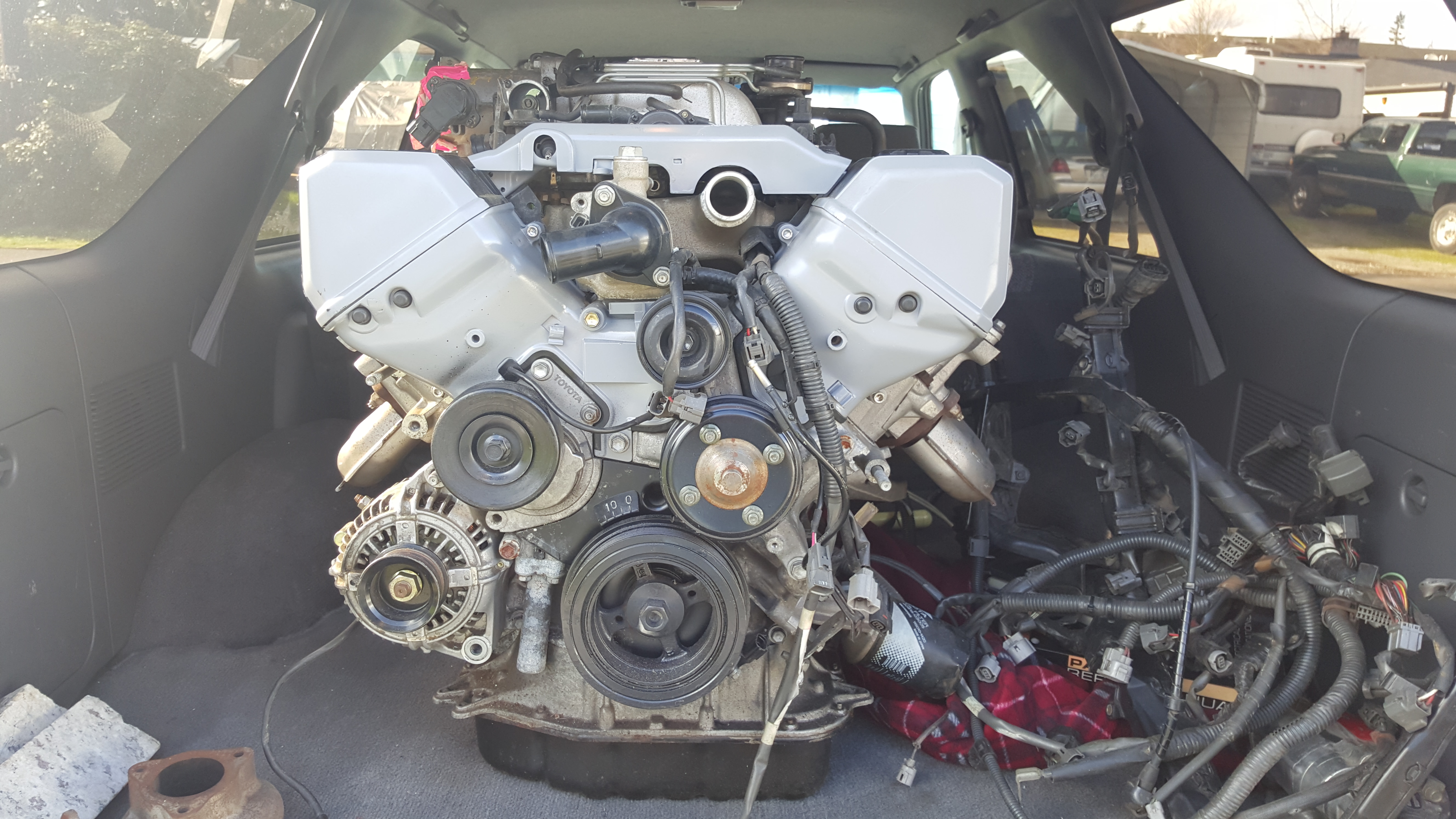

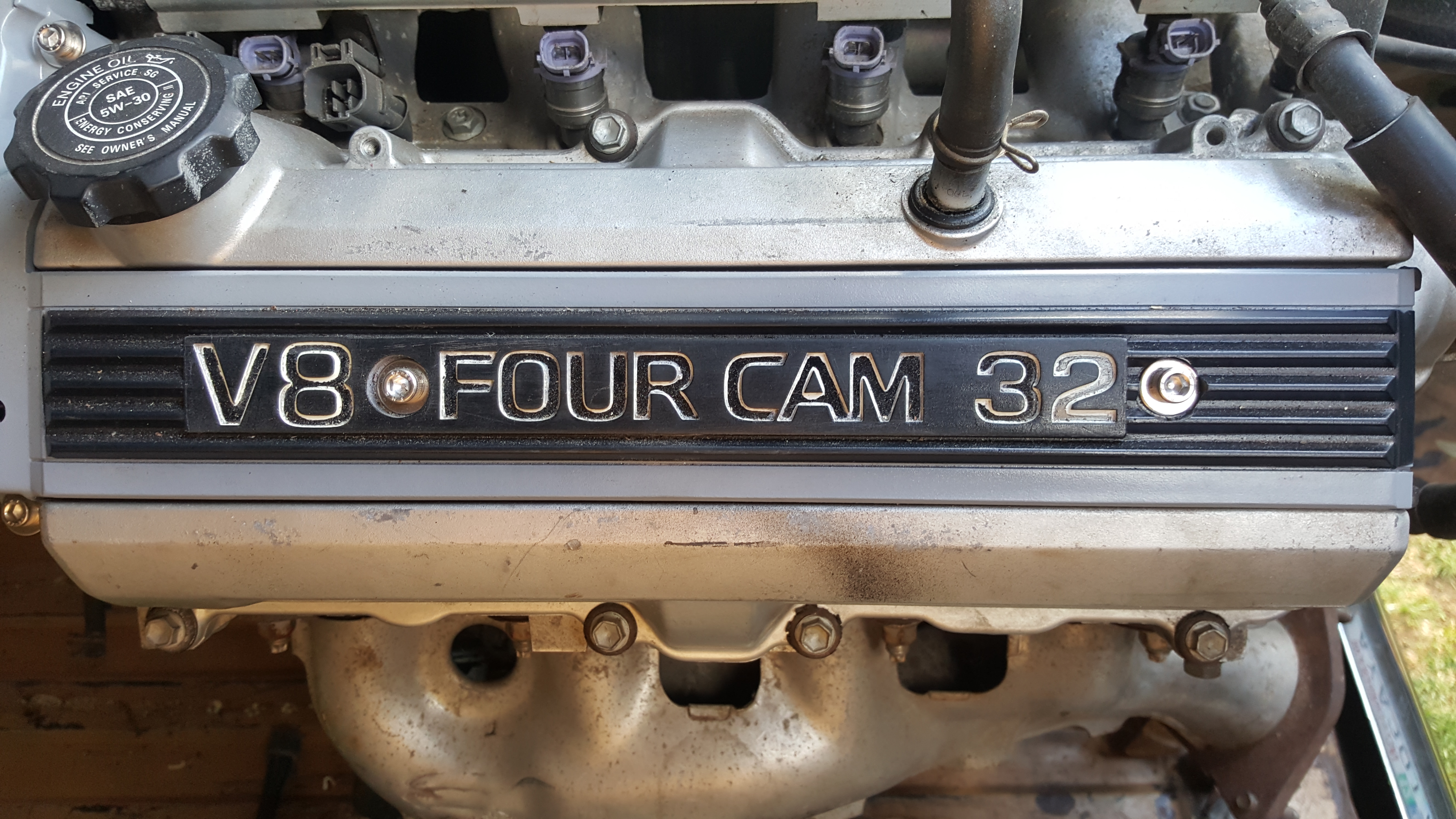

Anyway, it's a 1990 LS400 engine with only 17k miles. Yeah, seventeen thousand.
I still need to source an ECU, P/S pump, non-TRAC throttle body, some other odds and ends, and of course all of the other parts from you.
The guy I bought it from was going to put it in his SC, then changed his mind. It's too bad he painted the distributor covers...
