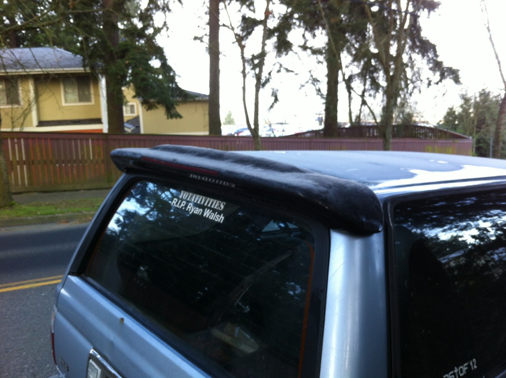

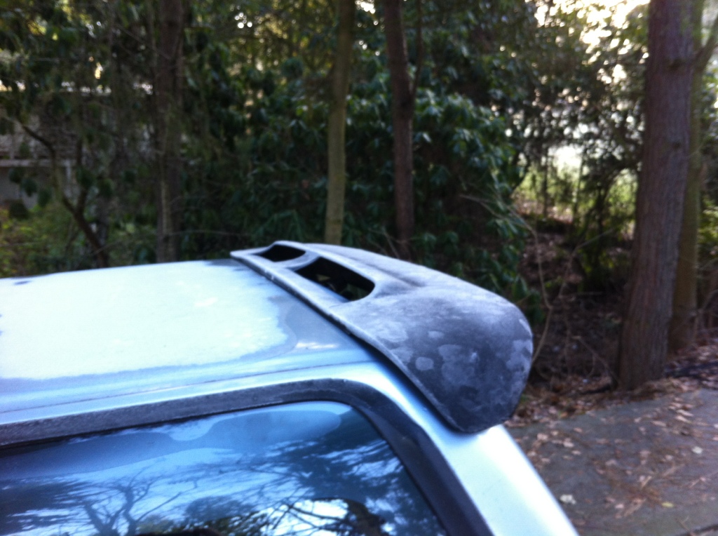

Ebay UK Shipped to me!
I found and installed a 1995 KZN130 Hilux Surf ear spoiler, and also installed Depo red/clear tail lights and clear bumper & corner lenses.
The paint looks weird cause its frozen. Damn cold here the last few weeks.
