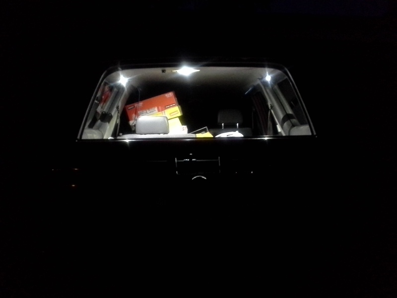

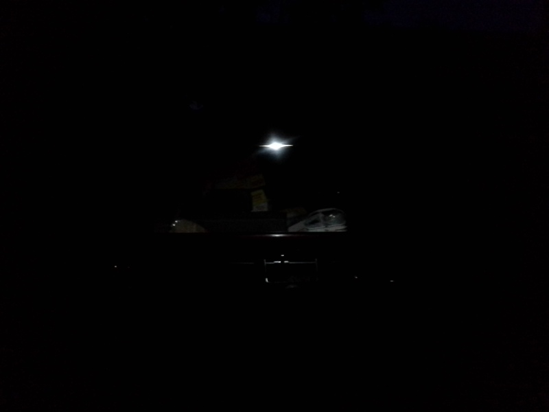

no rollbar. i do have some 3 watt LED's in the cargo area that are set up to come on with the stock cargo lamp or switched separately:
Originally Posted by dropzone
Added some additional LED's in the cargo area. A single LED in the stock cargo lamp was pretty lame
Attachment 114906
Attachment 114907
Much better
