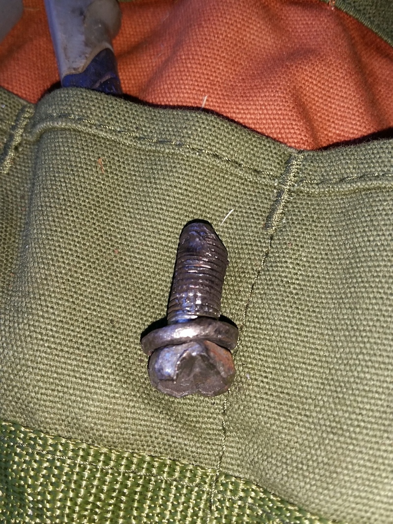

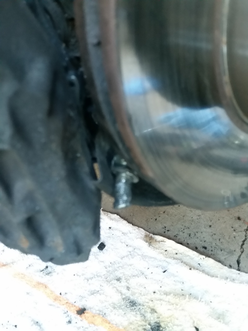

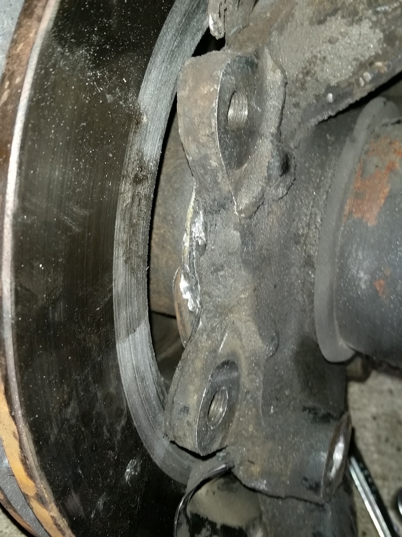

Pretty confident I found the root cause for the right front wheel seizing
When pulling the axle out I found this little gem
A family member had recently did the brakes and must have dropped a bolt. ..

Well, that bolt definately means time to SAS it
Old Sep 21, 2015 | 03:36 PM
  #31
BlazeN8's Avatar
Posts: 977
From: Southern California
That makes no sense muddpigg! Throwing the baby out with the bath water. A dropped bolt could cause the same problem with a SAS rig!
Old Sep 21, 2015 | 05:13 PM
  #32
dropzone's Avatar
Fossilized
iTrader: (6)
Joined: Oct 2005
Posts: 19,771
Likes: 456
From: PNW
It was the root cause for me getting it for $400.
Going SAS is because I have the stuff, by the time I buy brackets, the auto to dual case Inchworm adapter from LROR and other misc stuff I will probaby be into the truck for less than $2000
Nate- totally correct, it could happen to any brake.

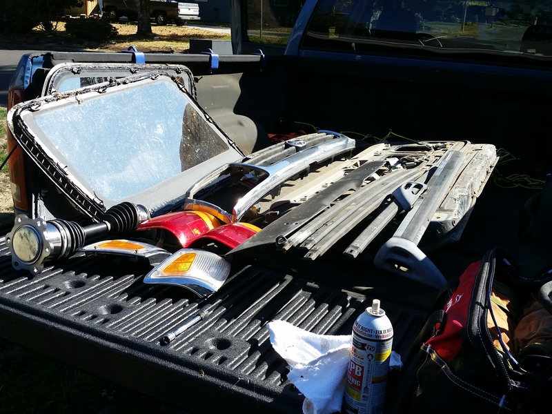

On to today's acquisitions
Two stops and $65 netted me
-complete tailgate
-roof rack parts
-L/R corner lights
-L/R tail lights
-L/R rear windows
-rear spoiler for an experiment
-grill
-CV axle so I can drive it this winter till I start the SAS
And my $5 pick N pull score from the labor day half off sale got installed today, spent $10 for the roll of 3m tape.
Also ordered LED'S for the interior and exterior lighting today.

I had one of them bolts to come out on me not long ago and then when doing the front bearings on my 88 seen someone had installed a non factory metric bolt in its place. Talking to another member, he had one to back out on him. Starting to wonder if it is more of a common problem that doesn't get mentioned much. I think I will start adding blue locktite to mine from now on.
Old Sep 22, 2015 | 03:34 PM
  #34
dropzone's Avatar
Fossilized
iTrader: (6)
Joined: Oct 2005
Posts: 19,771
Likes: 456
From: PNW
I think this was a case of someone not quite knowing much. A family member did the brakes about two weeks before this happened
