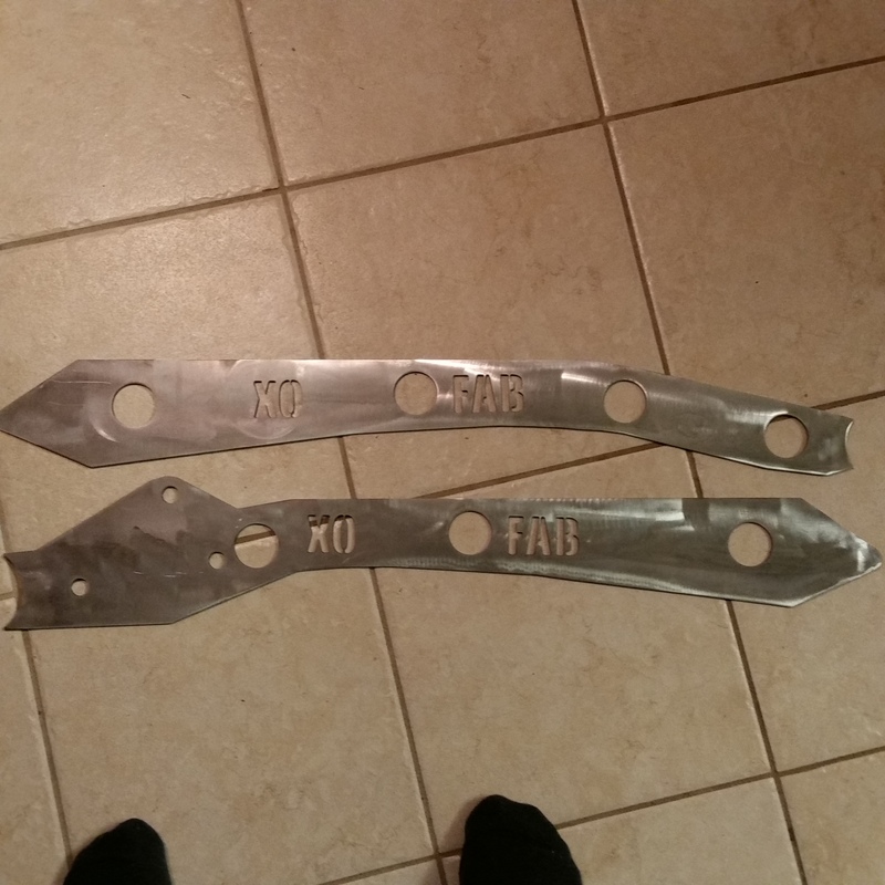

started ordering parts yesterday.
Ordered this from Extreme Options Fab Thursday morning, had it Friday afternoon. I will be ordering stuff from them again
the integrated steering box mount is a nice touch
rest of the stuff should be here soon from LROR
