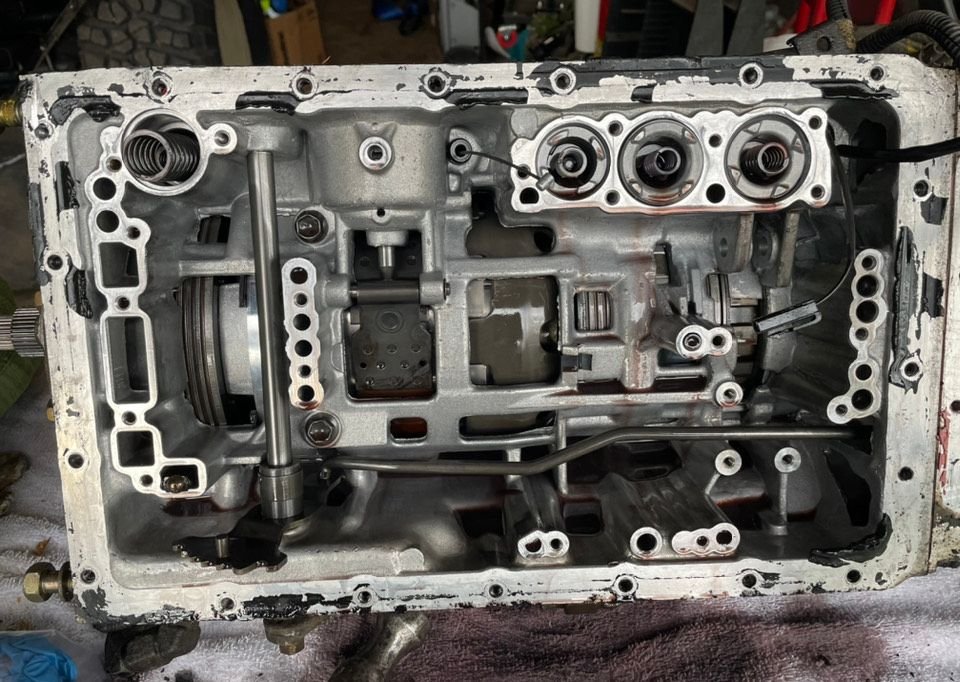

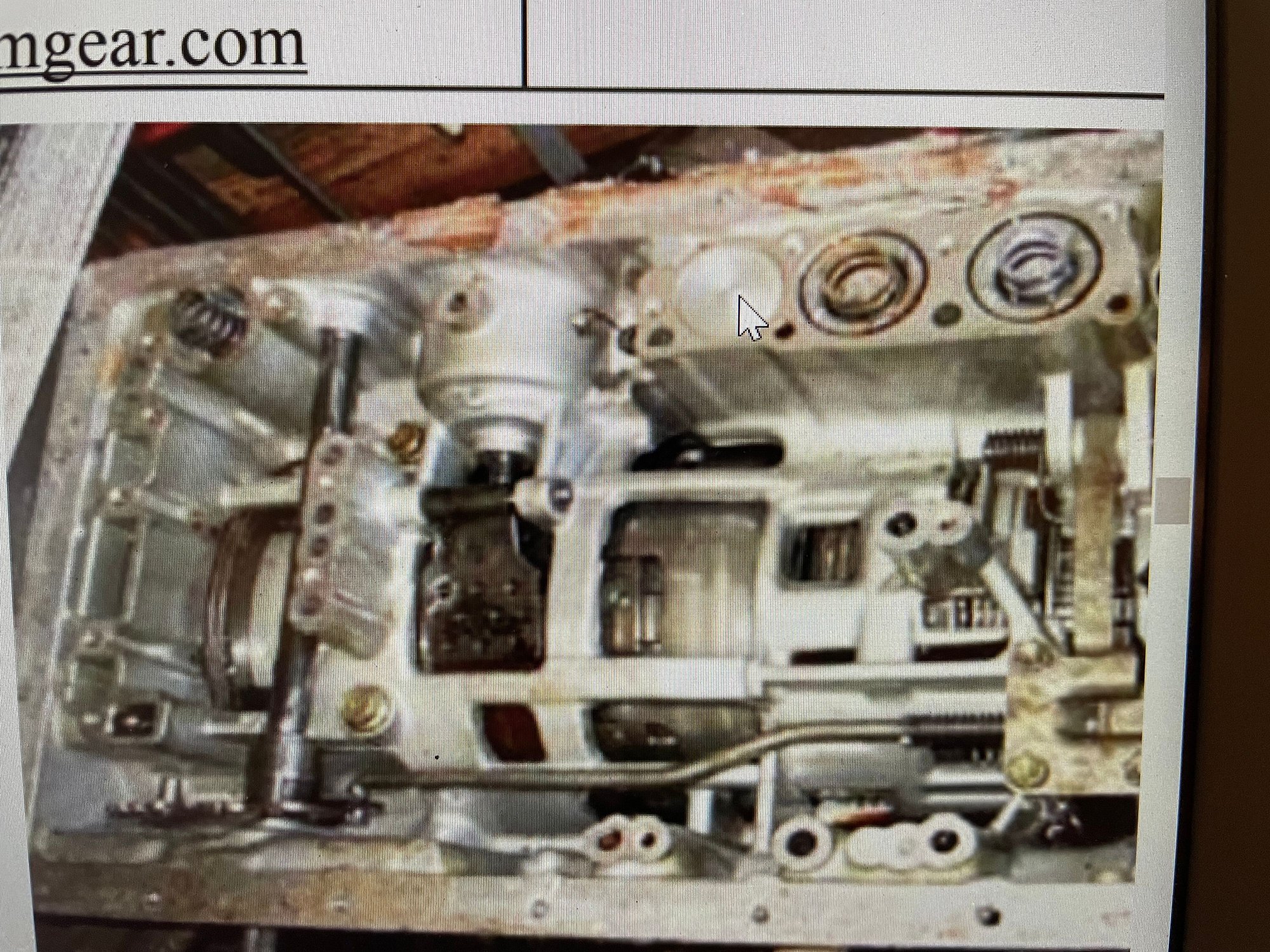

OK so i may have found something - dunno until tear it apart, again but something didn't look right when i was going back over the Inchworm Gear instructions on Low Range Off Road's website
I noticed the forward of the 3 pistons was inverted compared to the other two
when i pulled the valve body from my transmission all 3 pistons were inserted with springs down
all three pistons had springs down on my donor transmission were this same way so i figured it was accurate.

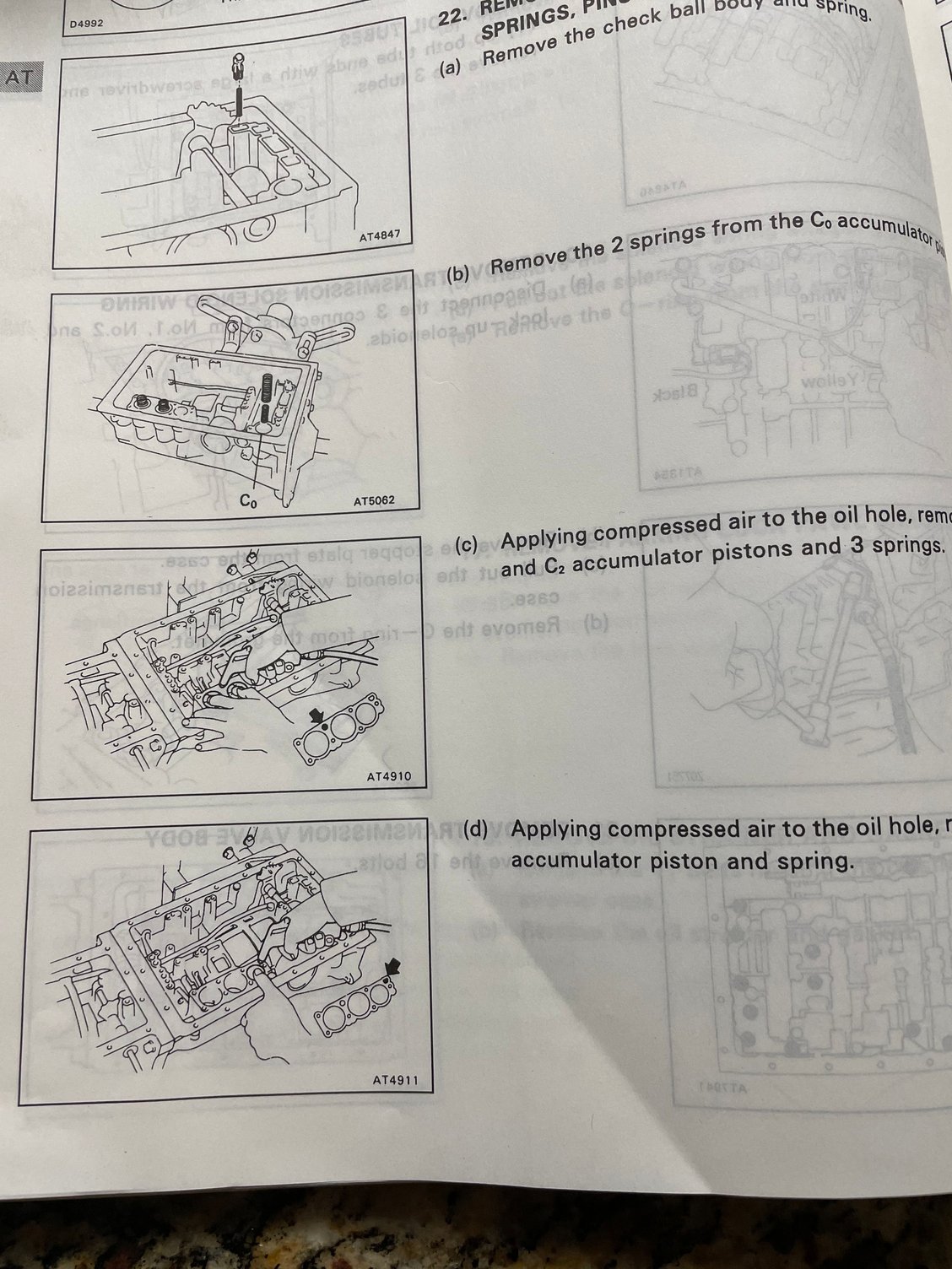

i forgot i had the Factory transmission manual. on page AT-24 is shows what would be the Bo piston being inserted with the springs up
so i go back to work tomorrow, i will pull this thing apart on sunday and see what happens.
I honestly have no clue why both transmissions would have the Bo piston inserted the wrong way
anyway the saga continues
