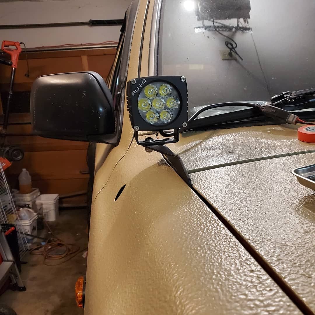

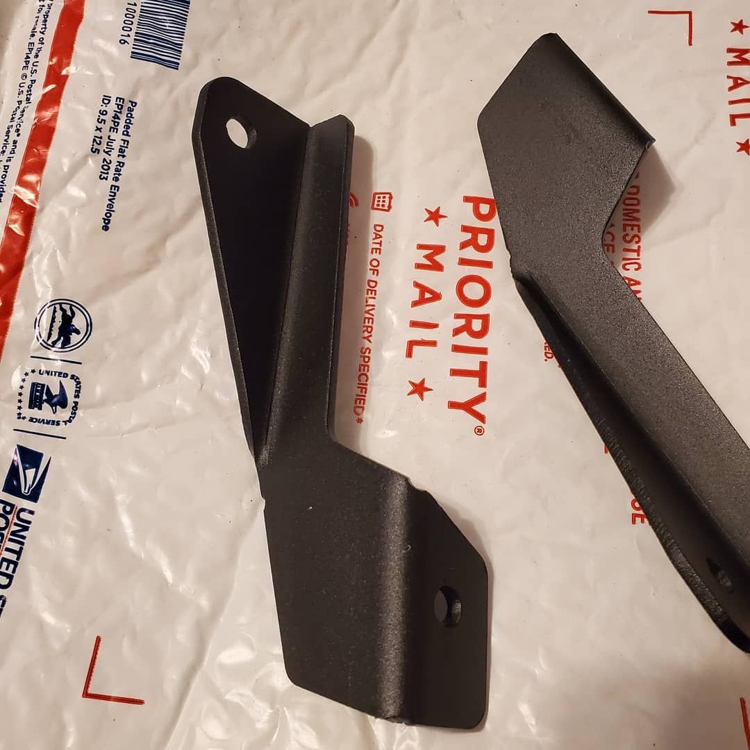

Finally had an afternoon off and decided to make some junk.
I have been going back and forth about using a set of ditch lights. No one made a kit for 2nd gens that I was aware. Plus I try to make crap for this POS when I can.
Finally caved and decided to see what I could come up with. Didn't really want to swiss cheese the A pillar or pop the windshield vent to run wires etc.
I had some left over aluminum from the 8020 roof rack project. Looked at a spare mirror and saw the 3 screw holes.
Took a few minutes to see what I could come up with.
Not too bad for V1.0. I could use a couple of longer bolts for each side. But overall i am happy with how it came out. And I am into the mounts for about $5
Lights are some Run-D 35w LED's off Amazon

At my buddy Phil's suggestion I tried to level the 2nd gen 4runner mirror mounted ditch light bracket out a bit.
I tried bending the bracket in the vice but the 2.5" x .25" thick bracket just didn't want to adjust using the vice and tools I had on hand.
1st version on top
2nd version on the bottom
So the next option was to use some nylon inserts I had in the fastener bin
Drilled them out to work with M5 bolts and sanded them down to a close height.
Not perfect but way better than bolting straight to the mirror

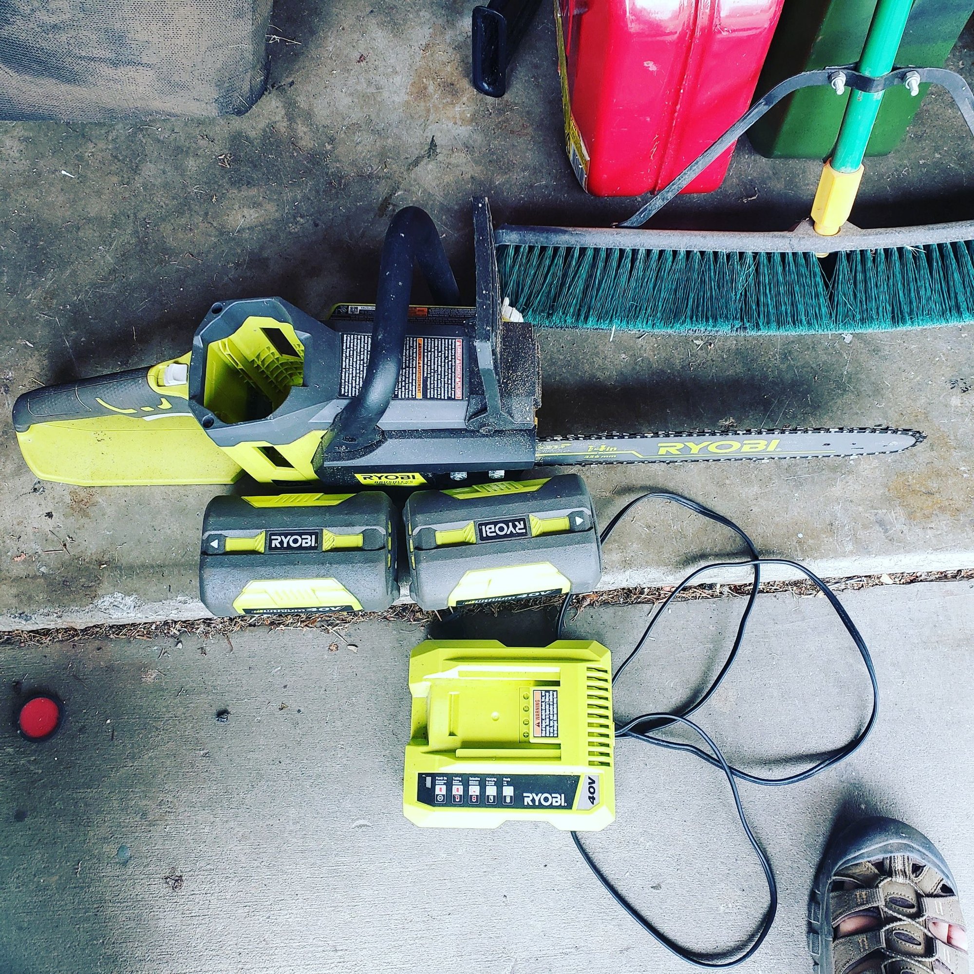

I did wander down to my neighbor's garage sale to look at a tiller that I would need.
ended up walking home with a gently used cordless 40v Ryobi cordless chainsaw with a couple of batteries. I had priced one at home depot, couldn't really justify the $200 for one. I picked this one up for $35
Plans are to make this my trail chainsaw. in the PNW you get downed trees blocking trails sometimes. I have a 18" gas saw but it is sort of a PITA. If I end up having to cut more stuff out of the way that the batteries won't last for it is probably time to turn around.

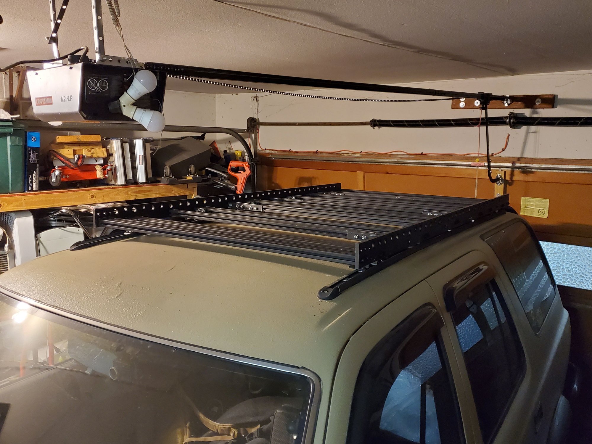

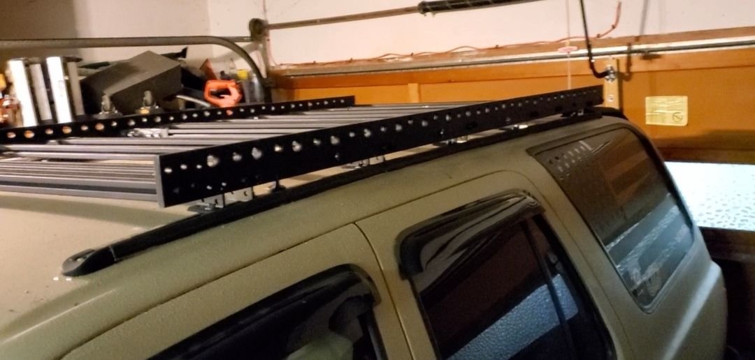

Did a little revamp on the roof rack. Using 8020 makes an old fart feel like kid with an erector set again.
Version 1.0 was only about 34" wide and was very low to the roof. That was fine but difficult to get bungee cords/rope around a crossbar. It was also a bit narrow.
Version 2.0 is 38" wide, 72" longand sits about about 1" above the roof line. May not seem like much but will be better in the long run.
Version 1.0 34" wide
Version 2.0 38" wide

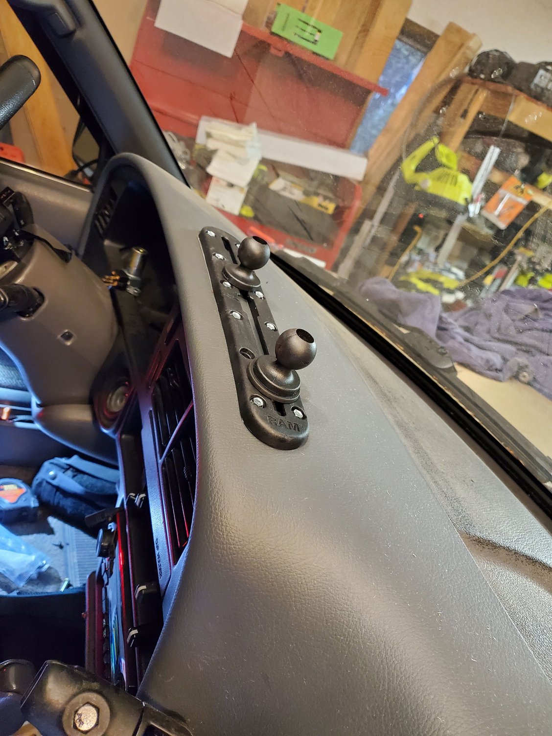

Decided to try the @rammounts tough track mounts. These are cool as you can slide the mount around and have as many mounts on the track as you can stuff in there.
I installed a set of 8" LED's but they were blocking my Truck-Lite led signals so swapped them with some 5" 80w lights.

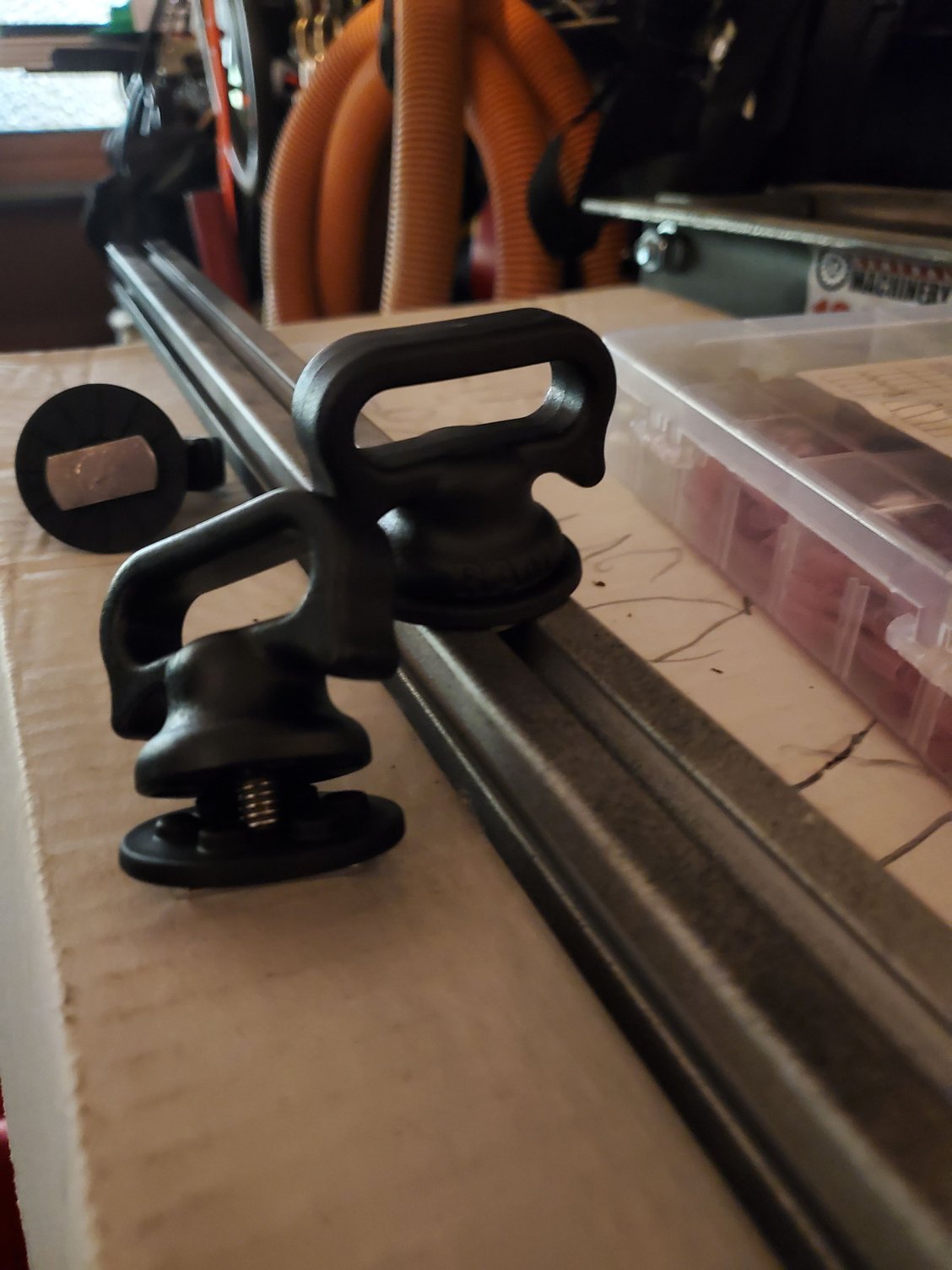

So I have gadgetitis pretty bad. I order junk try stuff and change my mind quite a bit as you can probably see from the various redoing of junk on this truck.
One thing I was looking for as far as a tie down solution on the roof rack was something that would be quick and easy and work with the slots of the 8020 strut crossbars on the roof rack.
Ordered a couple of sets of these Ram Mounts that are designed for their tough track system. I think they are more geared towards use in a kayak but figured I would give them a shot.
I don't think you can put a huge amount of pressure on them but they slid right into a piece of 8020 and they will easily slide to where you want them to go so for a light load using a bungee cord they should do the trick.

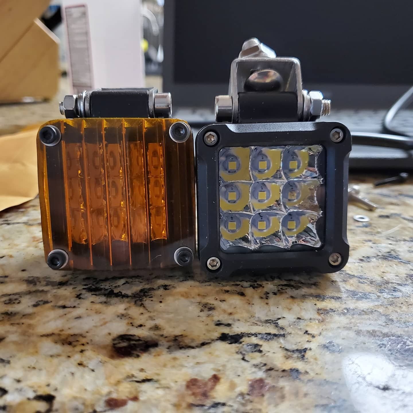

Was looking at something to use as some daytime running lights.
Baja Designs S1's would be awesome since they are very small but at almost $200 a pair hard to justify. Found a set of little 2x2 24w pods on Amazon that have some great reviews.
Cut down a set of extra amber covers. Pattern came out pretty good. Not bad for a 30 minute and $30 experiment
Will probably stuff them under the winch plate
