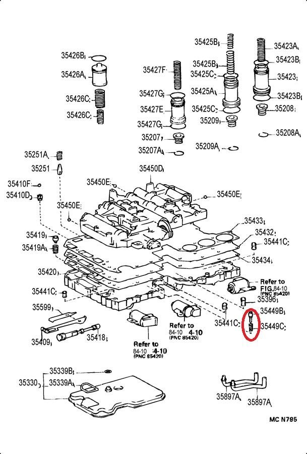

Finally got up the nerve to start replacing the valve body gaskets plus it took a few days to get gaskets. Dealer said both gaskets were there..cool..well got two of the same..
so road block #1
Road block #2 is a small plunger fell out when I lifted the upper portion of the valve body apart.
Gotta figure out where that goes, looked at assorted stuff on the web I know its # 35449B/C and goes above a solenoid.
Fortunately that is the only thing that popped out. Check Balls and strainers all stayed where there should be.
If anyone has advice I sure would appreciate it #a340 #canofworms
I found a source to download the transmission rebuild manual from but looking at that it doesn't show the part other than the exploded diagram

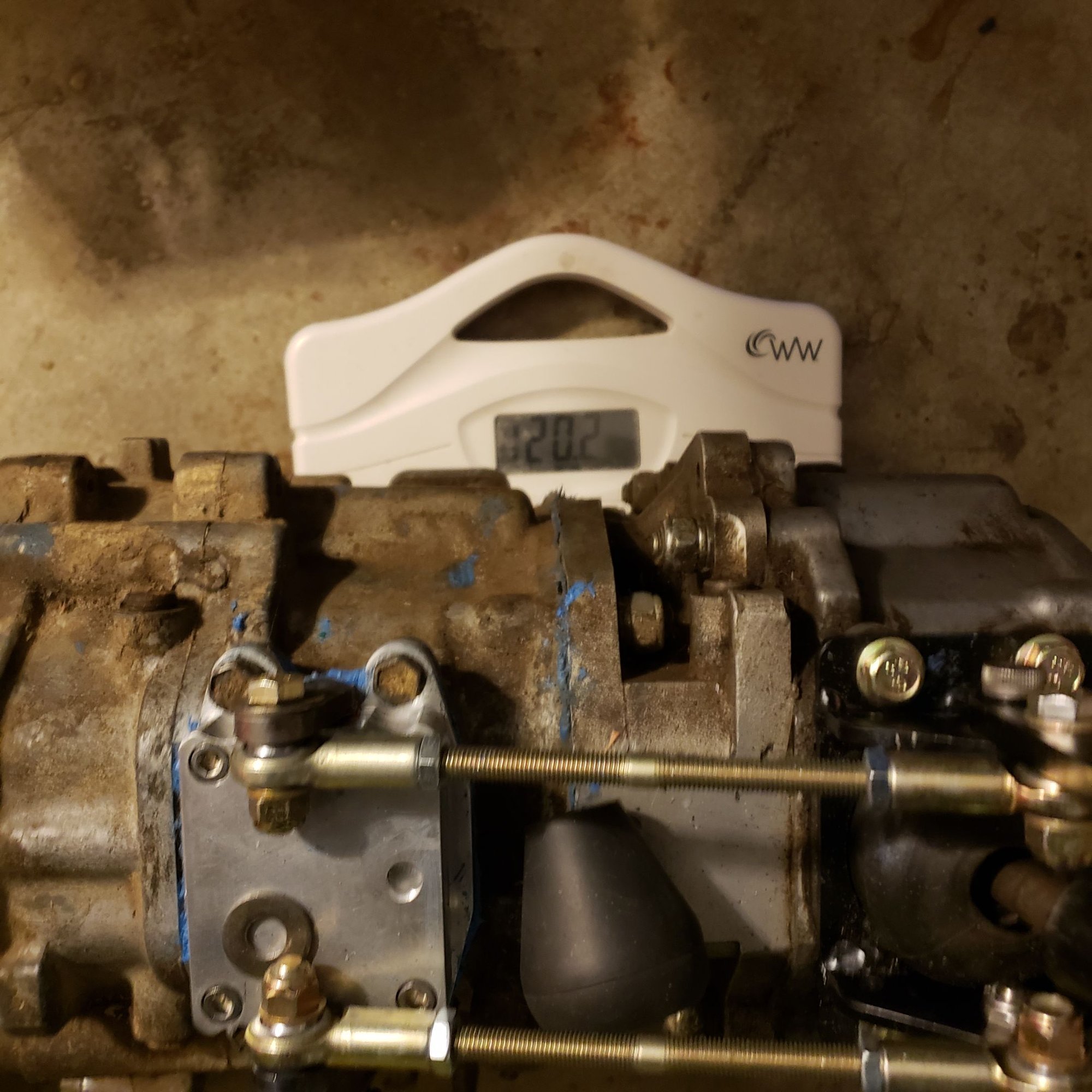

Ok so since I am kinda stuck at this point and burned out looking at transmission diagrams I stole the bathroom scale and wanted to find out of the 4runner was gonna loose a few pounds with this conversion.
threw this pile in some buckets(minus crossmember)
the chain drive parts ended up weighing 101 pounds between the two buckets.
the assembled dual gear drive cases were 120 pounds
So for a net increase of about 20 pounds more gearing options and two more levers on the transmission column the additional weight will be worth it.
trivial I know ...
