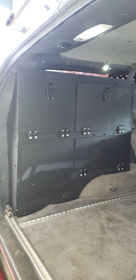

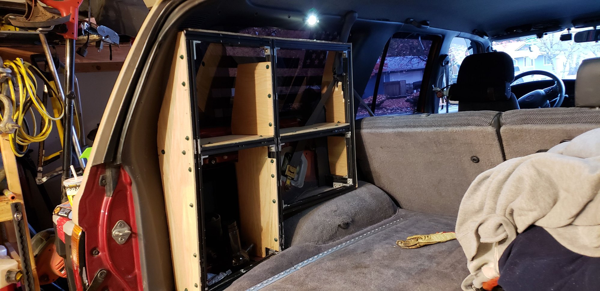

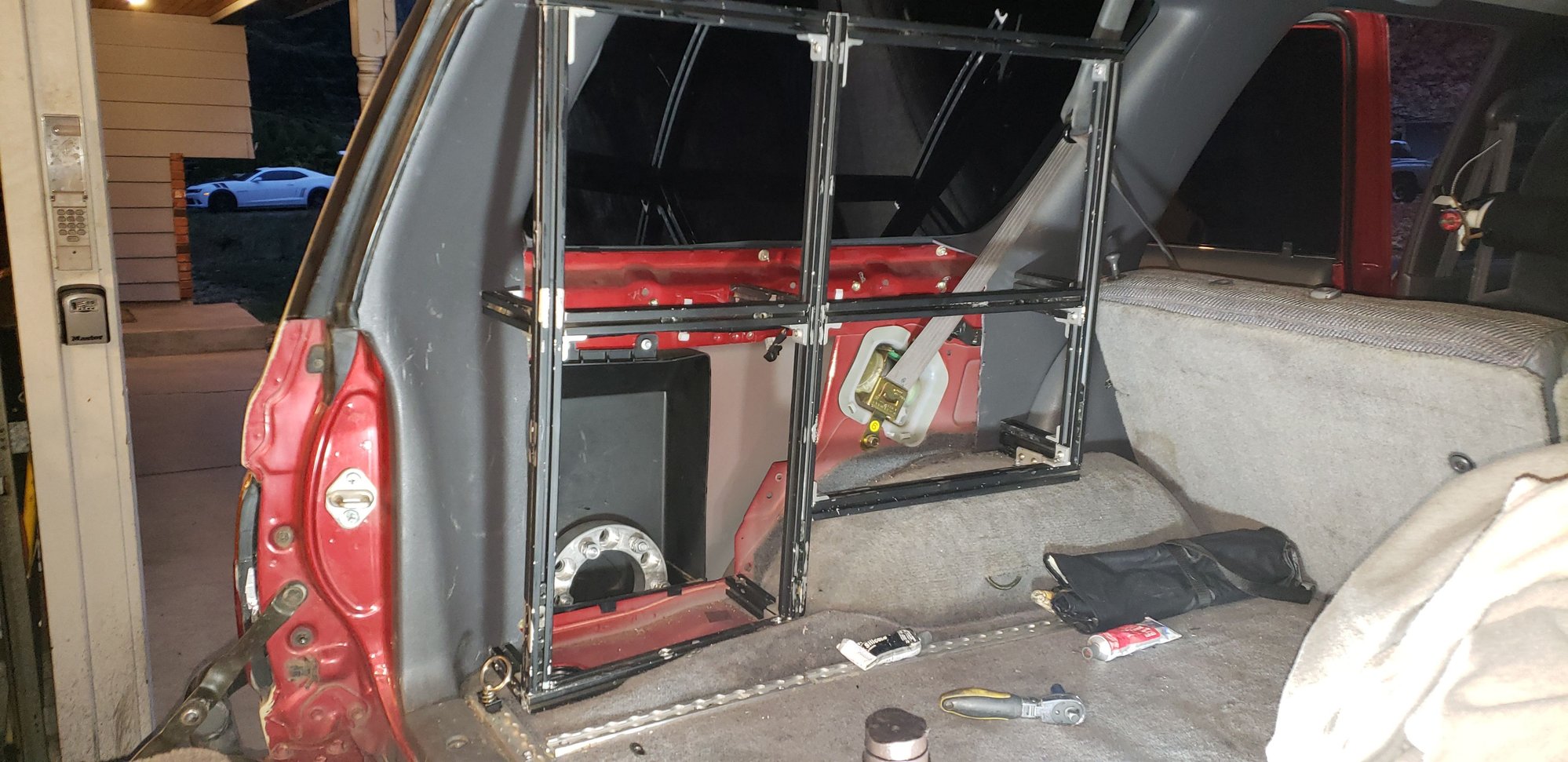

My left rear cargo area cover was cracked. I was looking at the bucket of left over 8020 series 10 strut I had left over from making my roof rack.
Debated about recycling it and than got to thinking about putting it to use for some rear storage. Had to creative since I didn't have a lot of long pieces. It's 34" long, 27" high and 6" deep on the bottom.

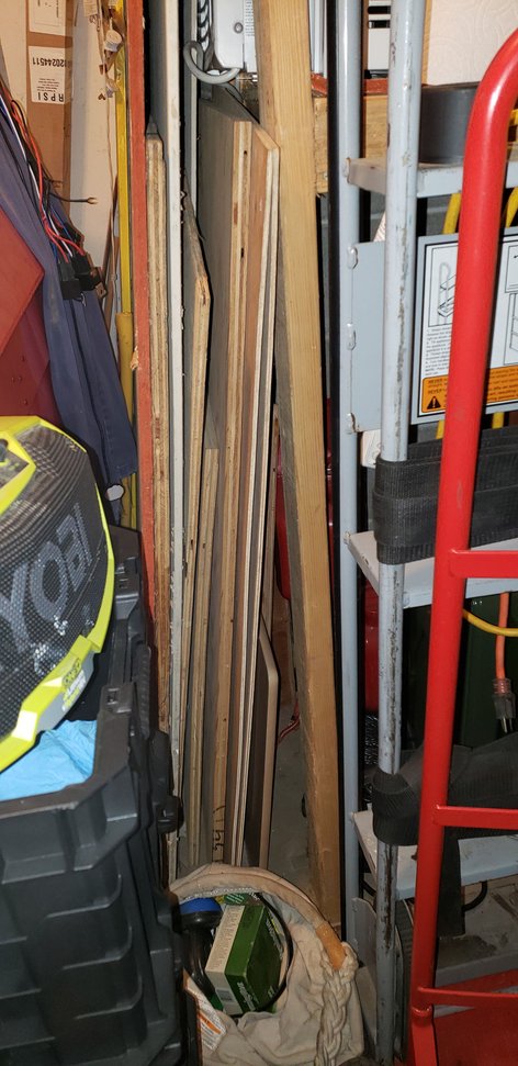

So far since I had materials I am into it for about $7 for screws. I have a bunch of plywood that has been sitting in the garage forever so I'll use 1/4 and 3/8" for the shelves and skin. I am pretty sure I have some hinges around i can use.

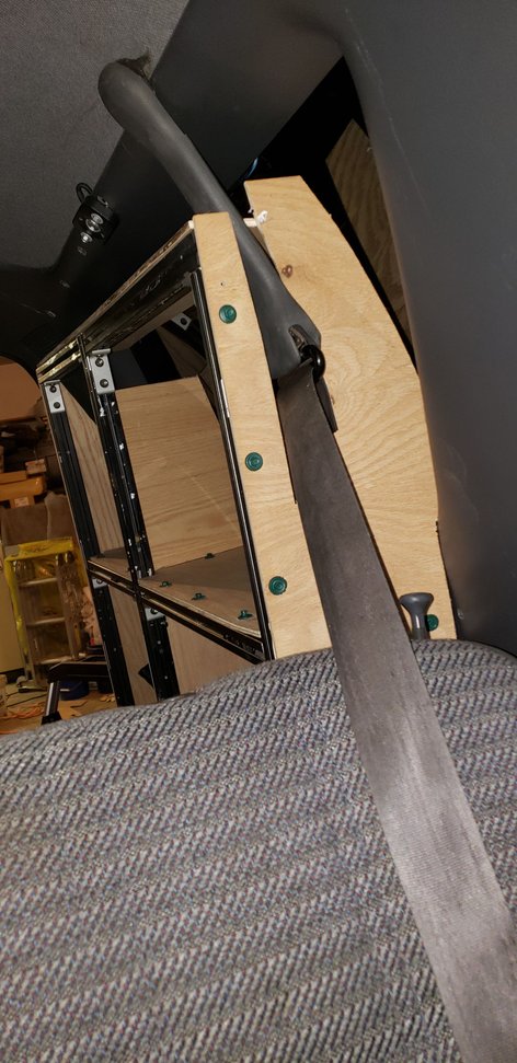

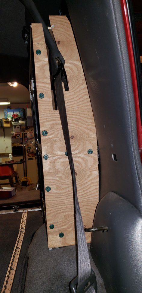

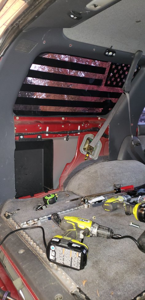

Had some time this afternoon to cut some plywood for the cargo area storage
Working around the seatbelt was sort of a pain in the butt
Definitely not a nice as the pro built stuff but I am still only into it for less than $10 using leftover junk from other projects

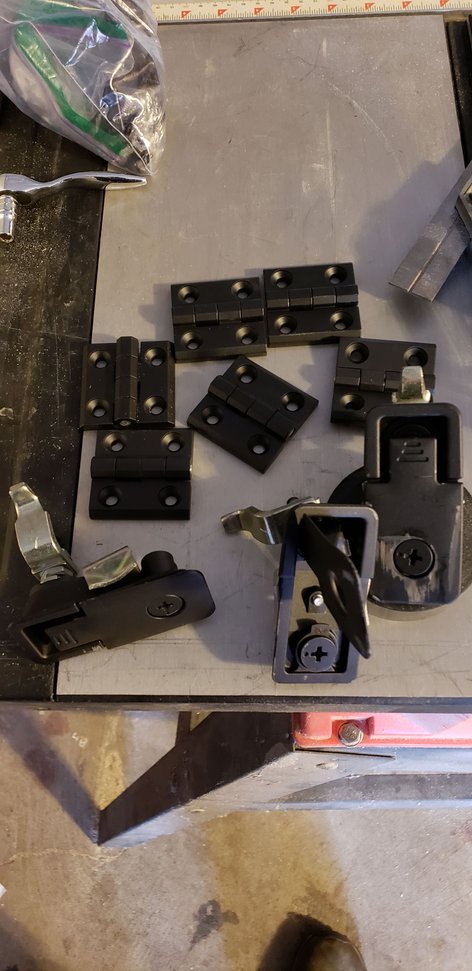

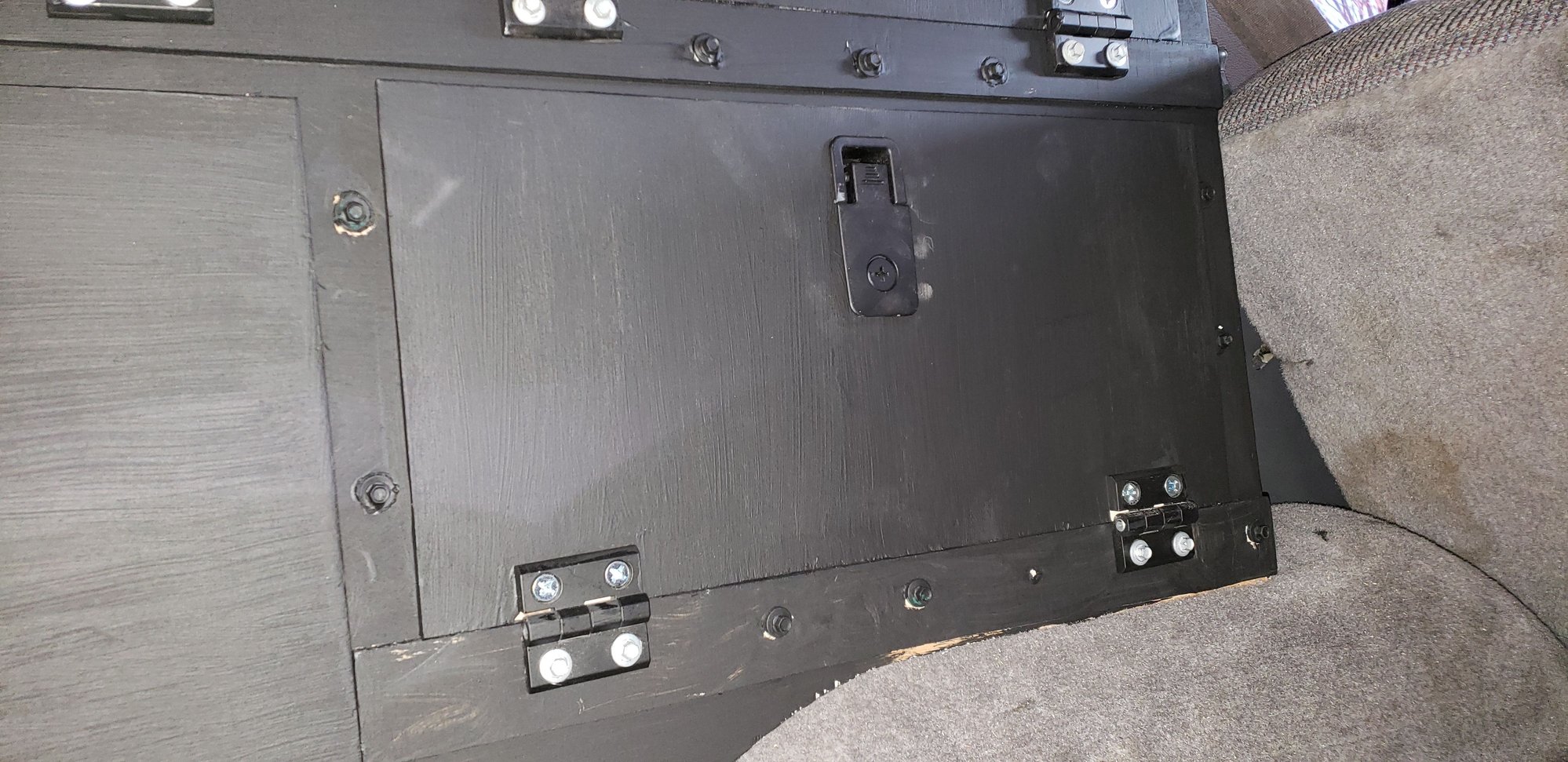

Finished up the rear storage. Well pretty close. Had to order another set of hinges and a compression latch. Not perfect but will work. Sort of wish I had left the wood natural instead of painting but oh well.

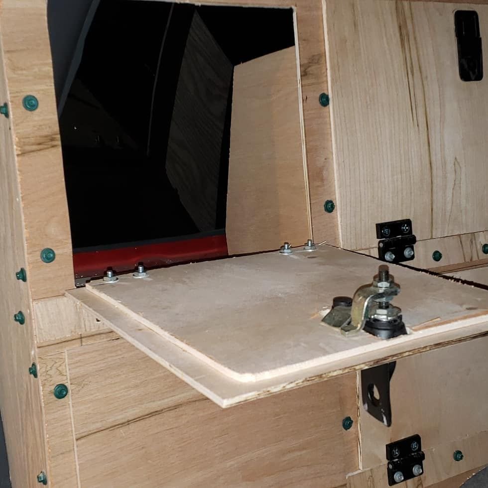

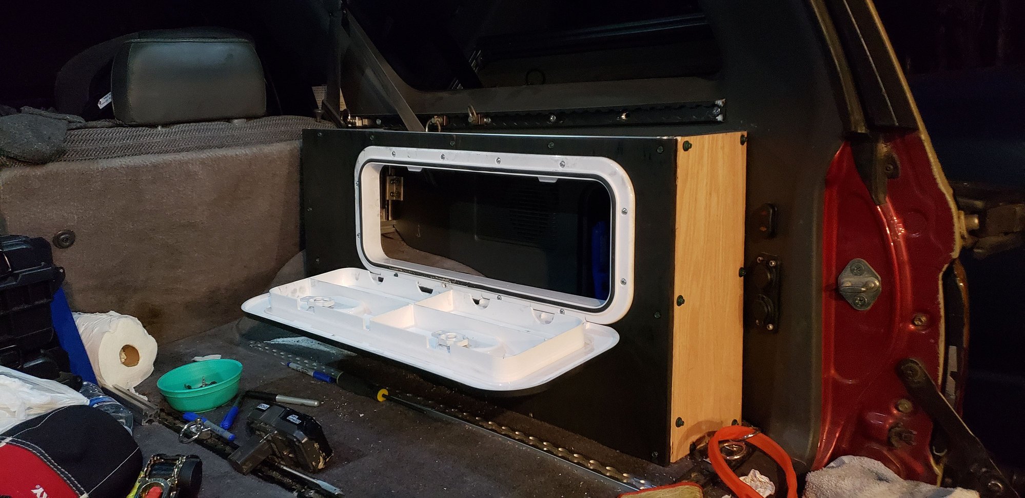

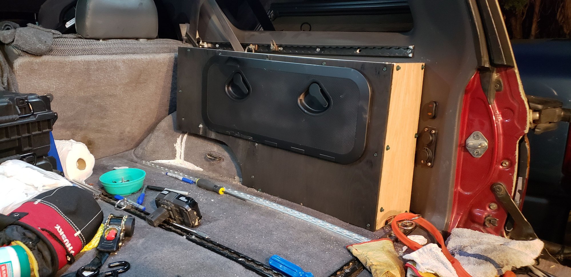

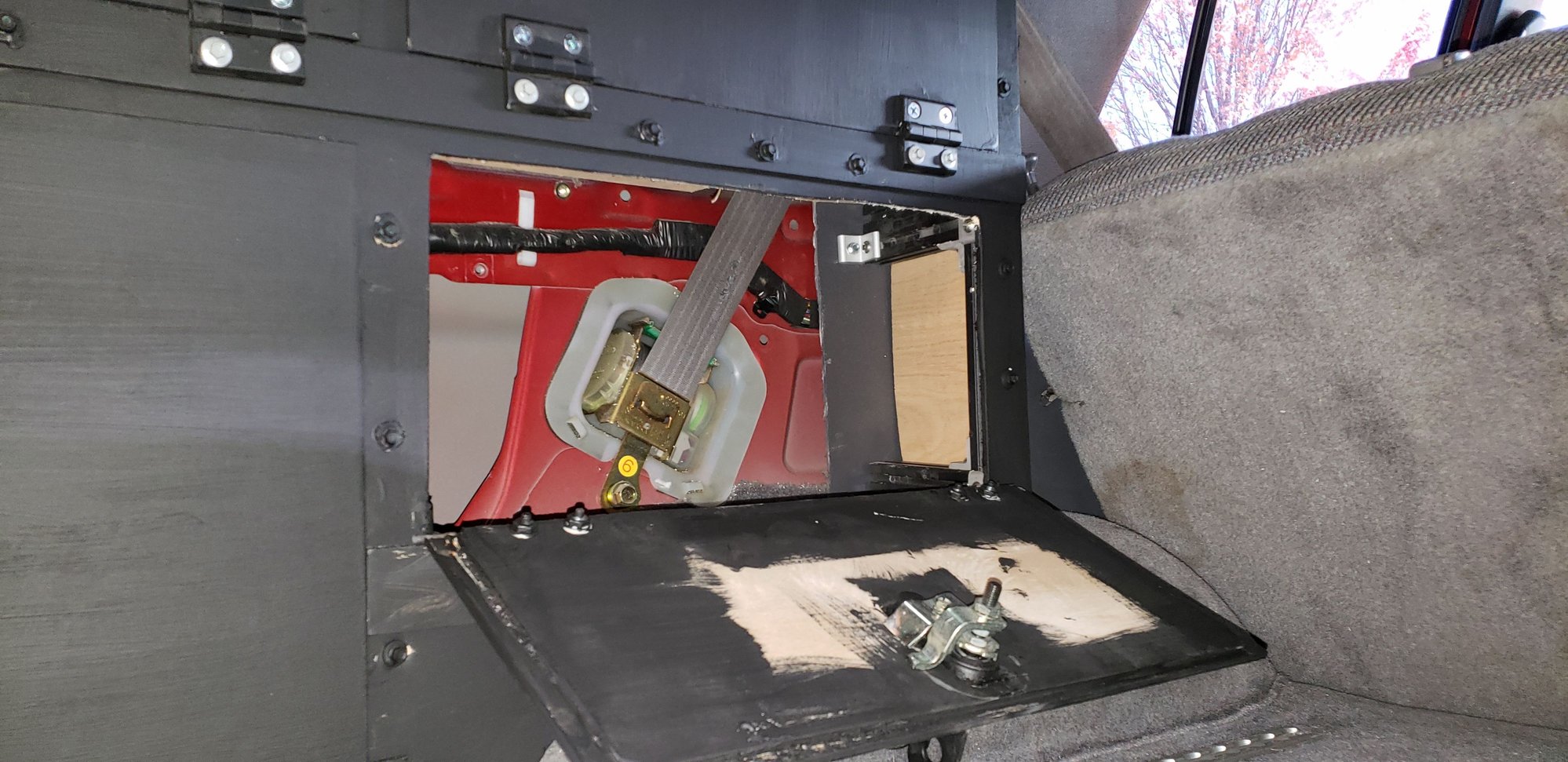

Got side tracked today and decided to make a smaller storage compartment on the passenger side
cheated this time and used a cheap boat hatch

From: mo
Boat hatch......would have never thought of that. I like it!
If there was a way to make it work like the 3rd gen cargo storage does, where it doesn't swing out but lifts up and off, I'd be all over that idea. You've got so much storage though, having too much stuff in the middle of the cargo area to get to your container areas shouldn't be an issue.
haha thanks. Wish the 2nd gen had better stock storage. This was a fun low buck project

The storage looks good. I like the boat hatch idea.

Thanks on the storage. I think I may tweek the right side so I can access it from the the top too

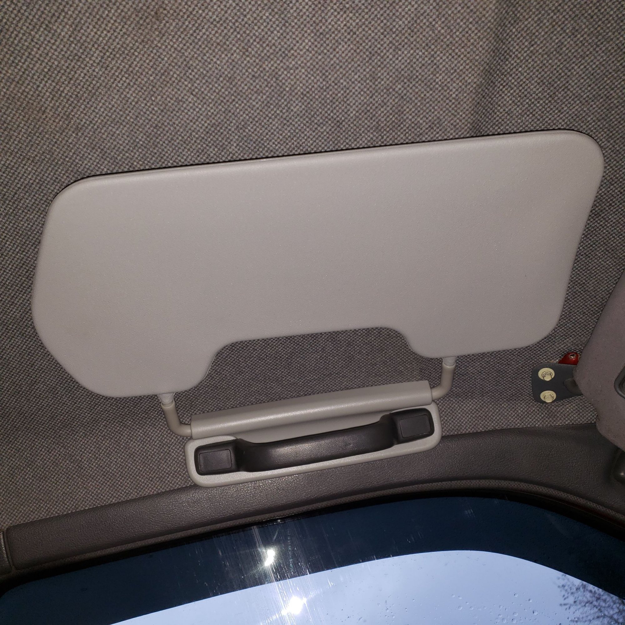

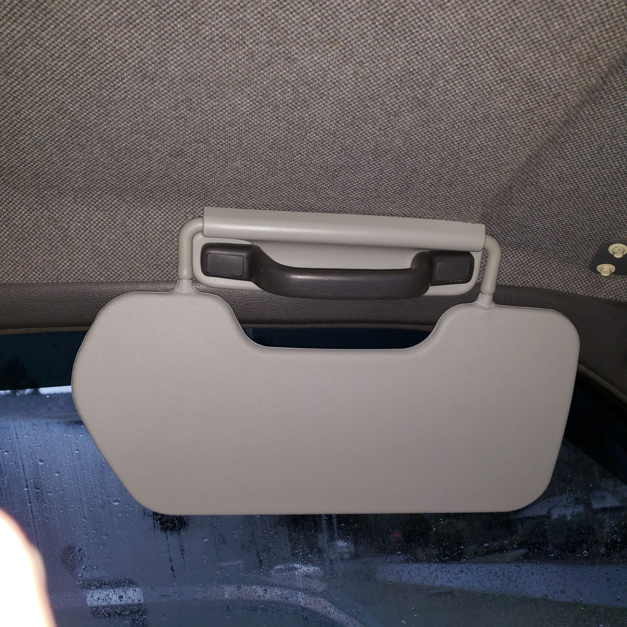

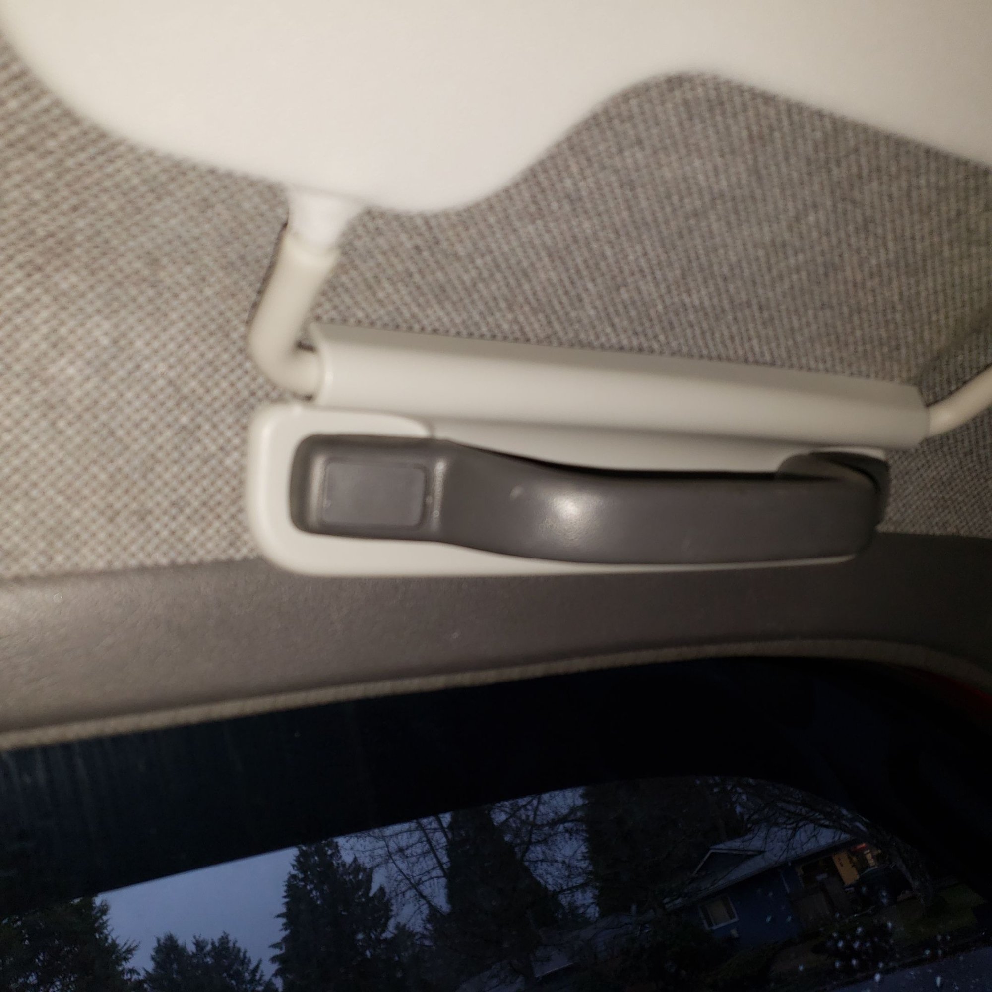

Had a FJ Cruiser side sun visor floating around.
Installed it today in about 5 minutes.
suprising the mounting holes are the same as the upper grab handles mounting holes.
will be nice this summer. Will color match it when it warms up

I still love the way you come up with these re-purpose and really useful mods...our grab handles look very similar so I may find myself doing this one if an FJ ever shows up in a yard around here....
come to think of it, my sister has an FJ with a grey interior....think she'd mind??
