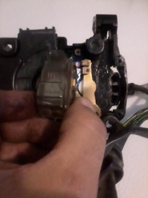

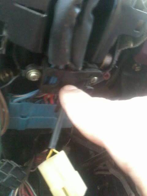

so heres some pictures for mark

The third picture down, under that clear/black cover is where the contacts are. I updated my 88 thread link to show the .22 shell as well. If your Combo Switch doesnt show any burnt wires, I would say it is just the contacts needing cleaned. Do Not try and bang on the shaft to get the steering wheel off. It will bulge easily. I seen a friend of mine trying to avoid renting the tool to take it off and you wont be able to get the nut back on that holds the steering wheel. Parts stores rent the tool for free.
Pull the steering wheel and there are 4 screws that hold the assembly on to the column, and then the combo switch comes off and you have 2? screws that hold the cover on. A finger nail file or fine sandpaper will clean them up nicely. It only takes 3 or 4 light brushes to get the contacts clean and working again. I have fixed several of the switches and never have had to replace one.
I did try using my 86 on to the 88 and something didnt quite work right. Cant recall what it was. If you do replace the combo switch, if I recall right, there is a part number down at the end of the wire harness where it connect to the rest of the column and you need to match it up as there are several different switches out there and they will work, but some functions dont work correctly.
I went to work on my Light Switch and Wiper delay. I plugged my old one in and the wiper delay worked. But not bright lights. I then tried to combine the 2 and was going to have cut wire and splice and didnt want to go that route.
MORE INFO>>> https://www.yotatech.com/forums/f116...icator-229946/
The Light Assembly I had before was from an 86 and it has another plug my 88 didnt have. I figured it was for some option mine didnt have so didnt think much about it. The white plug is what I am talking about on an 86 in this picture.
