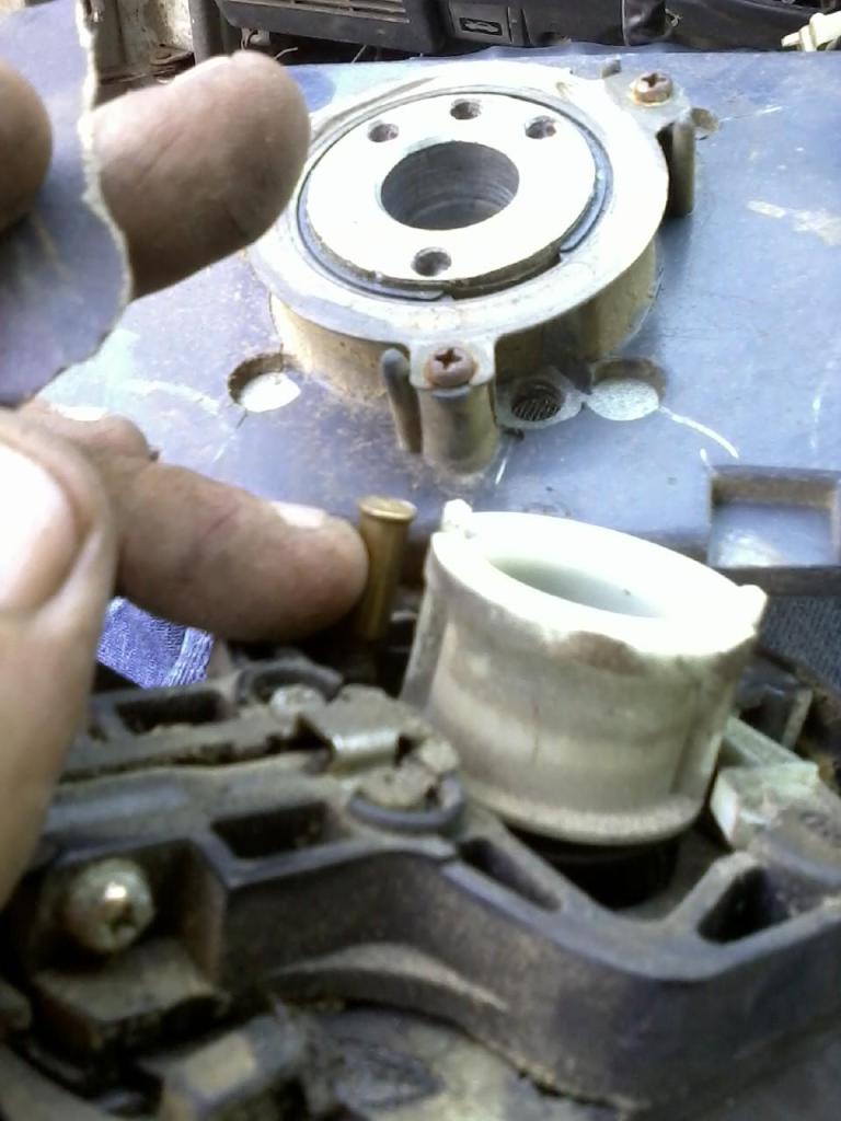

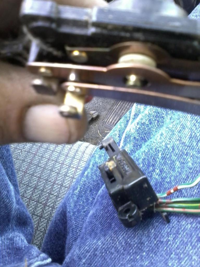

Hello Mark.. I got a laugh out of the Lexus horn as well. I used to lift the horn ring and put some kind of spacer behind the ring. I think the .22 shell works better. I was in Mistys truck the other day and I never honk the horn. I went to get afriends attention the other day as I was driving by and I have to admit, it wasnt the manliest sound at all.
Cyberhorn...I have never seen one smoked but guess it is possible. I have heard that running Halogen headlights is hard on them. The contacts just have a little carbon on them. Here is the horn fix while you are in there, it probably needs it anyways.
Got the horn to working. I used a .22 shell to make the contact to the steering wheel. I found this on Yotatech and like it better then how I used to fix my horns. I have it listed on my 88 4Runners build thread for more details about getting the horn to work on the first page. Will add this info at a later time.
Combo switch is around $40 at the boneyard here if you can find one. I just cleaned the contacts with some 1500 grit sand paper. Have it listed on the 88 runner build thread as well.
