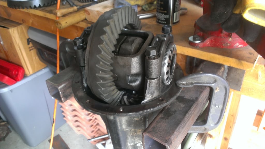

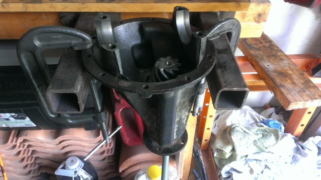

Ok, some major progress on the differential.
First of all, I used that OTC carrier bearing puller and the carrier bearings came off easy as pie. That tool is amazing.
With the carrier bearings off, I cleaned the surfaces and then tapped the new bearings on with a 2x4. Then I put the diff housing into my little jig and clamped it down.
Put the races onto the carrier bearings and sat into place. Then carefully put the adjusters into the threads and put the adjuster caps on. I did not yet put any anti-seize, I'll do that later when I make sure my pattern is good and I set my final backlash and carrier bearing preload.

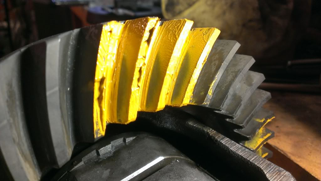

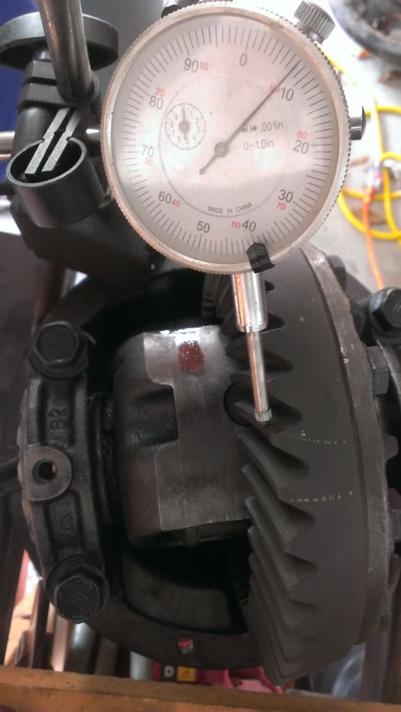

Next, I turned the adjusters until I got about .008" of backlash, tapping the bearing caps with a hammer all the while. Once it was set, I rotated the ring gear and check the BL in 4 places. All were within .001", so the run out seems fine.

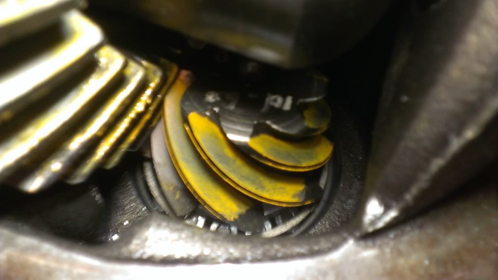

Tightened down my bearing caps, painted some ring gear teeth and went in for a pattern check.
This is with the .081 shim, and in my opinion, looks a bit deep comparing it to patterns on Zuk's site. I think I'm gonna tear it down and go with the factory .077. If anybody has a different opinion, let me know.

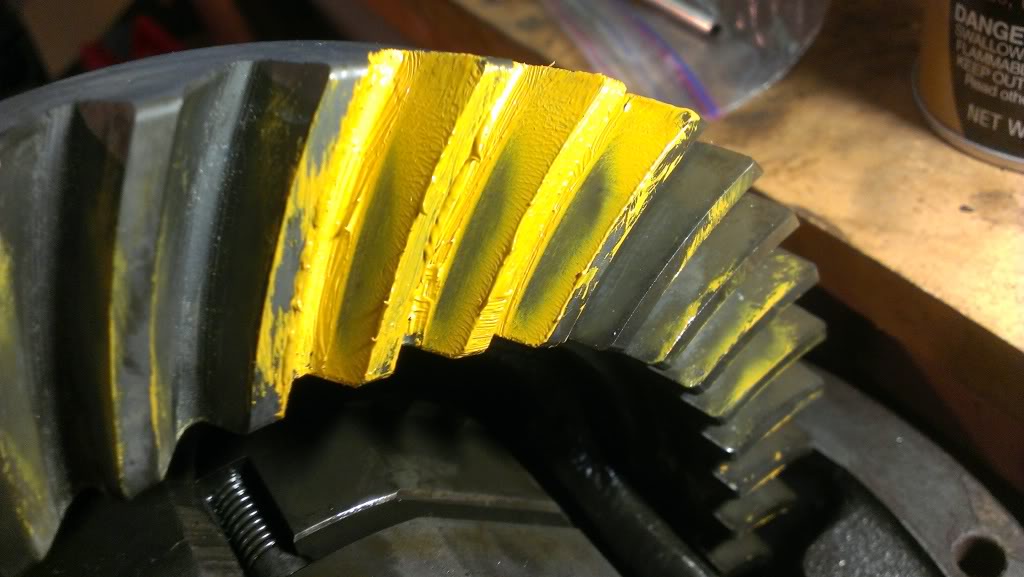

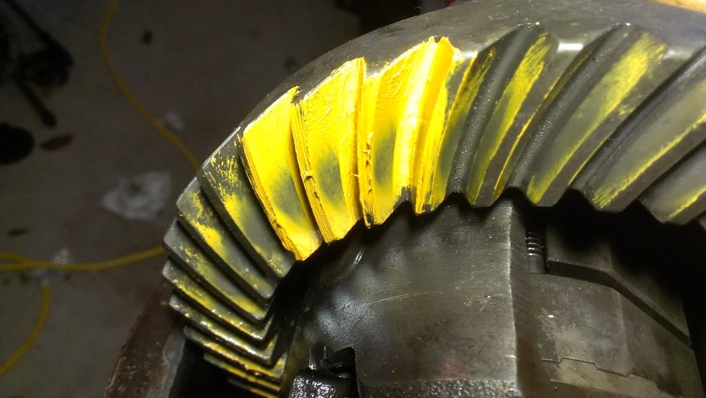

Thanks Chef, I always appreciate your comments. I jumped from .081 to .079 mostly because those were the only 2 thick factory shims I had. The other shims from the install kit would take a big stack to get up to the desired value, so in my opinion, fewer is better.
Anyhow, since I had the .079, I disassembled everything and put that shim behind the pinion bearing. Took me a while to get one of the carrier bearing adjusters seated properly, but it's important not to cross thread it. You should be able to rotate it by fairly easily when the cap is lined up properly.
I didn't take any pics of the tear down or reassembly, but it's all the same as before. Here's the new pattern with the .077 shim.
And here is the coast side...
To me, it still looks a bit deep, I'm gonna ping Zuk and see if he agrees.

No possible alternate idea that could beat the ZUKopedia input! From all the threads/pix I've seen, I agree that it MIGHT be a lil deep. But, better to inquire with the maestro! Lol

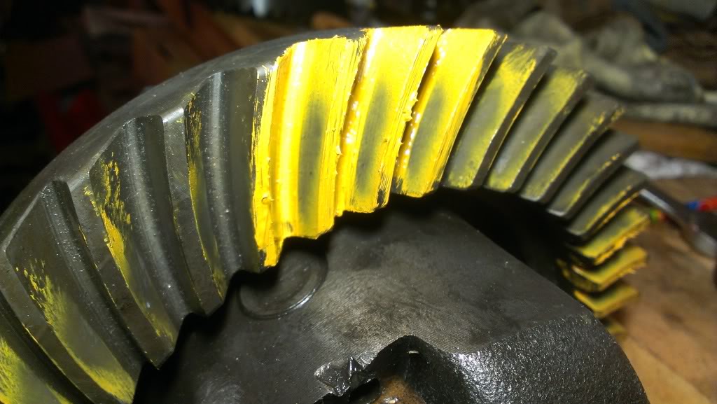

PING!!!!! I agree Cory....it needs to be 075....unusual that it would be at the lower end but that happens.

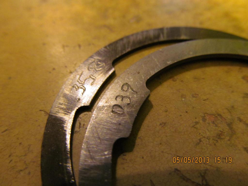

Cory, it looks like you will have to use the shim stack so be careful when measuring the individual shims. The edges of the shims might need to be filed. I think they stamp these shims out and that edge can mess up your reading a little. 074 is ok to try also.
edit---looking at the 081 pattern and the rate of change of the 077 pattern, i bet 074 puts it in a good spot.
Wow Zuk, thank you so much for the advice. I will definitely file the edges of my shim pack. With the shims I've got, I'll have to shoot for 075, but I might sand them a tad and see if I can knock off .001, I believe I've seen you do that a time or two.
