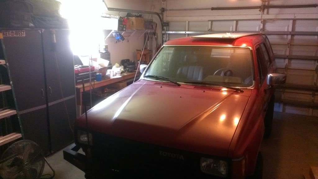

Gizler, Kornhusker - just saw these responses. Thanks for your encouragement. Setting pinion depth seems to be the only real difficult thing about the whole gear setup. I had to take a little break on the truck work in the last week or so to finish up the playroom in the house. I finally got the room all painted, ceiling painted, baseboards painted, and the foam flooring put down. This was originally a party room addition by the previous owners which is why there is a sink and mini-fridge.
I spent all weekend working on that room, but I did manage to make a small bit of progress on the truck....I cleaned out space for it and moved it into the garage so I can pull the rear axles and diff. It's a small victory.

Hey Cory,
Room looks great. Kids will have a blast in that room...
Good planing on moving the truck in, seems to be raining down here in Miami every day lately. This weekend I got started working on the trucks TPS (Bad TPS), but I opened up the hood pulled the tools out and what happens rain 20 minutes later RAIN. Closed up everything and put up the tools closed the garage and head for the shower. What happens after I take a shower, bright and sunny...

room looks good!
shop looks better than mine LOL

Room turned out great. It's always nice to be able to work inside.

Thanks Junk - yeah LOTS of rain here in the last week or so. Rain and heat...it's definitely summer.
Originally Posted by Cyberhorn The Dragon
room looks good!
Thanks Cyberhorn....I don't know if I'm allowed to call my garage a shop. Terry has a shop, I've got a barbie play shed.
