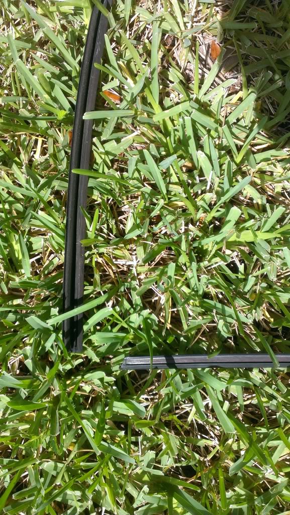

irab - Thanks! Been reading your thread on the villager fan, appreciate all your info. I have done 2 out of the "big 3", still need to upgrade the alt wire, but I guess that can wait until I upgrade the alternator.
Originally Posted by Cyberhorn The Dragon
several all metal radiators are avail on ebay as well i got an all aluminum one with 3 cores for the 90 for 135 n its worked great
id have a shop look at it, fins can be fixed easy they even make a fin straightening tool my radiator both side plates were broken loose due to the bop she took to the nose an i sweat soldiered them back on easy not hard if youve done any copper water pipe repairs
DO NOT get any plastic an metal radiators they fail regularly and at the plastic potions also not repairable the aluminum is crimped an glued to the plastic
Thanks Dragon - both you and junk suggested I fix my current radiator myself. Didn't even occur to me to do that, so I think I'll examine my fins and see if they look like I can comb them straight with a tool. I have soldered pipe, so I suppose I should be able to solder the radiator. Saved me some money right there, thanks.
Originally Posted by junk4u
Had the same issue on my radiator and didn't think anything of it, did the same as Cyberhorn and soldered it right up, except I used a little silver solder.
the fins you can get a FIN COMB from any HVAC shop or store that sells AC supplies, not sure how well they would work on the radiators as i never tried it on those before, but it should work fine since the concept of the fins are the same.

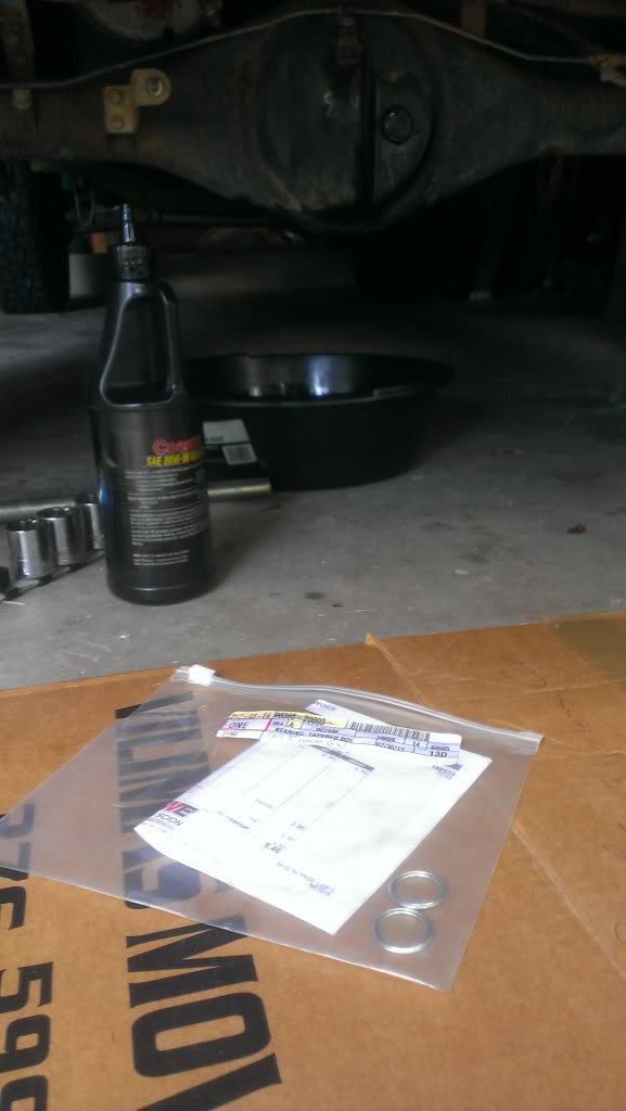

I noticed a drip from the rear diff in the driveway a couple weeks ago. So knowing that I was getting close to the 500 miles of break-in on the new diff, I ordered new drain and fill plug gaskets and waited until I hit the 500 mile mark. The new metal crush washers were .96 cents apiece, so I ordered 4. Since my last ones were original, I'm really hoping that was causing the drip and not the new pinion seal or worse the RTV seal on the 3rd member.

Well, so far have not seen any drips of oil hanging off the diff, looks dry to me, so I'm crossing my fingers that it was just old crush washers.

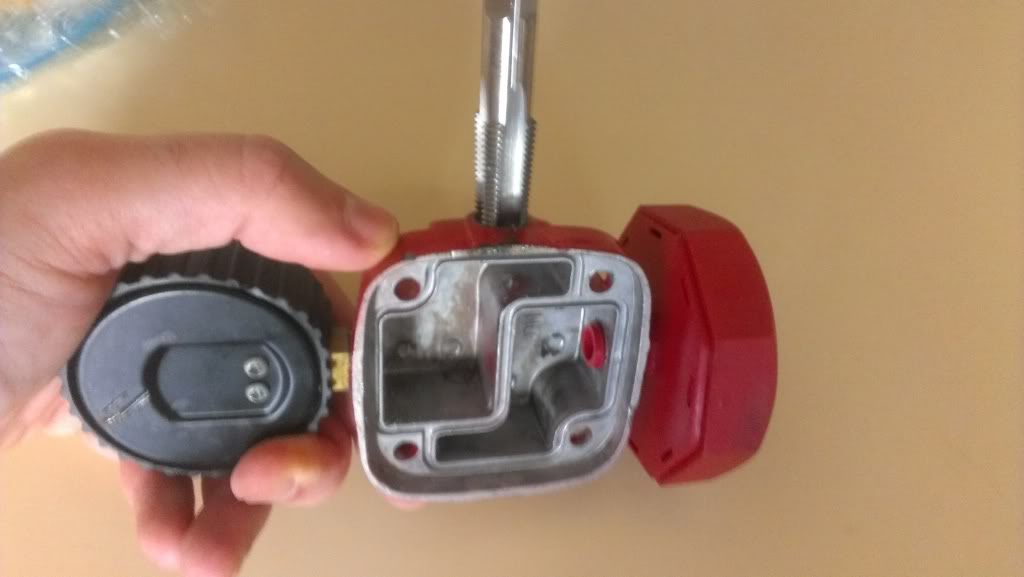

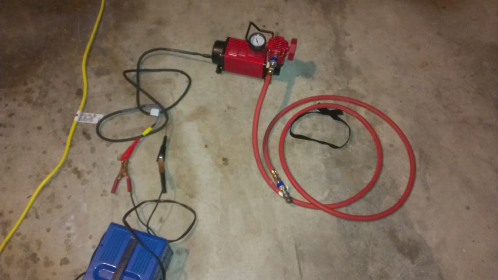

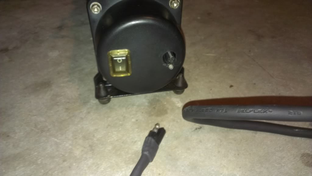

I have had this superflow air compressor for years, but the air fitting broke making it unusable. I finally decided to fix it so I could take it on my trip. I drilled the hole out with a 7/16 drill bit, and then tapped it with a 1/4 18 npt. I'm also going to replace the power wires with some heavier wire that I have.

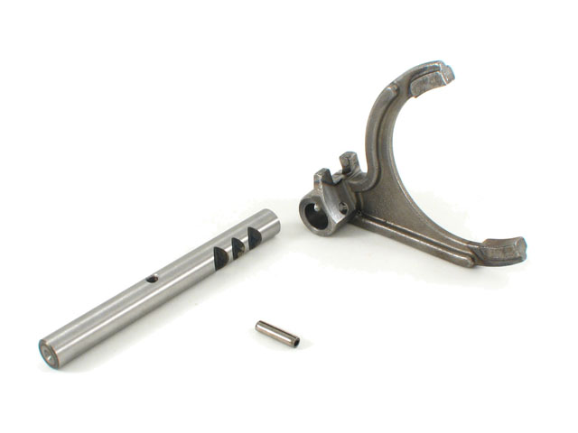

Well, I did some more digging last night, and at this point I'm pretty certain that I do not have the hi/lo shift rail for this transfer case. I contacted the seller and he could not find it in his garage either, so I need one. If anyone has a spare hi/lo shift rail please let me know.
Here is a pic of what I need I copied from Marlin's site...they are out of stock by the way. I only need the rail, not the shift fork.

Hey buddy, go to yotamasters.com , grab the phone number is give Eric a call. I'm sure Scotty as well might have something like that in his shop stored away. I know that Eric Hansen who owns yotamasters does a lot of transmission, gears and so forth... You never know.

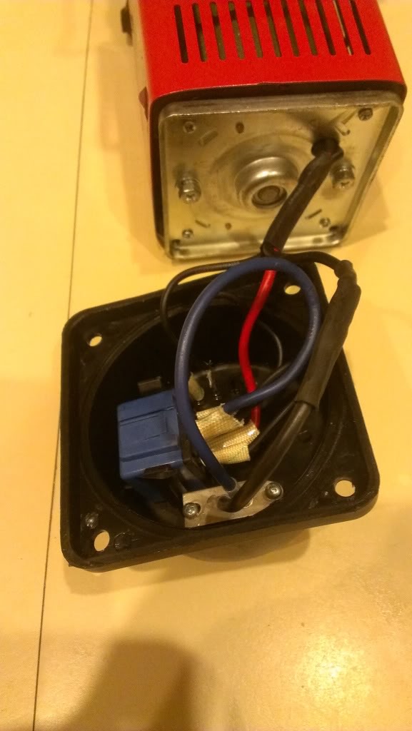

No progress yet on the transfer case rail. I've posted some wanted ads on different forums, I'd rather get the rail from a member.

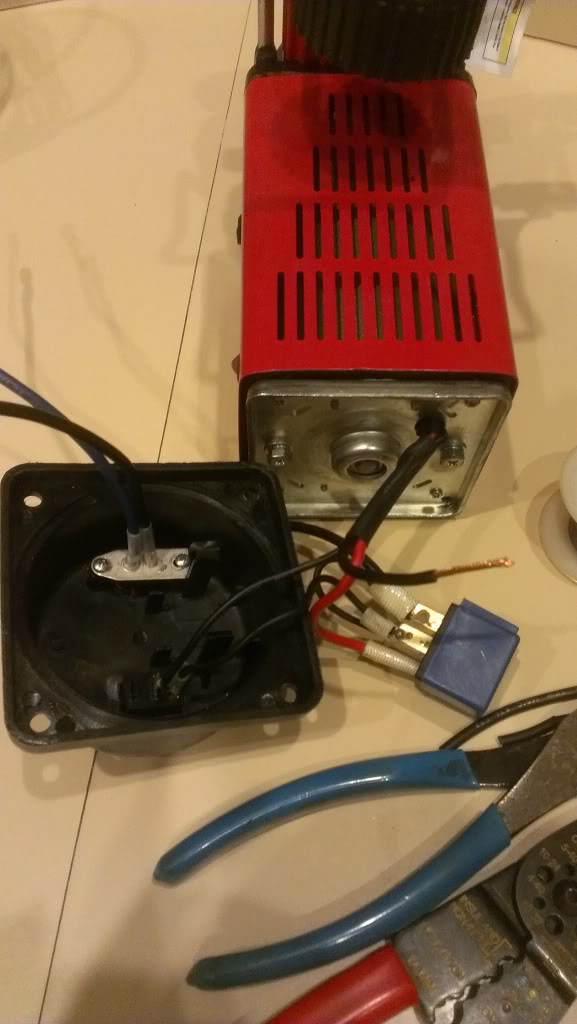

Finished up the work on my little superflow air compressor. The other day I drilled and tapped the output hole to fit a standard quick coupler. So tonight I opened up the electrical end cap and soldered in a heavy duty connector which is thicker wire and is a nice automotive style connector so I can remove the power cord.
Here is a shot with the end cap opened up. You see the new connector there on the left and the stock relay there on the right. A lot of people change that relay, I may do that at some point in the future, but for now it works.
All soldered up and heatshrink installed, relay stuffed back in its spot.
Here is a view of the end cap back on, you can see the new connector just peeking out of the original hole and the mating DC cable laying there next to it.

And here I am testing the compressor all put back together. Still gotta go pick up one of those air guns that Chef mentioned to really try it out.
