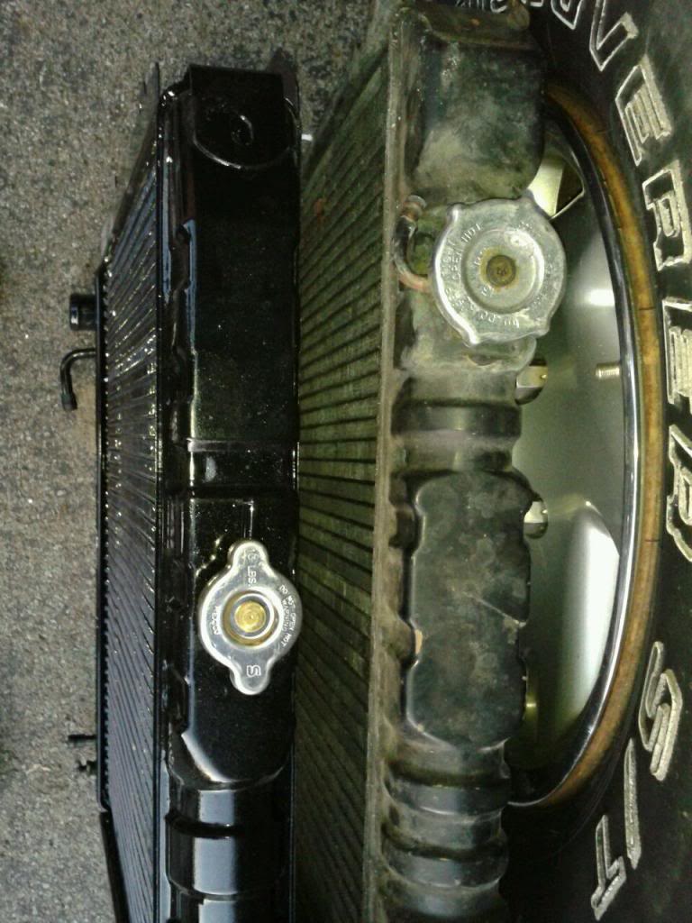

My old rad which is the v6 style next to the new one.
The old one behind the new one. Note how the old top tank is taller than the new one but the new one at the inlet is at same height as old. The position of the mouth is different as well as the overflow vent.

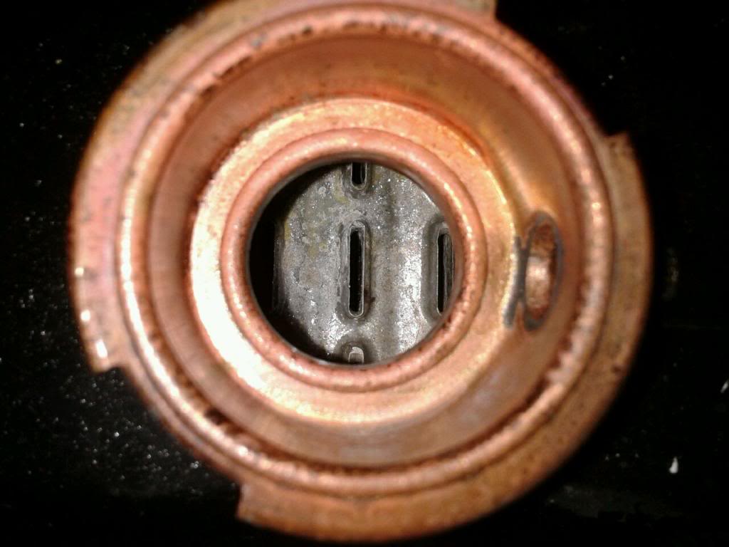

Looking into the old rad - three row with 2" core.
