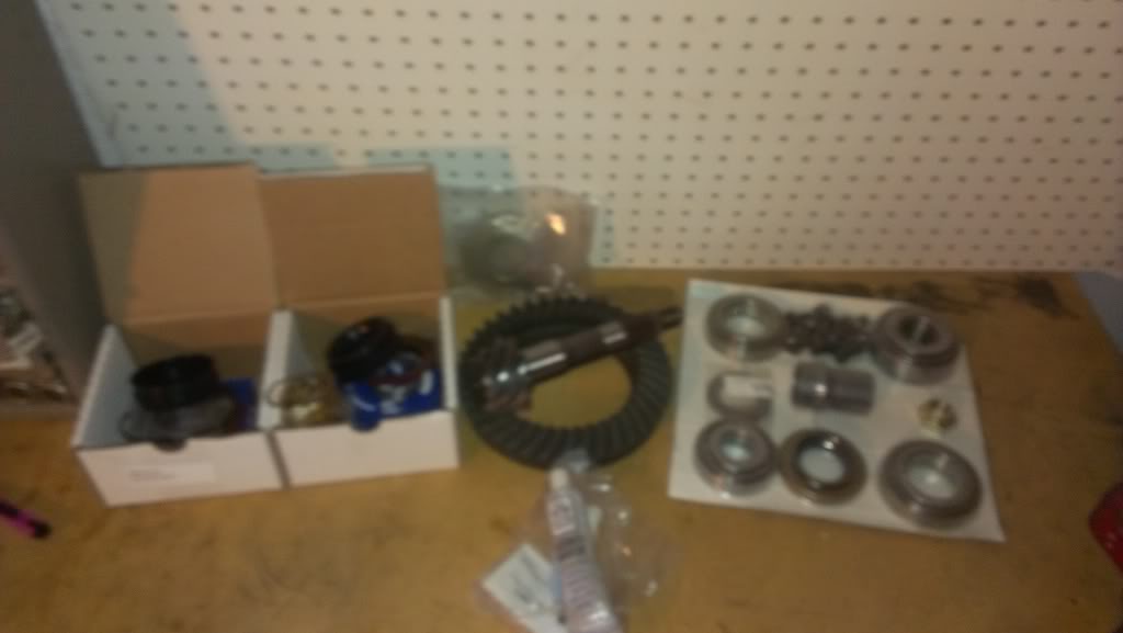

Alrighty, got my package from Marlin crawler today with my solid spacer, rear axle service kits, and my new carrier adjuster lock tabs. That motivated me to get out there and start tearing into the job. On with the pics...
First of all, here's all my goodies. Axle service kits on the left, Trail Gear 4.88 R&P in the middle and the TG gear setup kit on the right.

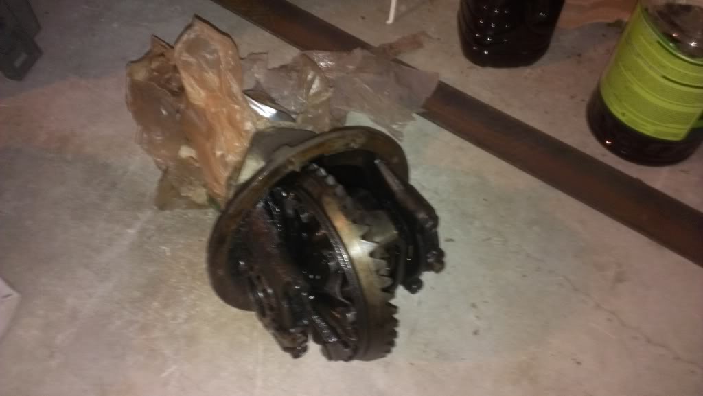

And here is my victim...it's the original diff from my 4Runner, which I swapped out a few years ago.
Breaking down the diff was not hard. I just removed the carrier (keeping track of which bearing support goes on which side), removed the pinion nut and the pinion just fell out.

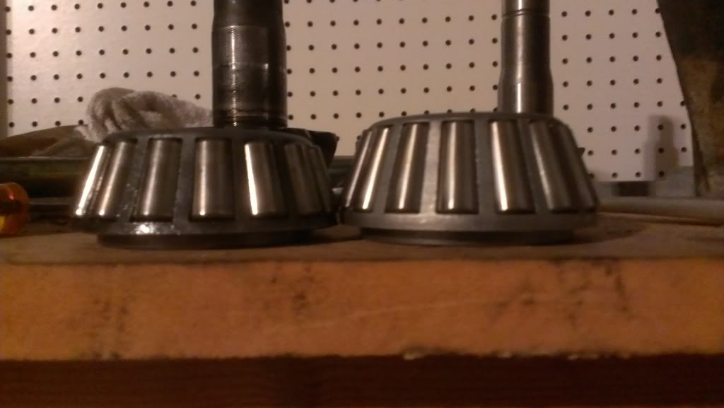

Here's a look at the original 4.10 pinion on the left and the new TG 4.88 pinion on the right.
I used my HF bearing splitter and my HF 12 ton press and removed the pinion bearing. I didn't have to do this, but I wanted to measure what the OEM shim was under there. It measured .076.

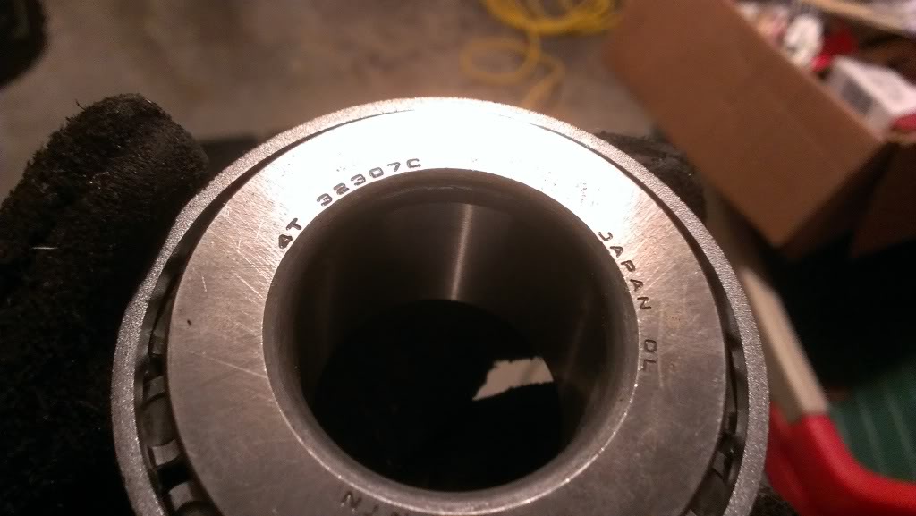

As I was looking at the old and new pinion bearings, I noticed that the new one is thicker than the old one. Old is on the left in the pic.

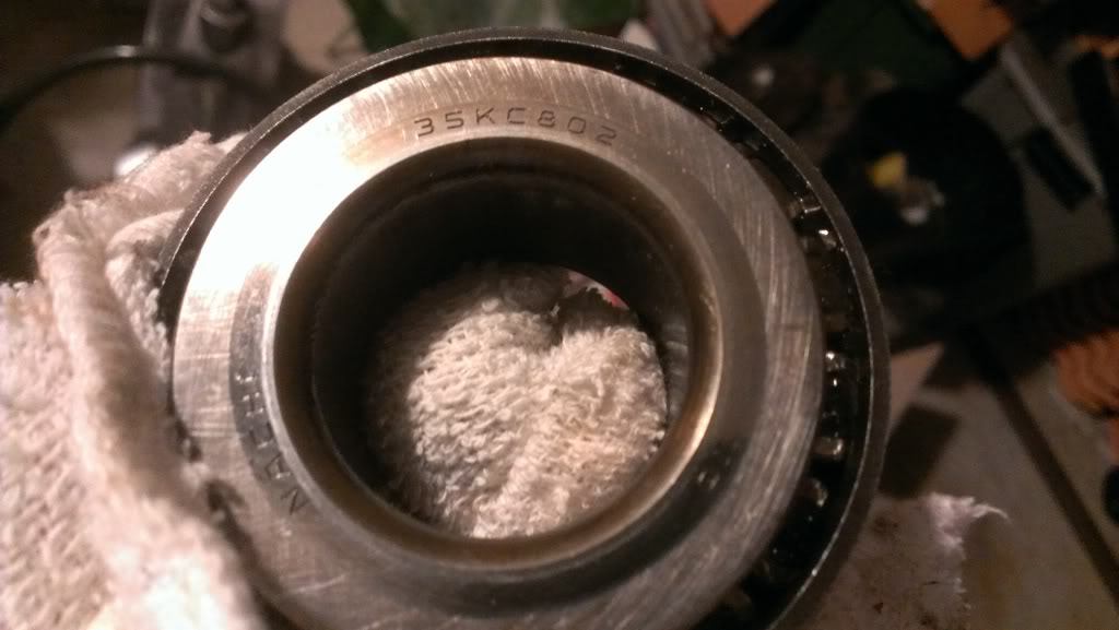

Hmm, the old inner pinion bearing is a NACHI 35KC802.
And the new inner pinion bearing from TG is a NSK 32307C.
According to ZUKs info page, the 35KC802 is the correct bearing for my 88 4Runner, the only mention of the NSK part number on his site is for 79-85 trucks. I'll email ZUK to see if he thinks there is a problem. Just seems odd to me that the bearings are clearly different thicknesses.

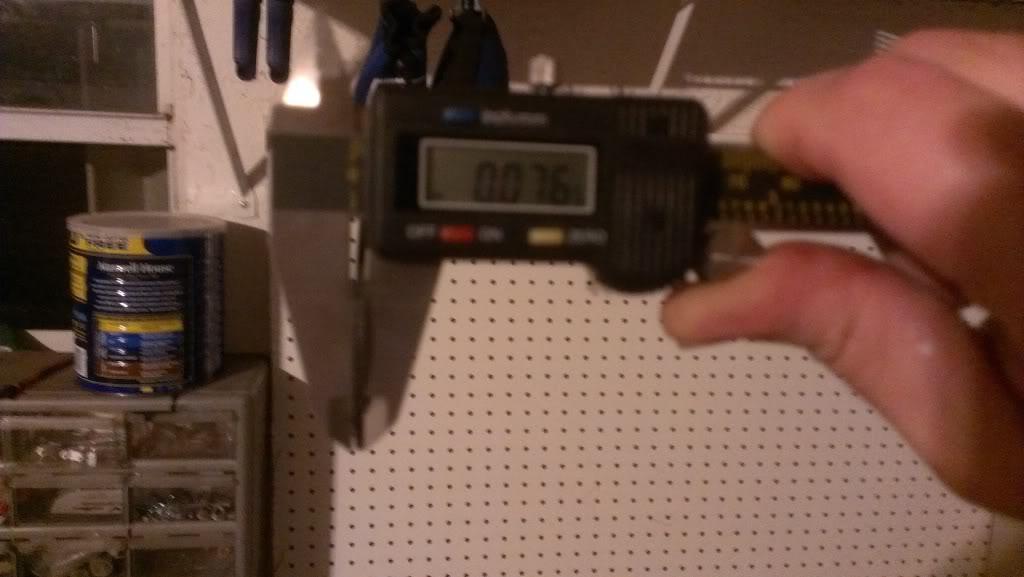

EDIT: Ok, after reading ZUKs page more and more, I went back out and measured the heads of both pinions. The 4.10 head is 1.66" and the new 4.88 head is 1.56". I'm more and more confused. Zuk's page says that the long pinion head is the V6 pinion. So perhaps at some point in the life of this 4Runner, somebody swapped in a V6 pinion. Maybe this is all starting to make sense, Zuk usually seems to use around .092 shim thickness for the 4cyl thirds, and my diff had .076, which seemed awful low to me, but maybe the .076 shim is because this pinion head was longer than it should have been.

Your good to go. All pickups and Runners in 1986 got "V6" long pinion head ring/pinions. Nothing really to do with V6 power or engine size.....all the 4 cyl and V6's got them. The 79~85's received the short pinion heads....they were all 4 cyl rigs also, by chance.
So, your new 488 gears are the "4 cyl " variety. Just as strong as the V6 gears, by the way. Toyota might have dis-continued the shorties due to stocking problems?.....better to use one part number for ALL trucks?....Just have to use a different bearing. So, your short pinion and long bearing cancel each other out resulting in the same exact pinion placement needed. Try a 080 shim for starters and post some painted pics
ZUK

Wow, ZUK, your knowledge about differentials blows me away. Thank you so much for posting and clearing that up for me. Without your website, I wouldn't even have dared attempt this.

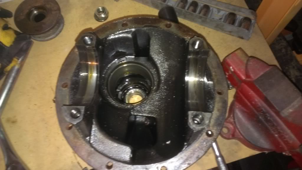

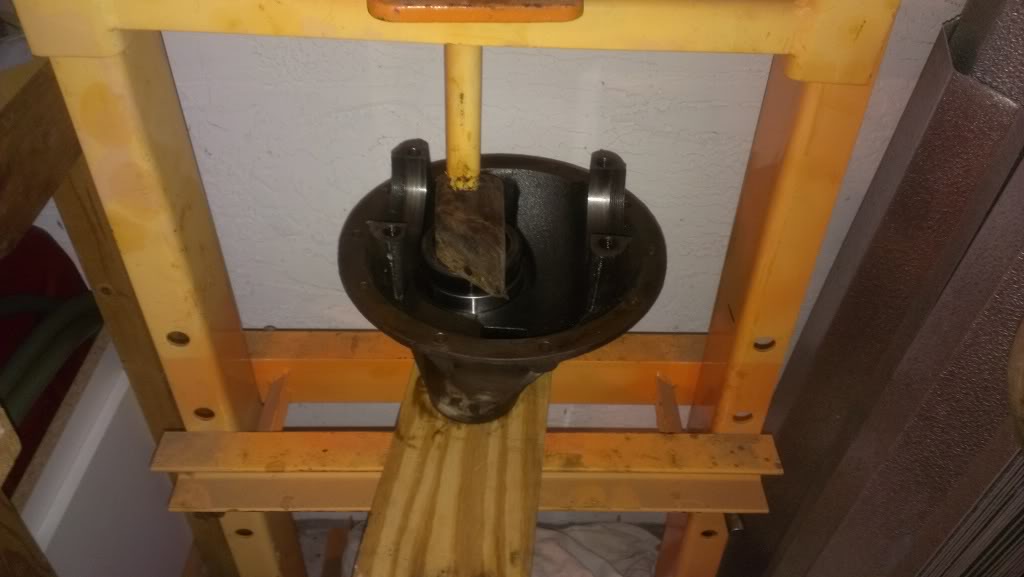

I made a bit of progress last night. Tapped the old races out with a brass drift and pressed the new races in.
I used the old inner pinion race to press the new one in. It worked great until that last 1/16" or so. The old cup (which is sitting upside down on the new cup) would also get pressed in to the bore a little bit and I could not get it out without flipping the whole housing over and tapping the new race out a bit to knock it loose. My solution was to just flip the old cup over and press down again. It again got stuck, but now I had a lip that I could knock it out of there with. This is probably all hard to picture, but if you put 2 races on top of each other, skinny edges touching, that's the first way I pressed. Then if you flip the top race over, that's the other way. And with that top race flipped over, I could then turn the 3rd member over and use my brass punch to just tap the butt end of that old race out. I then cleaned the inside with brake cleaner and also cleaned the new races with brake cleaner.
That took me longer than it should have, but it's in there. I flipped the 3rd several times during this process to see if the race was fully seated. Then took it out of the press and I just used the brass punch to tap the outer pinion race in (using the old cup as a spacer). I gently tapped around it in a circle over and over and it went down fairly easily.
I'm going to borrow a micrometer from work and do an inventory of the shims that came with the install kit and with the solid spacer.
I also need to check AutoZone to see what kind of loan a tools they have to pull those carrier bearings off. Stay tuned.

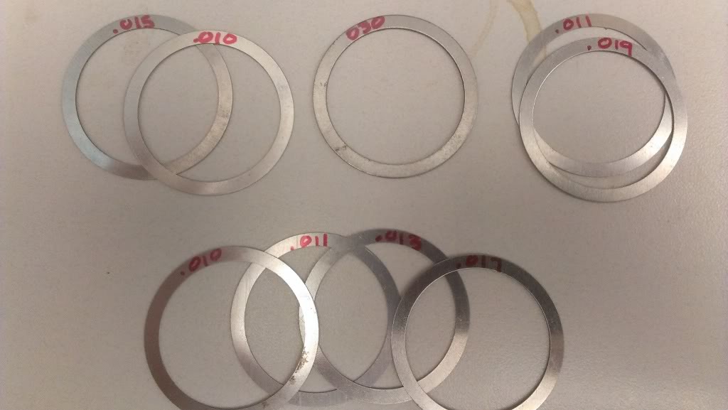

Brought all my shims to work with me today to use a buddy's micrometer.
On the left is my selection of shims to make up the .080 that ZUK suggested. 4 .015 shims plus a .020. On the right are the leftover .010 and the original .077.
Also mic'd the solid collar shims from Marlin. It came with 9 shims, even though the website mentions only 5 shims. At first I was confused, but basically I think they give you the 9 shims so that you can combine them to get the 5 values listed on their website. I grouped them together to show how to get the .025, .030, and .040 values, to get the .035 and .045 I'd have to just add the .010s to the .025 stack.
