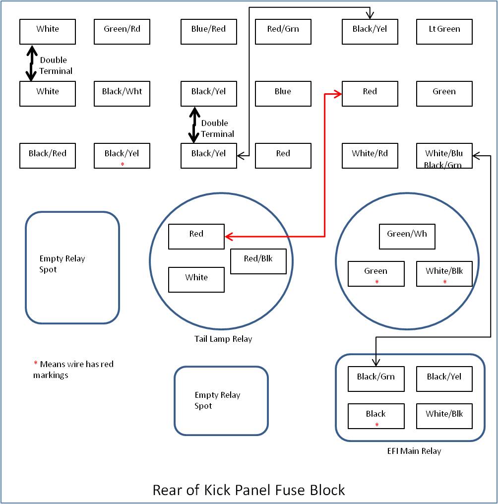

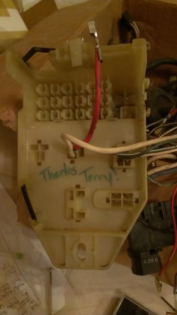

Made a small bit of progress on the fuse block. Got nearly all of the little terminals out of the replacement panel that Terry sent me. I made a diagram of the wire colors so I can refer to it when putting my truck's wires back in. It takes a flashlight and a couple of tiny jewelers screwdrivers to get the terminals out. All of the fuse terminals are held in the same, but for some reason each of the relay terminals seem to be different. I have to bring my dental pick from work so I can get the last couple, the screwdrivers just would not get down in there.

Here is my diagram for the wire colors and where they go...
