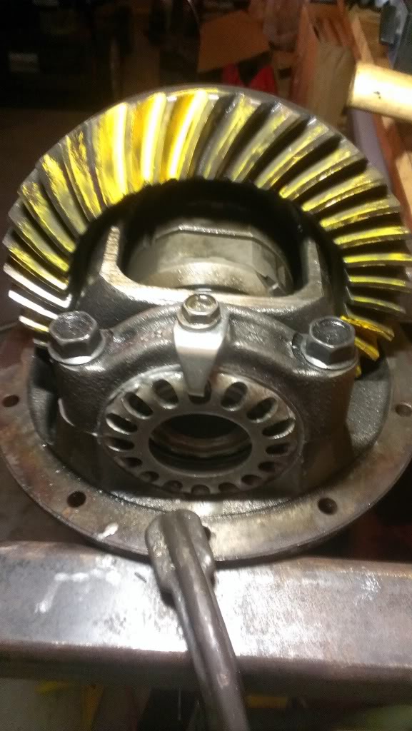

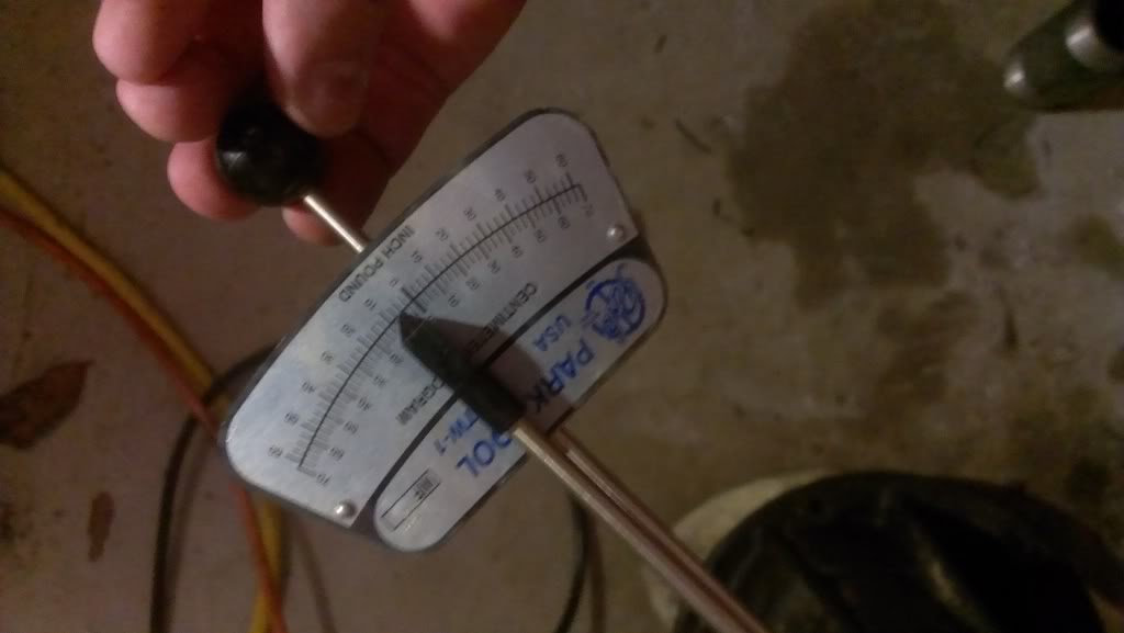

Ok, so I finished up the diff the other night. Where I last left off was the pinion shim stack was around .074, giving me a slightly deep pattern which Zuk approved of. So the next thing to do is to remove the carrier, put the pinion seal in and button that end of it up. Well I did that, and I did not like my preload. It seemed like once I cranked the pinion nut down, the preload was WAYY too much, like 30 in-lbs. This did not seem right to me. So I removed the pinion seal (now garbage), pressed out the pinion, added shims to the spacer. I must have done this 3 times before I got smart and measured the crush sleeve that was in there. I had to add about .060 worth of shims to the solid spacer to get right near that crush sleeve length. With that, the pre-load was a nice 5 in-lbs...

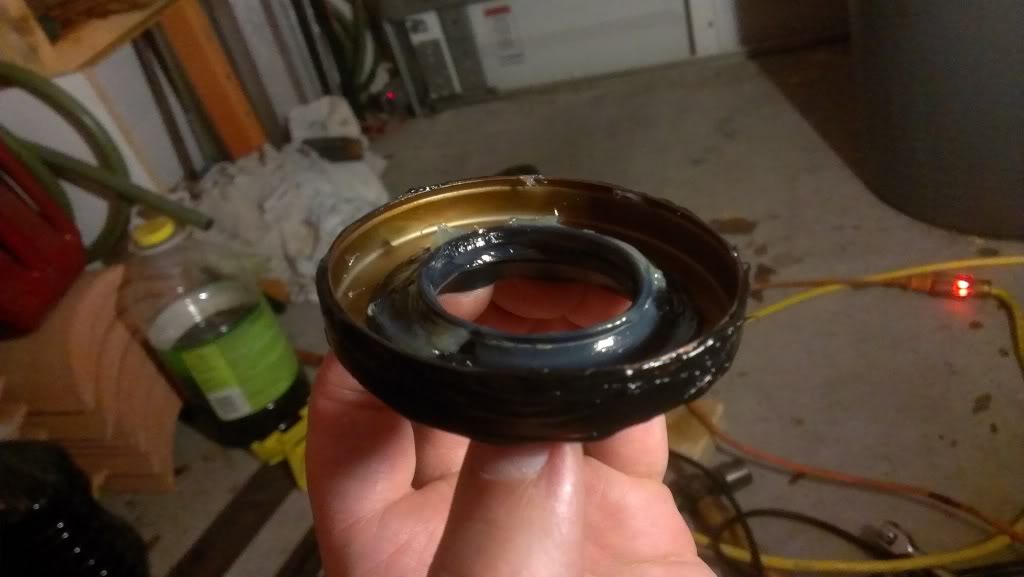

So I took off the nut one more time, put the splash guard in, loaded up the new seal with grease on that inner spring, and some RTV around the edge

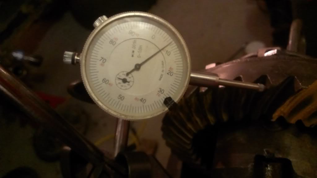

I put the flange on and cranked the pinion nut (red loctited) with the impact as much as it would go. Preload is nice and easy to turn by hand. Next I put the diff back in my little holder and loaded up the carrier as I've now done like 4 times. Set my backlash to .007, and checked it in 4 places around the ring gear.

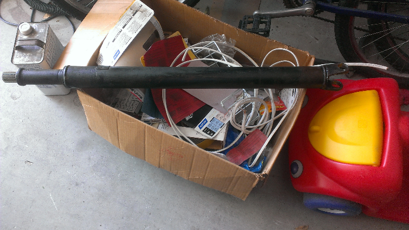

Waiting for my bearing tool, so yesterday I did that start relay fix. Today I cleaned up my driveshaft, I wire brushed it and used mineral spirits on it. Tomorrow I plan to paint it black and then install the new ujoint.
