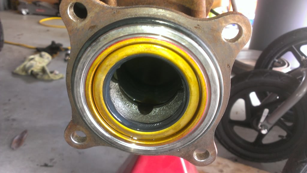

Just going thru your thread and it may be the way the picture is showing, but is the end of your drive shaft yoke flared and that is possibly the reason the U-joint come out? It may just be the picture, but thought I would mention it to you.
The axle bearing tool looks like it is a well made tool.

Terry - I'll take a look when I get home, I hope it's not flared out...actually thinking about it, the ujoint came loose on the part that bolts to the differential, the end in that pic still had the ujoint in it and the c-clips were there and the ujoint caps seemed to fit in there fine. I took the ujoint out right before I cleaned it up, so I'm hoping it's just an optical illusion in the picture.
And yeah that bearing tool is pretty nice, fits in my press nicely and I love that it screws apart from the flat plate, that makes it easier to get into the press.

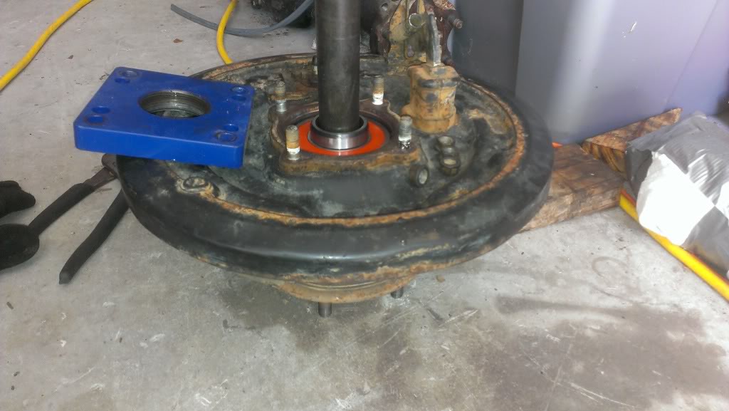

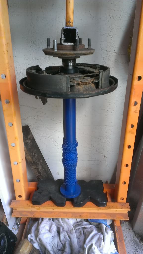

Dragon - the tool was $125 plus $31.50 shipping on ebay.
Spent a few hours working on things today. First up, I had to grind all the paint and a good bit of material off the inner surface of the tool's tube and a bit of the lower threads on the plate. The axle bearing retainer was hitting the threads on the hole in the plate.
Once I ground both pieces, I was able to bolt the plate down to the backing plate, put the whole thing into the press and screw the tube on. Took a lot of force from that press, but finally I heard a pop and the axle started easing its way out.
I didn't take a whole lot of pics of the removal, once the axle is free from the backing plate, you remove the old outer axle seal and tap the bearing out of the backing plate.
Here's a shot of the new bearing (I pressed it into the backing plate) with the retainer just sitting on the shoulder of the axle.

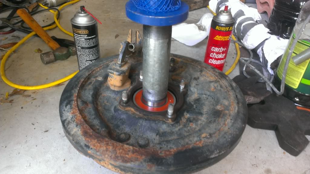

I used the tool in reverse to press the axle back into the backing plate. You can just kindof see the new outer axle seal in there between the axle flange and the backing plate.

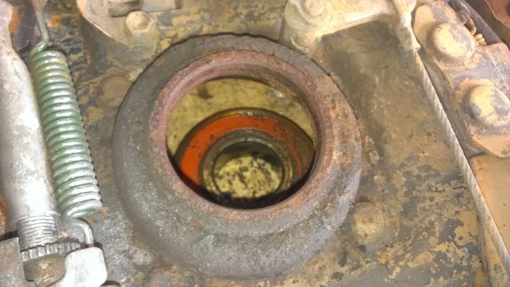

I pressed it like you see in the pic, then pulled it out to see if I was far enough to get the c clip on...
Nope, not quite, so then I slid a short piece of 1.5in pipe onto the axle right over the bearing retainer, then slid the tube part of the tool backwards onto the axle until it rested on the pipe, and then loaded that into the press and pressed it the rest of the way on.

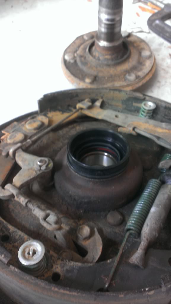

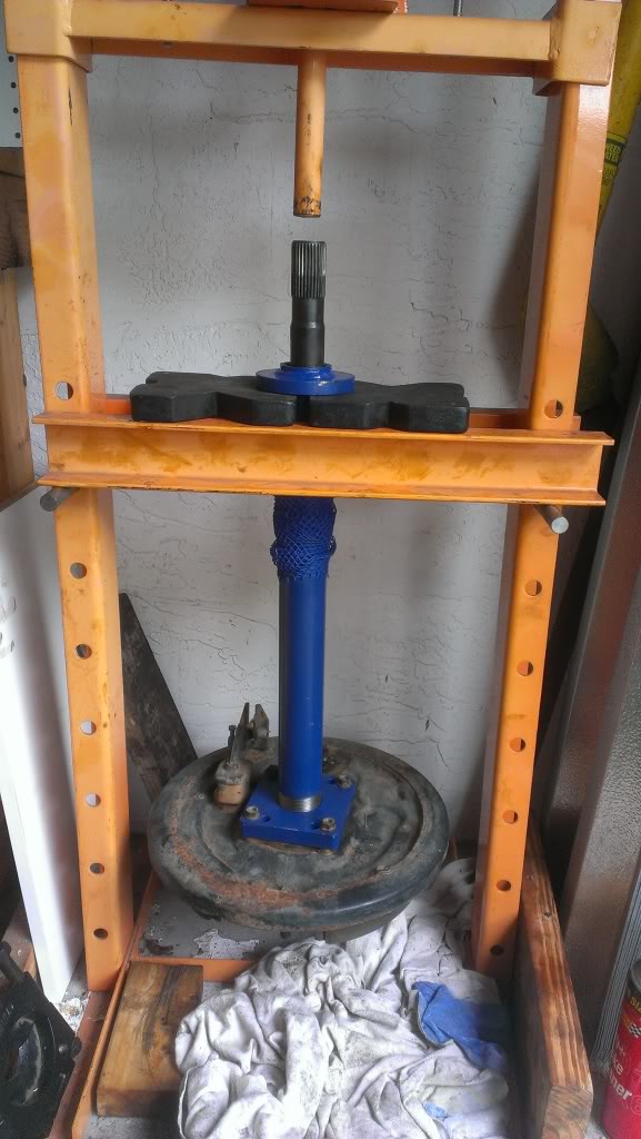

On with the pics. I finished the other side axle bearing today, it was MUCH easier the 2nd time. Here is a pic of the axle and tool all ready for pressing off the bearing.
Once you hear the big POP and you get the bearing and retainer off, you just tap the old bearing out of the backing plate.

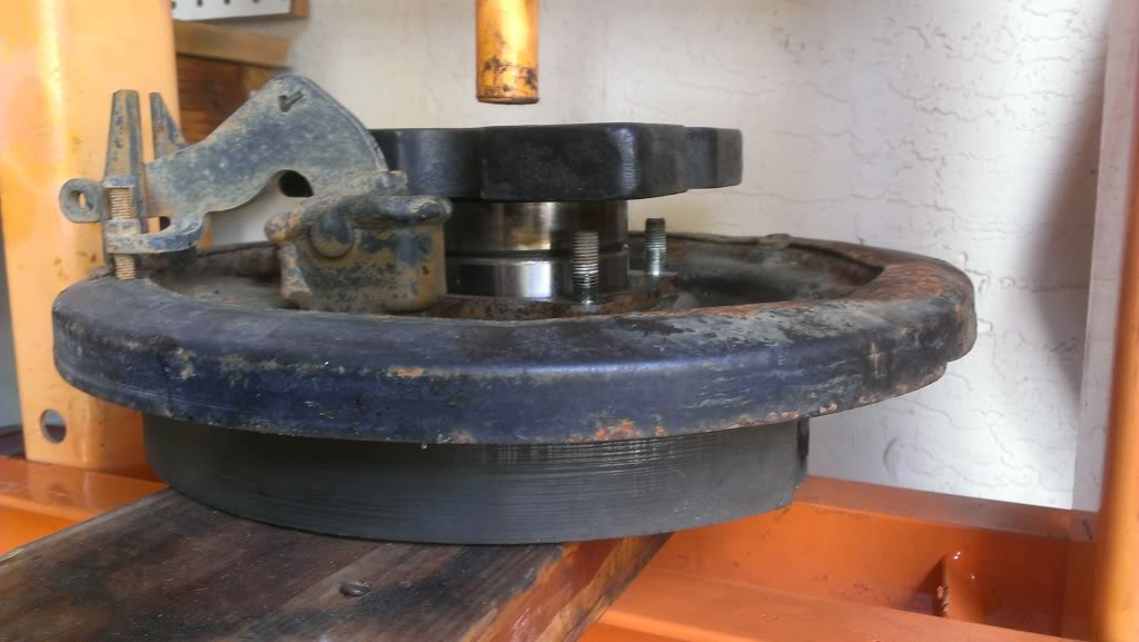

Here I am pressing the new bearing back into the backing plate, using the old bearing to press on it.

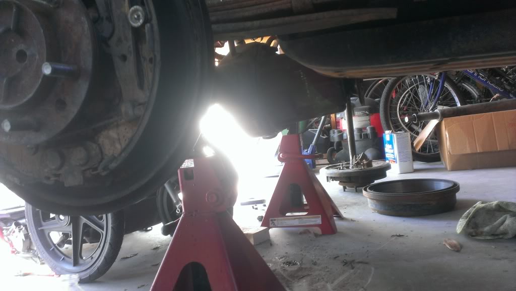

Took the truck on its maiden voyage yesterday to get gas for the lawn mower. Put my son's car seat in so he could go along. The TG break in procedure for new gears is to drive it for 20 to 30 minutes, then let them cool for at least 2 hours. Change gear oil in 500 miles.
I'm at 183,500 right now. Drove the truck to work this morning and I'm very happy so far. The gears seem quiet, at least I can't hear them over the roar of my BFG MTs. Also, I'm loving Ray's starter relay mod, I feel so confident that it will start every time.
