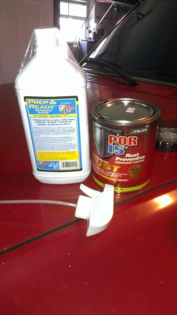

Got my por15 from Eastwood yesterday. Tracking said it left Pennsylvania Tuesday morning and it was here at my house on Wednesday morning. Very impressed with Eastwood.
Hope to get this done this weekend. Happy 4th to everyone...

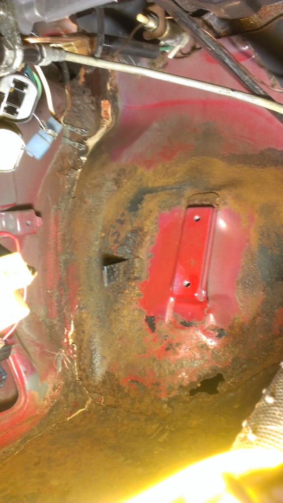

Been trying to get into the garage for weeks and it just hasn't worked. But last night I put my 2yr to bed and got out there for nearly an hour. I got most of the wires out of my fuse block...just a couple tricky ones left.
Taking the fuse block out serves 2 purposes, I can get up in there with the por15 and I can replace the panel with the one Terry sent me to fix that melted EFI terminal.

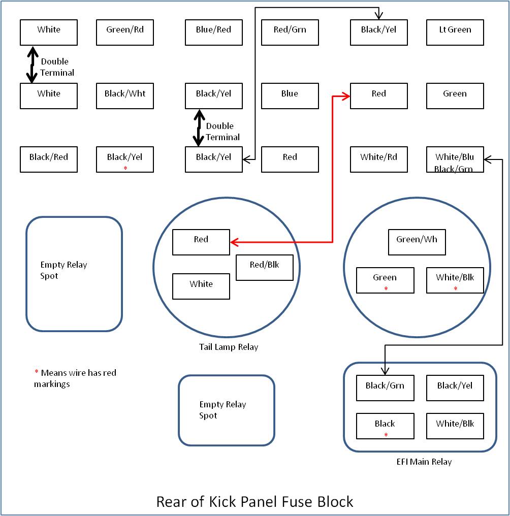

I don't mind it too much, I made a diagram when I took apart the harness Terry sent me...so far everything but 1 wire matches exactly between Terry's harness and mine.
Here's my diagram

Thanks Dragon. Got a little time this evening also. Fuse block is now out and I started to clean up the flaky rust. Found a hole forming in the floor I didn't even know about.
Got some more wire brushing to do before the por15 goes on.

i had a small hole there myself i ground it off and some of the pinch weld packed it with duraglass then primer an undercoat (several layers)

Speaking of the rust...went out there last night and finished scraping and wire brushing. I vac'd all the loose stuff up , and sprayed some degreaser on and wiped everything down. I then hit the areas with the POR15 metal prep spray. I wet it all pretty good, then went inside for 15min to let it soak. Came back out and re-wet the areas and let them soak for another 15min or so. Then rinsed with water and towel tried it. The directions say to let it completely dry before putting on the por15 paint, so I'll do that tonight or tomorrow night.
I will say that the por15 metal prep seems to be some good stuff. First of all it has a strong smell, much more so that the Evapo-Rust. Also, the rust seems to have turned black very quick, seems like it took longer with the Evapo-Rust. Anyway, hopefully the por15 will attach itself well.
