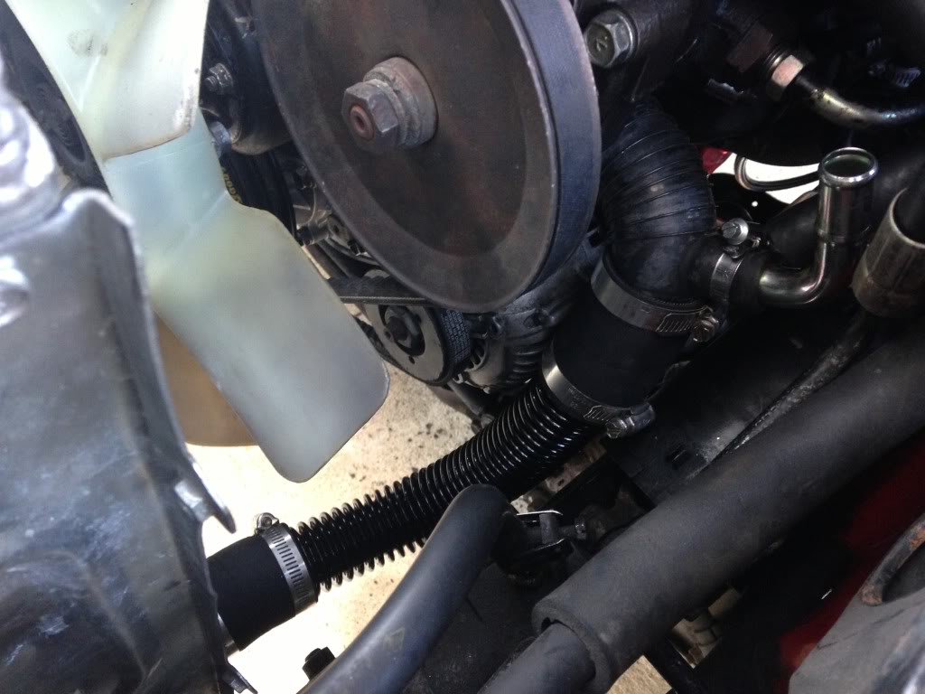

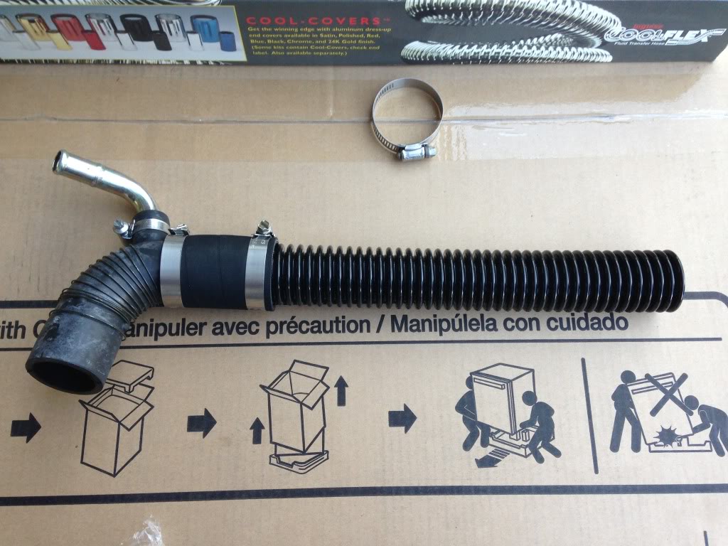

It may not hold where it connects to the half hose on the left, so I may have to cut a small piece of the old hardpipe to slip between them for a better solid connection.
Attachment 161902
Attachment 161903

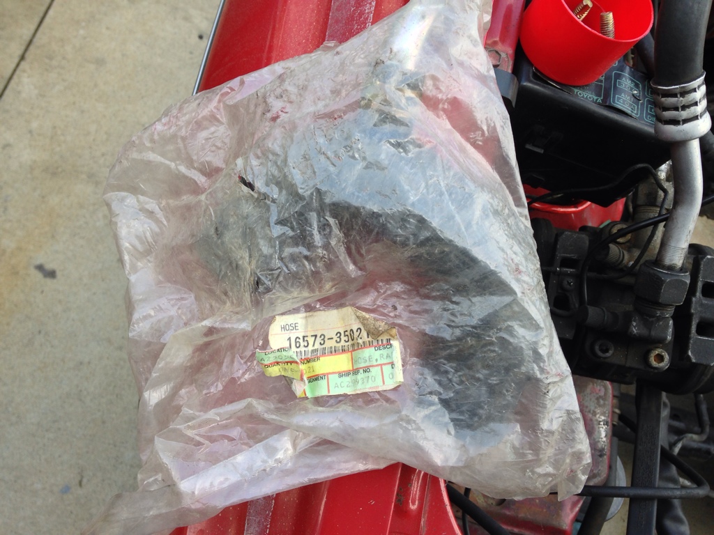

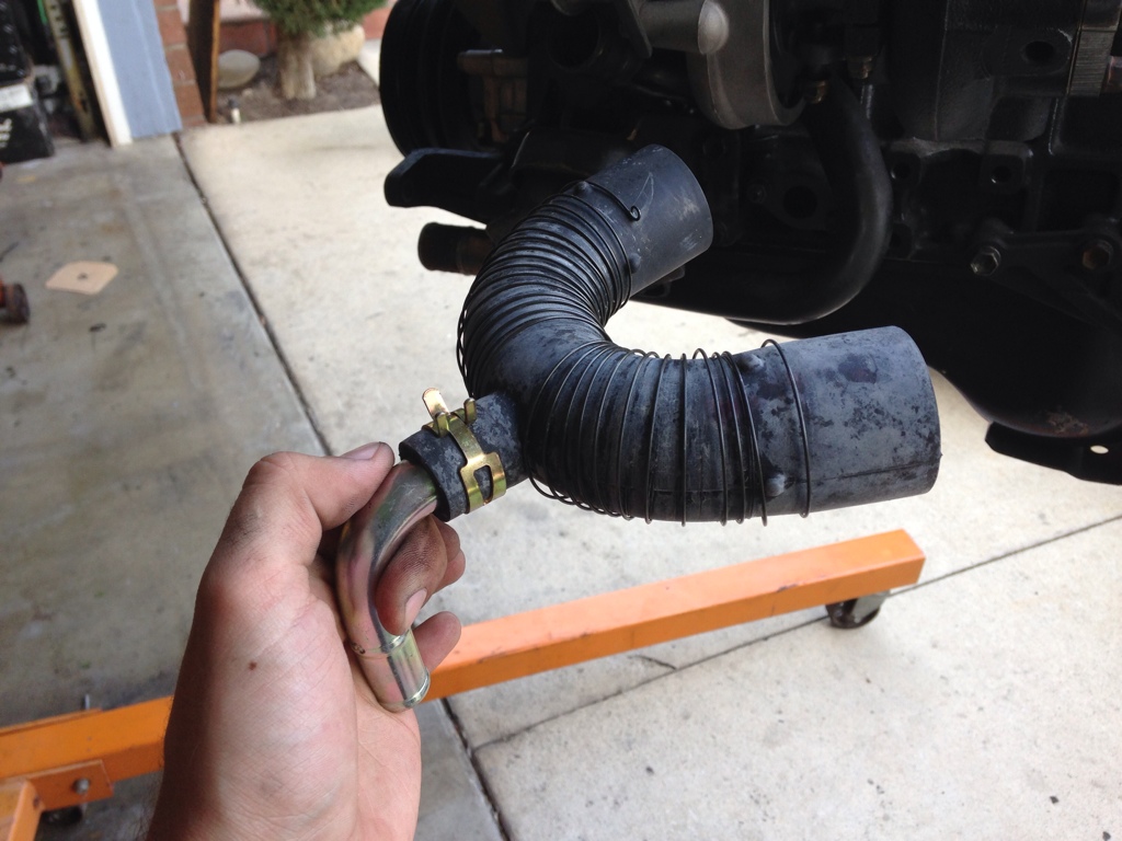

ChildrenOfBodom, long time no talk! Hope you’re doing well. I realize this thread is old, but want to pick your brain.
I recently purchased a bone stock ‘86 Turbo 4Runner. 3 days in, the oem hose (pictured above) on mine burst. Fortunately I was in a parking lot 4 miles from home when it blew, so not bad. After a quick tow home, I pulled it out to find it needs replacing as it looks original. However, what I thought would be a simple replacement, has since turned into much more. That hose has been discontinued from Toyota and no aftermarket company offers a replacement. Great…
I assume you don’t have any leads on anyone hoarding a stock pile of new old stock of these do you? Or do you have any good ideas for a homemade replacement? I’m thinking about taking a long coolant hose, cutting it in half and inserting some sort of T fitting in between to make everything work properly. Irritating no one makes a replacement hose for this part.
Thoughts?
EDIT:
I no longer need the oem part. I pieced together parts and successfully remade this part. Works great.
