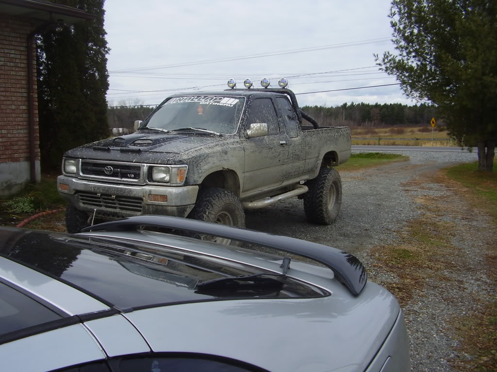

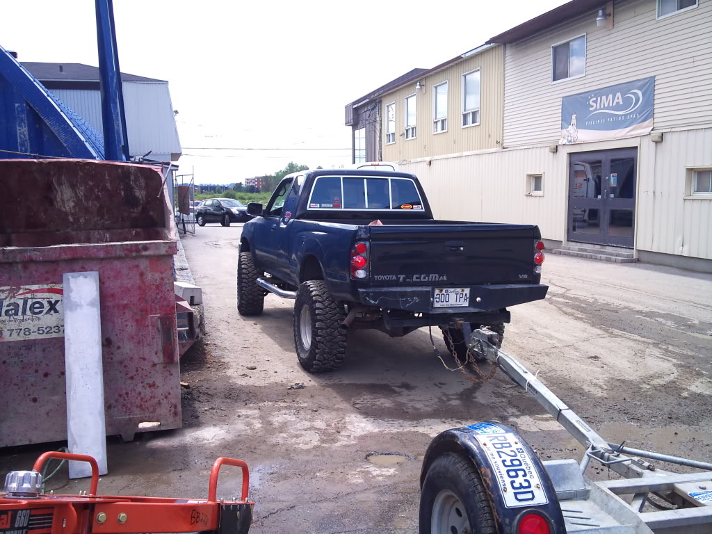

Dont get confused. This is my 93 pickup with a tacoma bed. mine was rooten and couldnt find one in a good shape. So i went with tacoma bed.
The hauler carring the victim

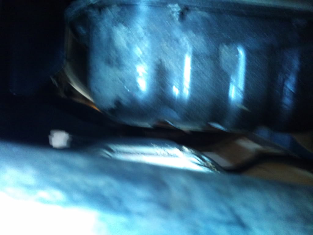

I wanted to repair the oil leak on the Z32 before starting the project. i removed the trans to replace the rear oil seal. The clucth became crap because of the oil. So i needed to buy a new one. More money. And thats a +/- 400hp engine that need a higher clamp load with puck disk. More money. I got tired of spending money into that car. Also, this in the middle of summer when the temp never got that high as i can remember. Got sick of the heat, car problems, etc so I went to the dealer and brought this home.

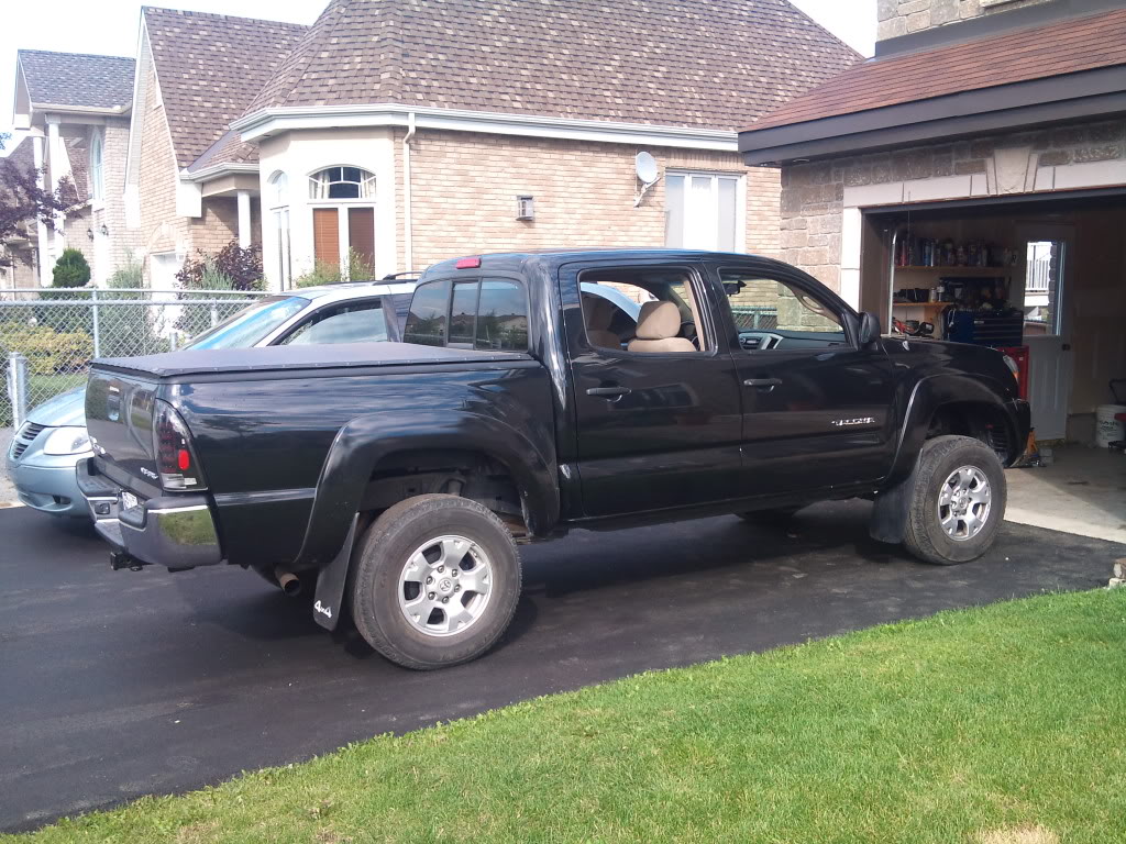

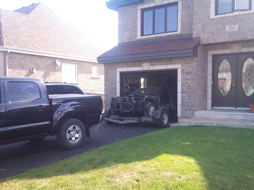

The new hauler. 07 Tacoma loaded with 4.0 and auto.
My confusion between 1uz auto or 5spd ended there. Im keeping the R150f.
The oil in the street is from the car. I know, its bad lol

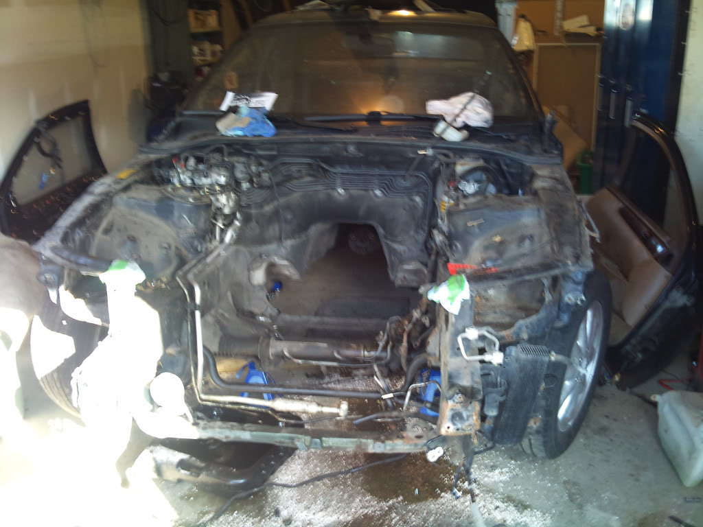

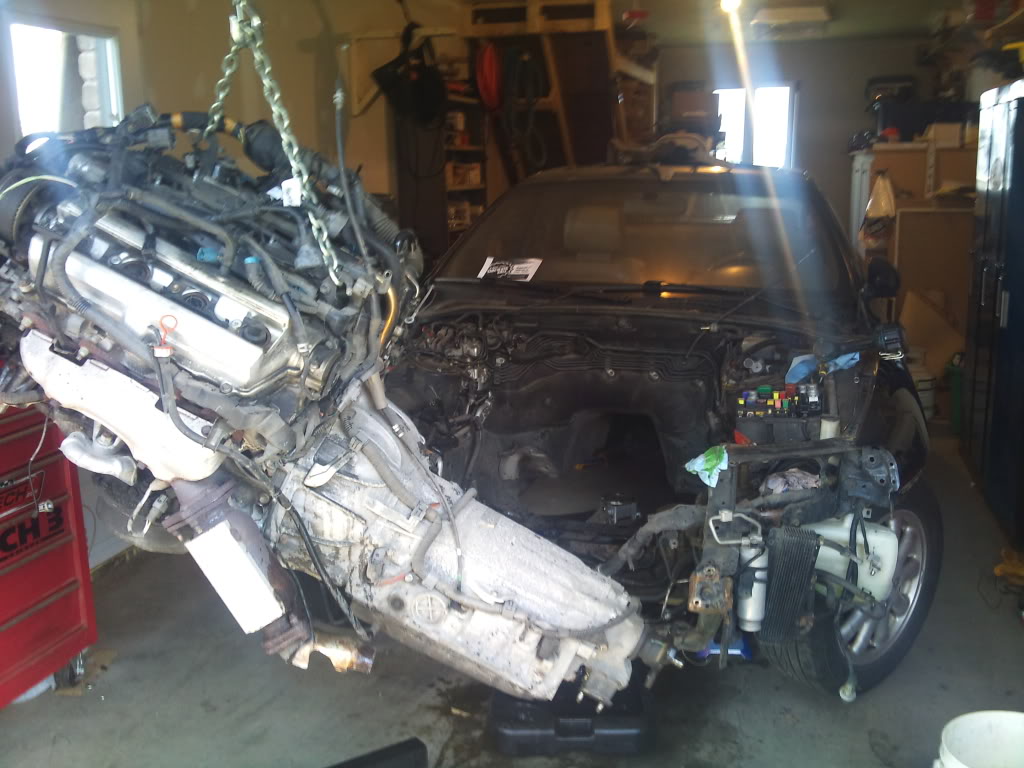

By the end of august, I started to work on the SC400.
I took everything i needed and even more stuff to be sold later.

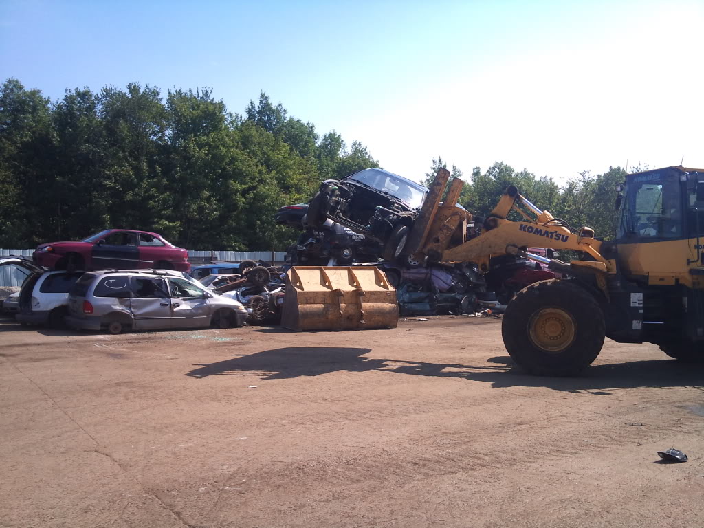

Rented the same hauler to ditch the SC. If I had room for it, I would have kept it.
I think the sc looks better in ''Mad Max'' mode
Farewell !!

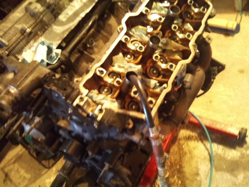

BH from KsRacing in thailand. Got it of E-bay. A1turbo in NewZealand sale one to. But A1's communication was S**t so i chosed Ks. Plus the hole for the pivot fork is on the same side as the R150f (right) compare to A1turbo is on the left. Yota 3.0 dealed with that one. After i bought my BH from Ksracing, they never answered my questions, bearing kit was missing and communication ended to be Sh...Anyway. One or the other will be the same. Price to.

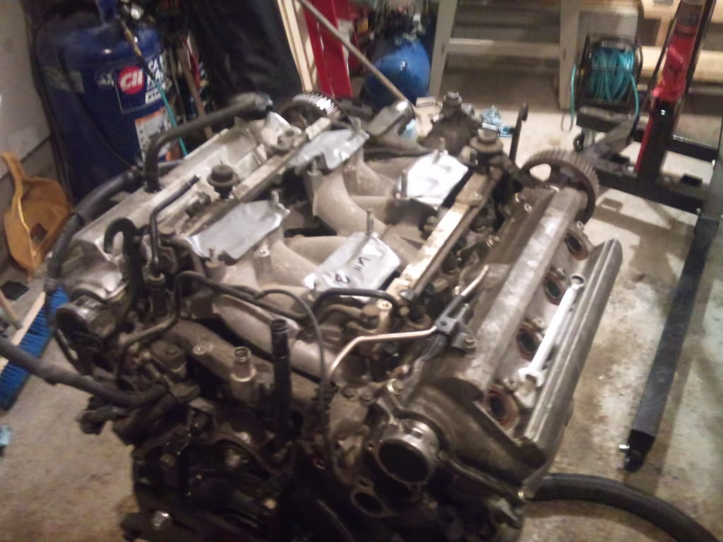

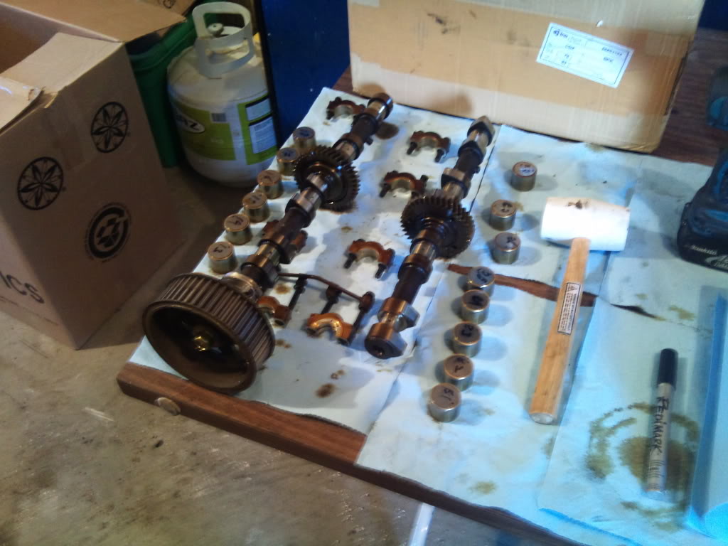

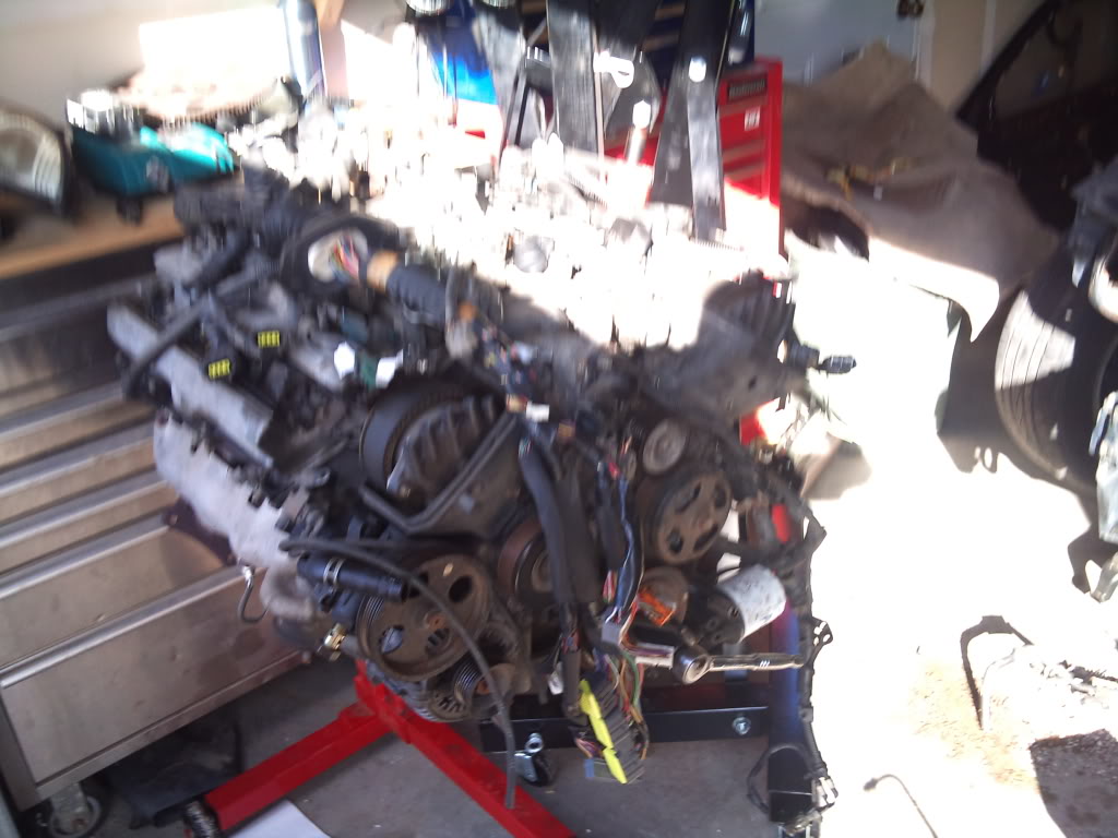

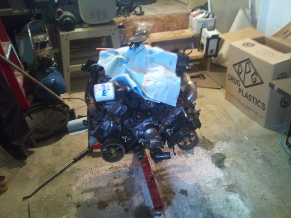

So I started to work on resealing the engine.

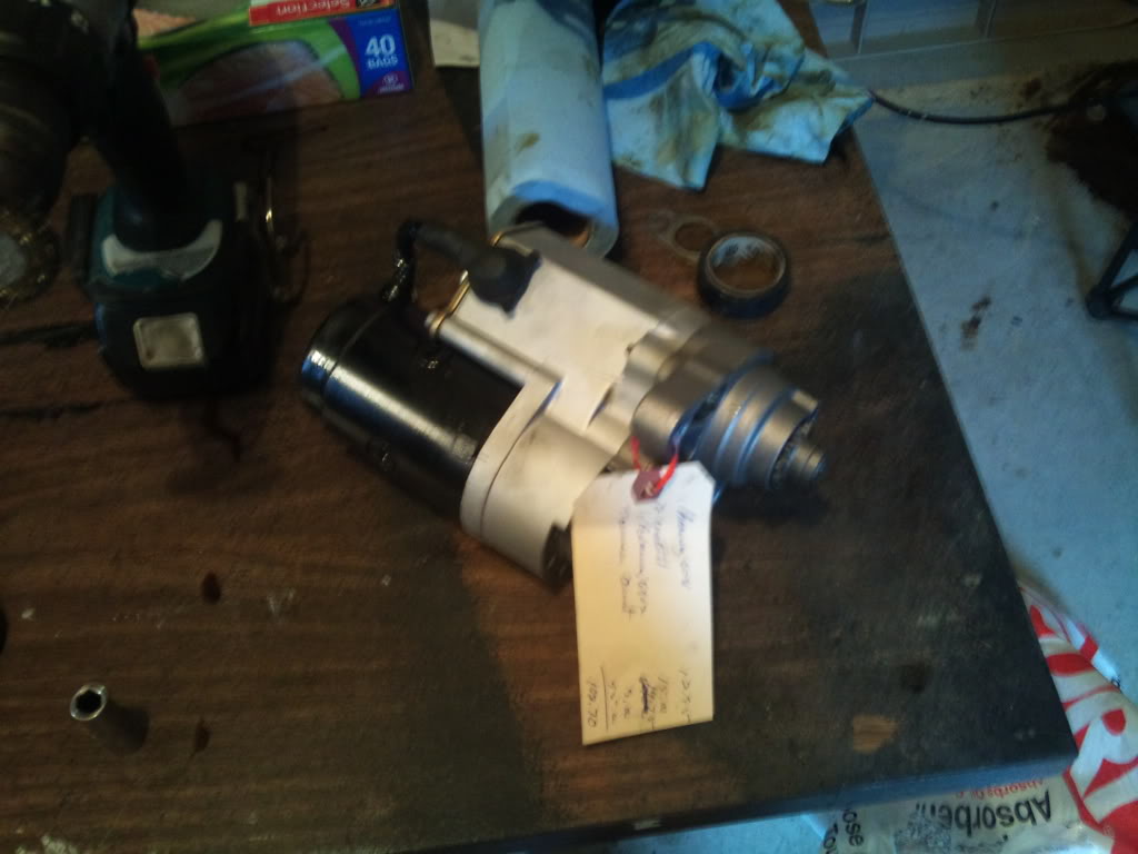

Got my starter rebuilted
It sure was working good but the starter location is a pain in the a..So i dont want to replace it soon.

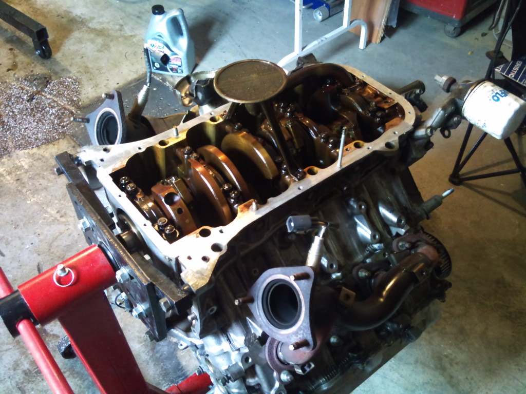

Getting it back into one piece

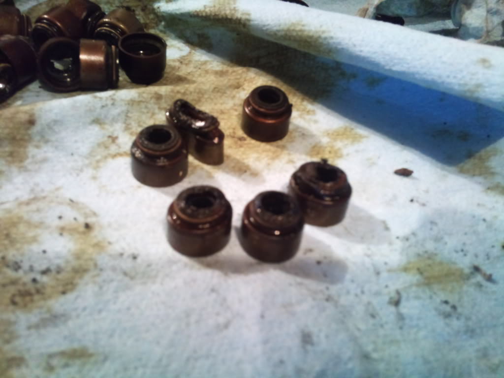

Old valve seals lol

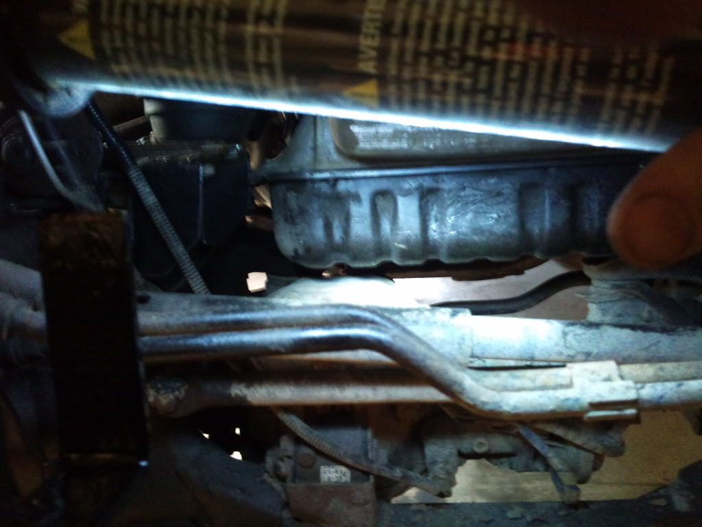

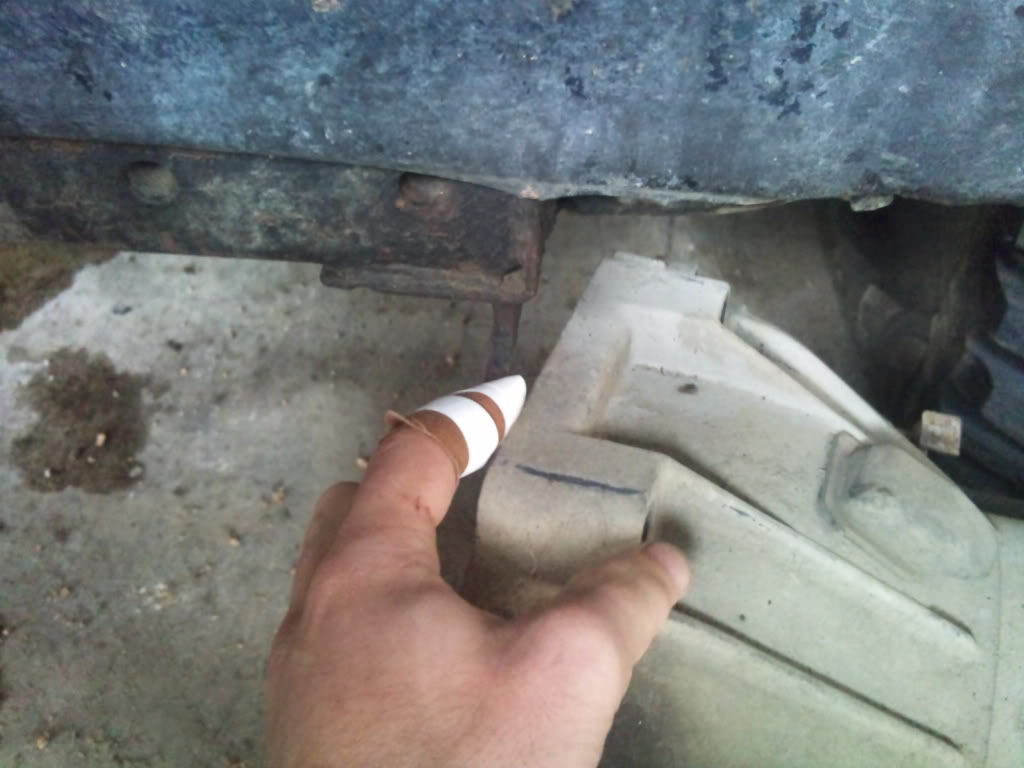

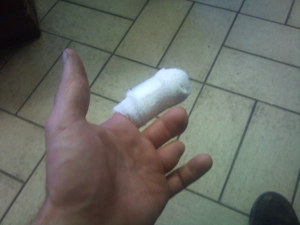

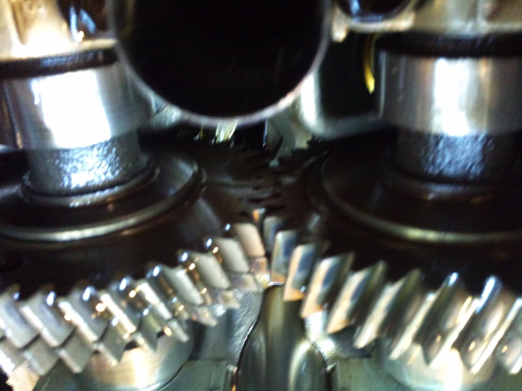

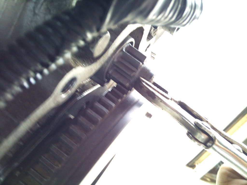

Ok. First speed bump. I have a small garage and space is hard to get. I was slidding the truck trans with case on the ground just to put it just under the front end of the truck. So that way, it will not be in my way and i will be able to work all around the truck. And on the great sliding momentum, Bamm. I hitted the hook.

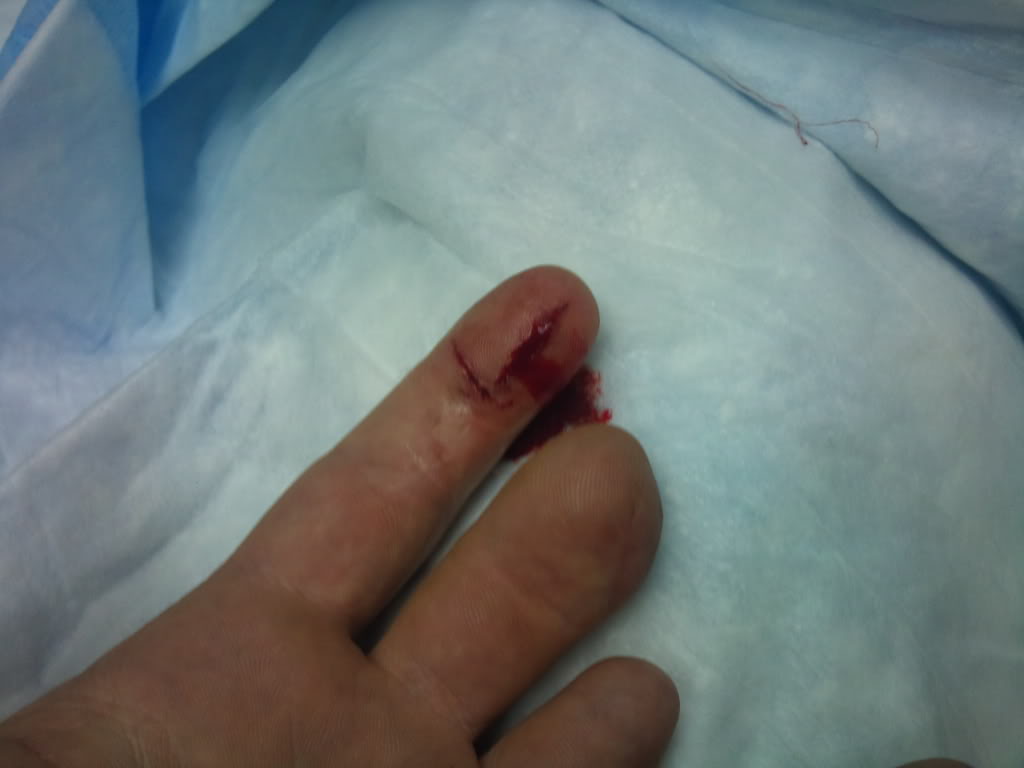

I ended at the hospital to spend a great 9 hours and get 5 stiches. Yay.
Even my pinky finger couldnt get there
Oh yeah, its the index finger. Forget the 2 other ones, they were like that before
This bump a slowed me down for a while. Lite work i guess.

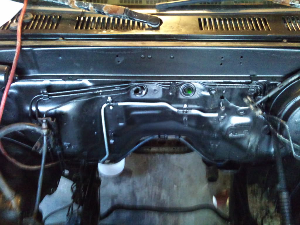

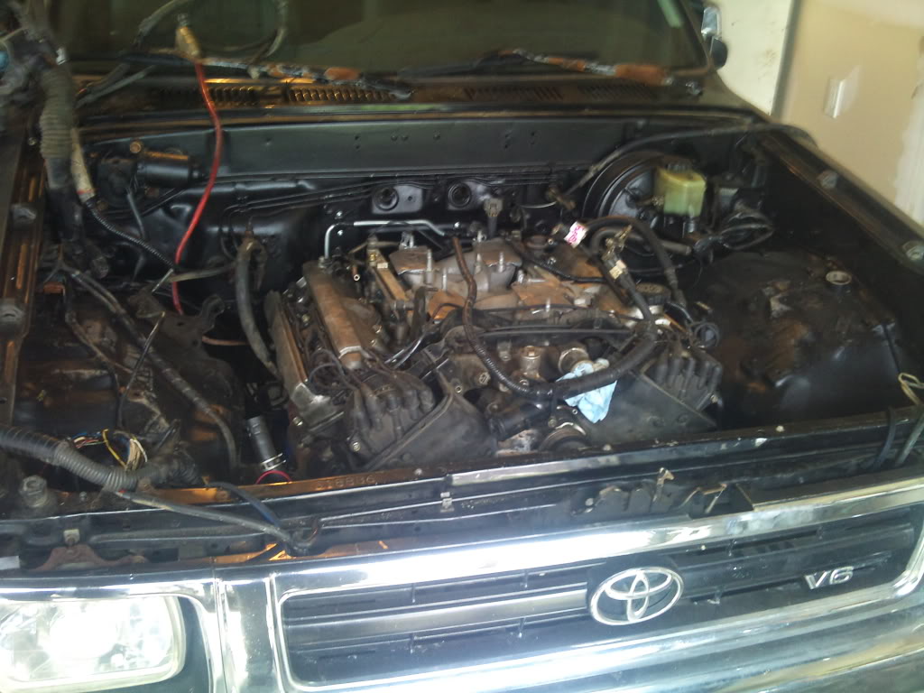

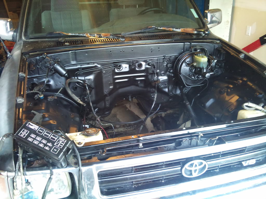

Painted the engine bay
Going down. Trust me, this is not the last one

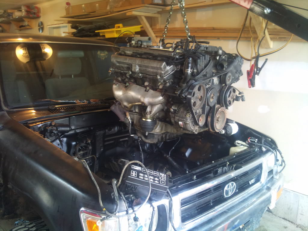

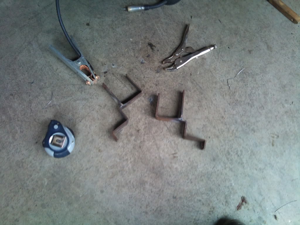

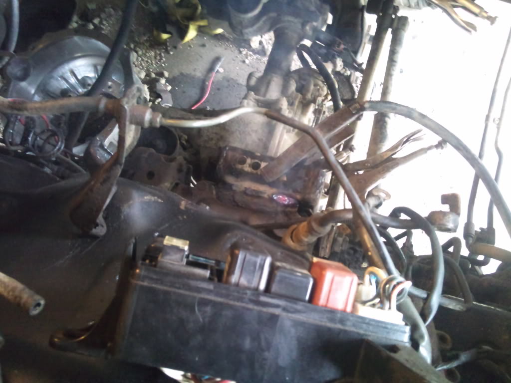

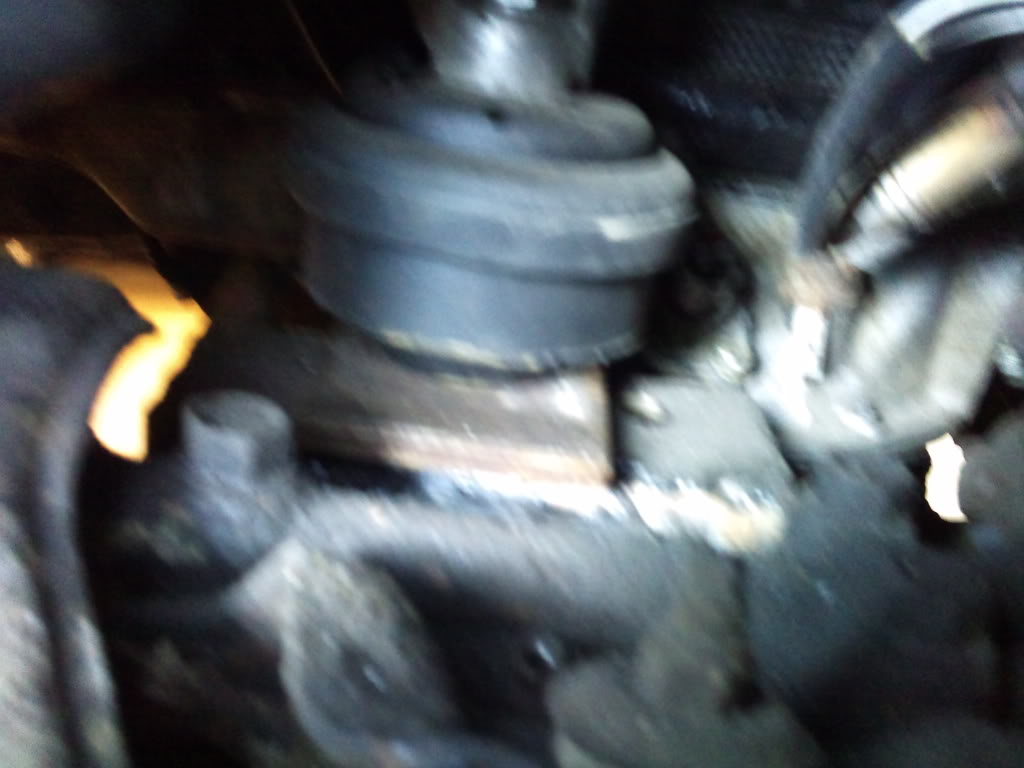

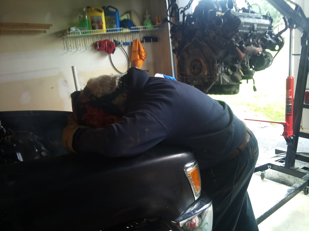

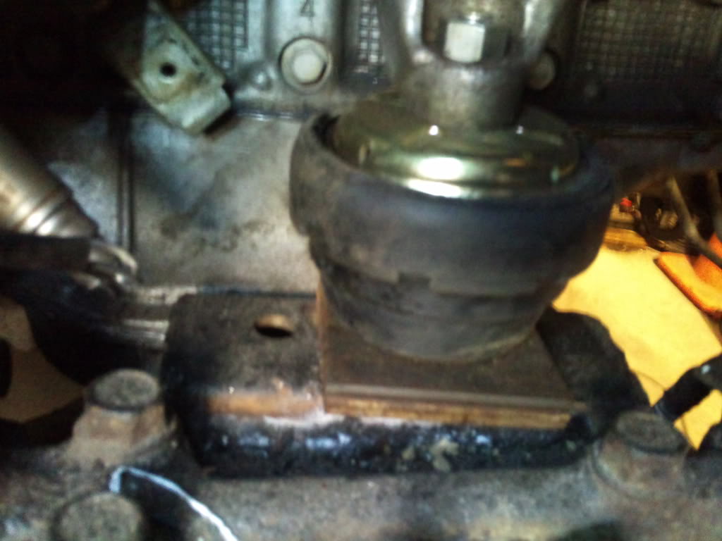

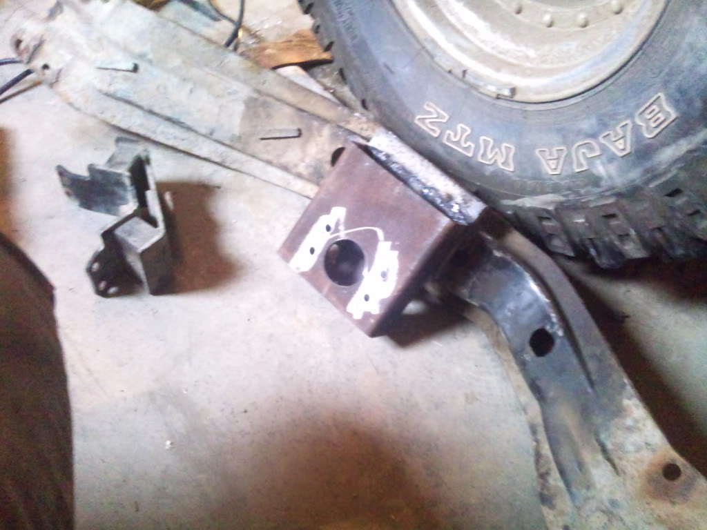

Hired my dad to help me with engine mount
My old man welding for me

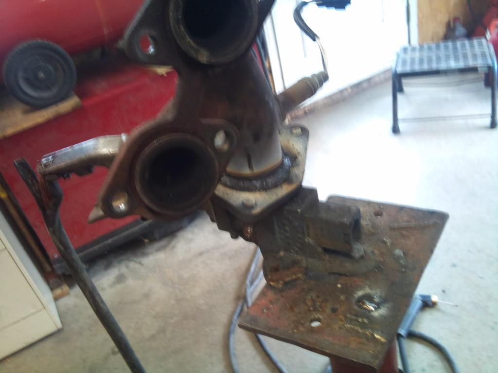

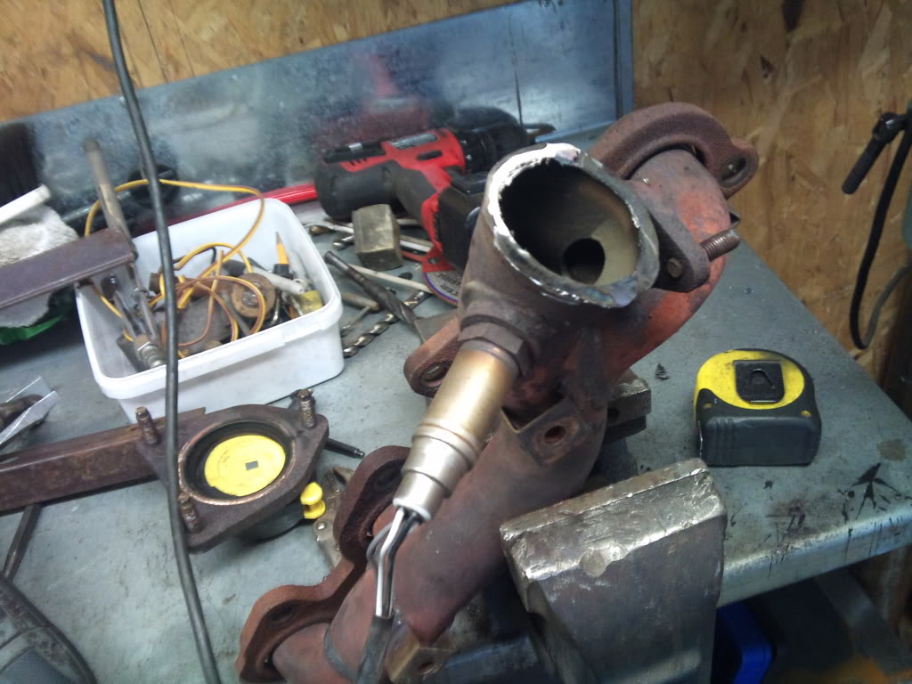

Modified the manifold to make it fit. We just cutted the flange and rewelded it.

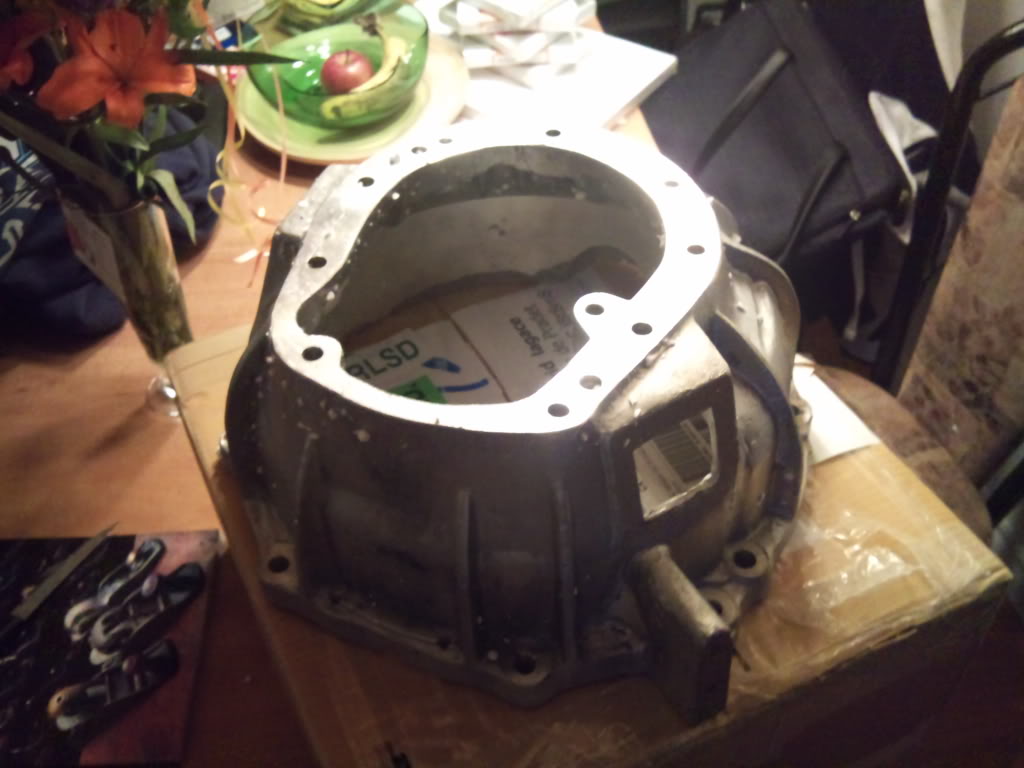

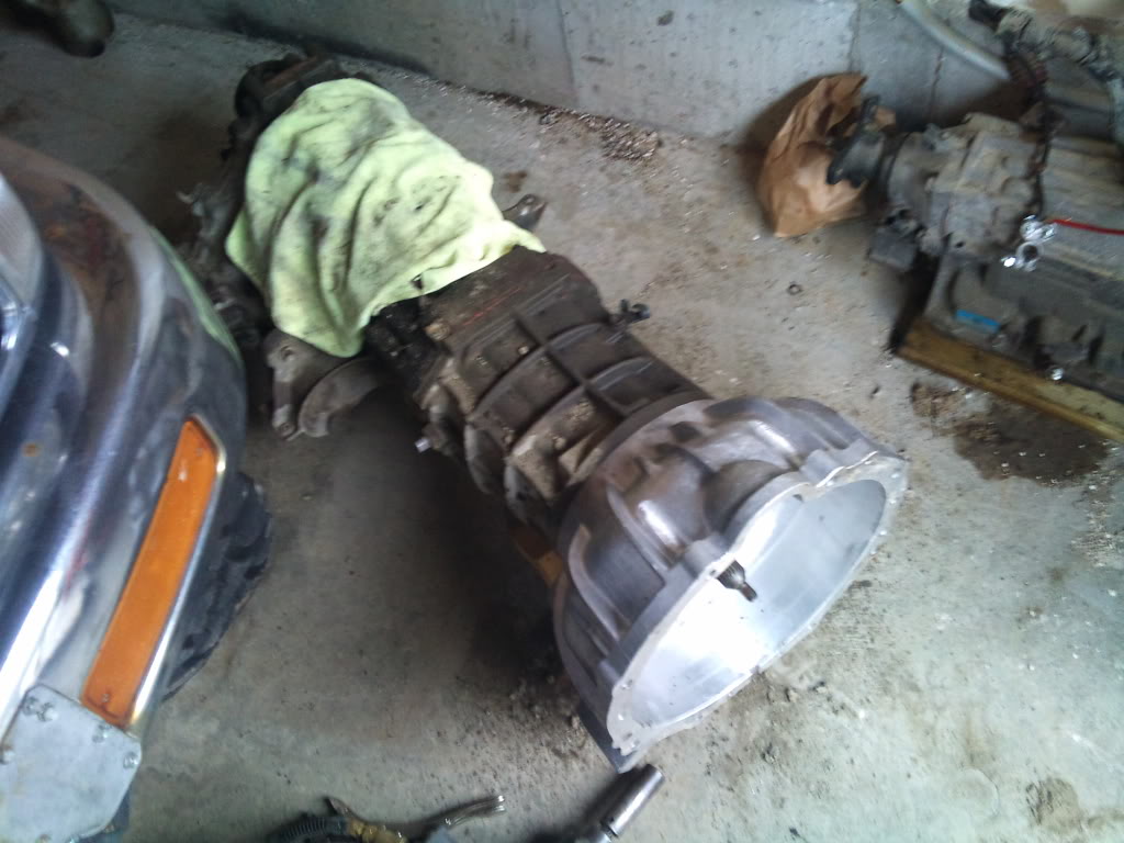

Trans with the shinny bell housing

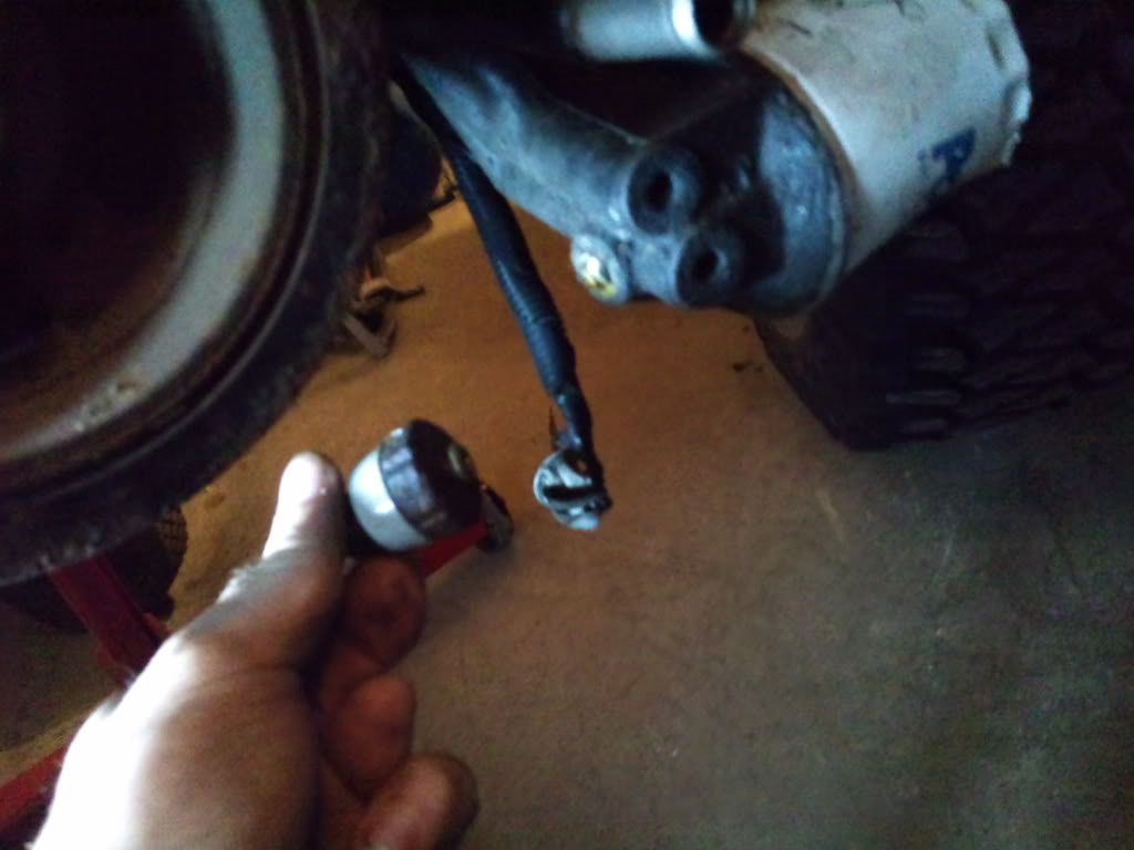

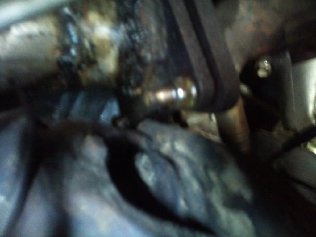

I was removing the sc oil switch to put the 3vz oil press sender and it broke in the braket. Damm

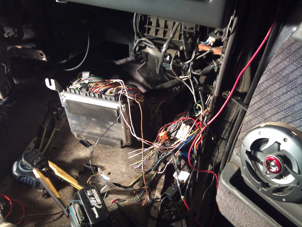

I removed the braket, drilled what was left of the oil switch, put the oil sender from the truck. Went well. Better than I tought.

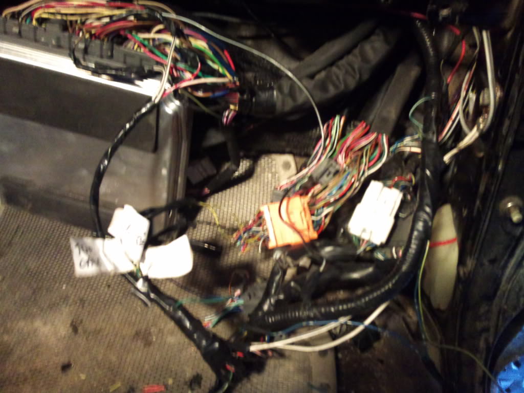

I Have good friends that own a garage. I went into their office and printed both wiring diagram. That saved a lot of trouble

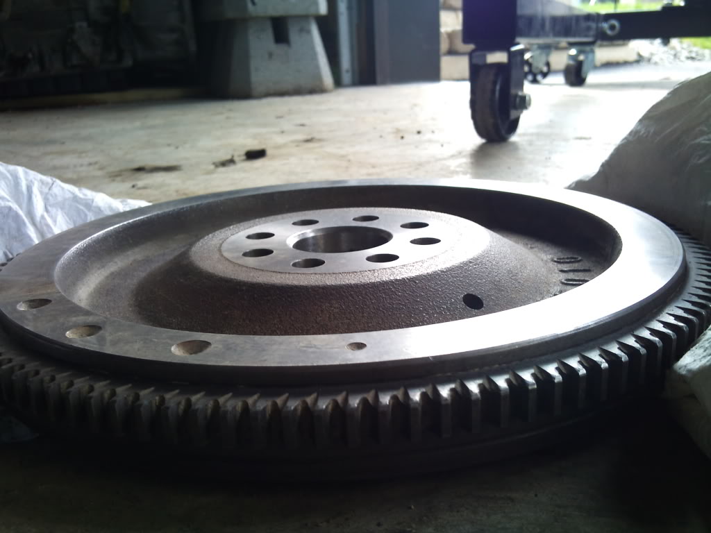

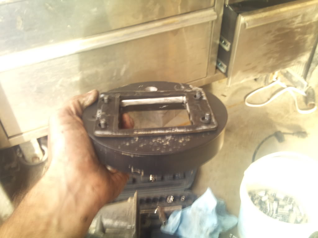

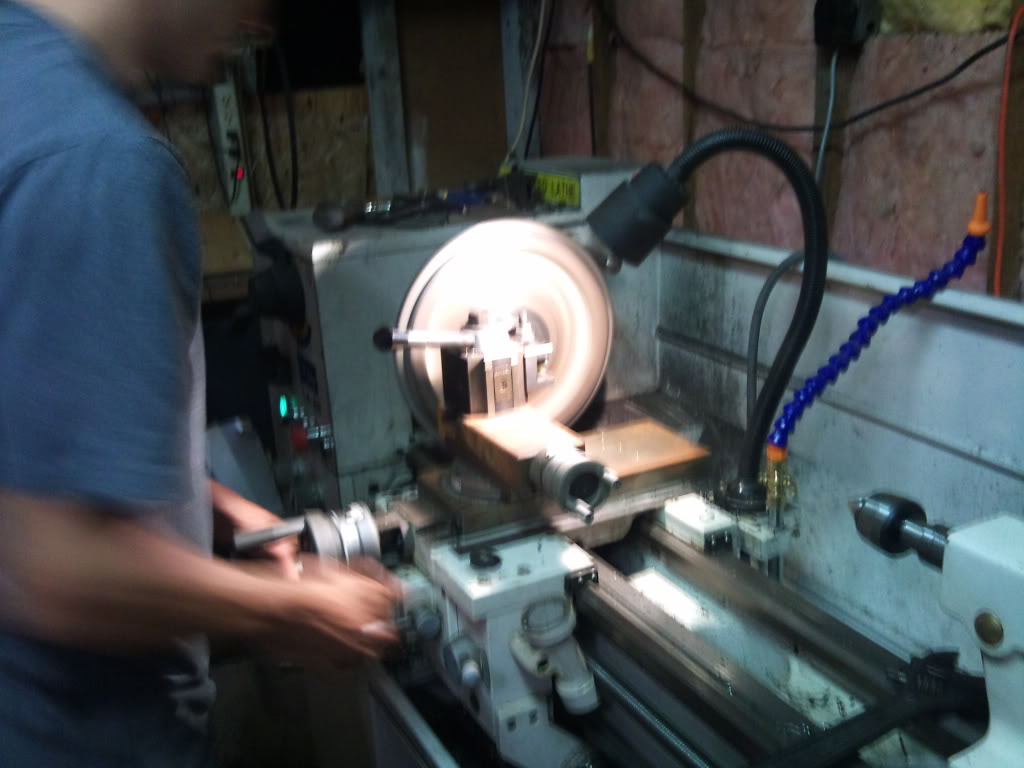

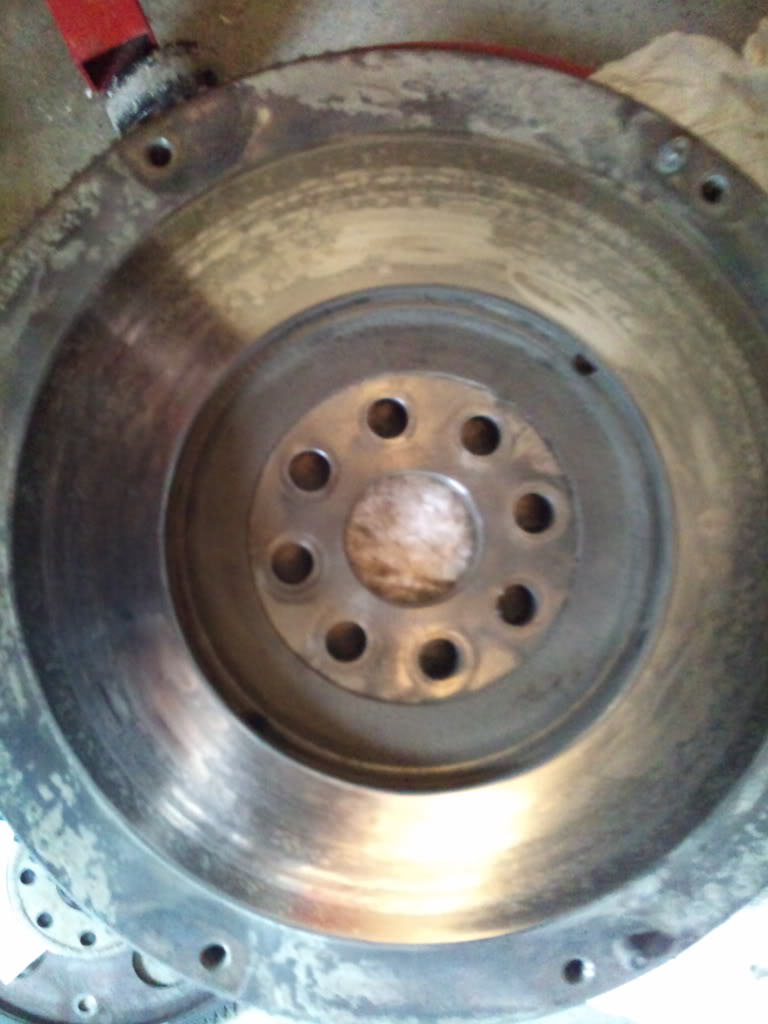

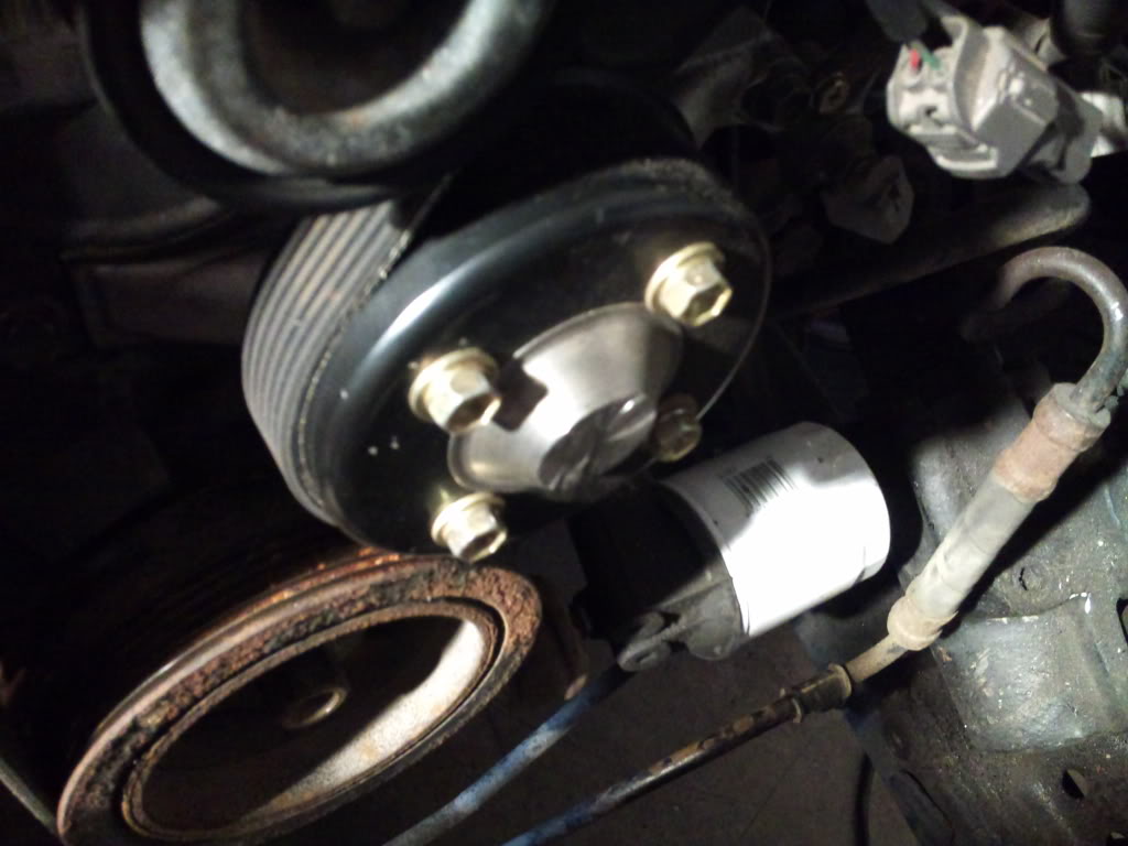

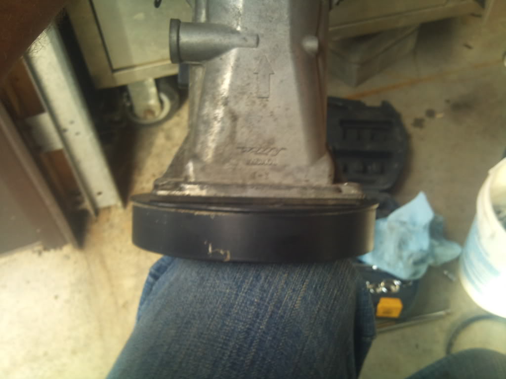

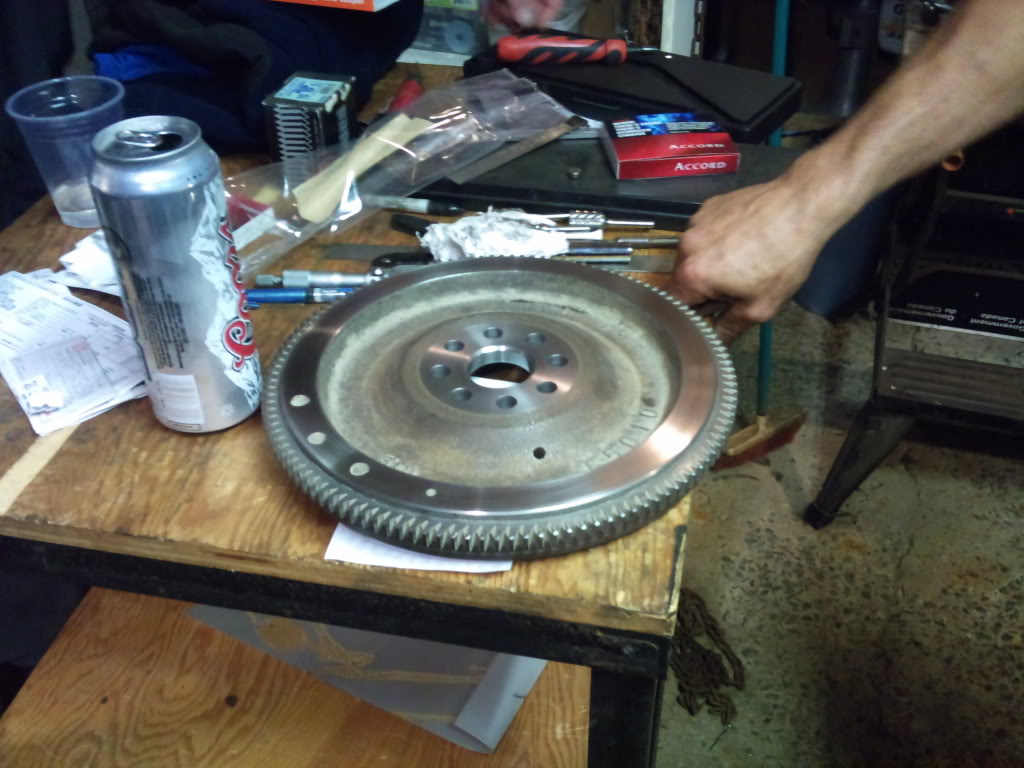

I had the flywheel machined so it would fit the crank.

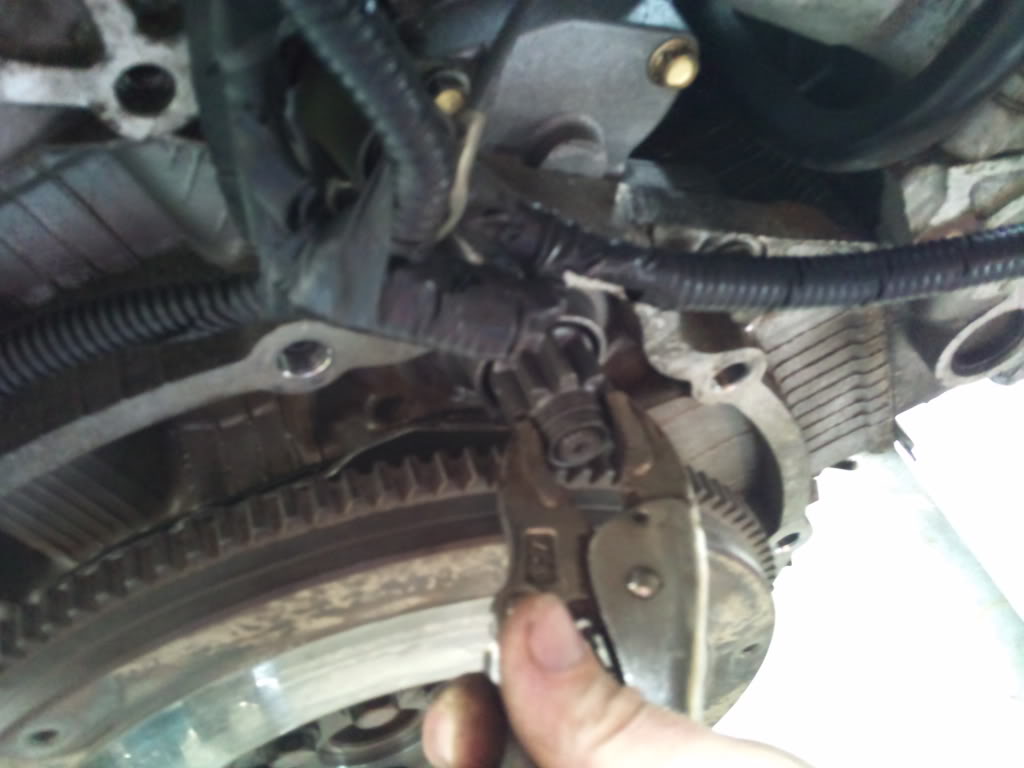

It sure did bolted perfectly but the starter was far from being engaged
This is when i found out that you have to remove about 5/16 from the back of the flywheel. Damm

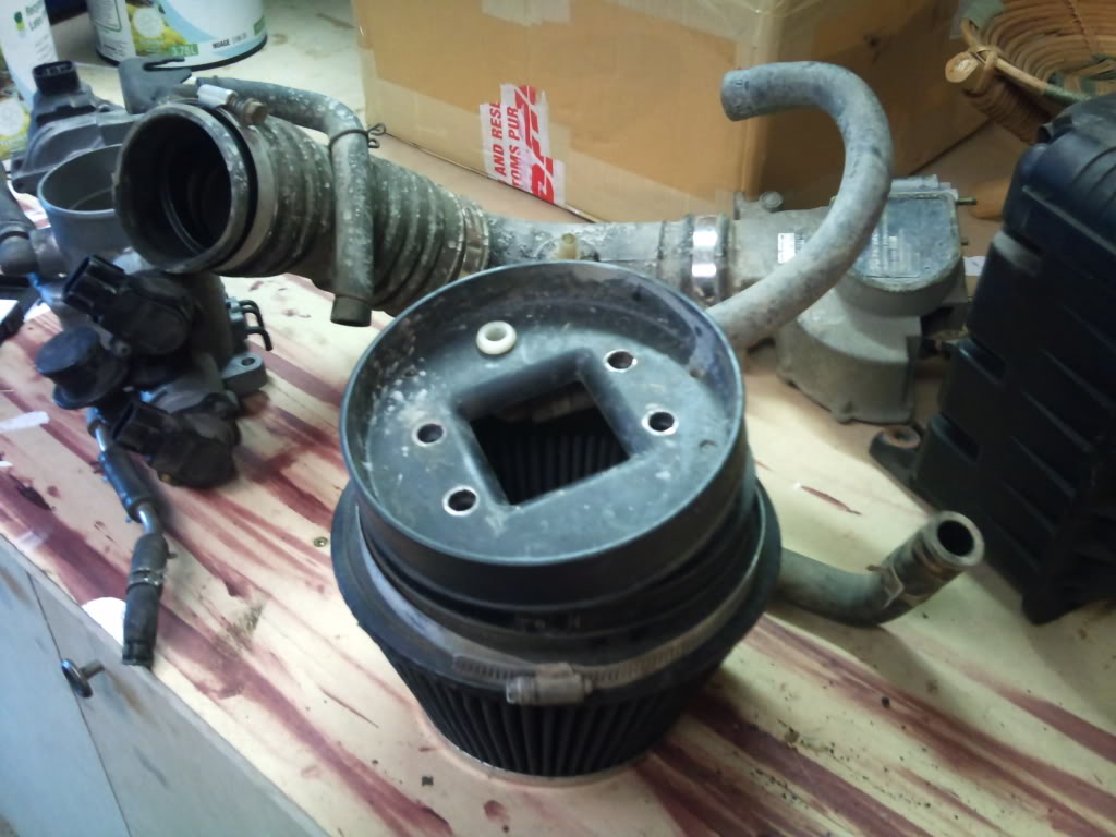

The K&N from the pickup. I will modify it later

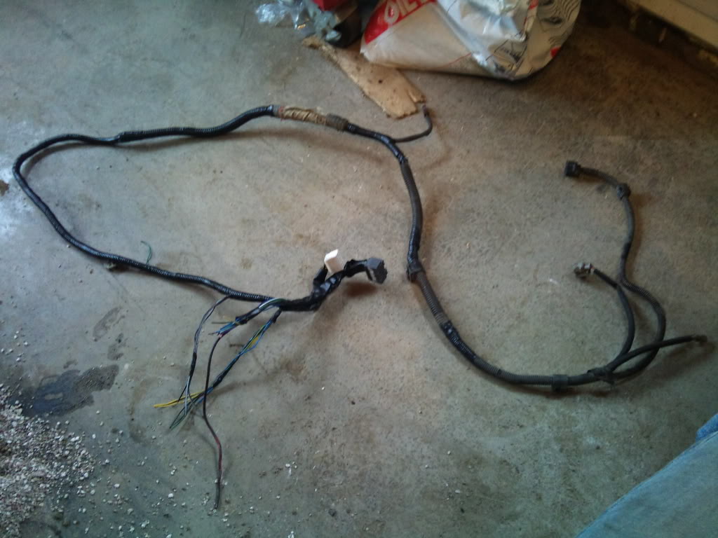

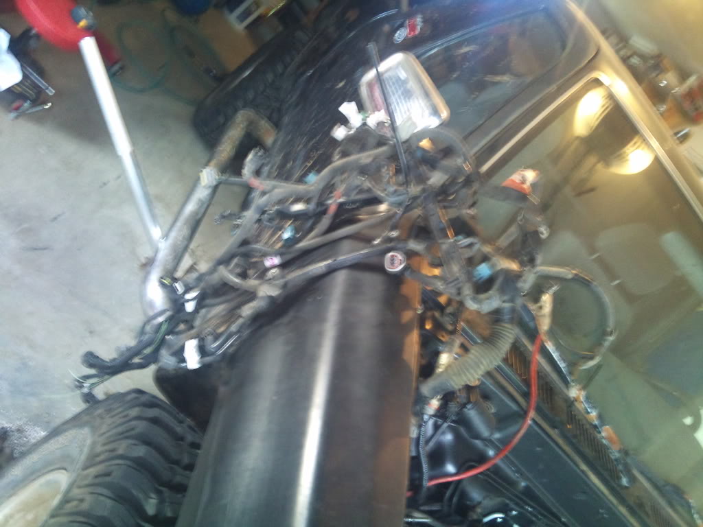

The Transmission harness
Everyting plug into the trans. the other en in the truck. The cutted wires goes to the cluster and some to other like the ADD, Fuel pump etc. I will work on that later.

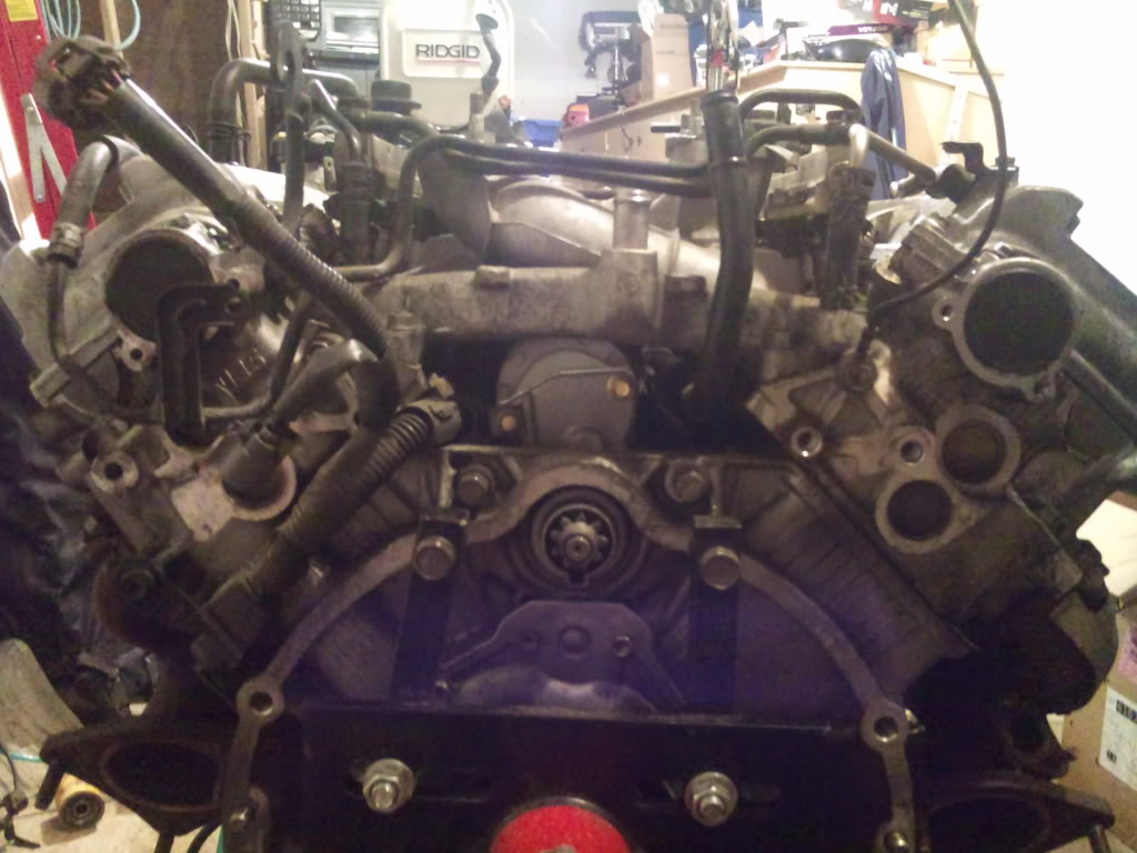

Back to the flywheel

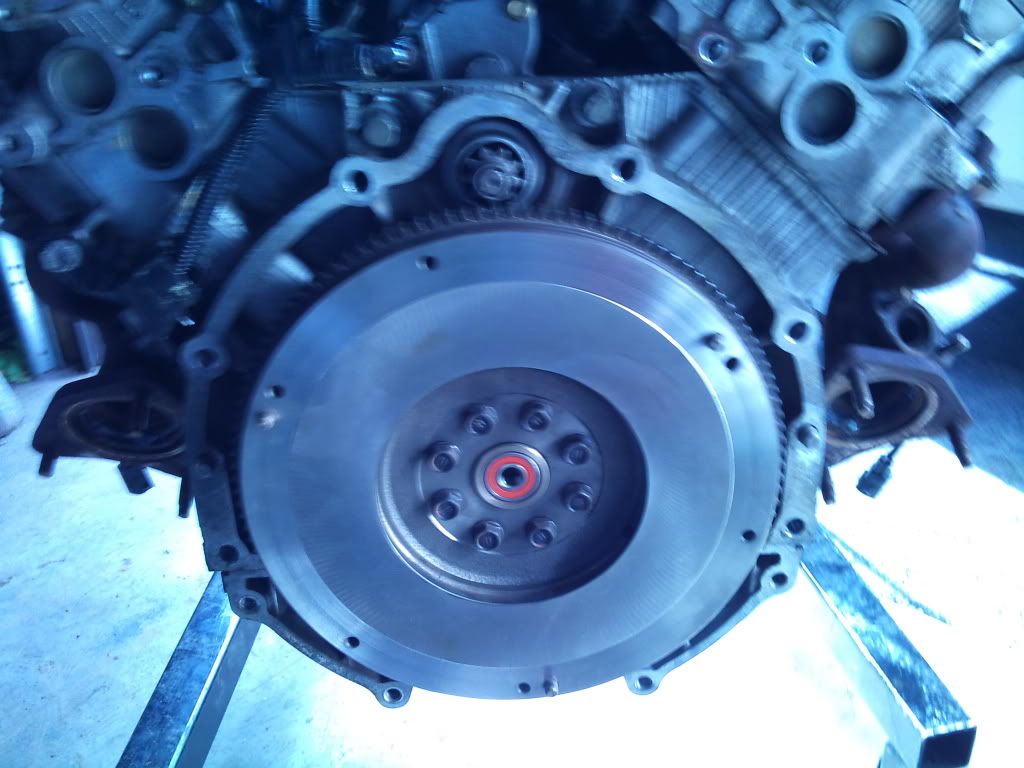

The results (Ignore the big can)
Now thats better
Freshly shaved

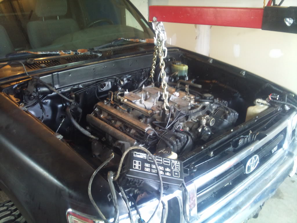

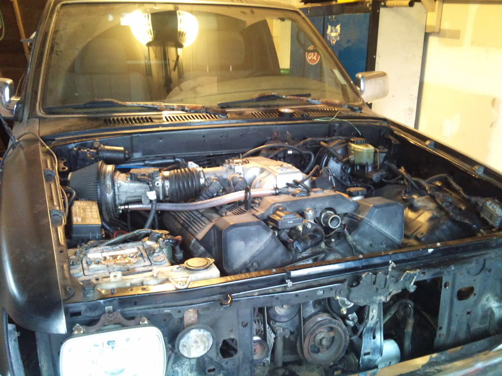

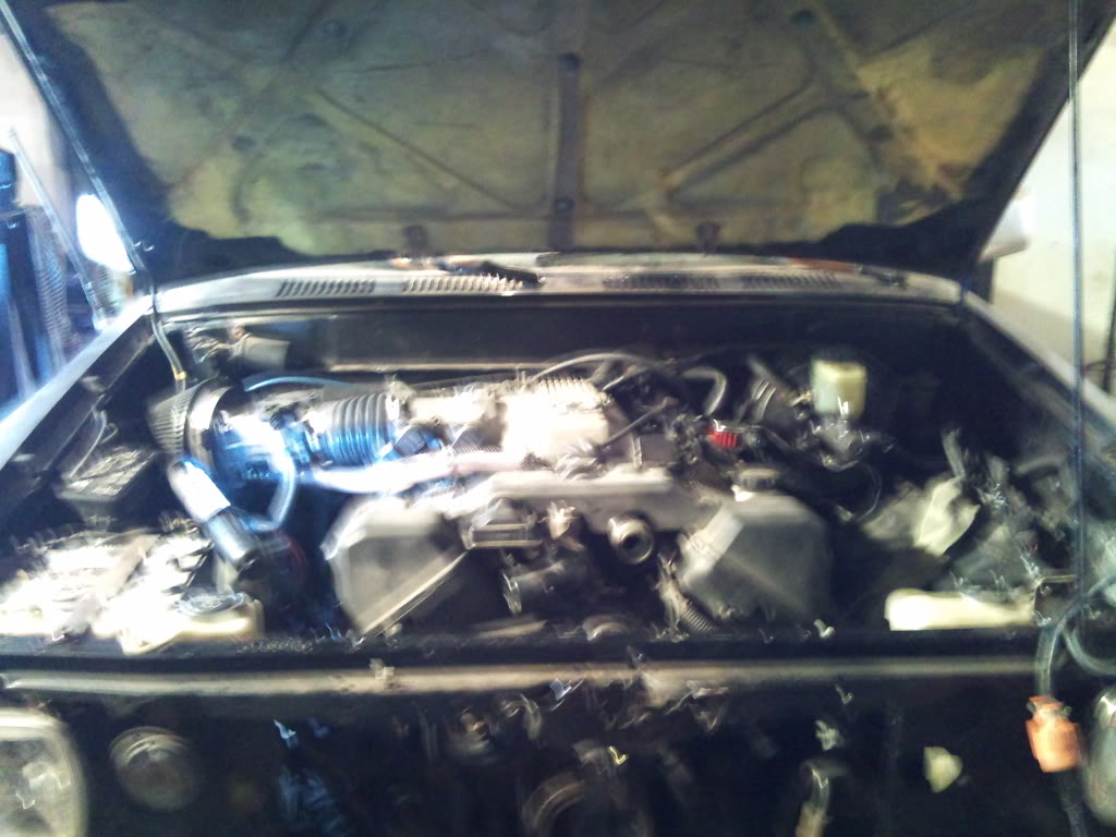

Engine and Trans in the Nest. All bolted

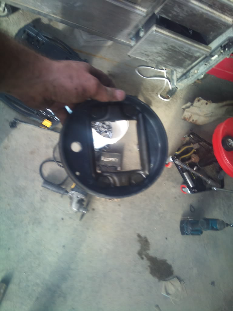

The Maf mod

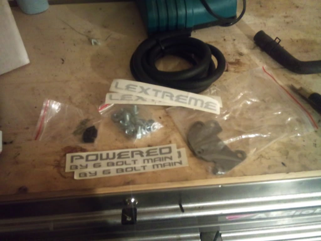

Egr delete kit from Lextreme.com

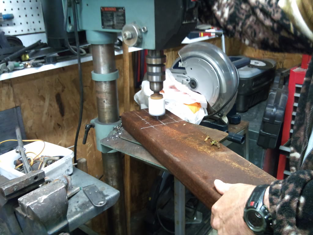

My opinion on that is metal is too T____ and its over P_____ but its my contribution to the knowledge they share with the world.
I went to my Dad's palace. He's a sheet metal worker. Well, he was(retired). So he got a bunch of metal pieces all around is place. This is the trans cross member mod

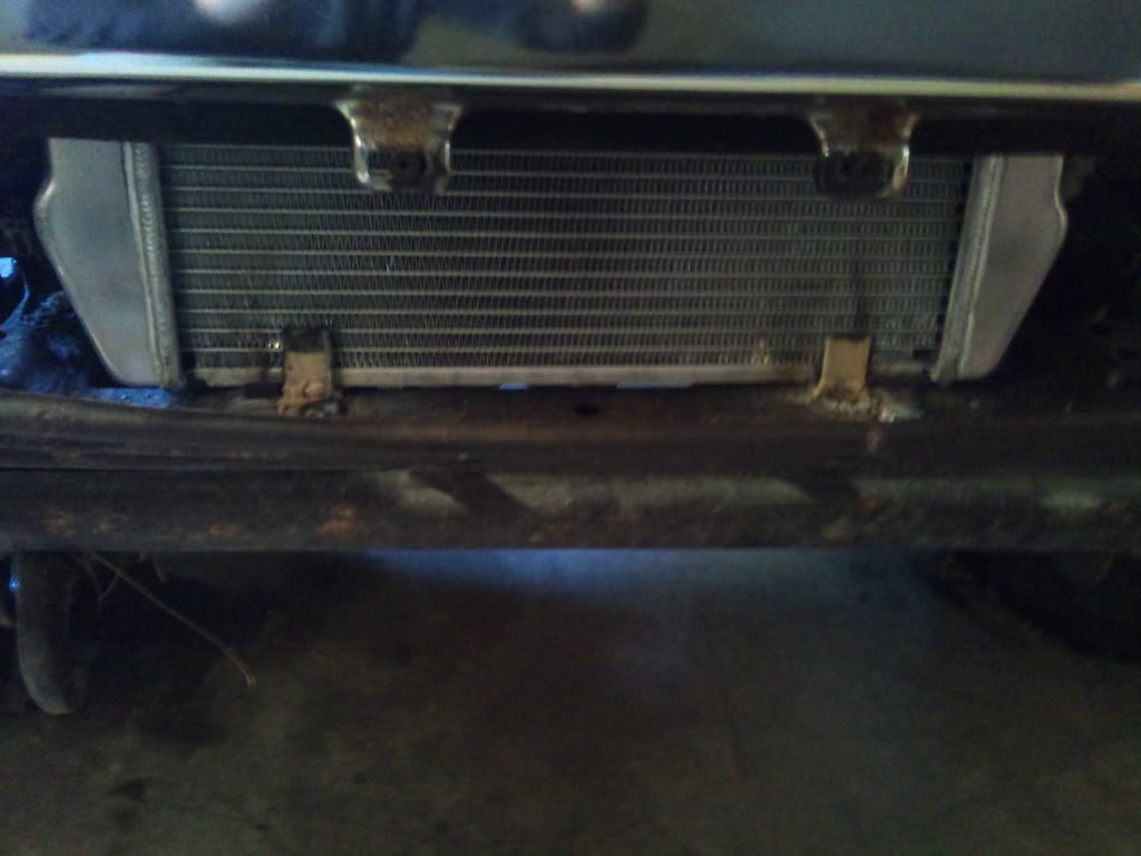

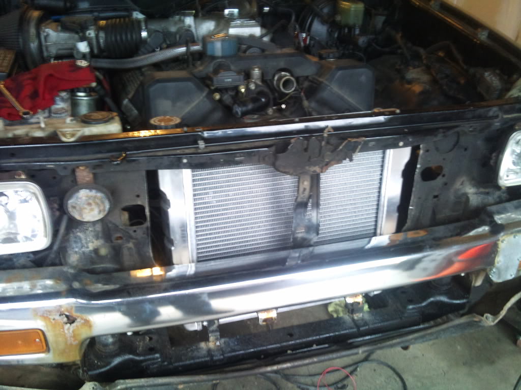

A white Box

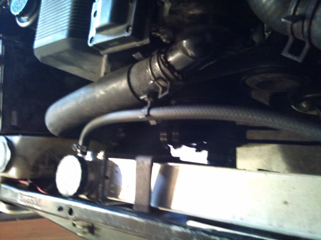

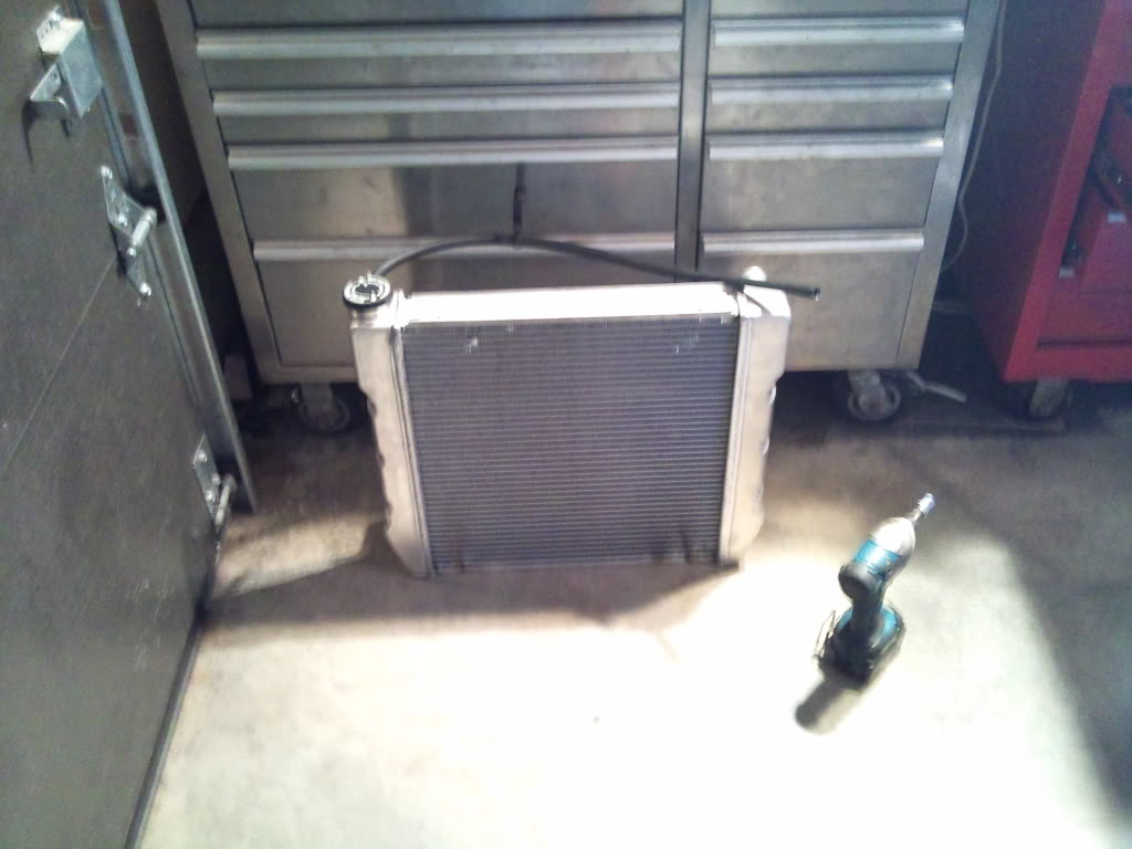

Its the radiator.
Whoa. I had lot of fun there

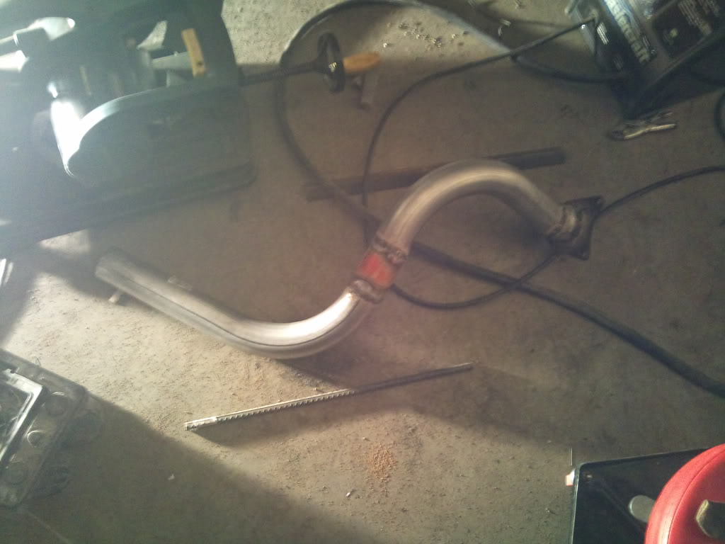

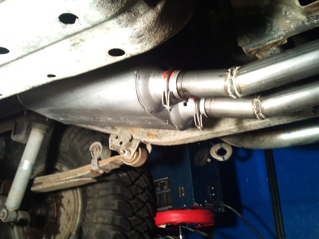

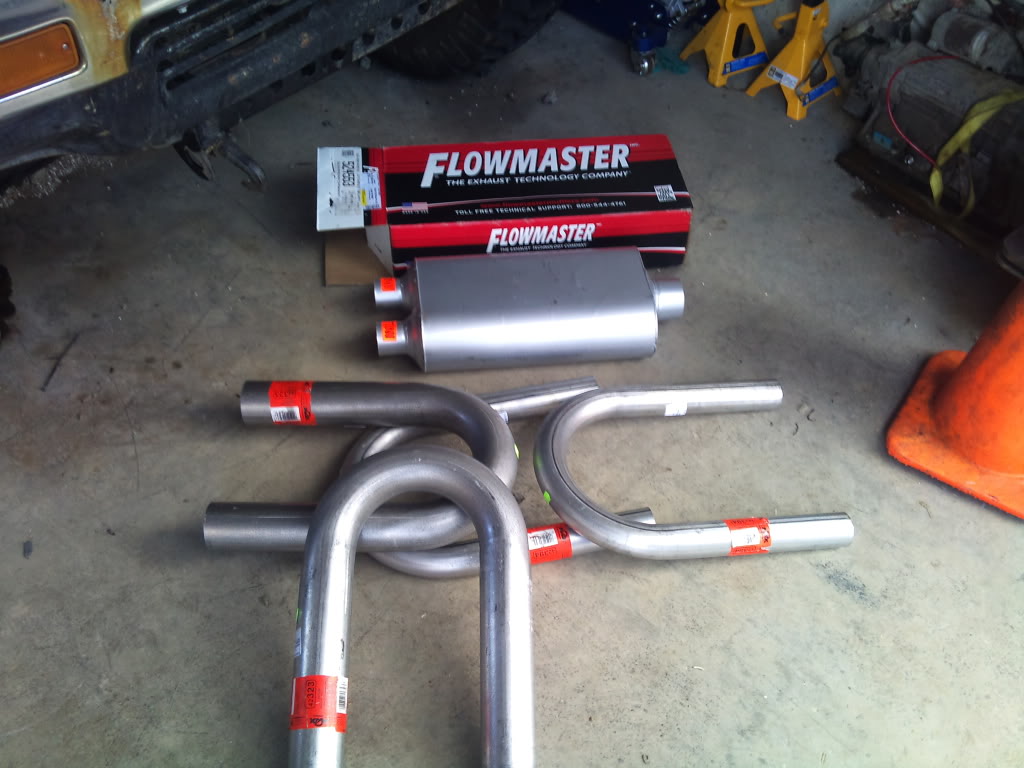

Exhaust stuff

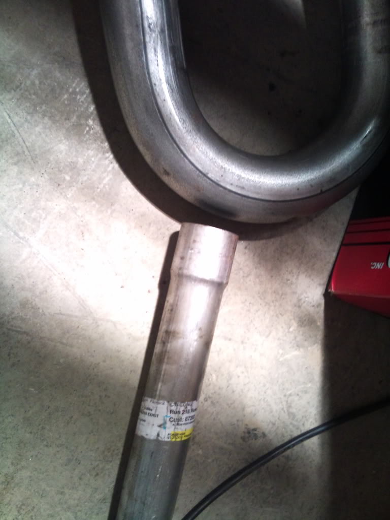

2x 2-1/4 U-bends
2x 3'' U bends
1 Flowmaster muffler.
Missing in the pic is 10' of 2''-1/4 that i bought later.
I tried hard to find a used one but i ended buying new. Fan pulley

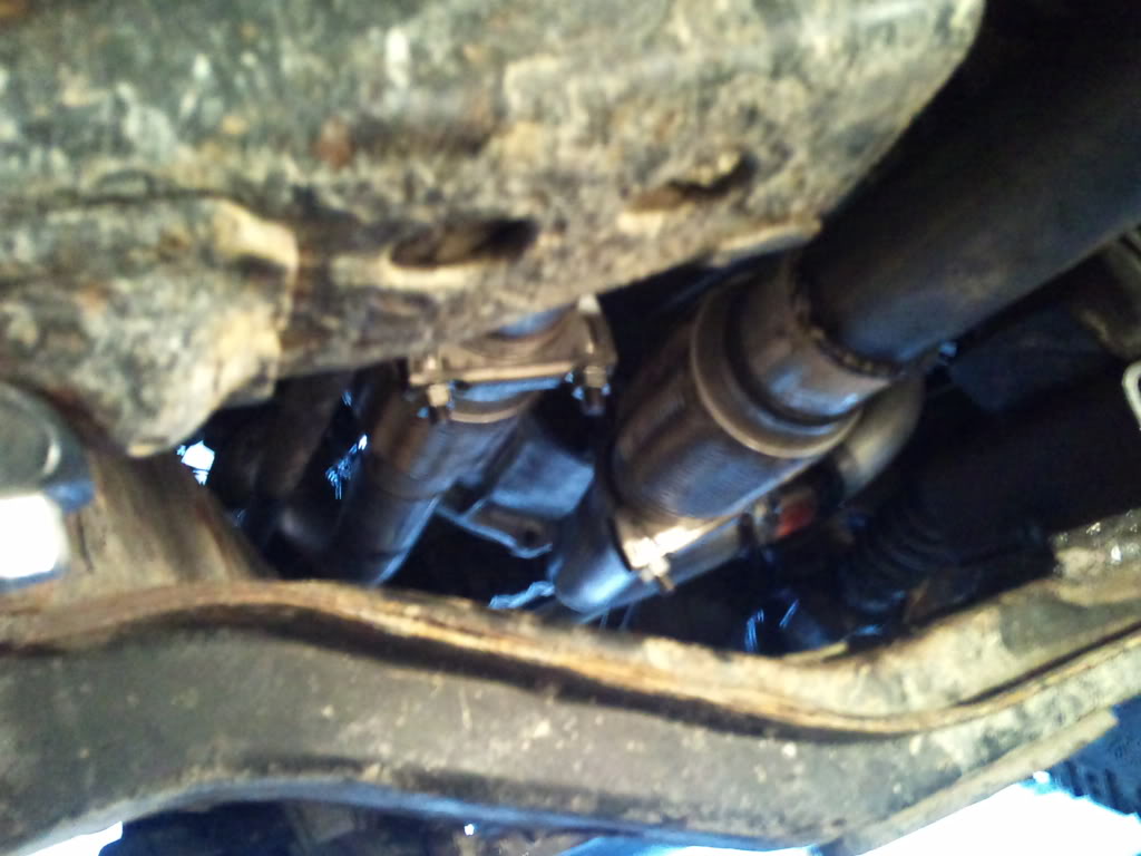

I traded the Cats with shop buddies for 2x 2''-1/4 flex pipe.

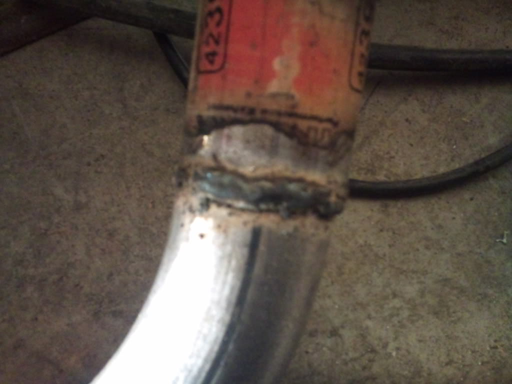

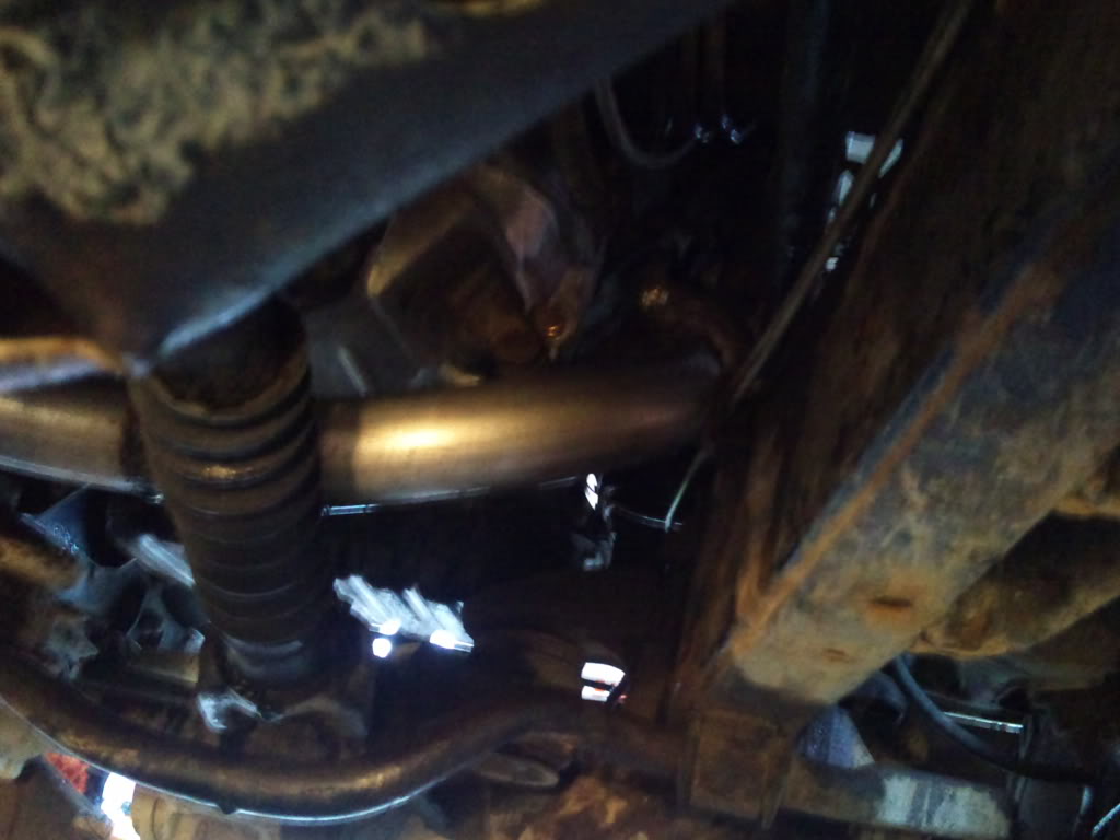

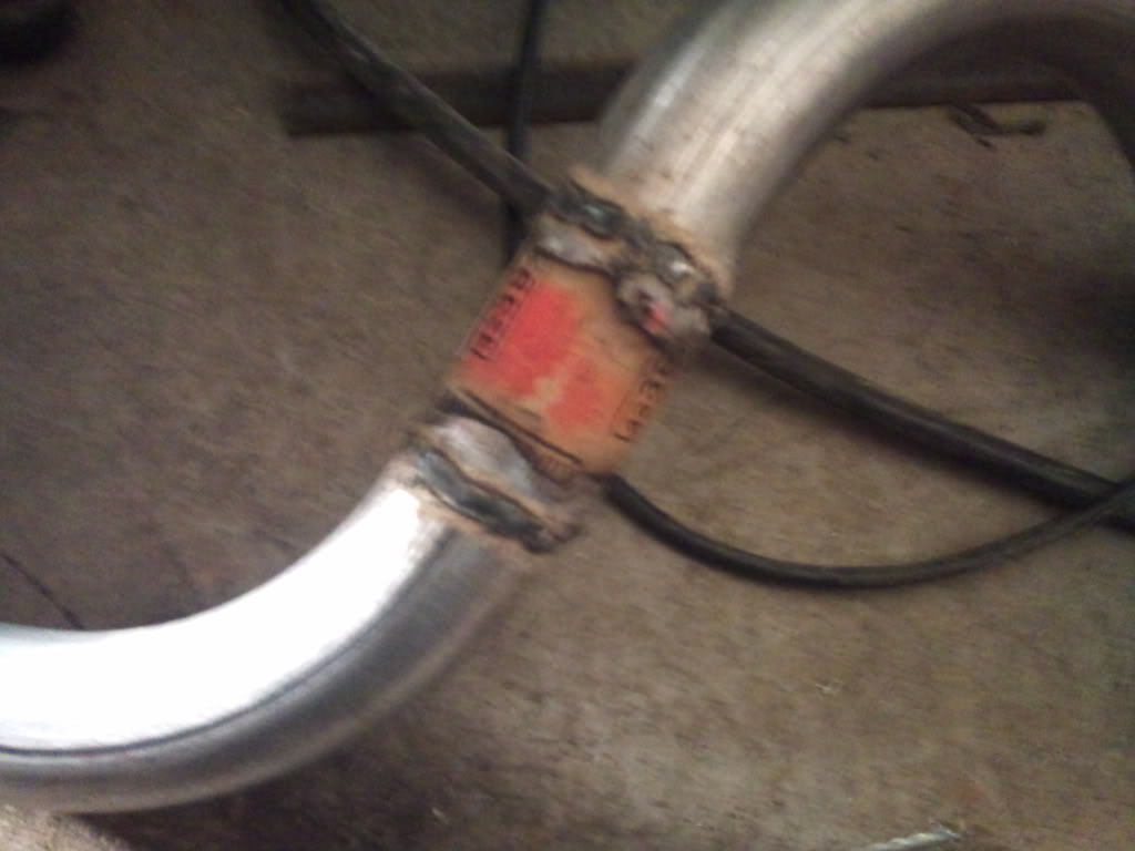

While in the shop, i expended the end of one U-bend till the cutted cats flange fits perfectly.

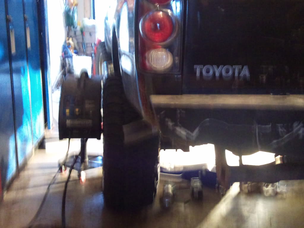

I stole my dad Mig welder and started the exhaust

What flywheel did you use, the 3.0 V6? When you machined the mounting surface of the flywheel, did you measure for the clutch operation?

Flywheel. I used the 3.0 with stock clutch also. I wanted one from the 3.4 but would have cost more money and a clutch. All this because the 3.0 uses a 9.25 clutch compare to 3.4 that uses a 10 inches clutch.
Clutch is working. I just added spacers behing the pivot bolt (only few washers)

So what about balance of the engine? Bolt pattern the same as the UZ?

The bolt patern is not exacly the same. But both patern have equal spacing. I've seen other flywheels that the bolt patern didnt have equal spacing. So that way, it can only fit at one spot. The center is not the same to. I had it machined so it could slide perfectly on the crank.
Specs can be found here.
http://www.v-eight.com/tech_forum/vi...hp?f=46&t=1541
After all those mods, you have to balance the flywheel. I've called like 15 machine shop till i found one who could do it.

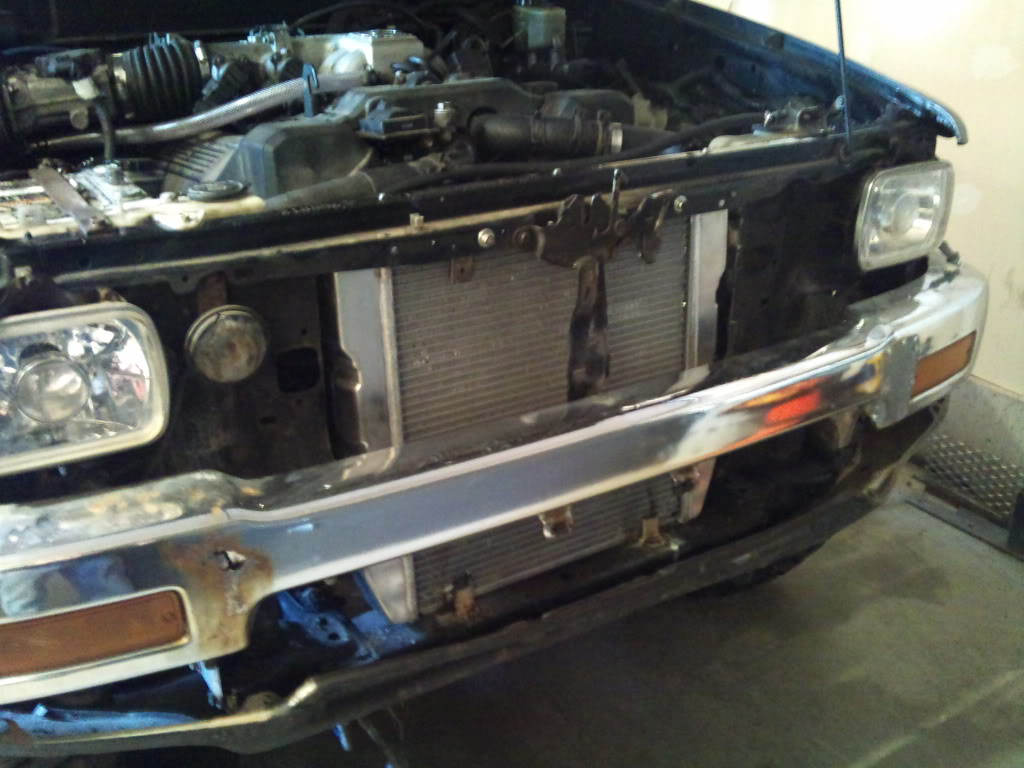

Some updates and some pictures for RMA
Removed the big nipple from fran braket

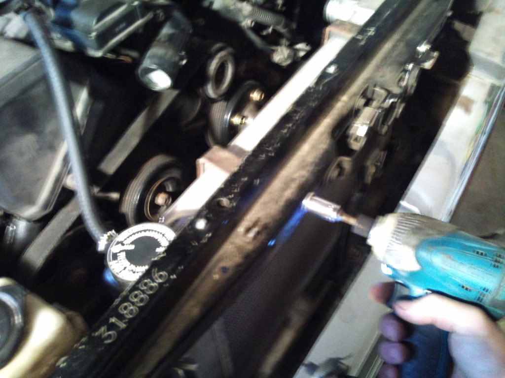

Working on the radiator supports.

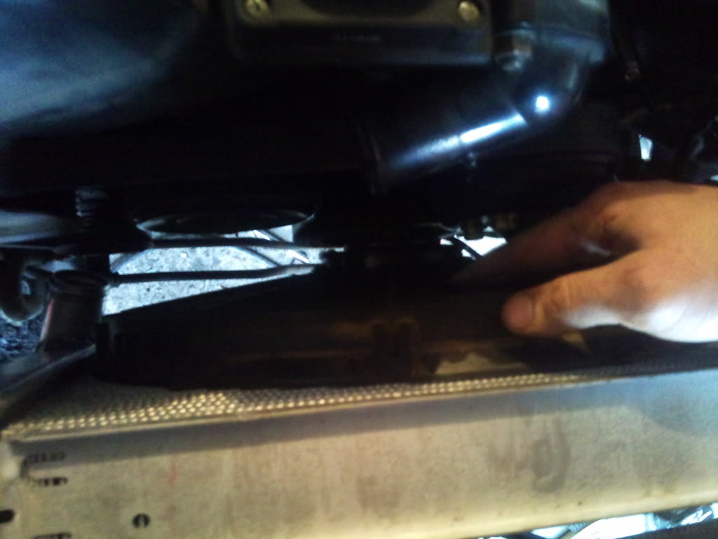

Looks Great but..
The fan is 1/16 away from the crank pulley. So sadly, it wont work
After few tries, the rad sit way lower than i expected and had to cut some truck to make it fit

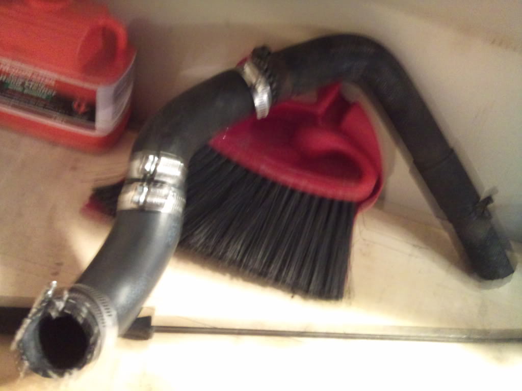

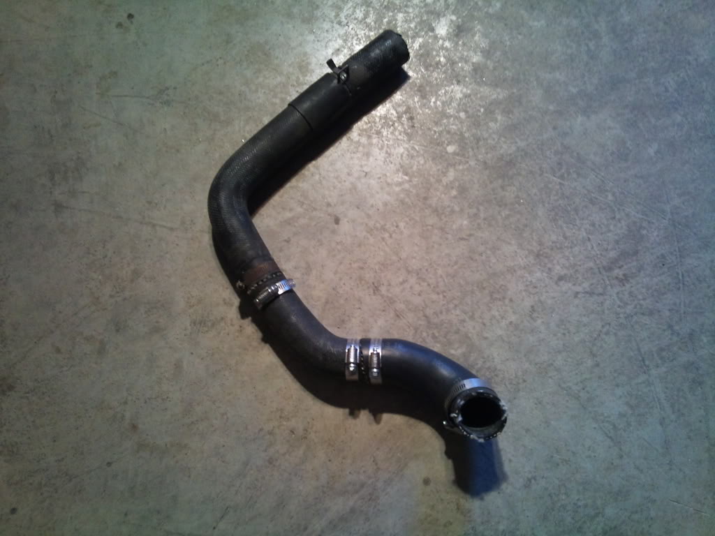

The multi-joint radiator hoses...lol
Removing rad set up to soften edges and paint the brakets.

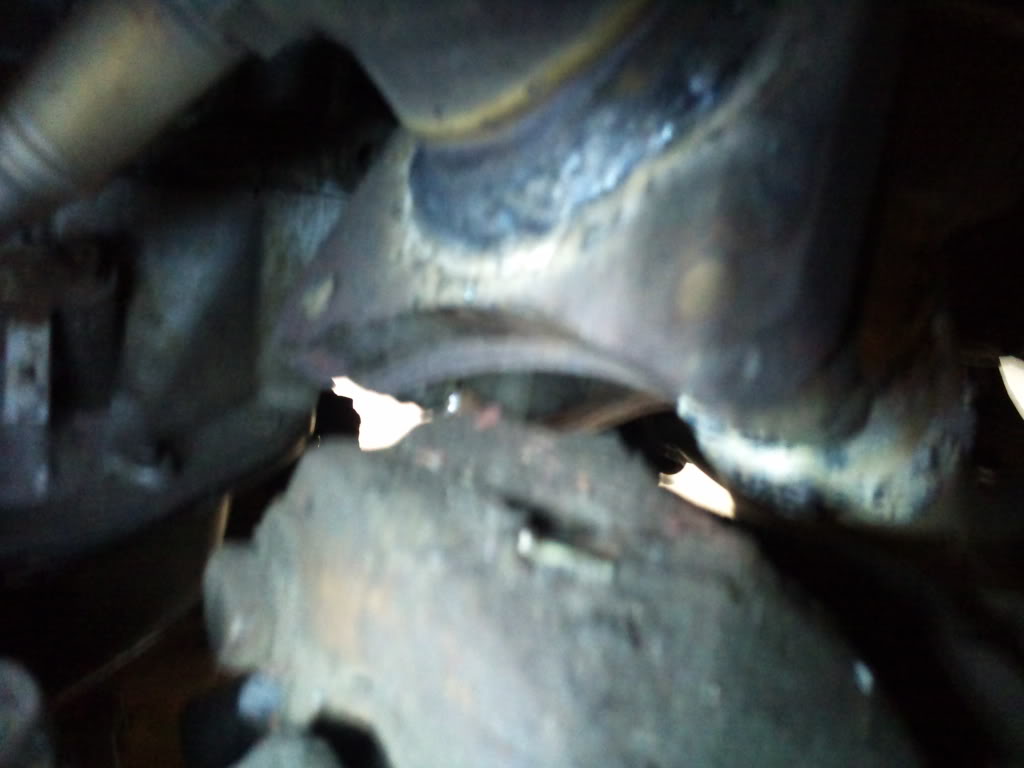

Ok, for RMA and others of course

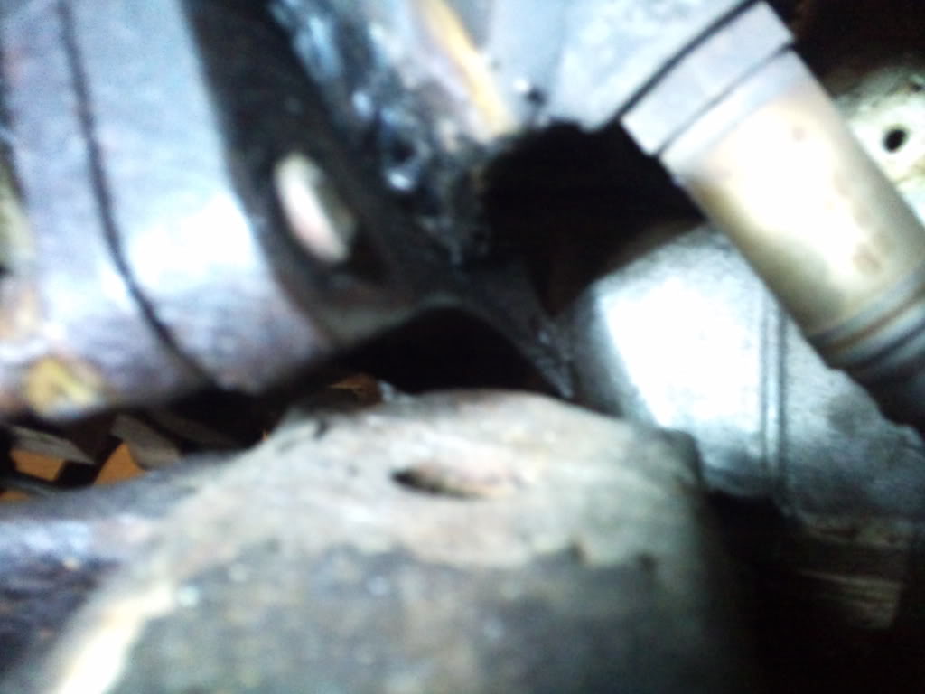

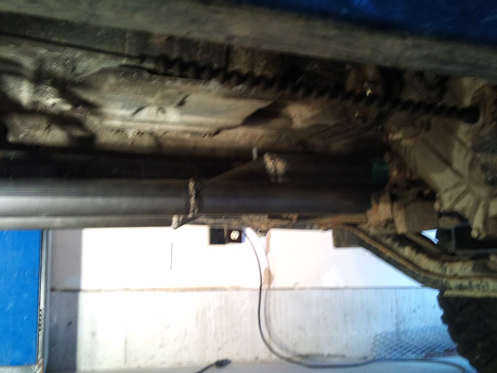

This is how close the pan its from the front diff.
Thats about an inch.
It was closer than that before but i had to shim the engine a bit because of both exhaust flanges.

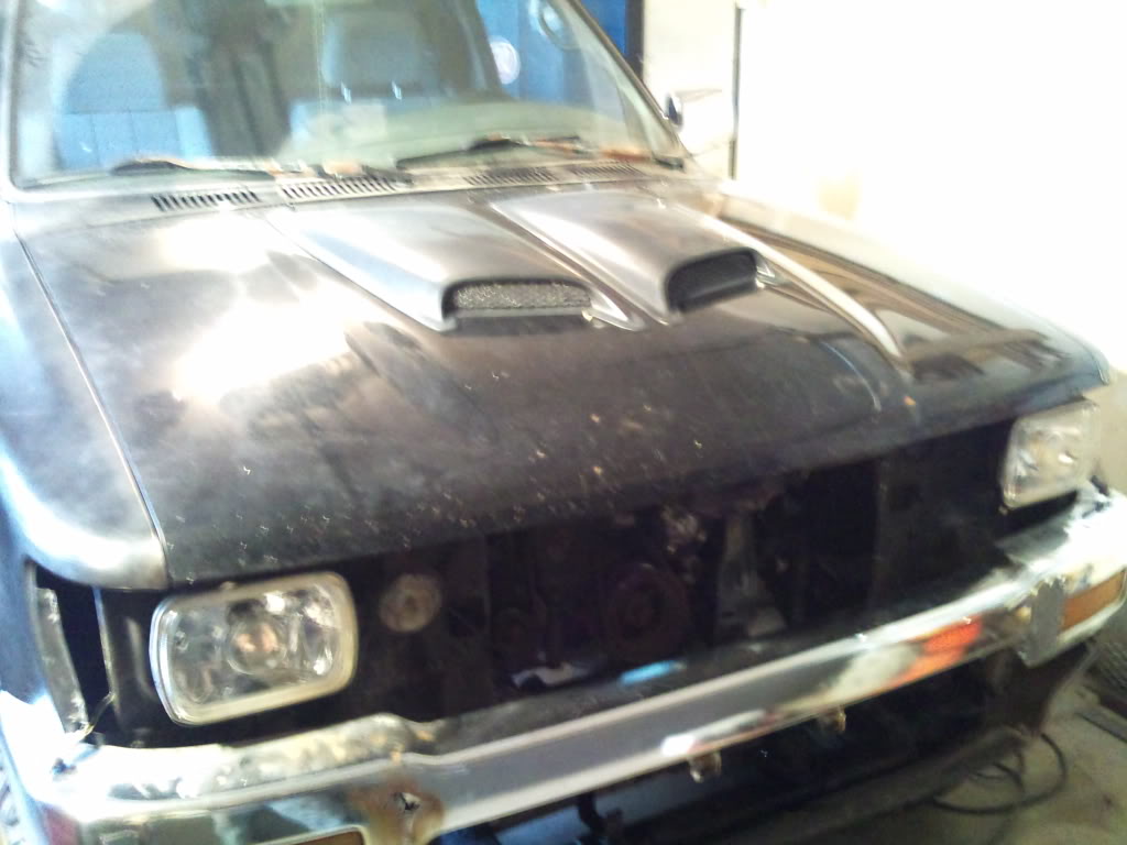

Installed the hood.
Closing....
Closed
Under the hood, fully closed, hand taking picture from grill hole.
Yay, it fits.
This will probly make me go faster
Made some clennup in the wring

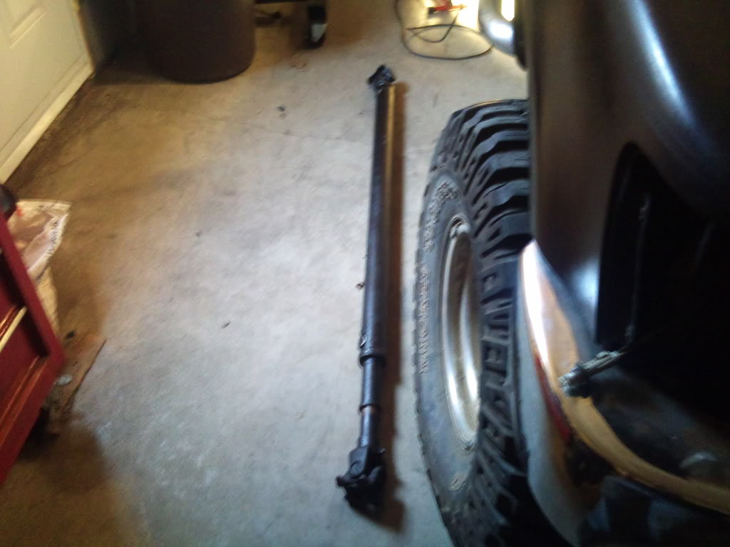

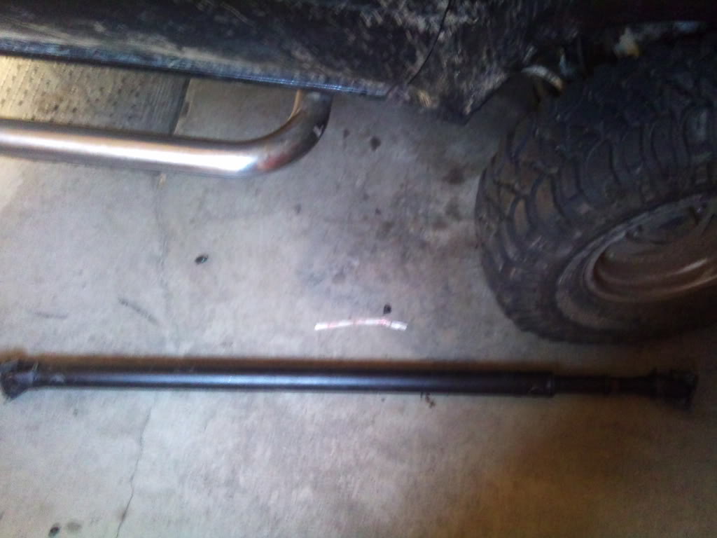

I went to the driveshat shop to exchange some money for my shorten rear driveshaft.
They have changed everyting. New steel, new joints, painted and balanced. Its now in one piece.

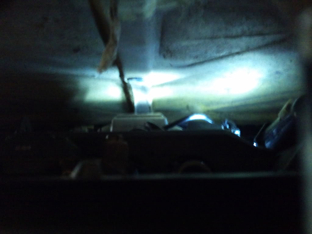

Added some anti-freeze, pluged the electric fan on the DRL (day running light) and went for a test drive....
Went back in. I had no power. That was not normal. 4 cyl was not working properly. One exhaust is hot. Like, untouchable. The other one is mild. Can leave hand on it no problem. I Got new spark plugs and wires and they all fires. Well we did find out the problem. This is definetly a NooB thing. While puting the cams back in their place, i didnt read the book. I just guessed lol. Well, try to figure the problem in the picture.
This is the best pic.
found it?
The exhaust cam is 180 deg off. ** aligned with * is not good. Must be *with*. That was noob. Never saw the other ones so i figured that was the way to go.
Anyway. Went back on the road. Rolled for about an hour. No problems. This thing pull like hell
At first, we had a bit of over heating. went back to garage, added coolant, back on the road. Its cold. lol Removed fuse for the fan and got a bit higher but its still too cold. I will have to change the thermostat i guess. I have to adjust the tach to. If i can figure out how. Or plan ''B'' is to go with aftermarket.

Also, here's some video of me and my friend trying to adjust the tach. The first try was a bit overkill but i think we did prety good after all. Oh, sorry for the french speaking, thats what we do in Quebec. Hehe. To make sure of our adjustment, we needed to borow a aftermarket tach to get dead on. My friend that was with me today, well he had one laying in the back of is Yota. What a coincidence?!?!
Im happy with the tach results It might be off a tiny bit but hey, I didnt loose time/money for a 4cyl one and i still have the same milage on it. Thats someting I was picky about. Nothing that couldnt be tricked tho.
Thanks for the info Toyminator !!
