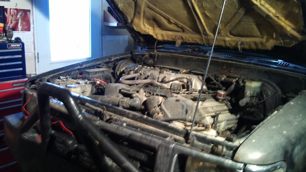

how about a pic of the engine bay ?
what radiator and fan are you using ? and whats these mounts your using also .

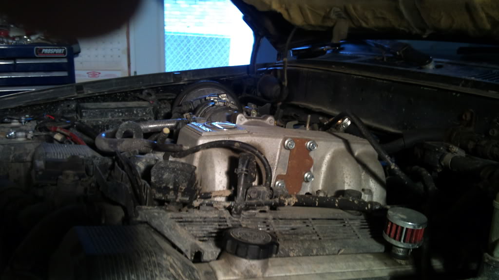

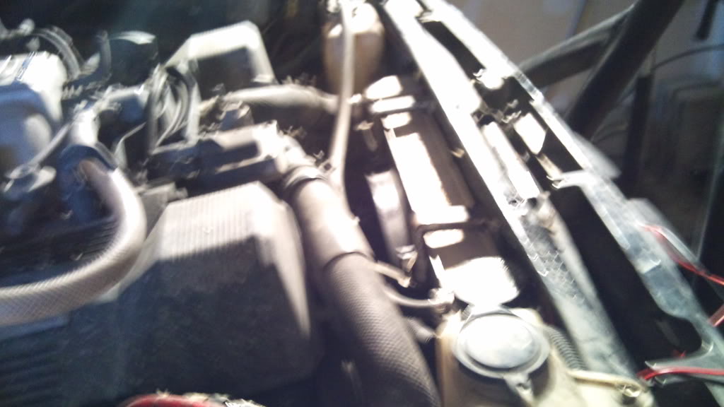

Im using a aftermaket GM rad. About 20in wide. Got it for about 200cdn$ That fan is a 16in flexalite. Expensive compared to those on ebay but its more reliable and more cfm. Can't remember these numbers tho.
Those engine mount are from a ford like i said. From inline 6 cyl late 80's. Can't remember lol. Some peps use those in their 300zx. Thats where i found that. Cheap mount mod. 25$, its a deal.
The engine bay, and miss febuary in the corner lol

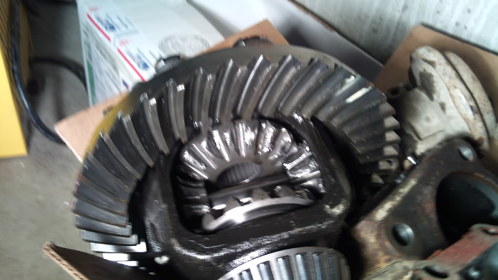

round tooth spider gears
4.56 gears are are to find. Well, used.

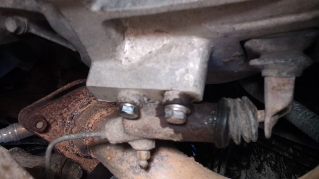

The bellHousing:

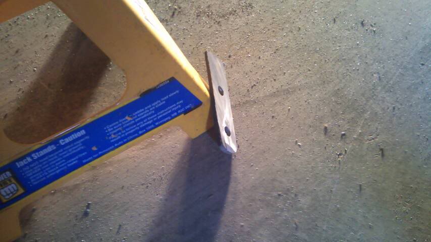

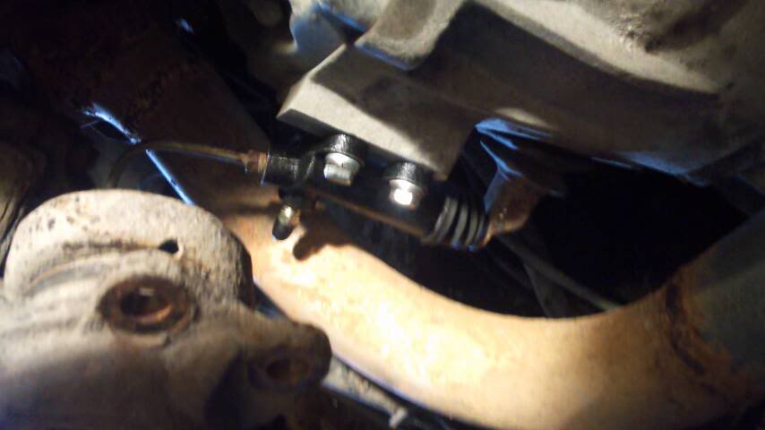

No cracks on mine. I would say the product is good but communication from the seller is bad. No input shaft spacer. Didnt came with it. I asked the seller but he never answered. Same as the 5-6 other questions i asked. But anyways
The slave mounting point is way to tall. Well on mine it was. They sell the BH to fit the R-series transmission so i guess the clutch fork dosent have the same lenght on every tranny. By making it too long, buyer can cut it the lenght he wants.
I did cut about 3/4 on mine and its still about 1/8 too tall
My slave is a bit sweety. I will change it soon and remove that extra 1/8 meat.
Im strongly suggesting to mount your clutch fork, cut mounting point a desired place, drill deeper and retread for longer bolts. (i lost both bolts on the road, so a working clutch to)
Also, i suggest to do it before installing engine/trans in truck. That will save you swearing words

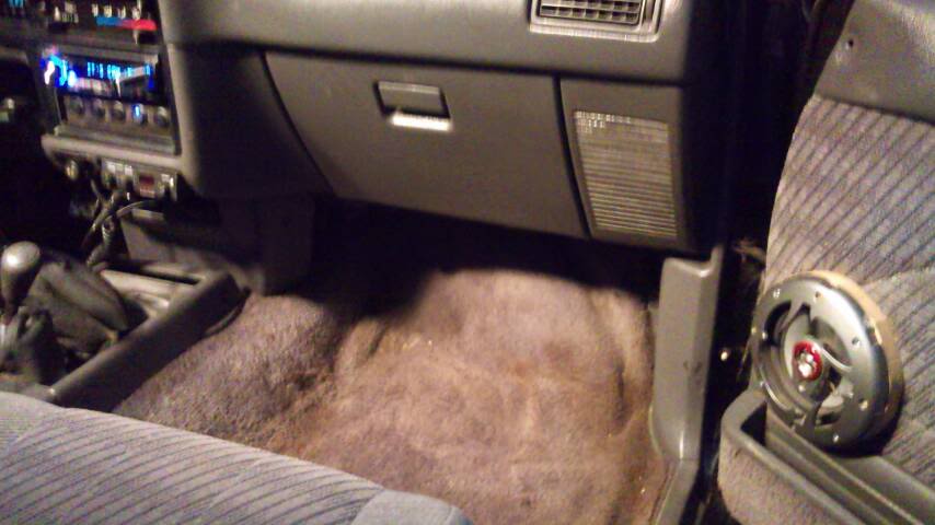

I did spent a lot of time in the garage lately fixin up things. I installed my missing sub o2's (thanks for the info toy2k).
I made a nice lookin switch panel. Made some clean up in the wires, installed some aux lights on the bumper, added rear speakers and rewired them all.
I finaly installed a C.B radio and did a super clean up in the truck.
When i told my girlfriend I was about to pass the vaccum in and wash all the mud inside, she told me "yeah right" lol.
And if my truck could have speak at that very time, he would have said the same thing.
Well, he's now a happy truck.

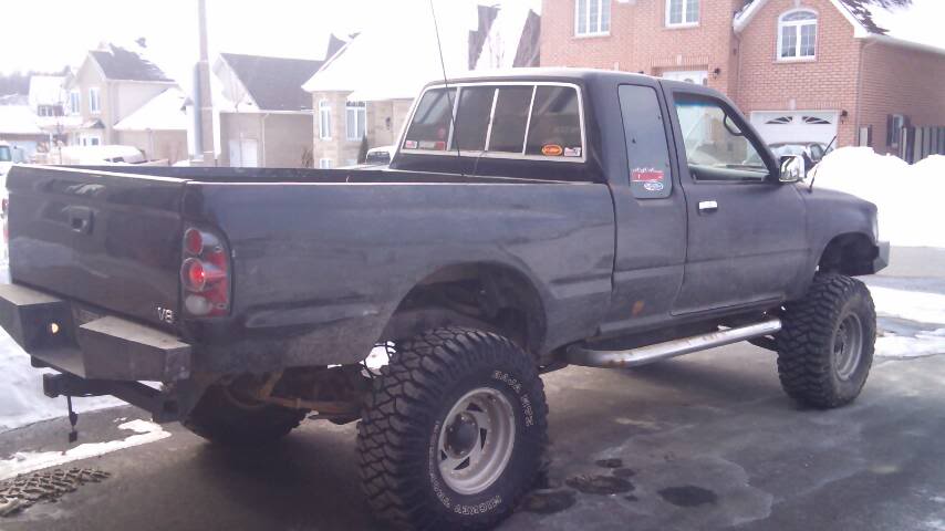

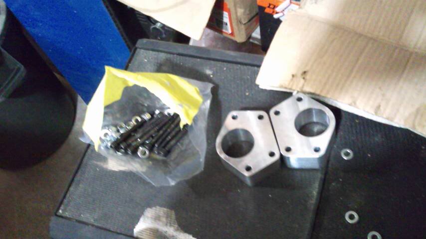

Got my ball joint spacer from the mail

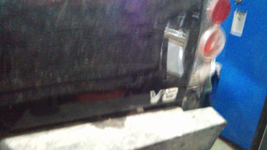

Installed a new badge on the tailgate

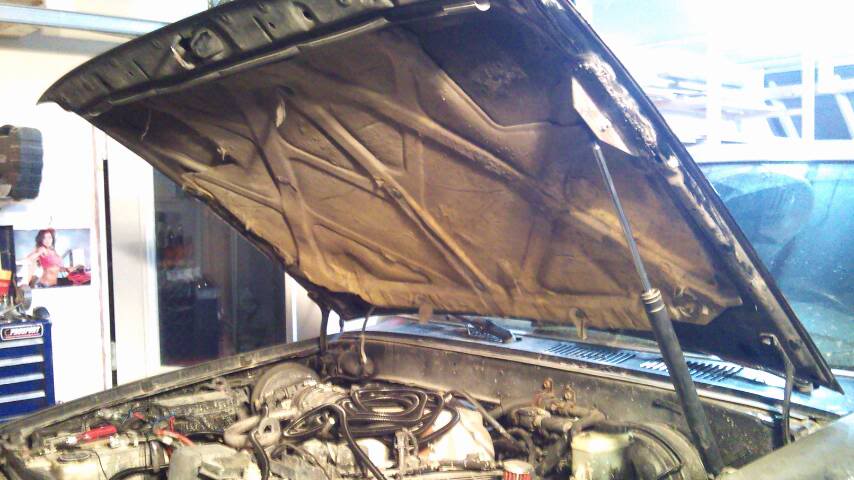

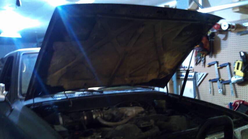

I had spare time so I installed one hood shock from the Sc400

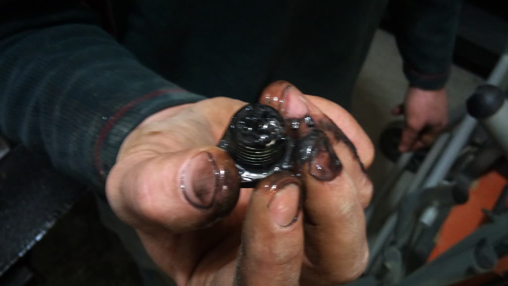

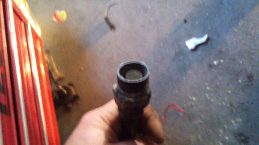

This is what i removed from the slave mounting point
New slave

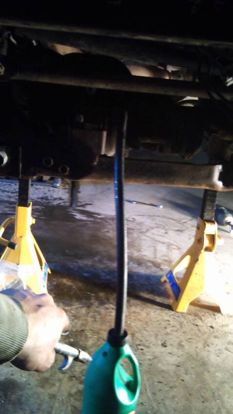

Finaly got my hand on a front diff. Paid 90$ for a used one. I had to get it of the runner but its in good shape and its 4.56
Thanks to my buddy who gave me a good hand with that one.
This is how i put the oil in. It looks redneck but its a hell of a good trick.
A hose in the bottom, a hole on the side, a bit of air trough the hole...20-30 secs per liter. No mess hehe.
