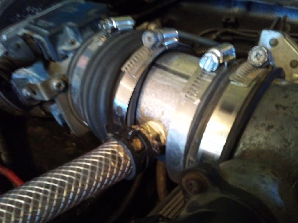

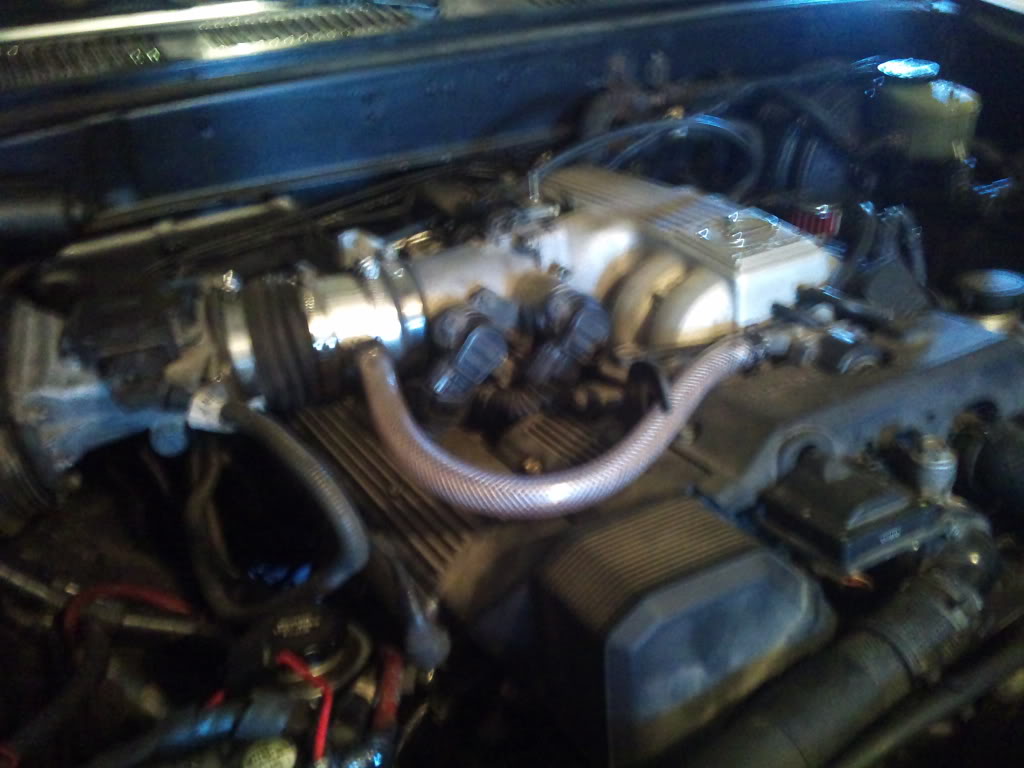

its nice when you have the funds for projects .. you might want to fix your ISC hose though, it should be routed behind the MAF..

Yeah that hose. I forgot the sc400 routing. There was a big hole on the k&n so, this is where i've plug it. Plus, I dont have a lot of space after the maf. I might have to relocate the battery on driver side...I still have some 3" pipe...Maybe I'll remove the TRC stuff and put it there... Ill figure out someting for it. Now, I have to change the front yoke seal on the transfercase. Also, I have to make the fuel pump work proprely. I got signal when i start, and the other signal is on the alternator. When the alt start to charge, it send a small signal. Just enough to light up a test light. Well, my fuel pump relay is on this signal. When the engine gets hot and below 800rpm, the signal drop and the relay disengage. So i run out of fuel and it stall. I did try to make it work with the ecu but it didnt. I was looking for a positive signal tho. After looking at the wiring diagram, i think its negative lol. Going in the garage to figure this out just after these words.

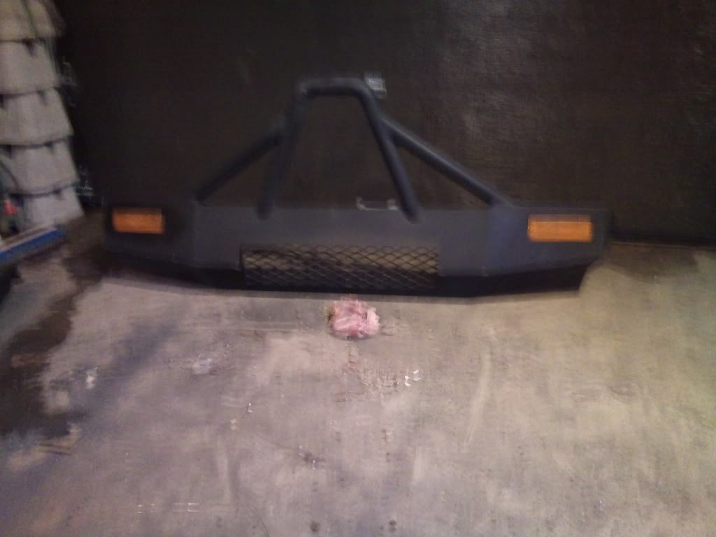

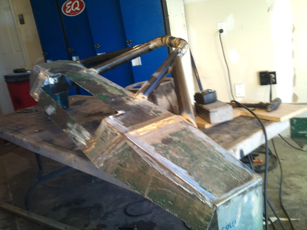

Anyway, keep the comments/advices coming. I should be loading the 2nd page with more pictures. Im now working with CAD to design a front bumper. I allready got so 1/8 sheet metal and going to borow a plasma cutter from a friend tommorow. That should be interresting.

yea the hose for the idle valve should be after the maf or you have a leak .

I did fixed the Idle Valve. Unpluged the batt, to reset codes. I started the engine, gave a few shot on the gaz and then turned of the engine. I runned codes and i got rid of 24 and 31. That was from Maf. Ill see if i still have them after a test drive. I still have 27 and 29 tho. Sub Oxy are not installed yet. I will do it later.

Big test drive today. Probly more than 150kms done. I got rid of Maf codes and engine is not stalling anymore. So, it was all about that hose. Thanks guys. Hooking up the fuel pump relay from the alt sens was not a bad idea after all. Tho, I still have 27-29 and the 42 codes. 42 is VSS(speed sensor). I think i should hook it up to.

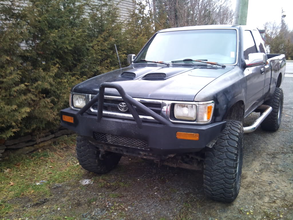

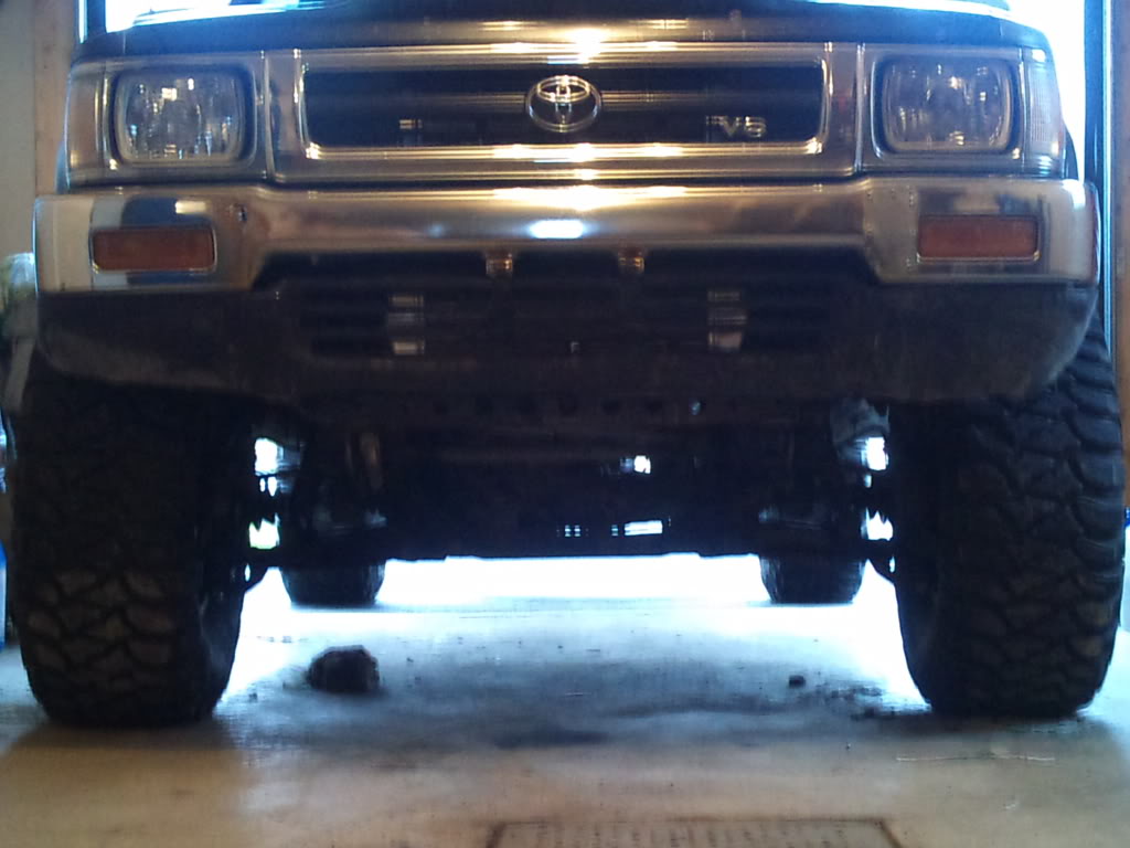

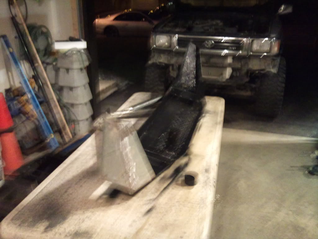

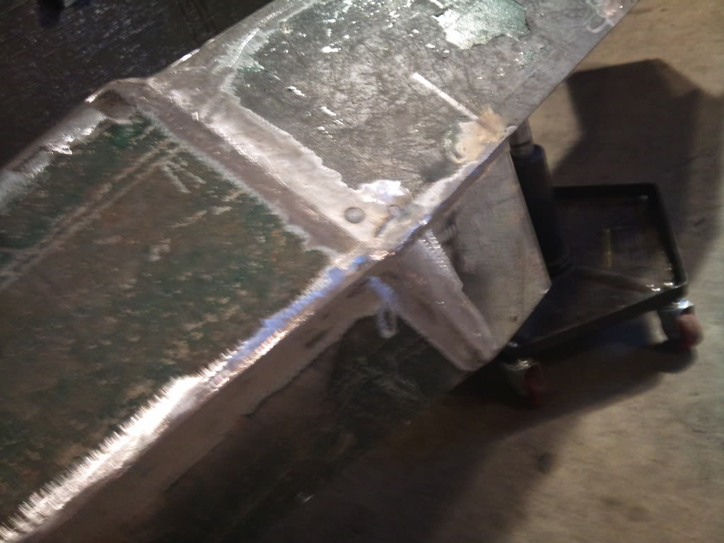

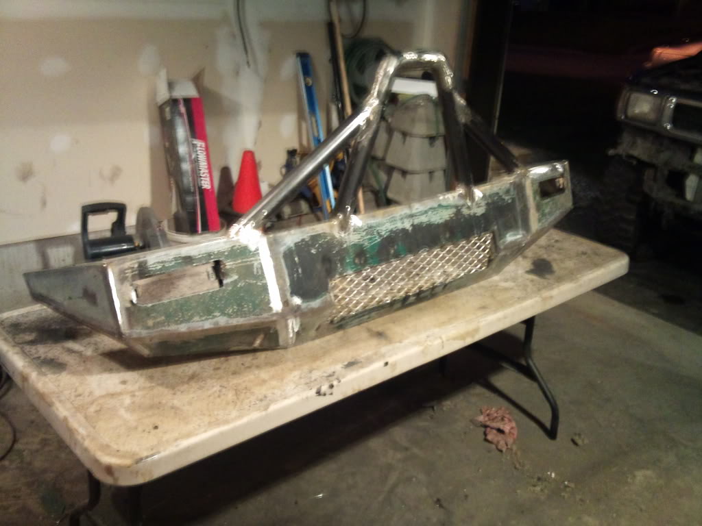

Here's some updates. Truck is doing good. I still have the engine light on but i will take care of it soon. I must connect sub O2's to get rid of it. The fuel pump is still linked to the alternator and works like a charm. I should hook up a backup switch I case the alt die.

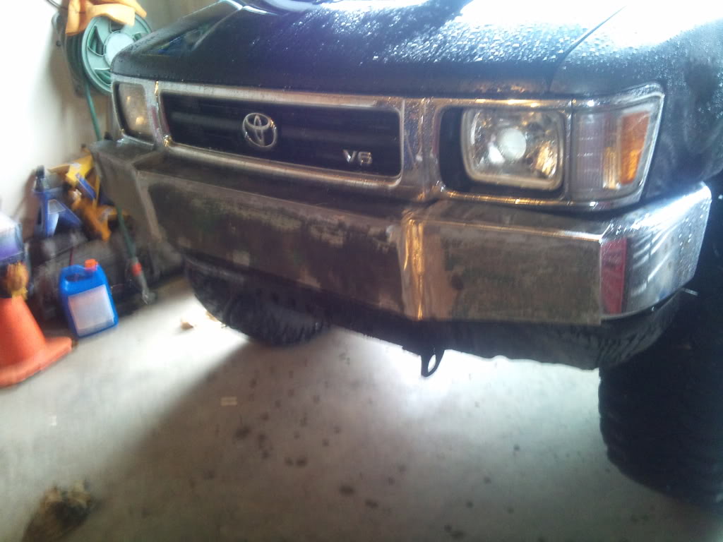

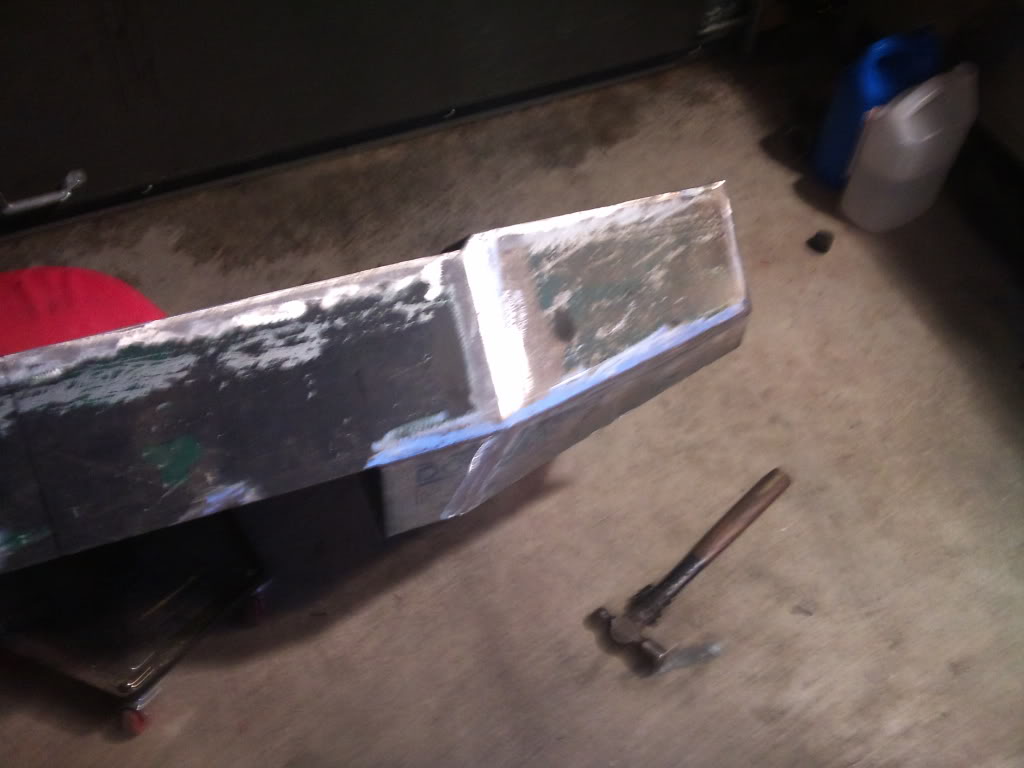

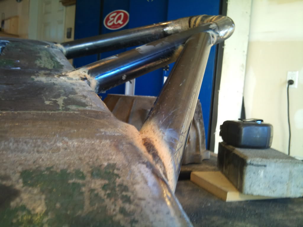

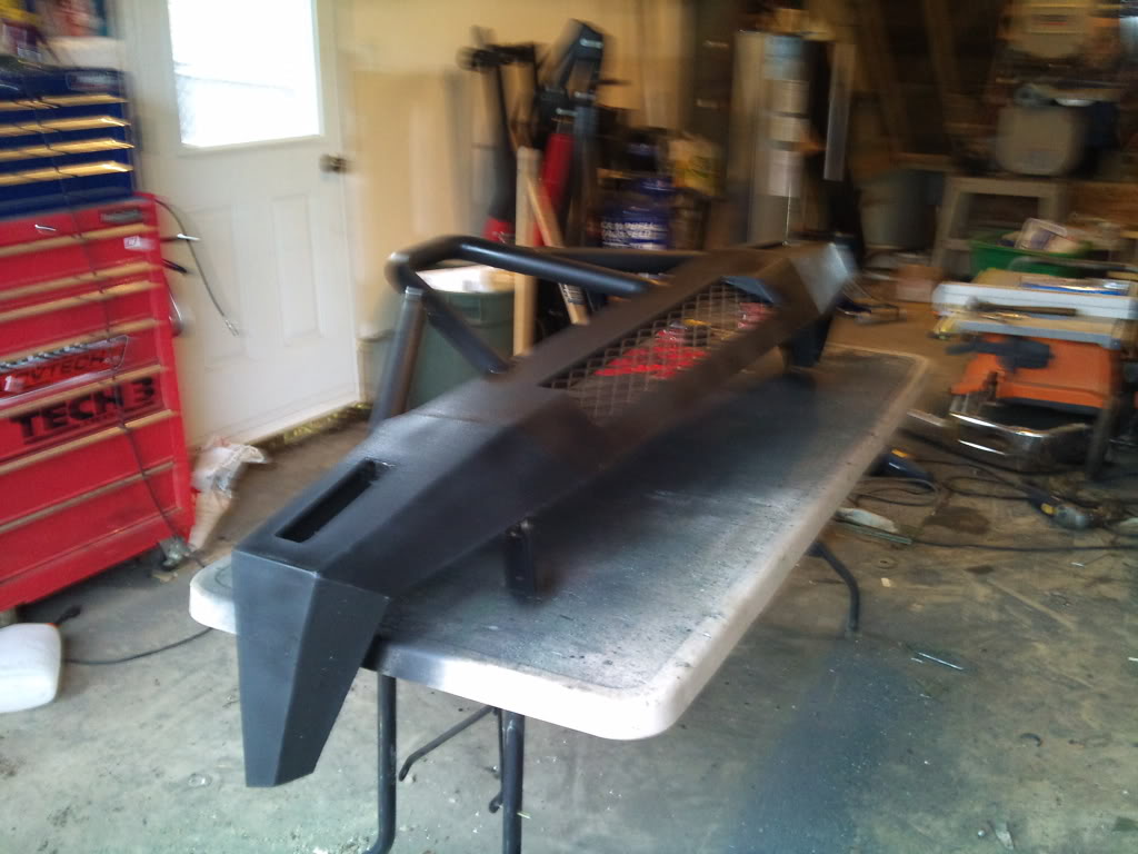

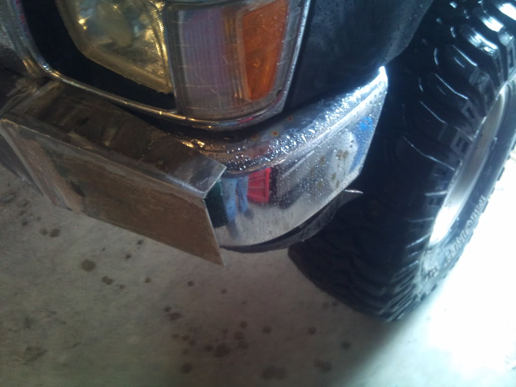

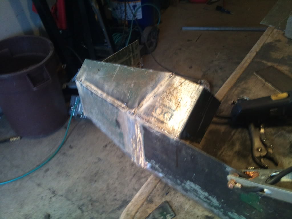

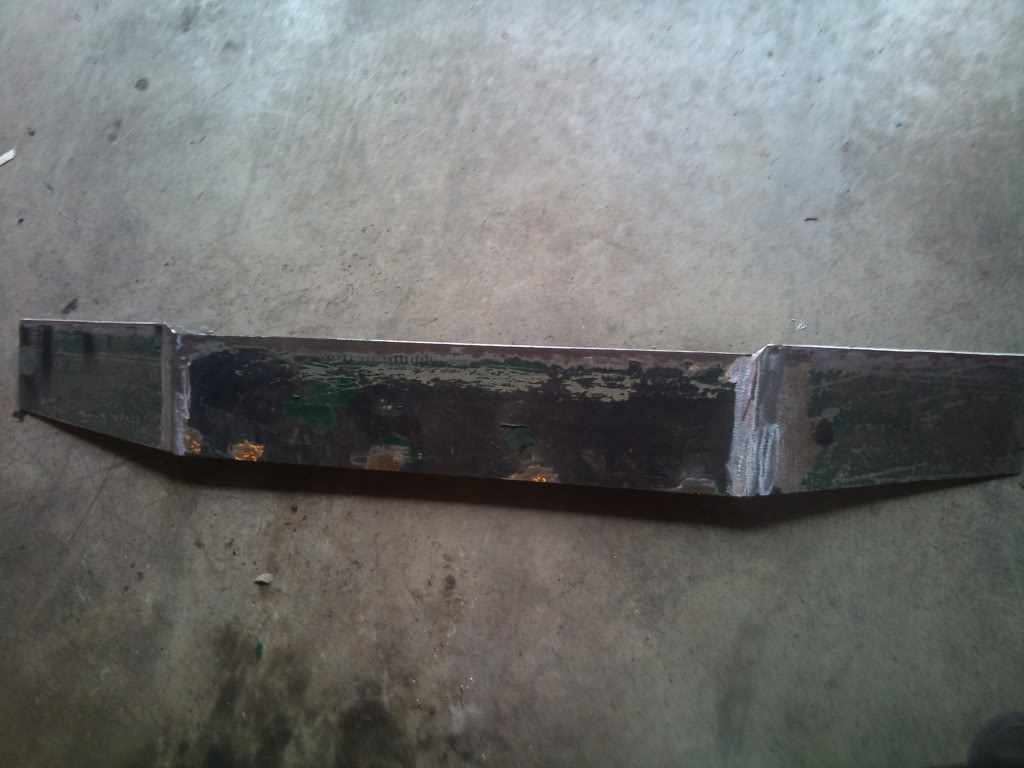

Here's some pictures of the front bumper I fab.

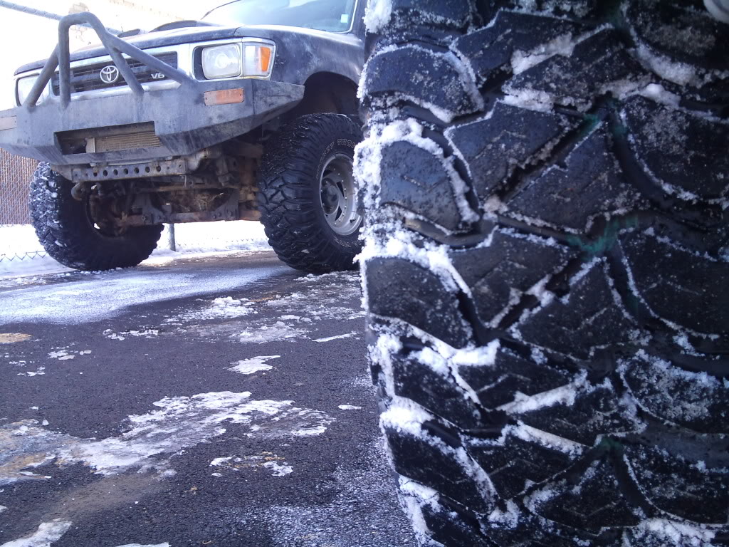

Looks like it got a little hot after running it at 5000 rpms all the way up that hill.

I know, it got hot even with a big e-fan. I was thinking about adding one or two lil fan as pusher. Might solve this problem during situation like that one. I don't think I will have the same situation every day tho. Maybe i'll invest in a winch instead. Hehe
