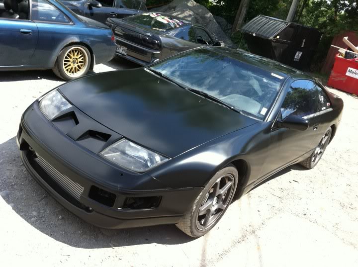

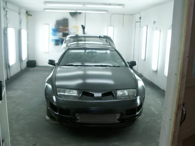

True James. Not fast like a 300zx. I got a new time for the year with the zx. 12.939
You're sure you don't want to trade? And she's now in...
Flat black!!

Now I don't know if the black will make me go faster...

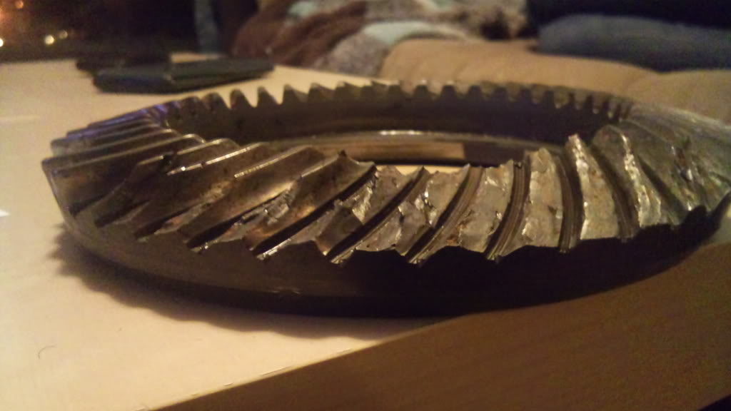

Apart from that, my truck body is getting soft. I will have to do something about it if i want to keep it for an other 5-6 years. Also, i spoted a tiny crack in the frame will changing the rear 3rd member. Yes i blew the rear end. I bought a 4cyl one at the scrap yard for 60$ and got it welded from a friend

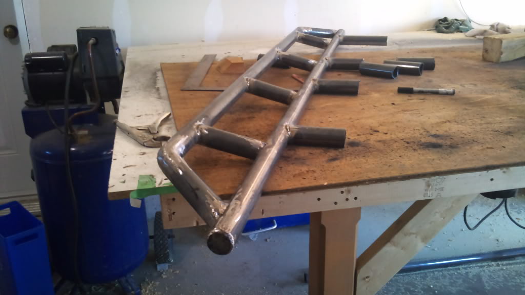

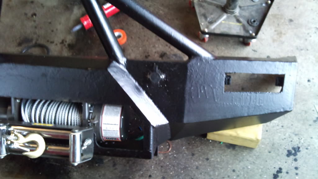

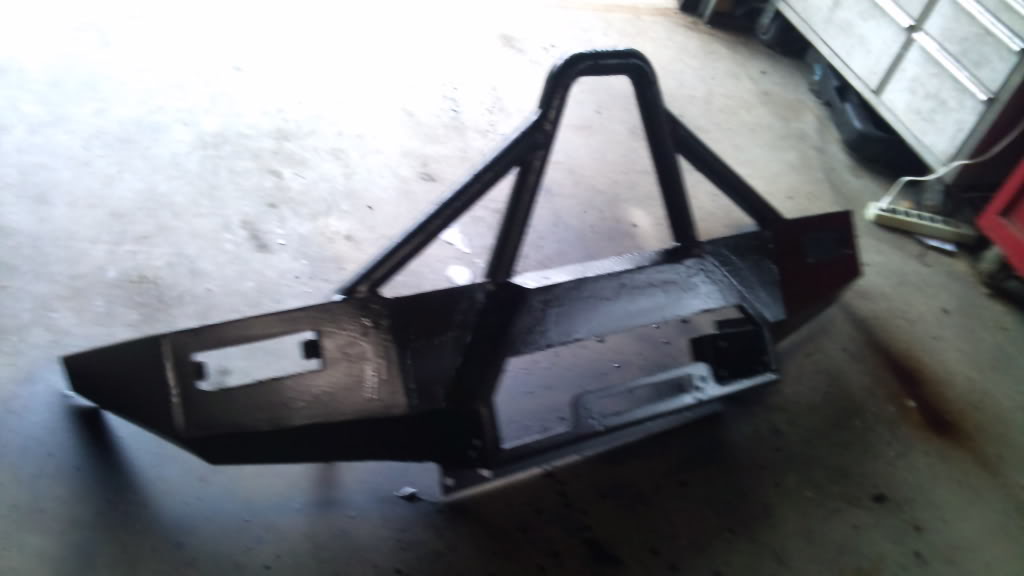

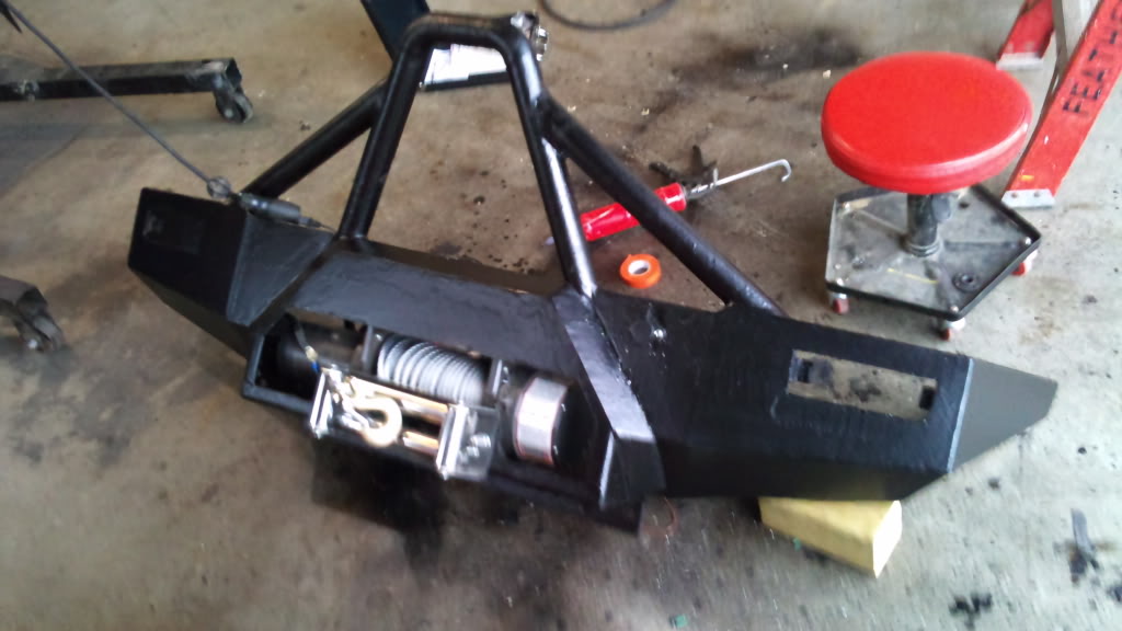

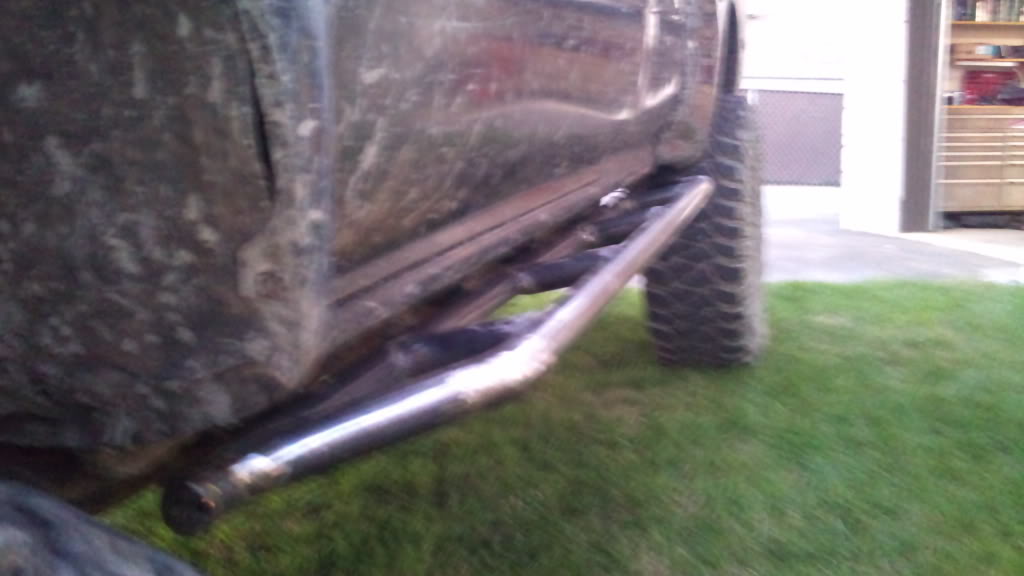

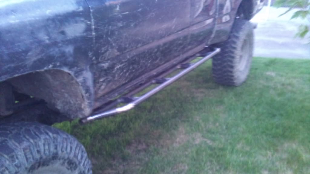

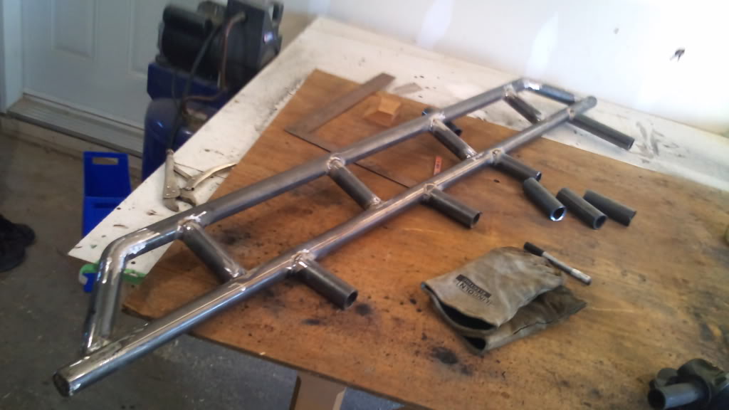

Here's a few picture while im at it.
I Made a pair of these. Took a while...

The 4cyl 4.56 getting hacked

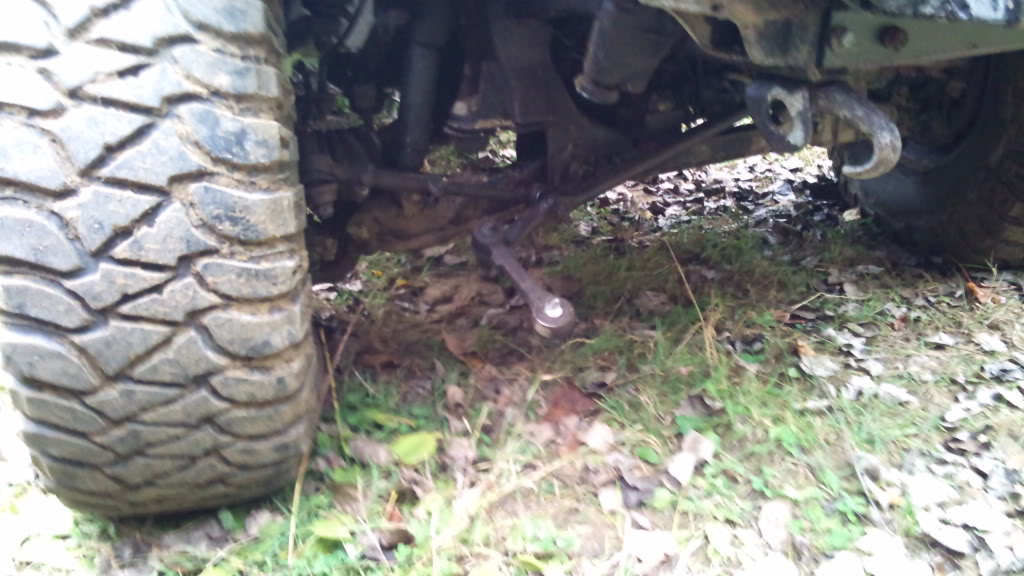

My gasket leaks are caused by the upper control arms hitting the manifold upon flexing. To solve this problem, I will sadly need to Sas it
Plus, my ball joint spacers with +0'' front shock caused one front shock to pop out. I ordered some +3" last friday. That will solve one problem this week.
