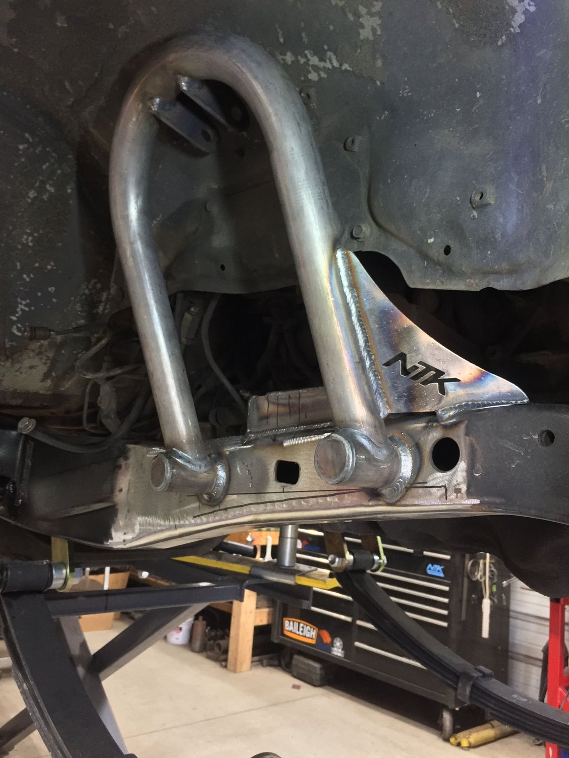

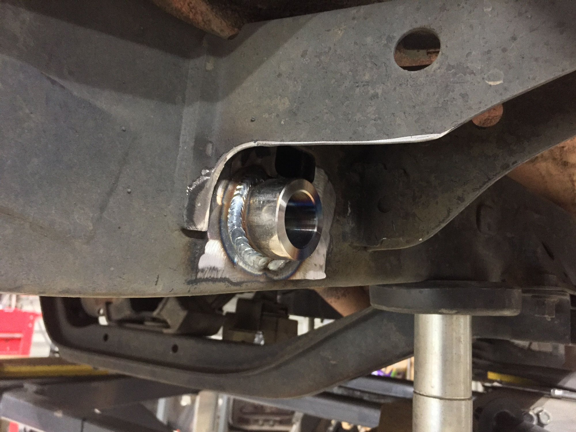

I mounted my front spring hanger flush with crossmember and my frame tube as far forward as the jig would let them go. If you go by TG instructions, they are the same for the 3", 4", and 5" springs. This is bad because they are different lengths and will not work and you will end up with a bad shackle angle in the front. Be sure and tack it and put load on the springs before burning it in to verify it fits because cutting it off after fully welding around the ends and gussets would be a real bitch!
Here is the passenger frame tube hole in relation to the body mount.
I used a hole saw to make the holes. I started with the torch but it made a real mess. A quality bimetal hole saw (I used a Lenox brand), plenty of cutting fluid, and a good low RPM drill will make it through the whole frame, gussets and all, and make a nice clean hole.
