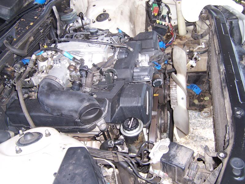

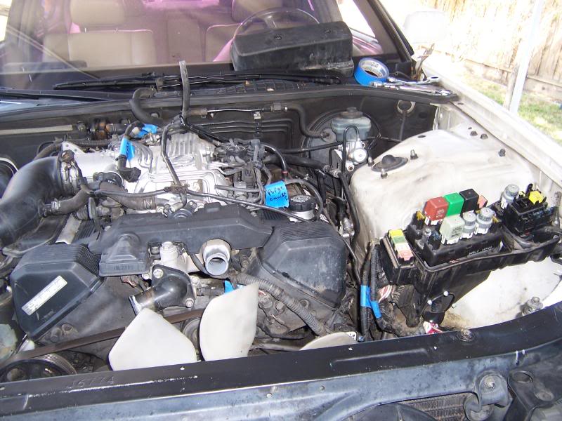

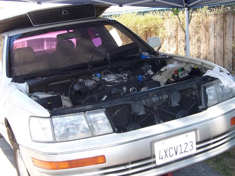

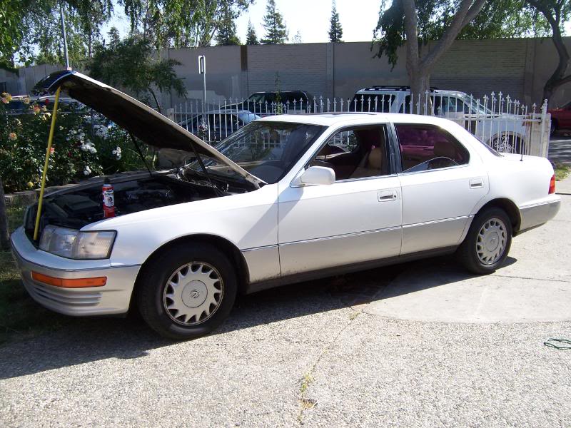

I bought a complete car for $1100 1992 ls 400 no traction control,drove it home 2hrs ,the car had the check engine light on pulled codes ,1 code came up #25 lean malfunction, cleaned air flow meter and still had the code bought 2 new main oxygen sensors off ebay and that fixed the problem.
Wifes been driving it every day and its running good, This is the first time I drive one of these cars and the passing gear is great just pulls and pulls wont quit.

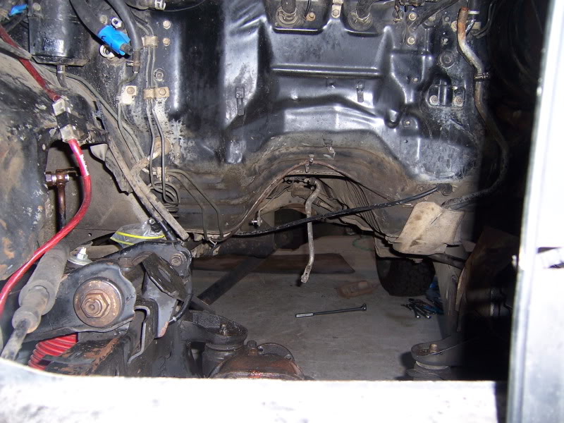

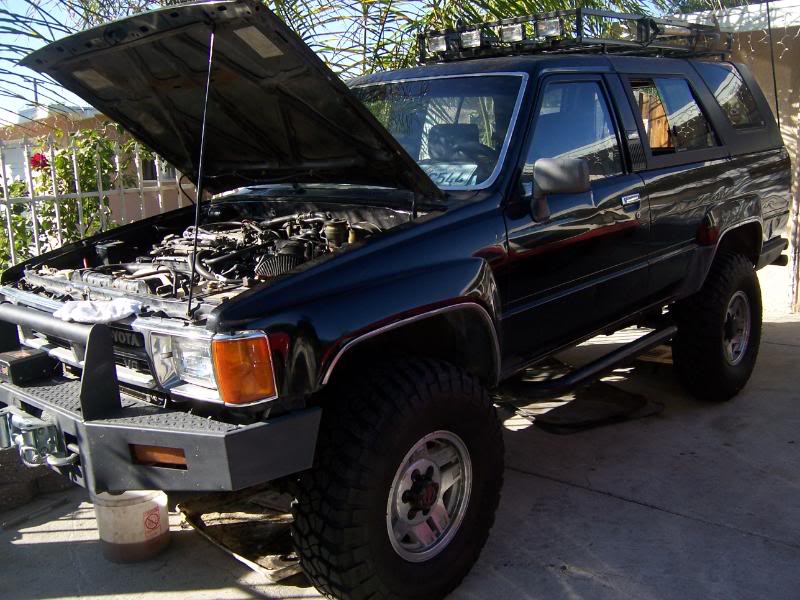

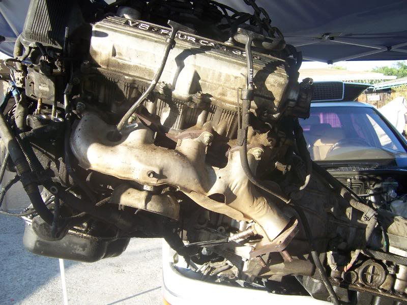

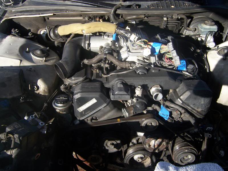

So on monday I started to pull the engine from the 4runner , tuesday I got the engine out took me about 4 hrs total ,the tranny is still in the truck will pull it tonight .

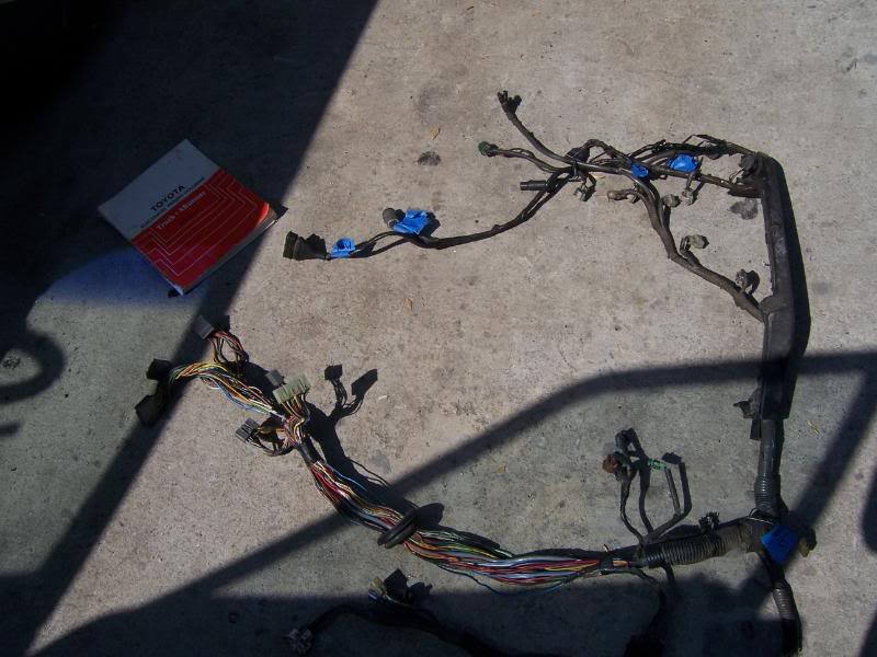

Thursday I started to label wires and finish removing some of the stuff I will not need .

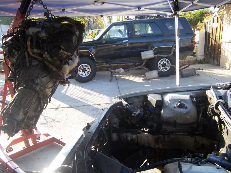

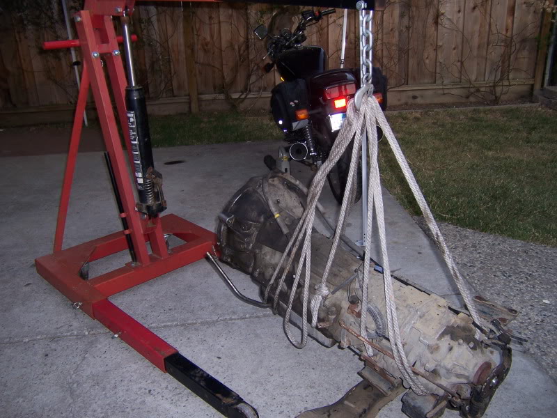

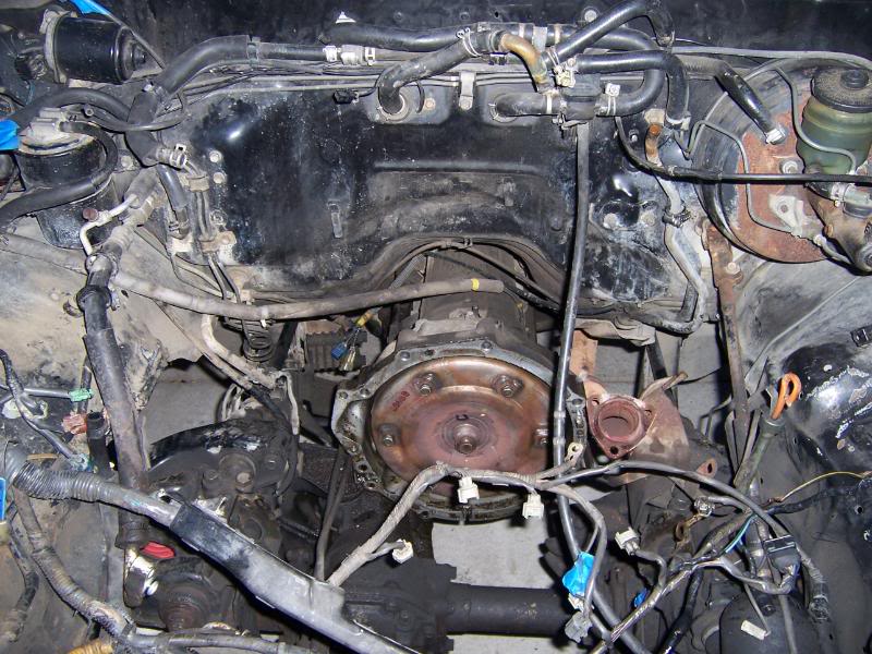

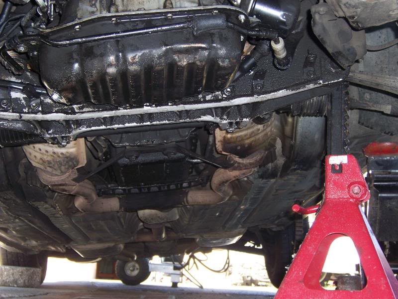

So I was able to remove the tranny and complete exhaust.

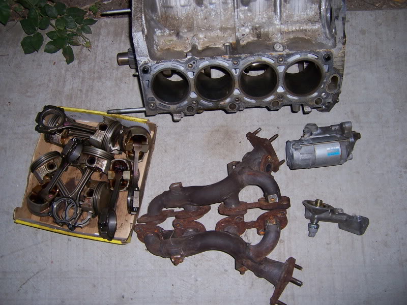

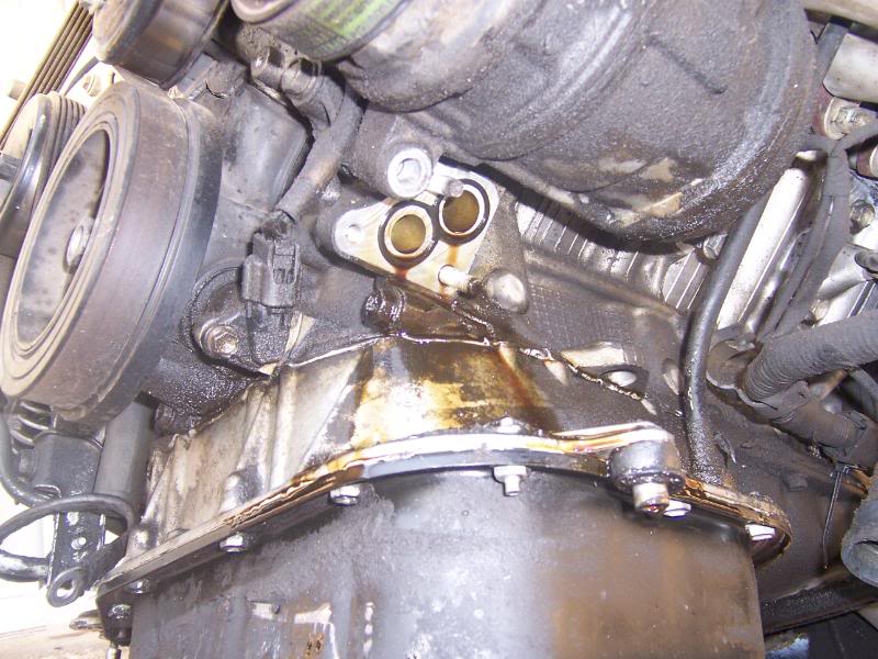

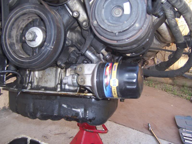

I also picked up a spare 1uz block so I can rebuild it , and a set of sc 400 exhaust manifolds along with the sc oil filter housing and starter.
I have read that the ls 400 maniflods do not fit in between the frame and that the sc manifolds do , so we'll see, also the oil filter hits the frame when attached to the ls 400 oil filter housing and that the sc housing will help this clear, again we'll see.

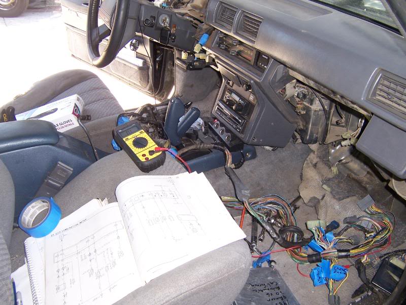

Ok saturday I was able to put in about 2 hrs of work and spent it just goin thru the wiring in the 4runner. I have the toyota electrical wiring book for the 1988 4runner and some of the wiring inthe book is not correct to what is in the truck . I had to trace some wires to make sure they what i need .
Mainly dash cluster wires. I aslo downloaded all the info I need as far as wiring from TIS or Techinfo.toyota.com.
The wiring diagrams for the lexus are so much better then the book I have for the 4runner , everything is in color and makes things so much easier.

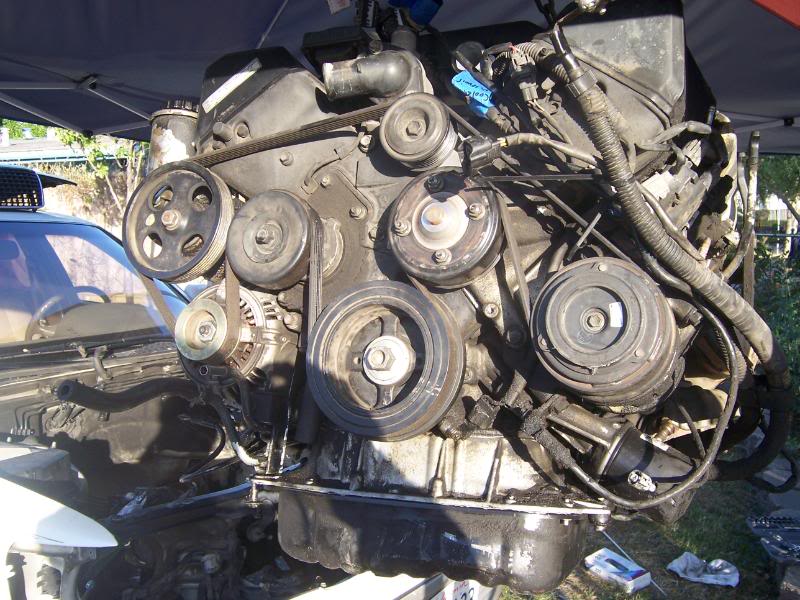

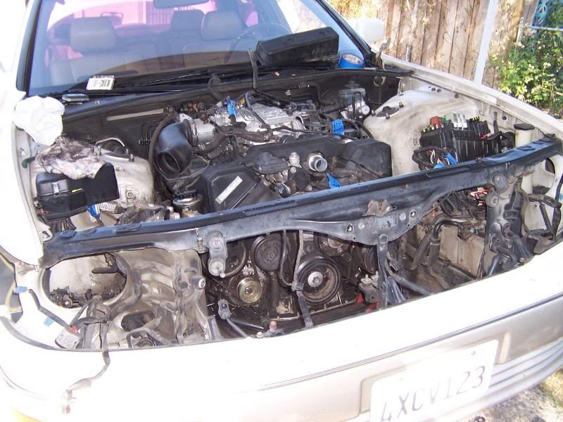

Today sunday I spent about 4 hrs working on the lexus I started to undo wires and hoses , getting ready to pull the engine. It was so hot out there ,man it was really hot.I spent the time working mainly on the top of the engine the only thing I did underneath was spray some pb blaster on some nuts for tomorrow.
After these pics I started to power wash the whole under side of the car just trying to clean some of the oil under there to make it a bit easier.

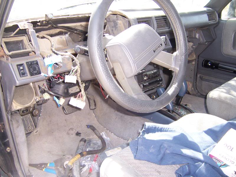

Ok so its official My wife thinks I'm crazy for tearing 2 perfectly good cars apart.
so after fighting with the dash from the lexus I finally just tore the damn thing up to get to the computer and unplug the wires for the engine.

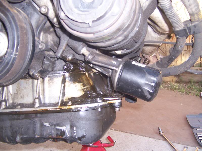

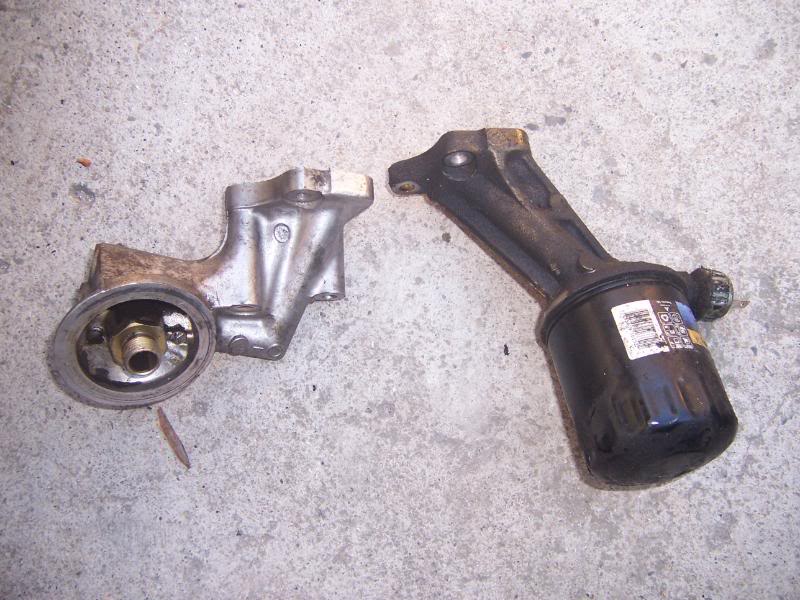

So I didnt have much time today to work on the car , the time I did have I used to remove the ls oil filter housing and was going to install the sc 400 housing but I did not have the longer studs .
All the reading I have done I never came across the fact that you need longer studs for the sc oil filter housing so I did not get them , now I need to pick some up.
ls housing on the right I will use the sc housing from the left .
Just a mock up not installed.

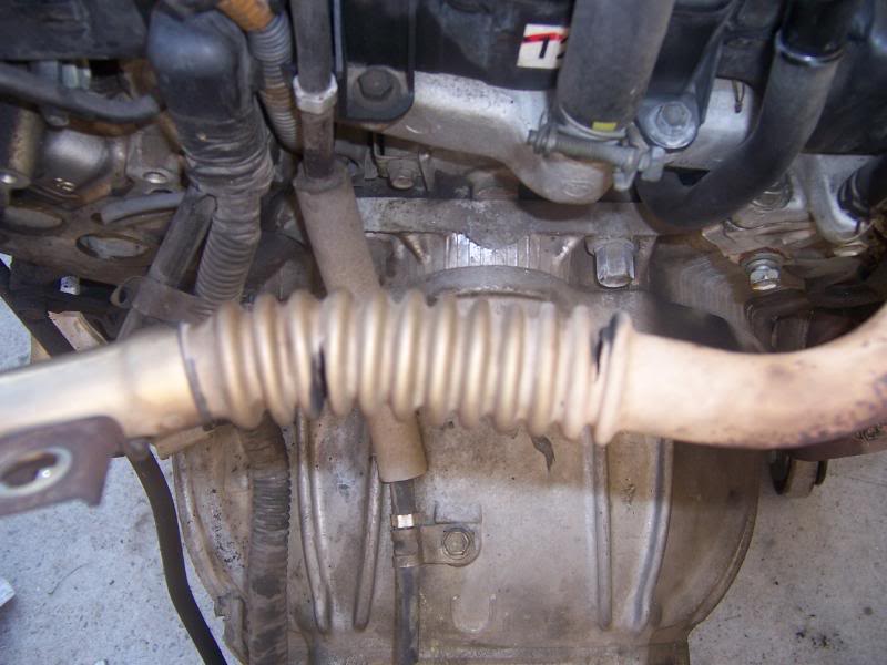

I removed the engine mounts and also the egr pipe was broken , which is common on these motors, I will also need to pick one of these up also.

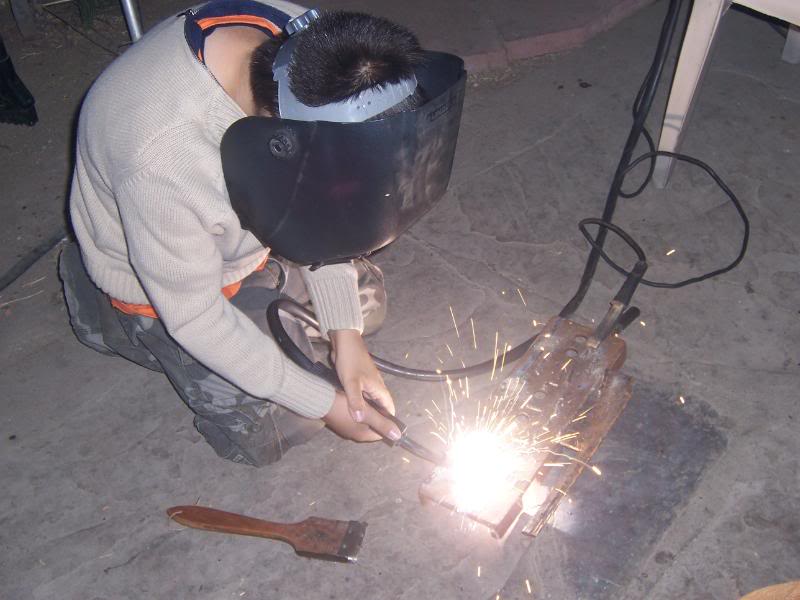

And just for the heck of it , my son playing with the welder.
I know I need to get him some gear.
So I need to pick some parts up and make some motor mounts , I will use the 3.0 mounts and add to them.
Old Jul 1, 2009 | 09:32 PM
whokrz's Avatar
Posts: 535
From: Suisun City, California
He is wearing more gear than I normally do, nice to see him learning to weld.

Spend $10 and buy the boy some welding gloves.
