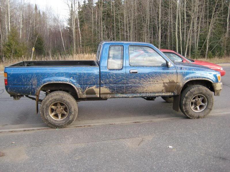

Drove it like this for the first winter

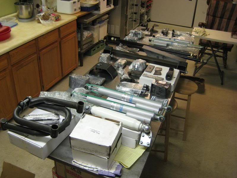

TG kit came in

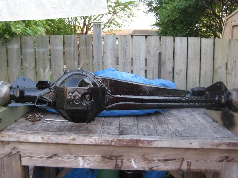

Painted with POR15

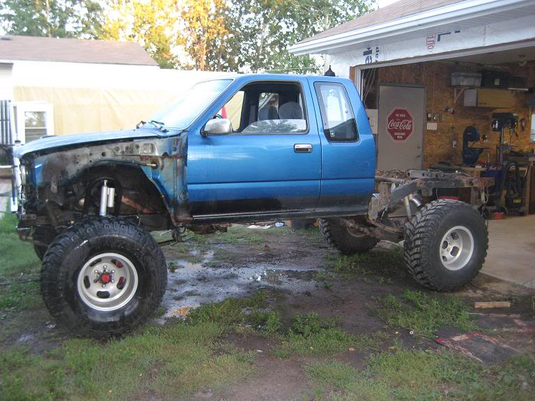

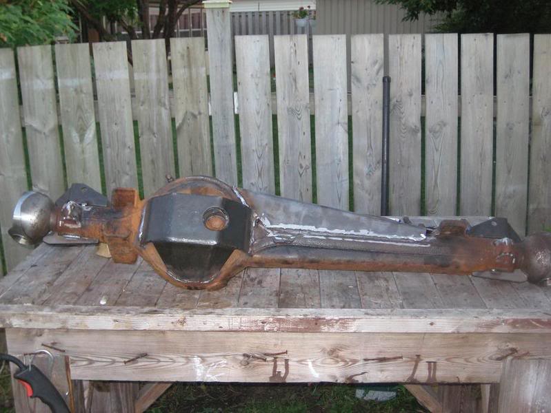

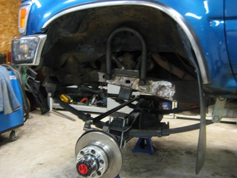

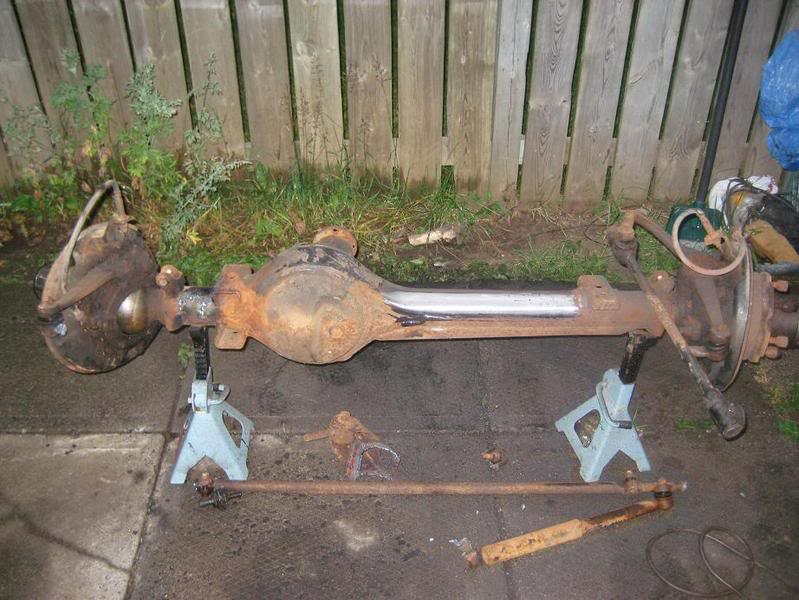

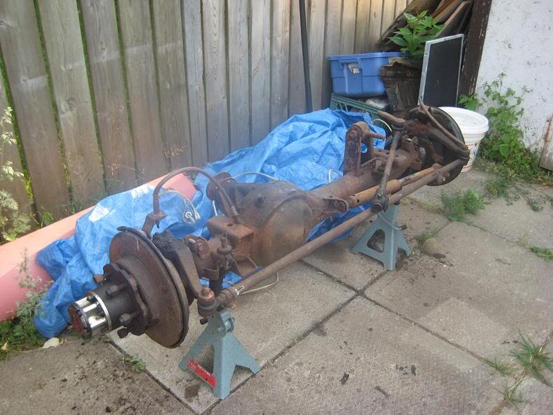

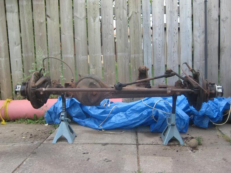

Fall 2008 i started the SAS

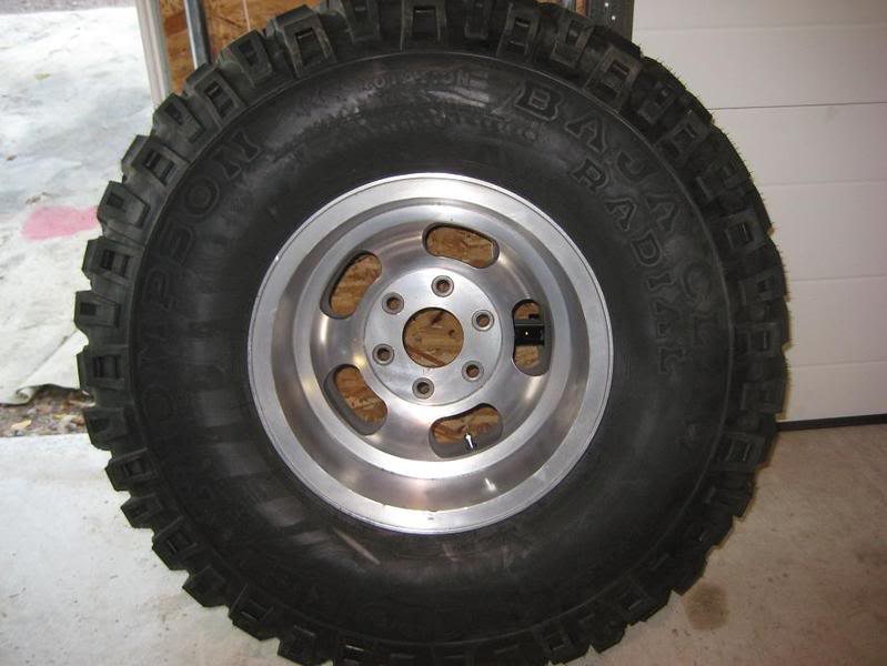

Picked up some Chevy Slot wheels from a swap meet

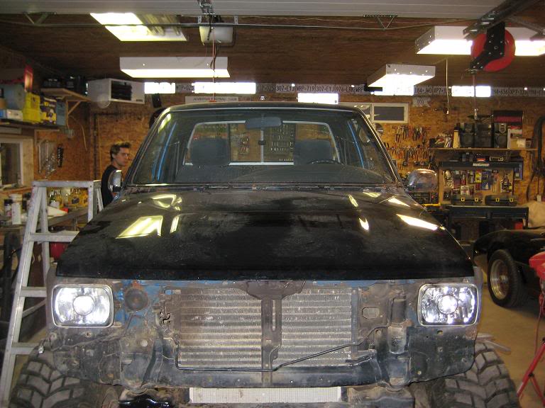

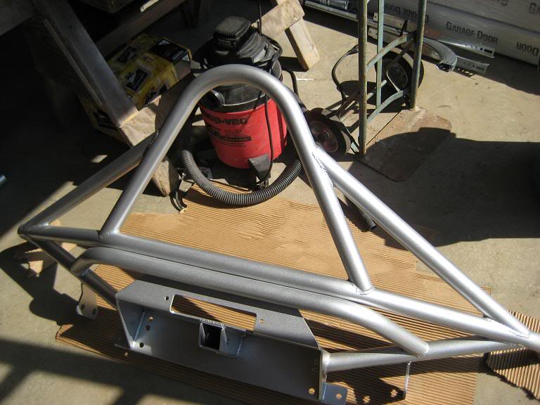

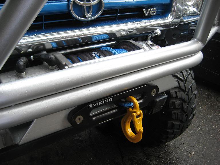

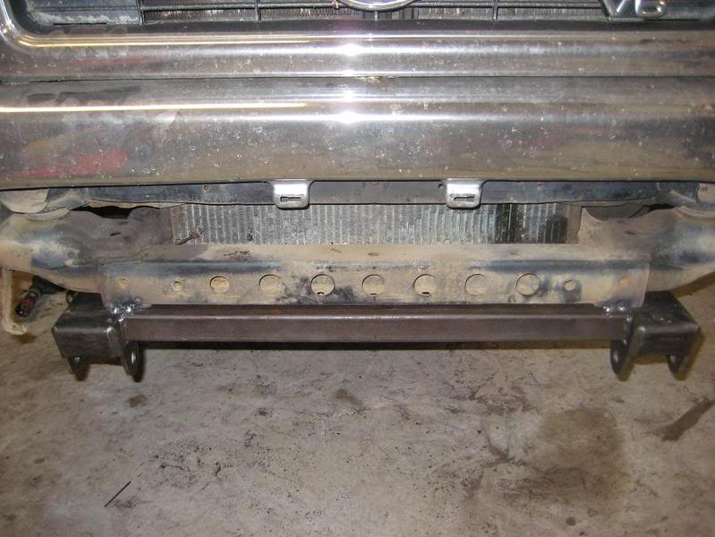

Put on a TG front bumper and Warn M8000

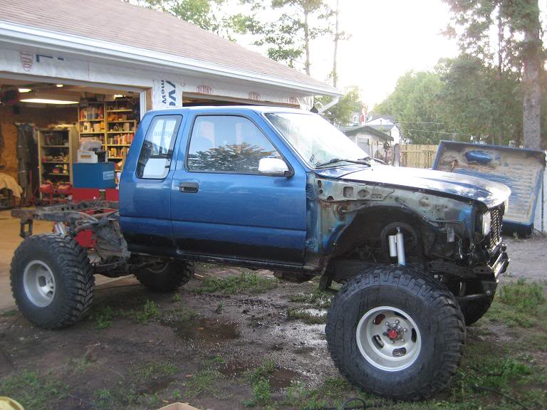

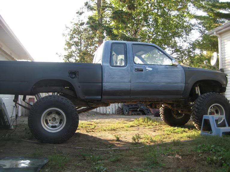

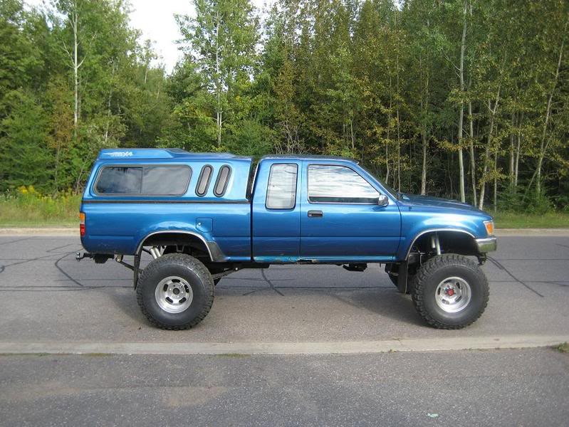

Winter 2008

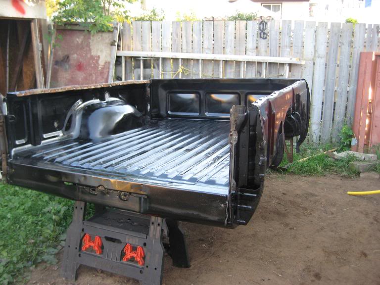

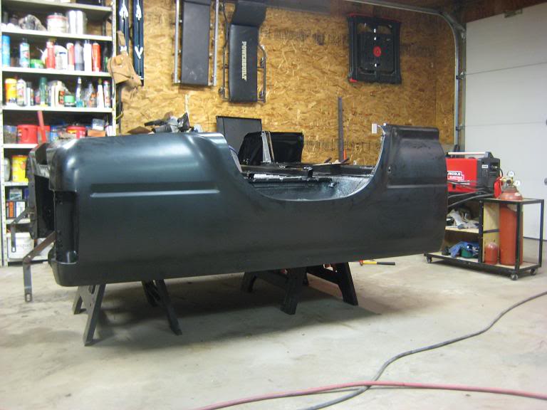

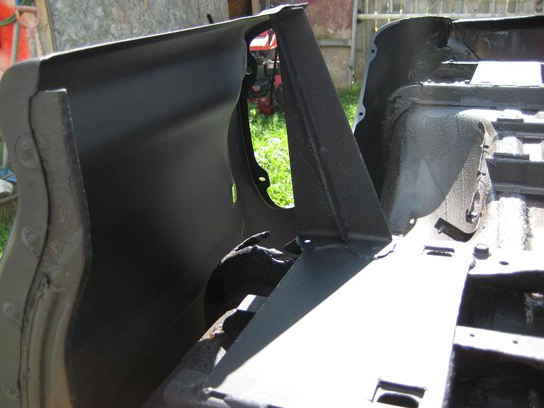

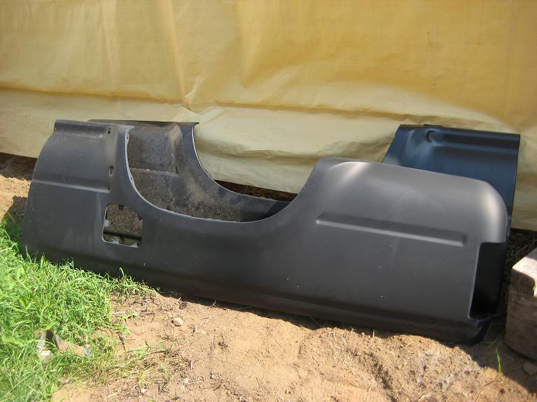

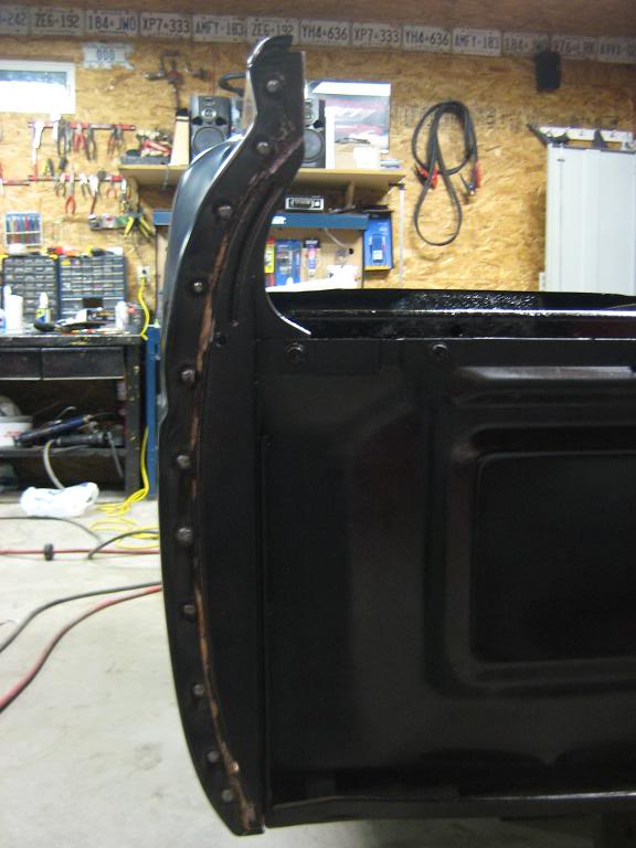

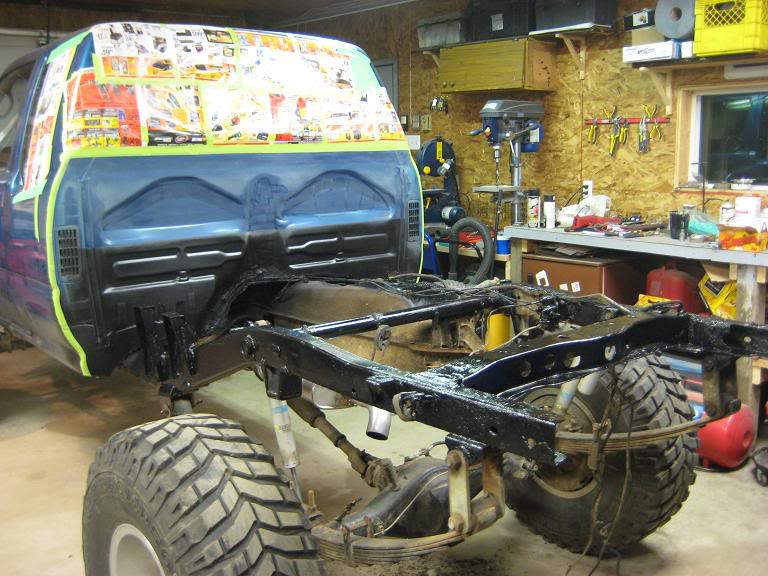

and decided to start on the body work so the search began for good shape box. found one with a nice bed but the sides were toast so ordered up some metal box sides.
Grind off all the spot welds andPOR15 the whole box

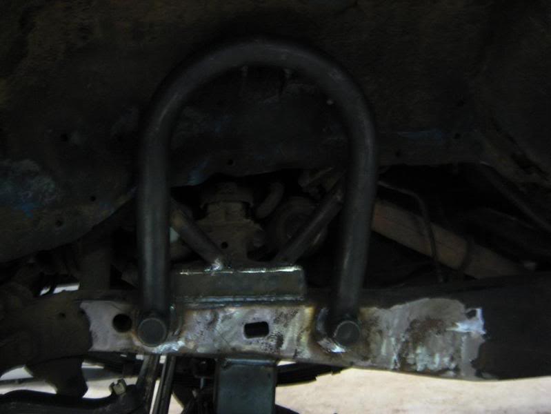

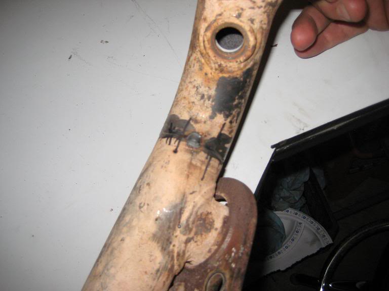

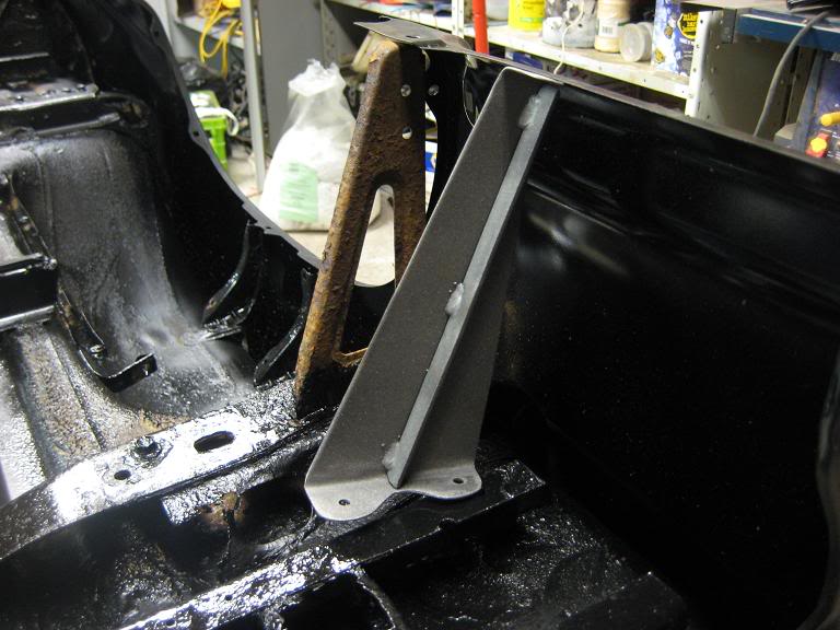

Made some new brakets to replace the old rusty ones

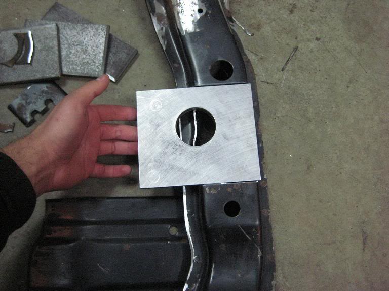

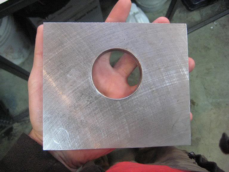

Made some plates to reinforce the bed a bit

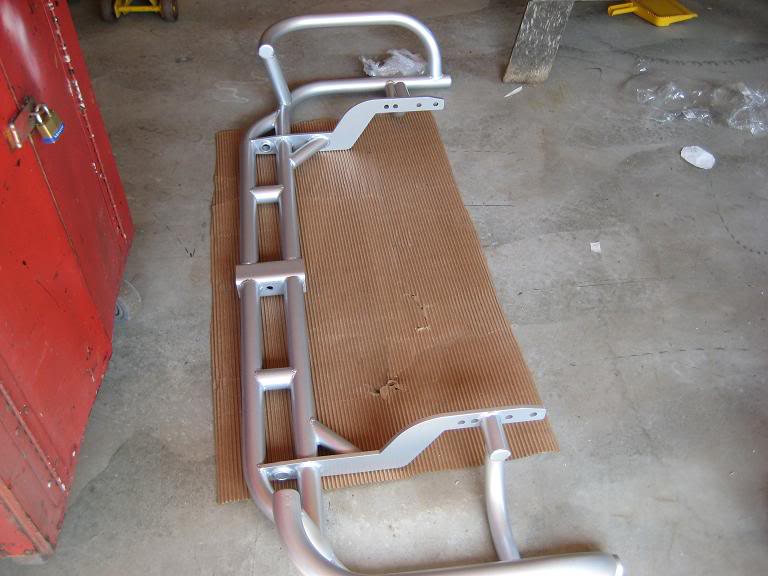

Powder coated bumpers

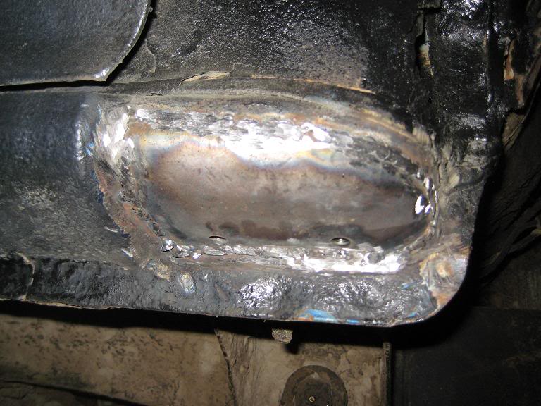

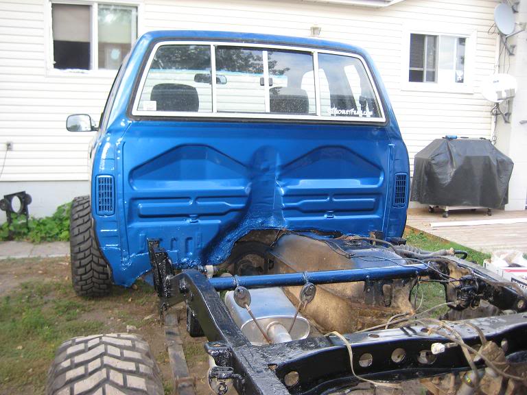

Cut some plate and fix the cab corners

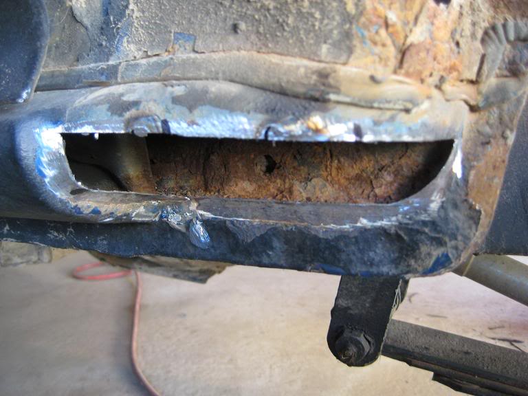

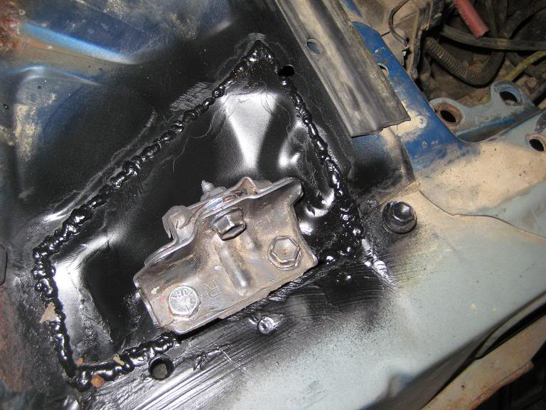

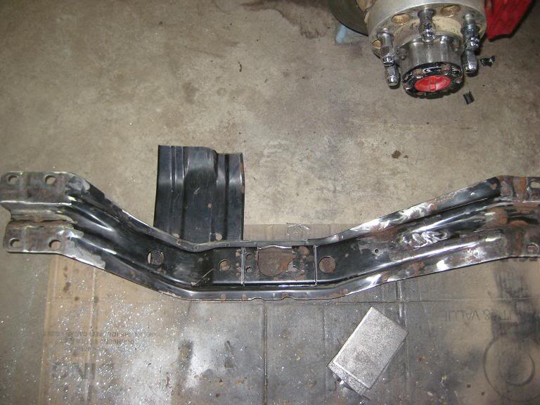

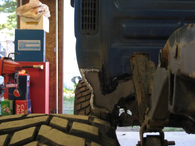

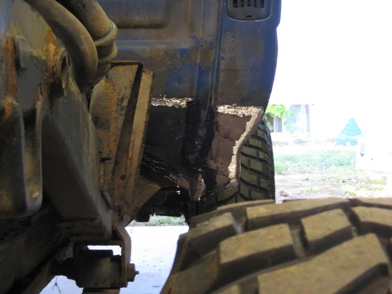

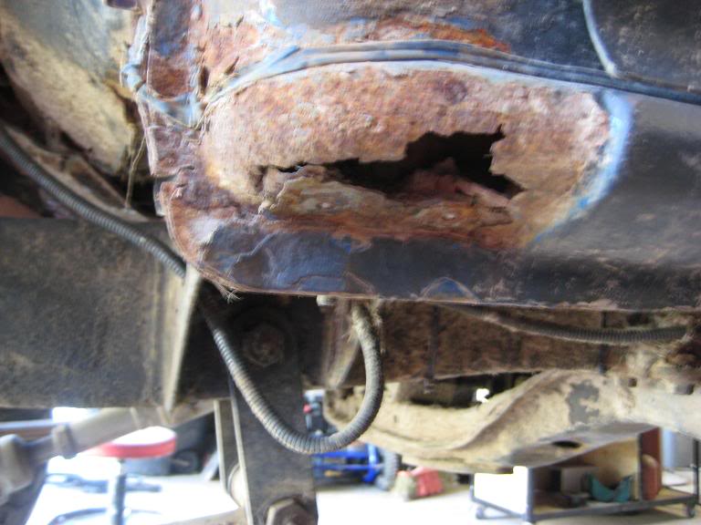

Front cab corners were all rusted also and the bolts for the fender no longer existed.... soooo i made some new ones

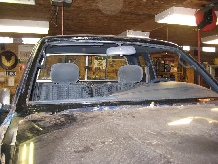

removed windshield to fix the rust around the window and POR15 it

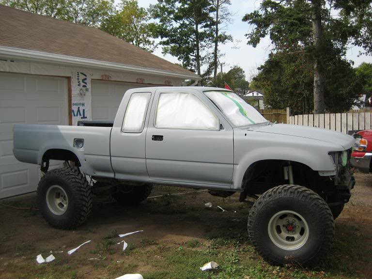

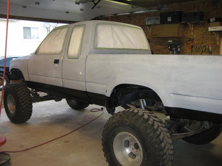

Primed

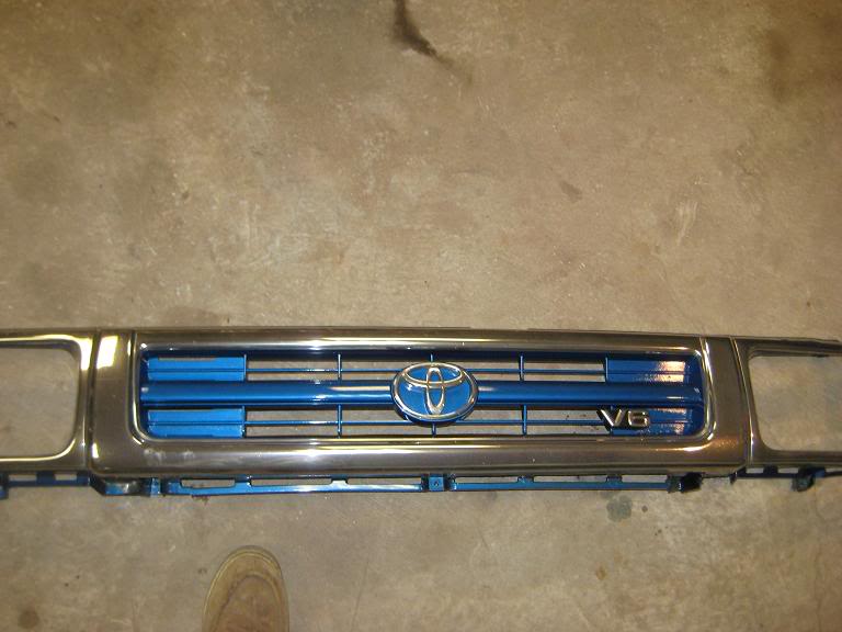

Painted the grill to match but it was a last minute thing while i had the black paint in my hand so i figured it wouldnt hurt to try and see how it looks.

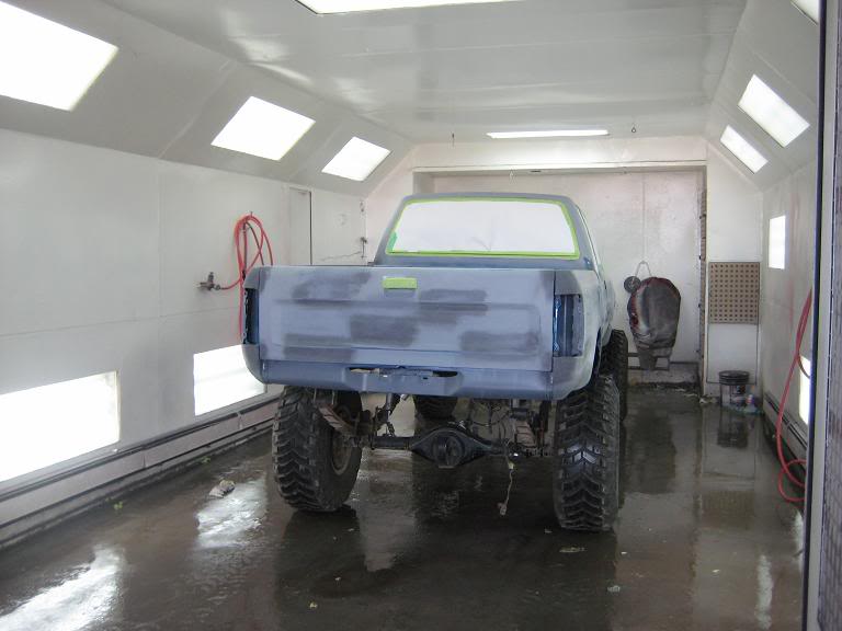

The paint booth

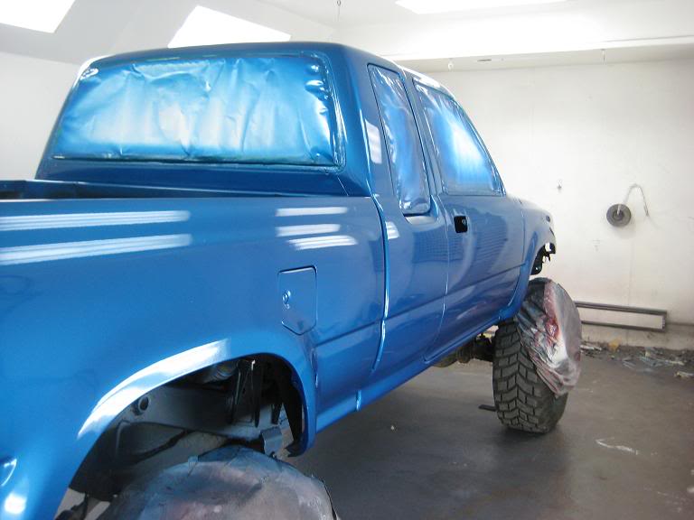

3 coats of base
3 coats of clear

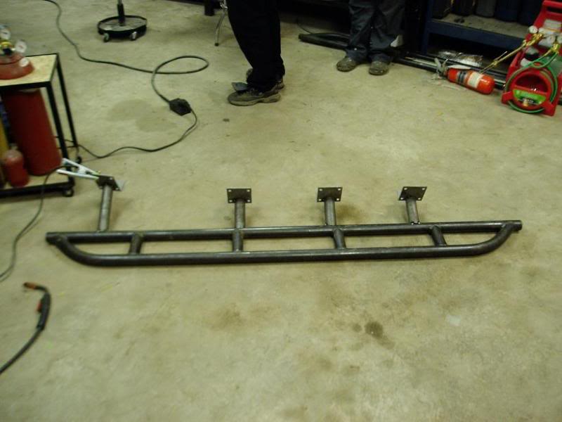

Put the rock slider together

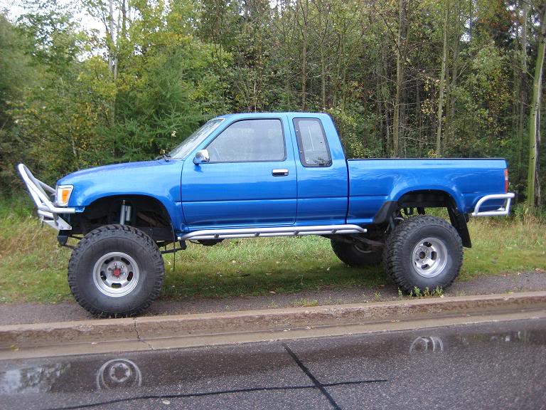

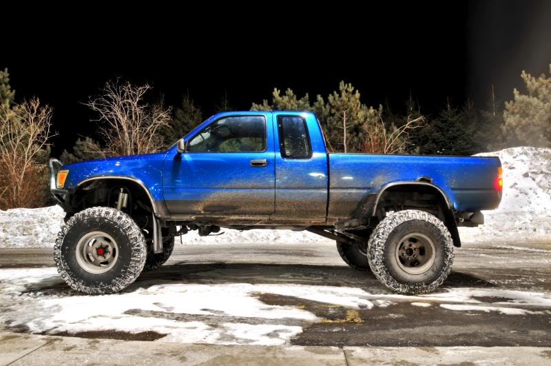

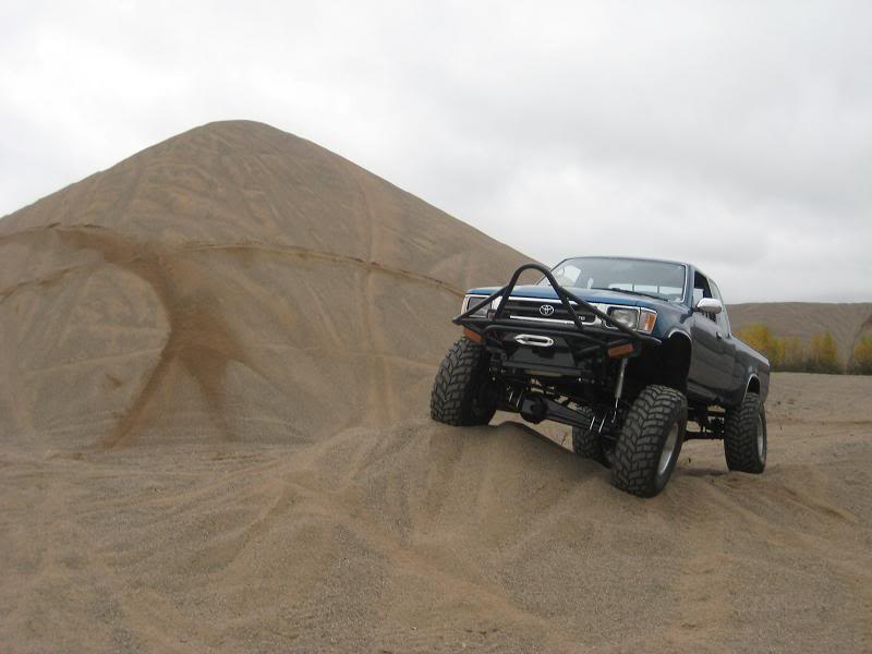

First day back on the road

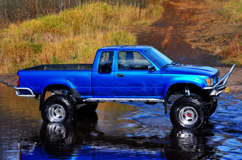

some more pics

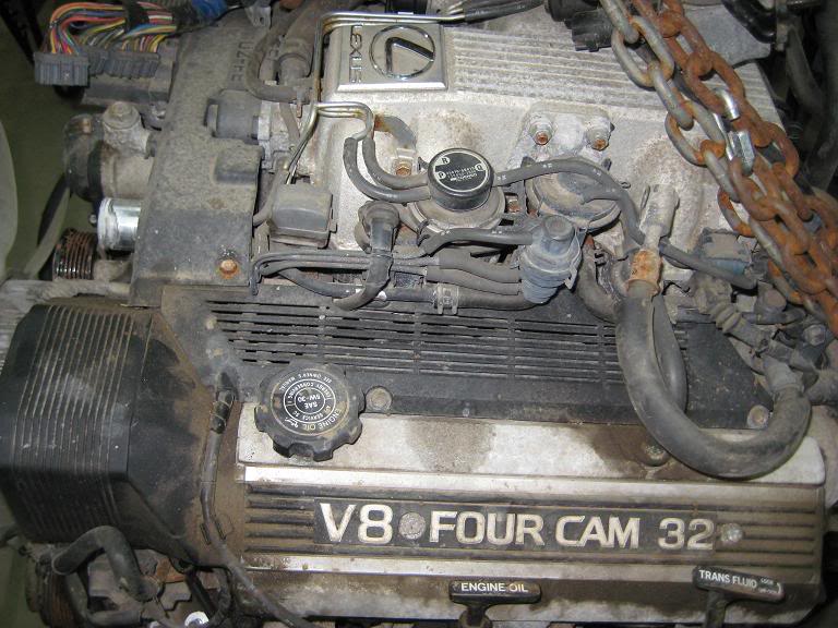

Fall 2009 brought this home
92 Lexus LS400 1UZ-FE

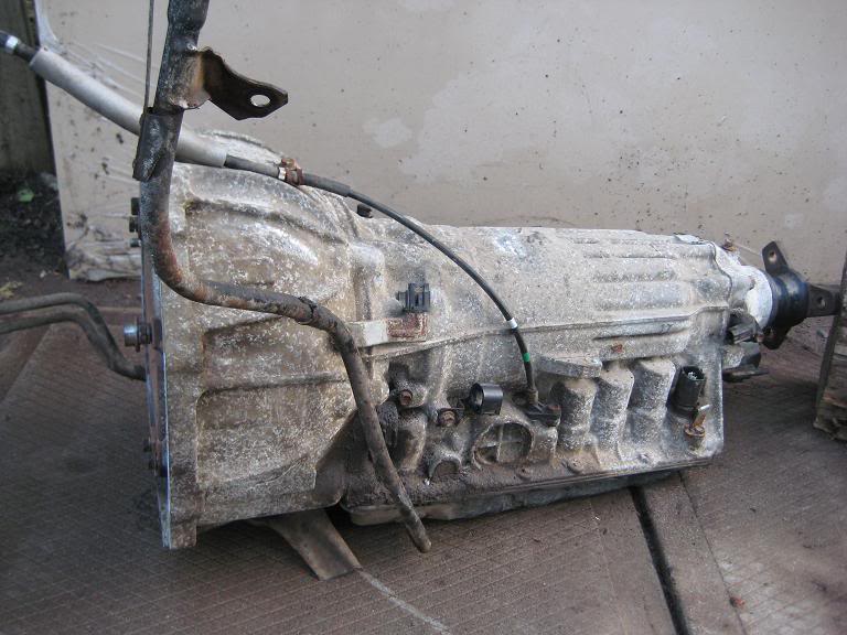

removed tranny

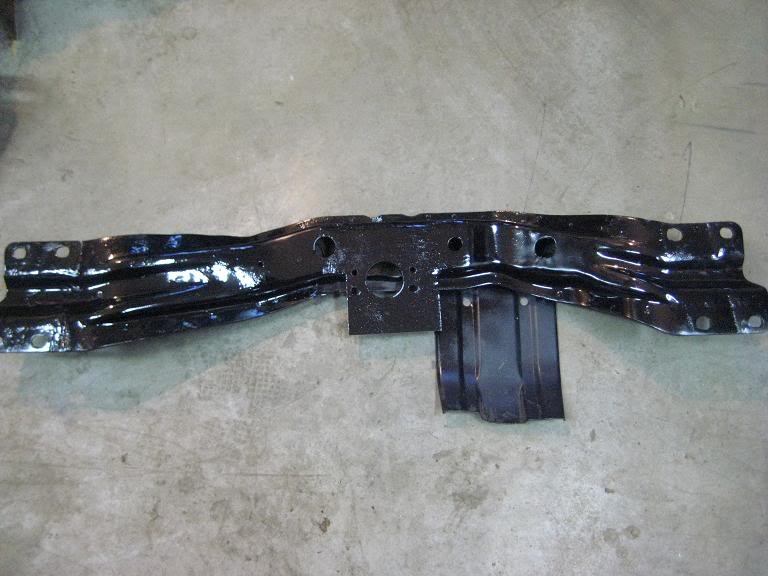

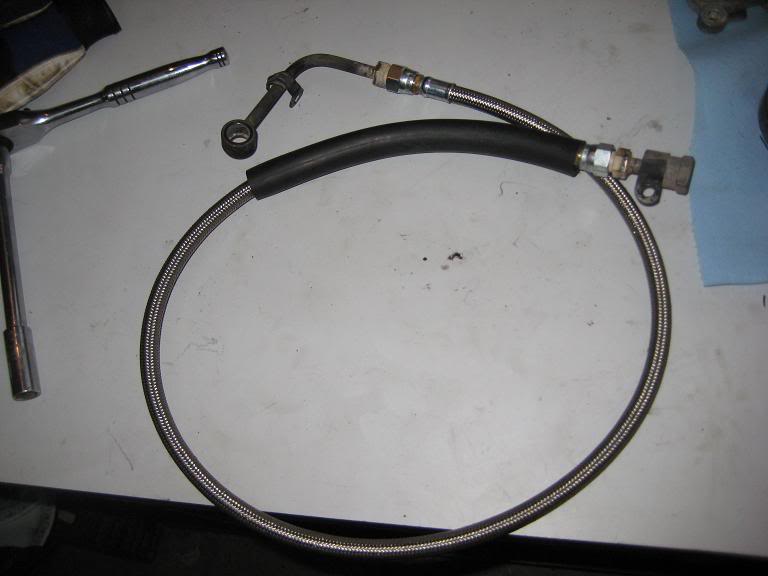

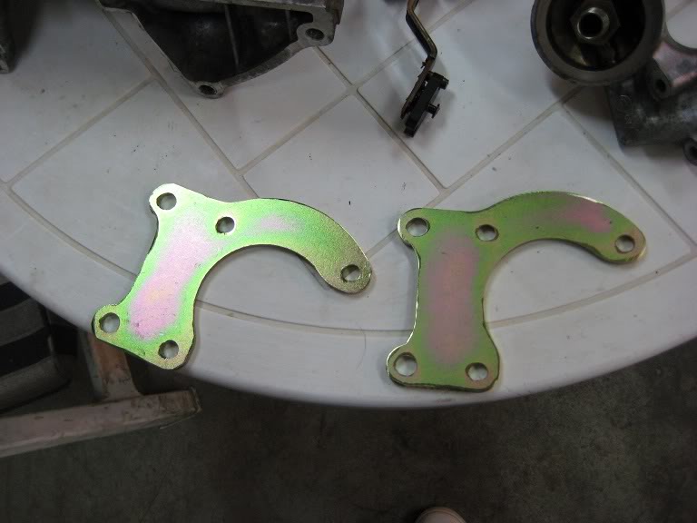

Rear disc brackets

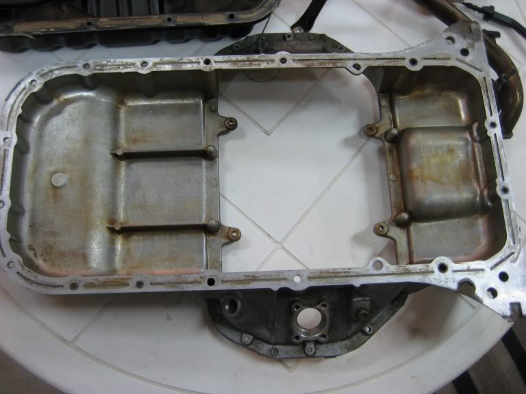

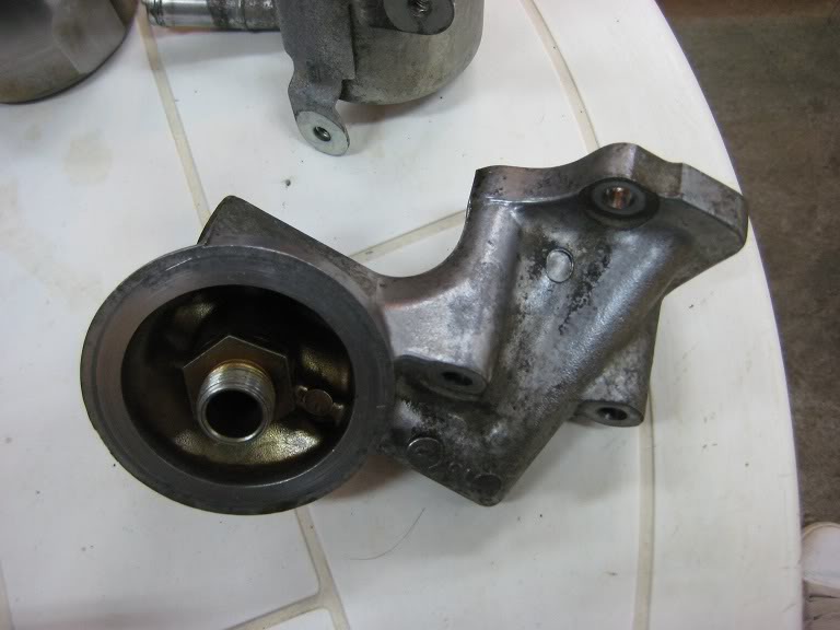

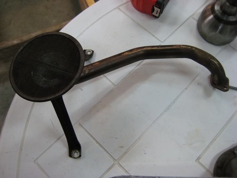

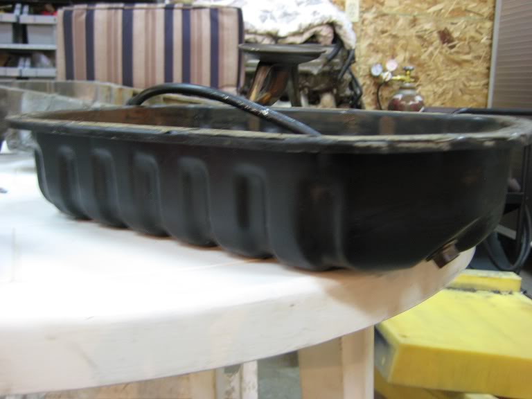

SC400 rear sump setup and oil filter mount

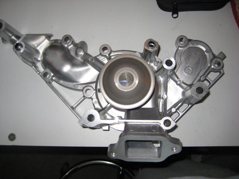

Water pump

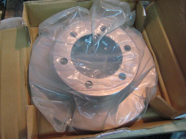

rotors

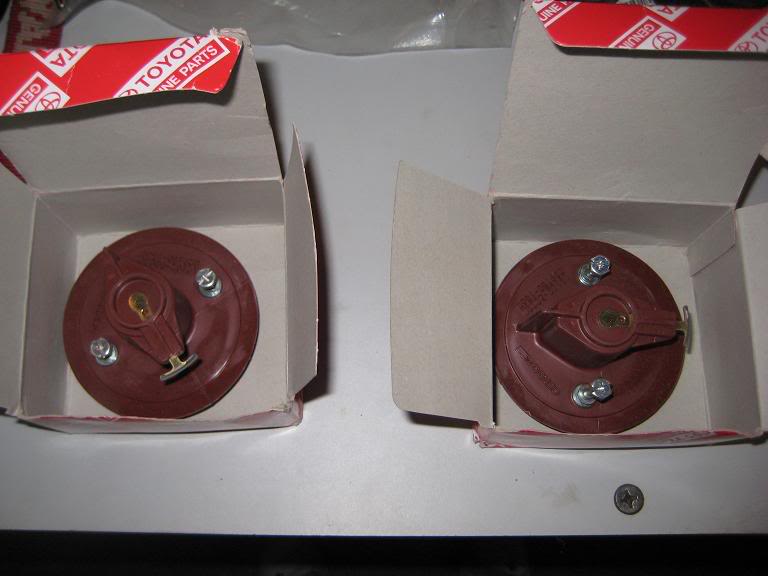

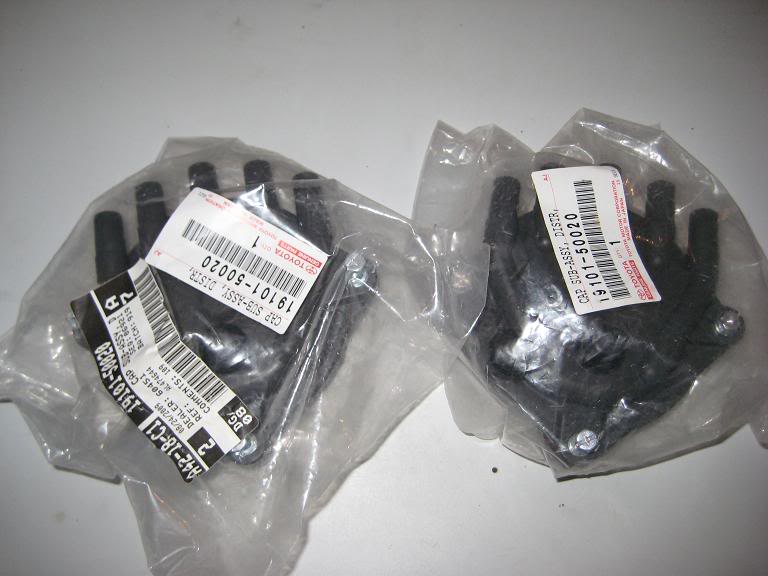

Caps

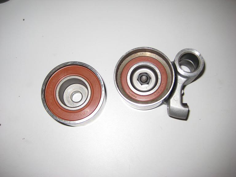

Timing belt pullies

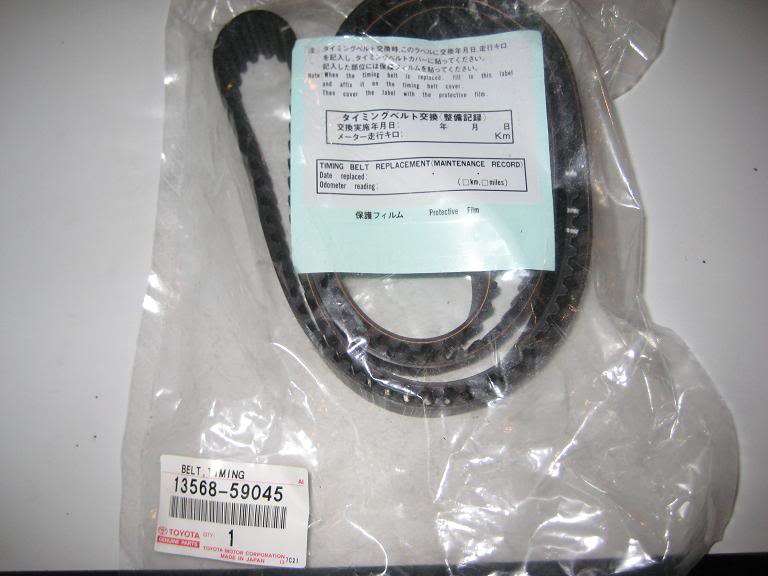

Timing belt

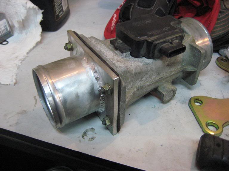

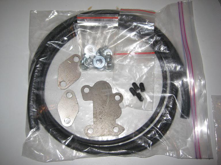

EGR delete kit

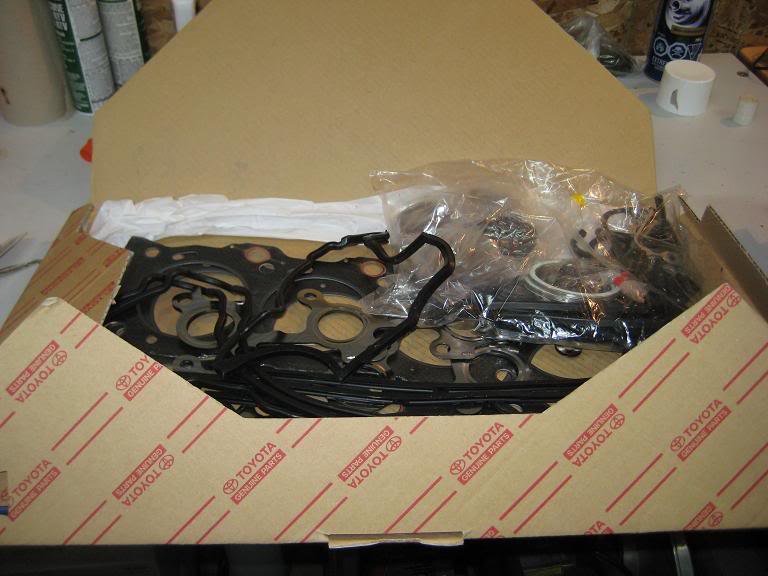

Full engine gasket kit

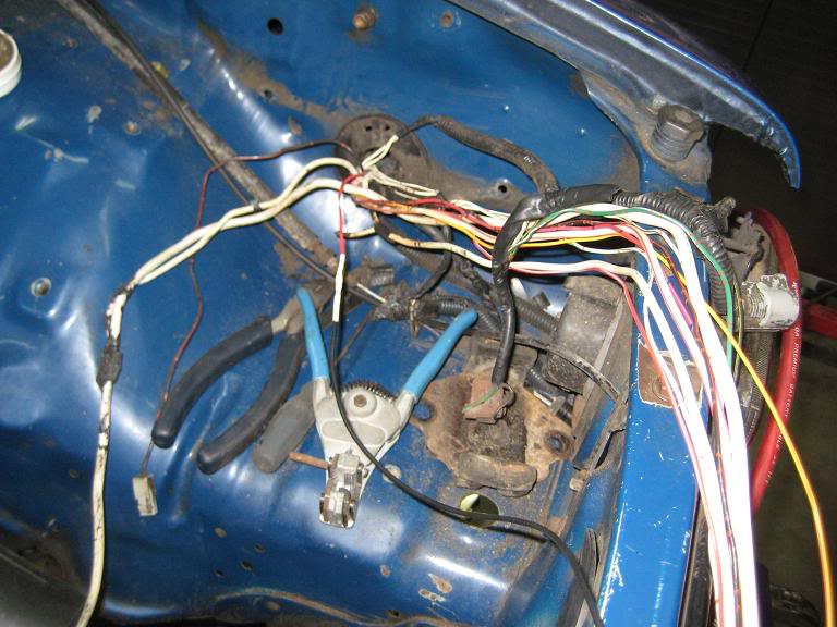

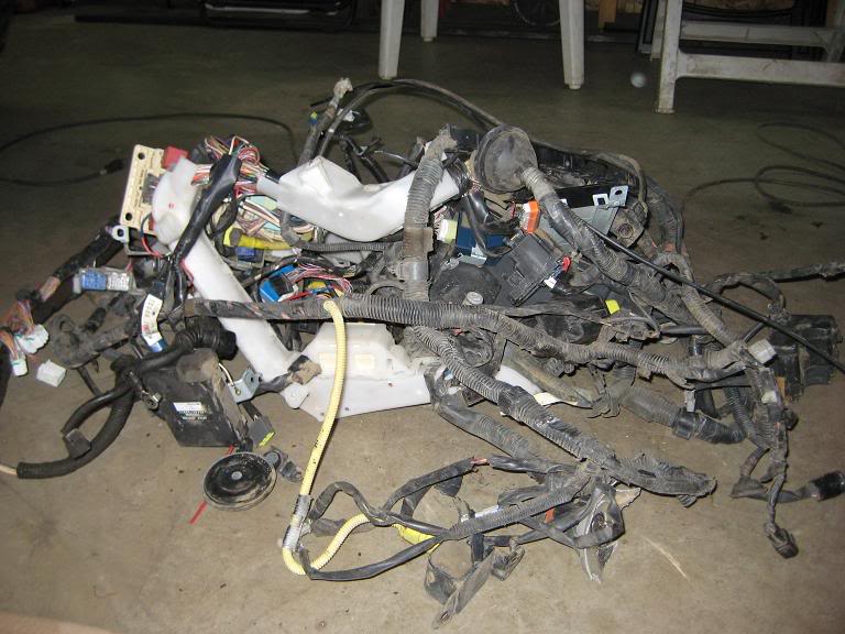

Wire harness from the car

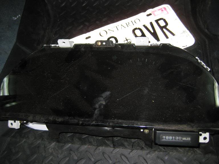

Lexus cluster

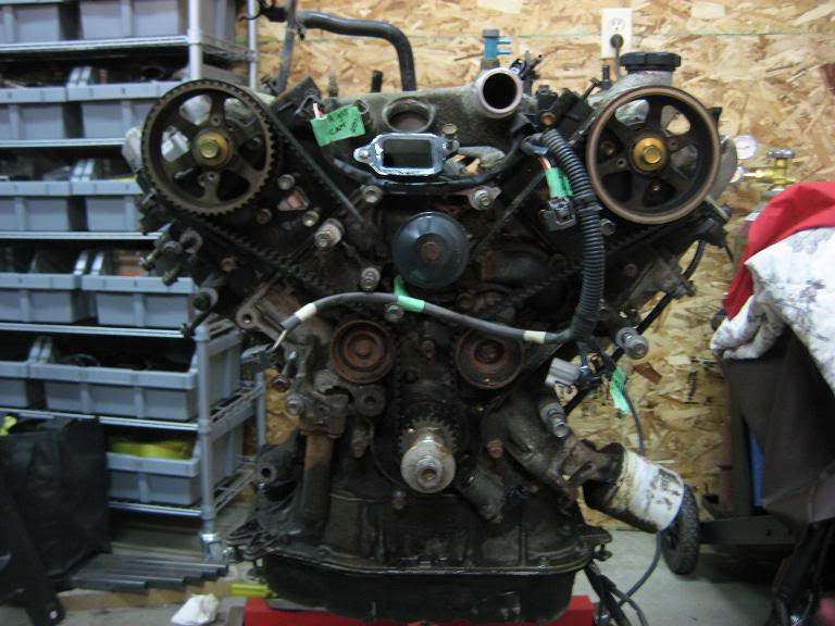

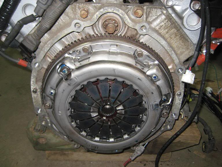

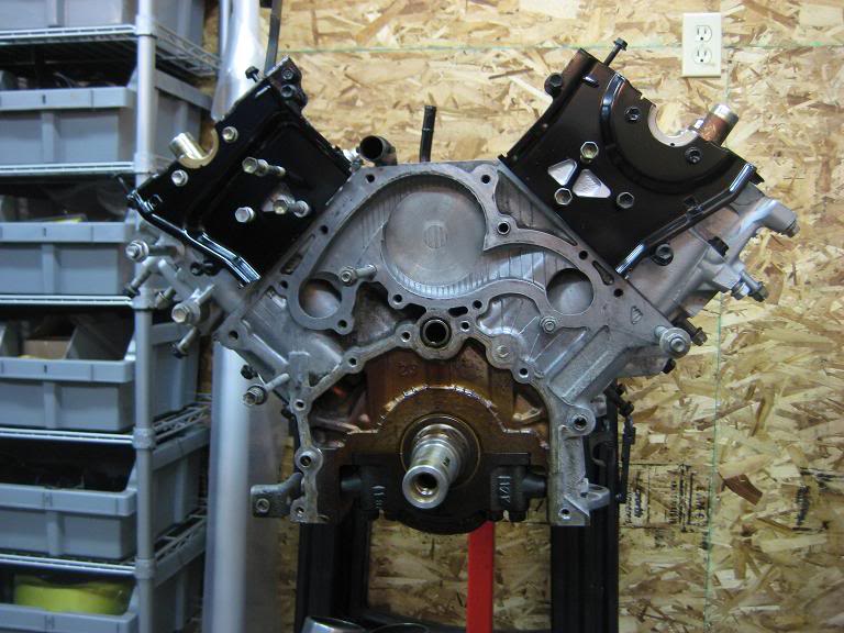

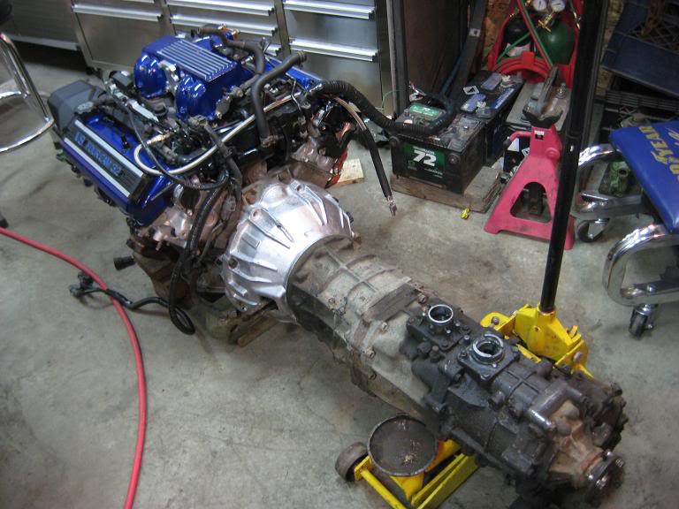

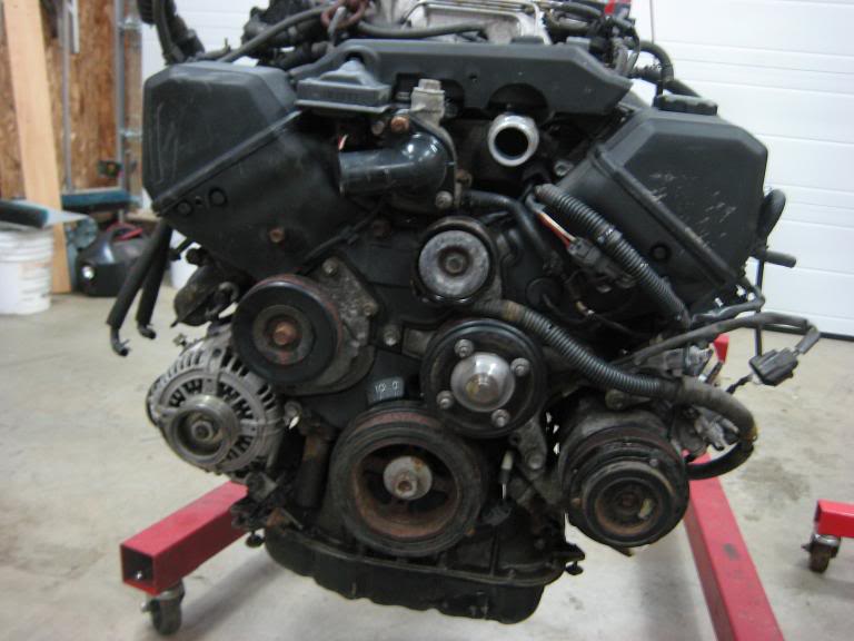

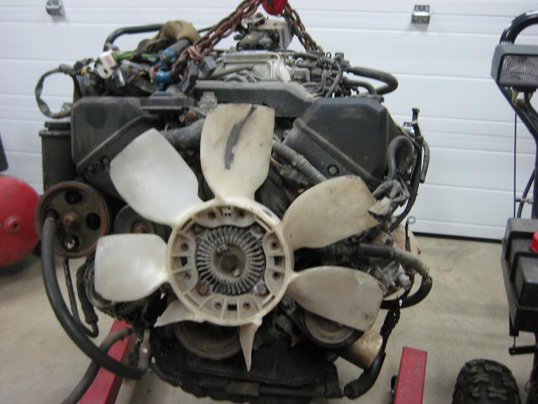

Started to pull the engine apart

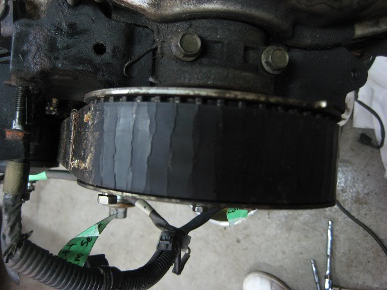

Nice timing belt lol

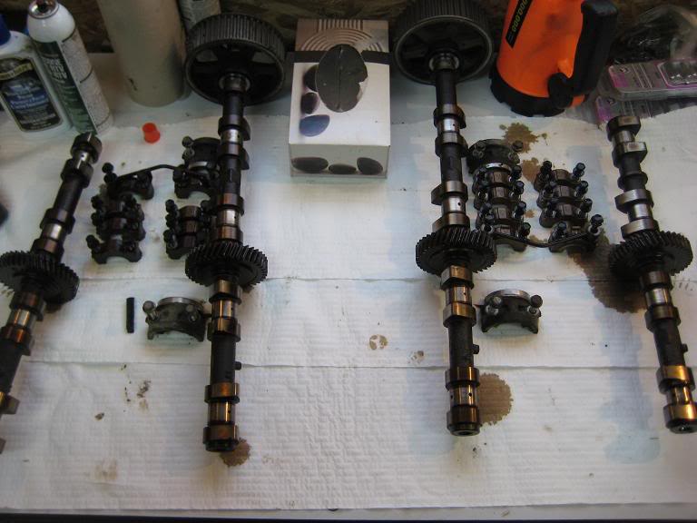

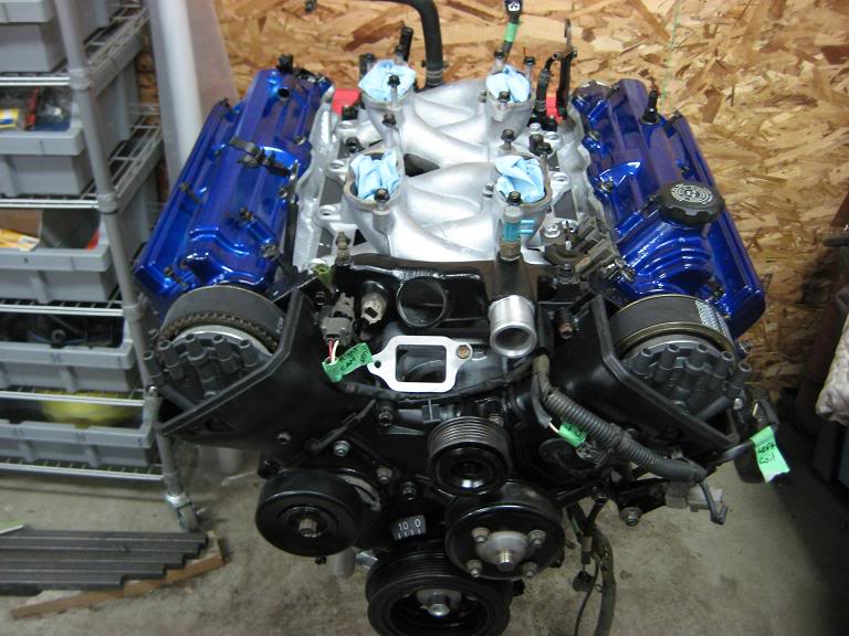

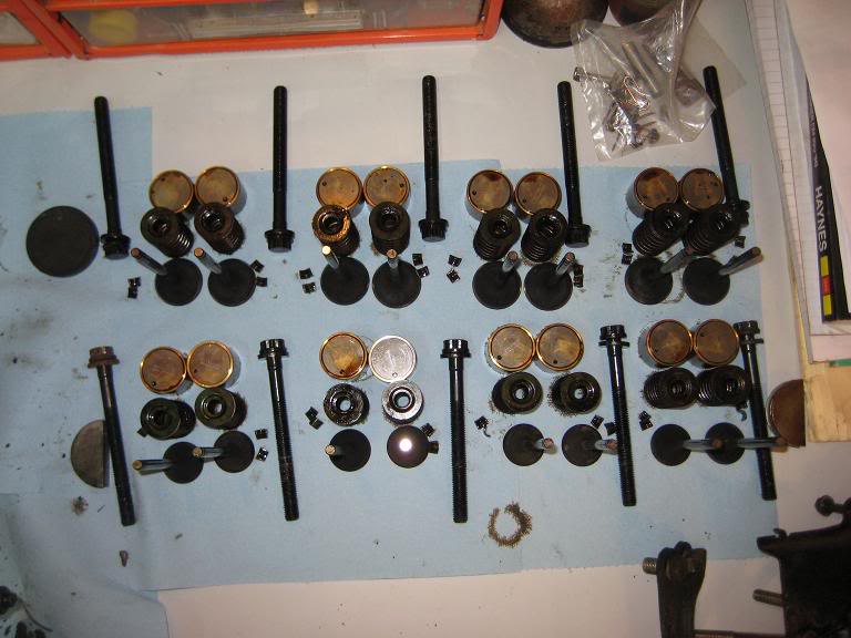

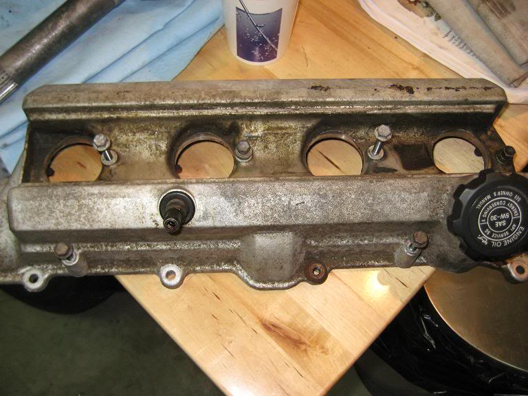

Pulled the heads apart to clean them and change the valve seals
Cleaned the block with some acid

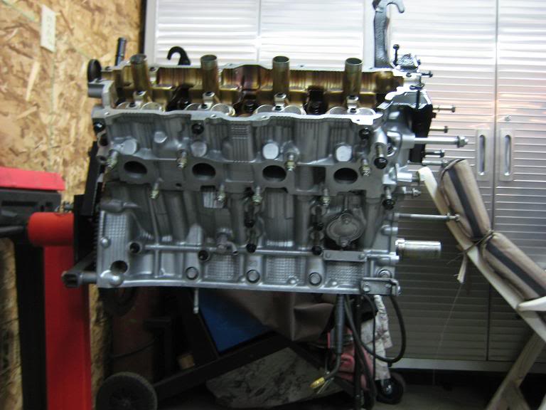

Heads back on

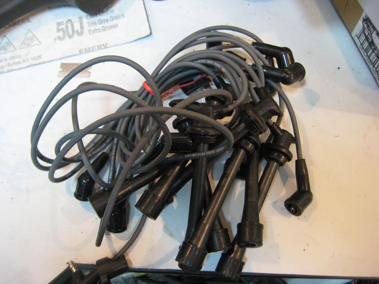

got some plug wires

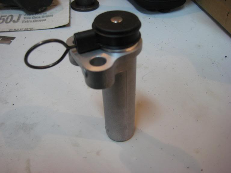

new timing belt tensioner

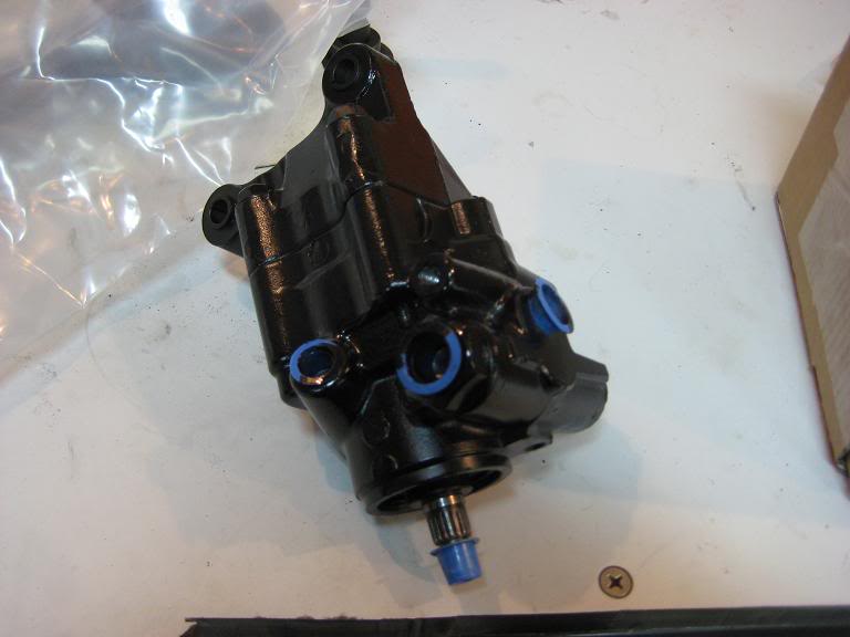

new power sterring pump

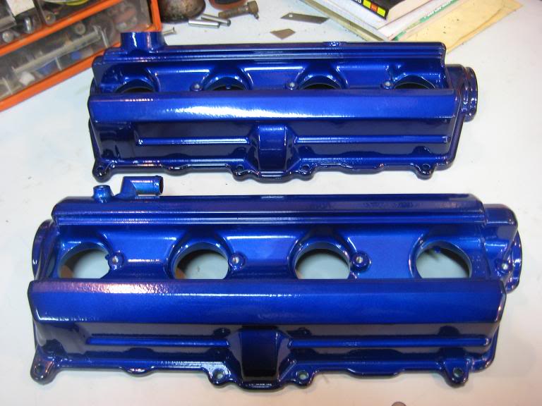

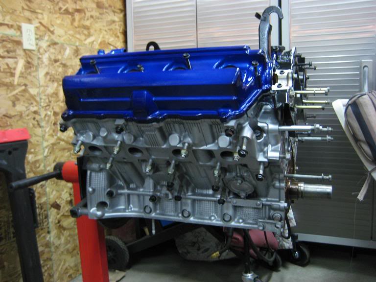

Powder coated the valve covers

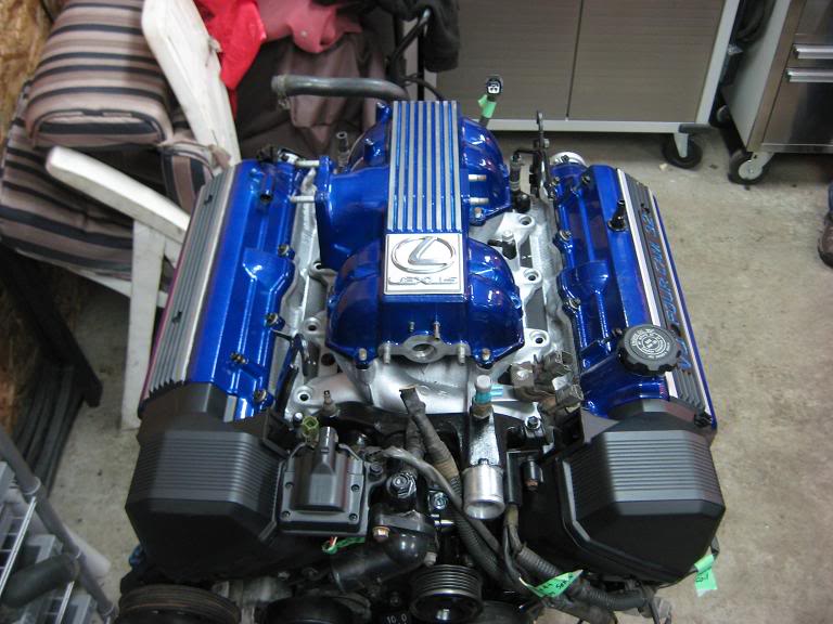

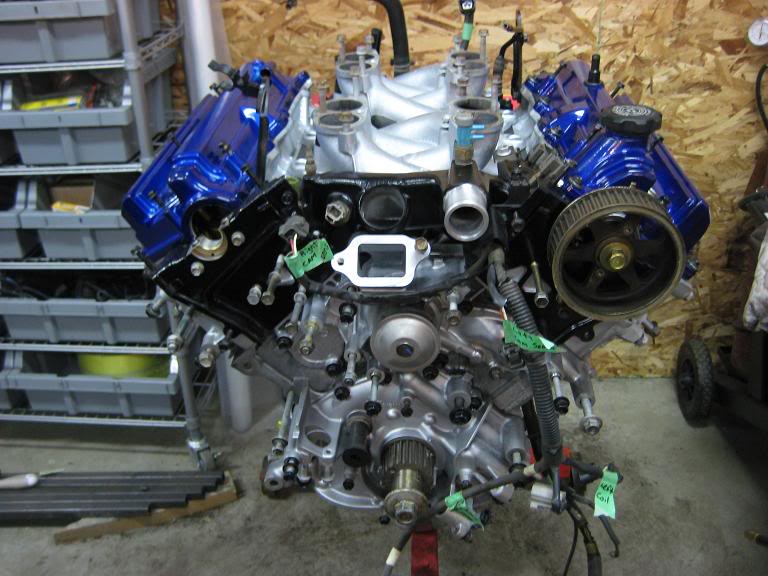

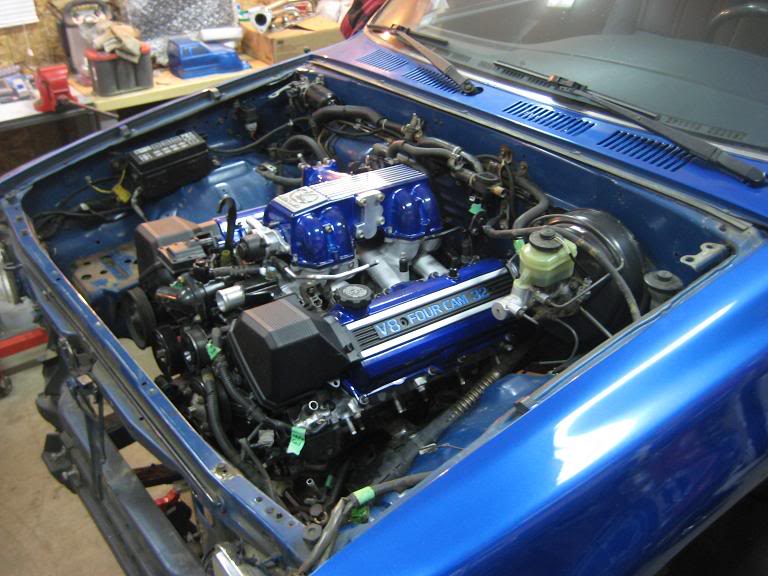

Almost back together

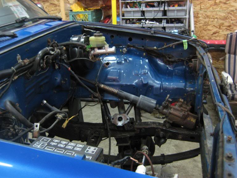

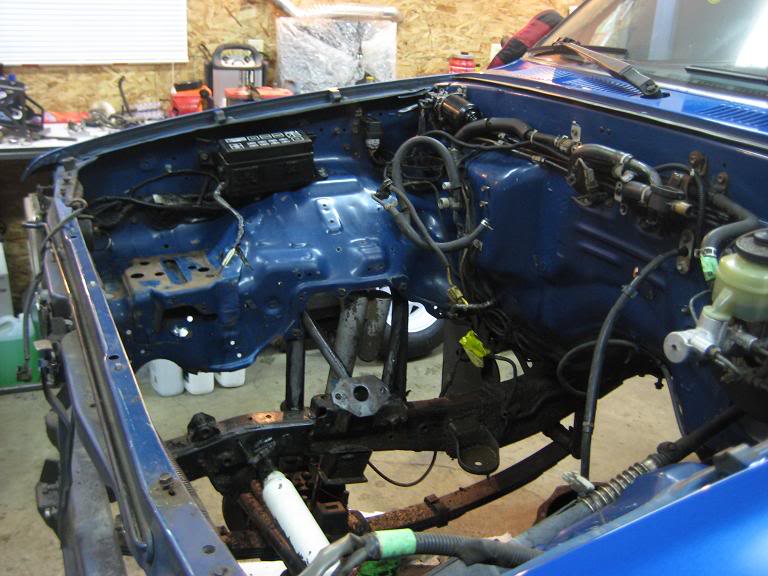

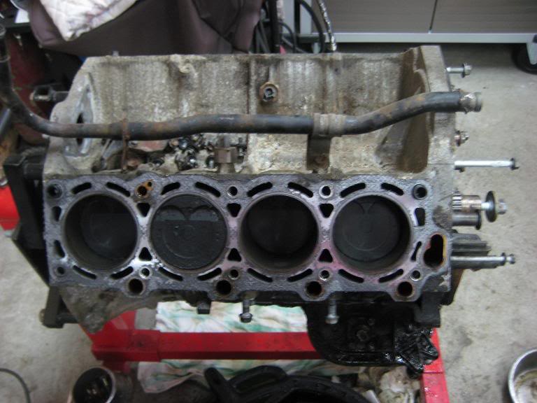

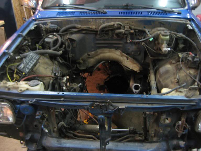

Pulled out the 3.0 and cleaned the engine bay. it was mid winter at this point so i had to lay down plastic and use a sponge with soapy water

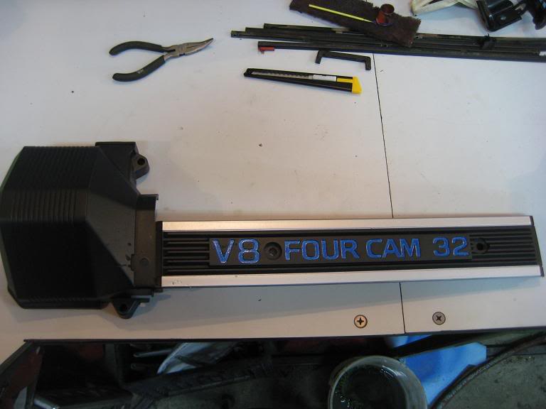

Painted the engine covers

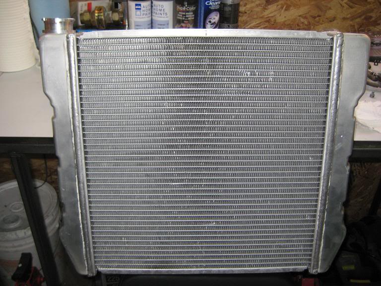

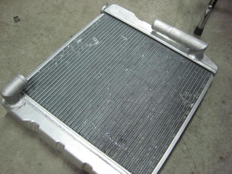

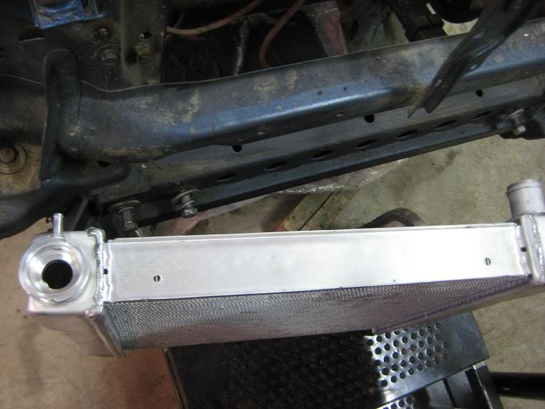

4 core aluminum rad

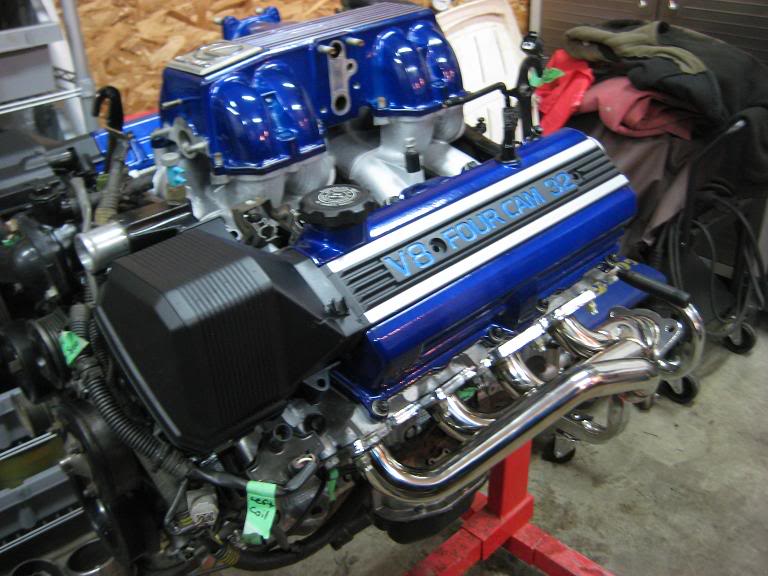

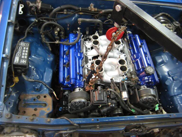

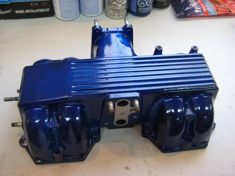

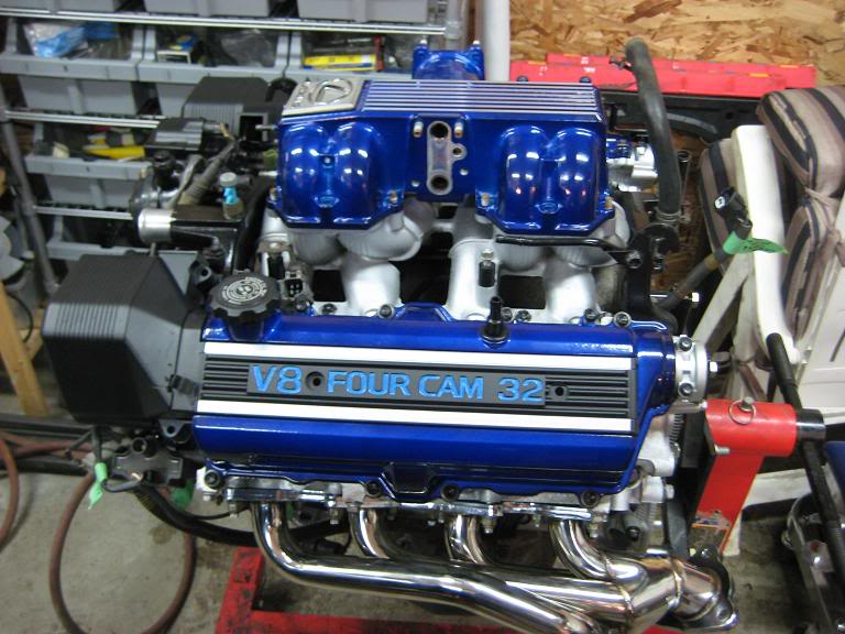

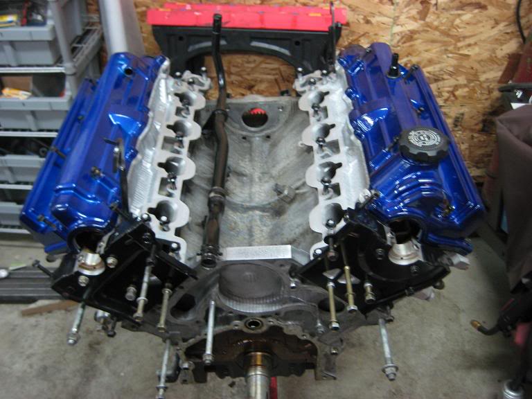

Powder coated the intake manifold
The first of many test fits haha

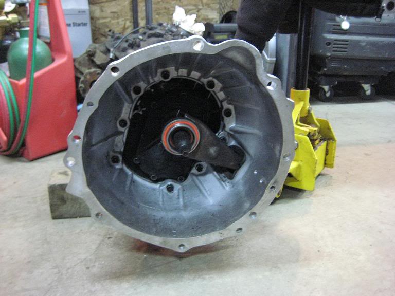

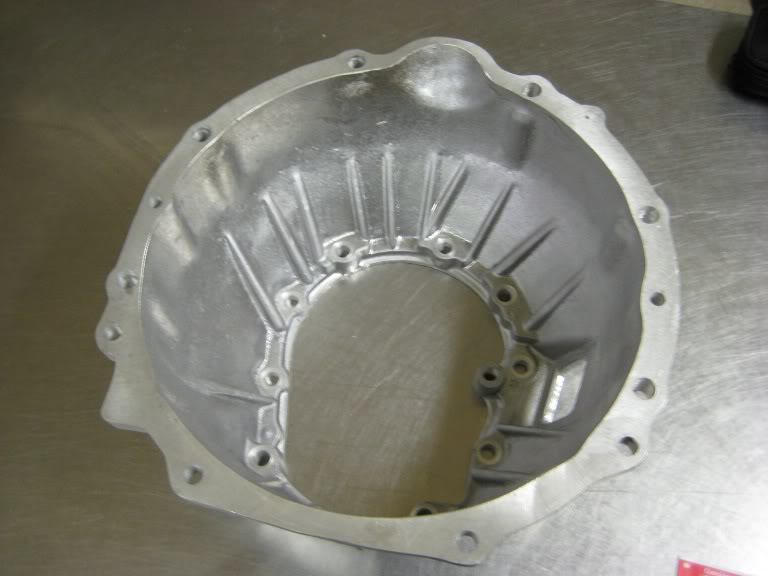

Then the bell housing for my R150F showed up from A1turbos

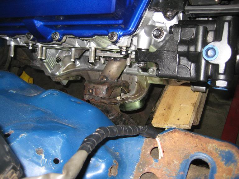

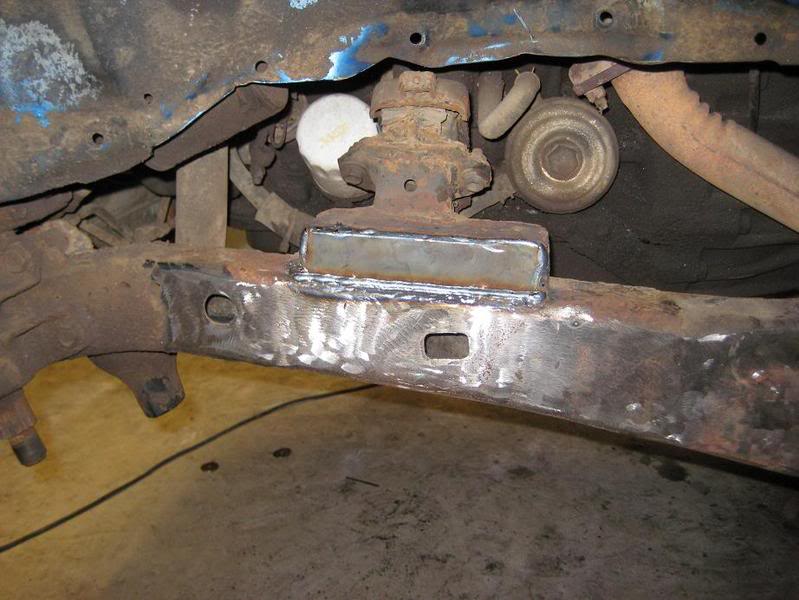

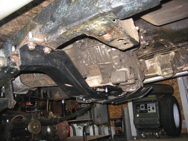

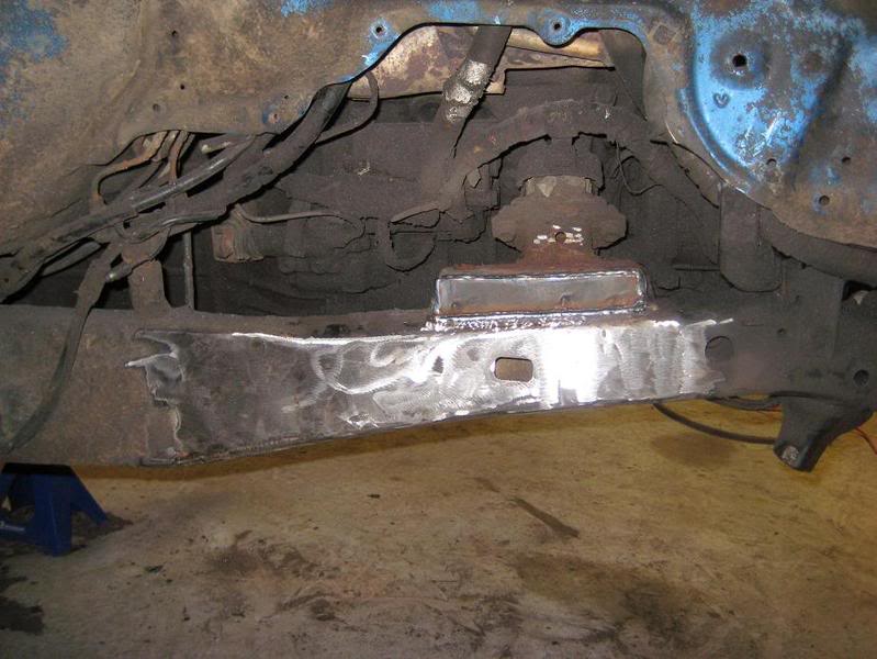

Another test fit with the tranny and new bell housing on. Started on the motor mounts

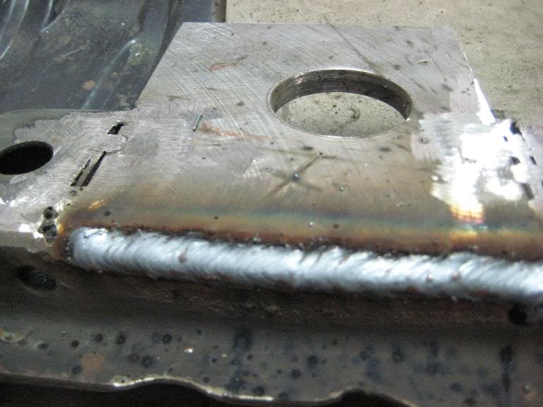

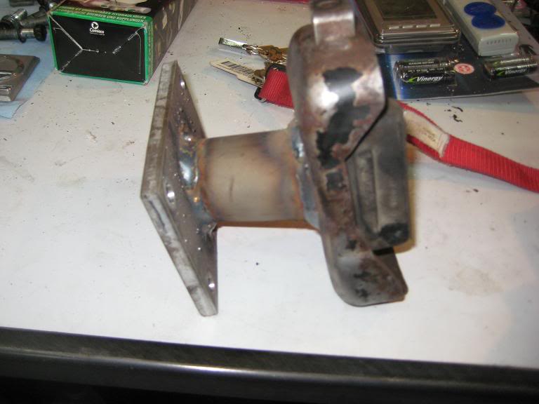

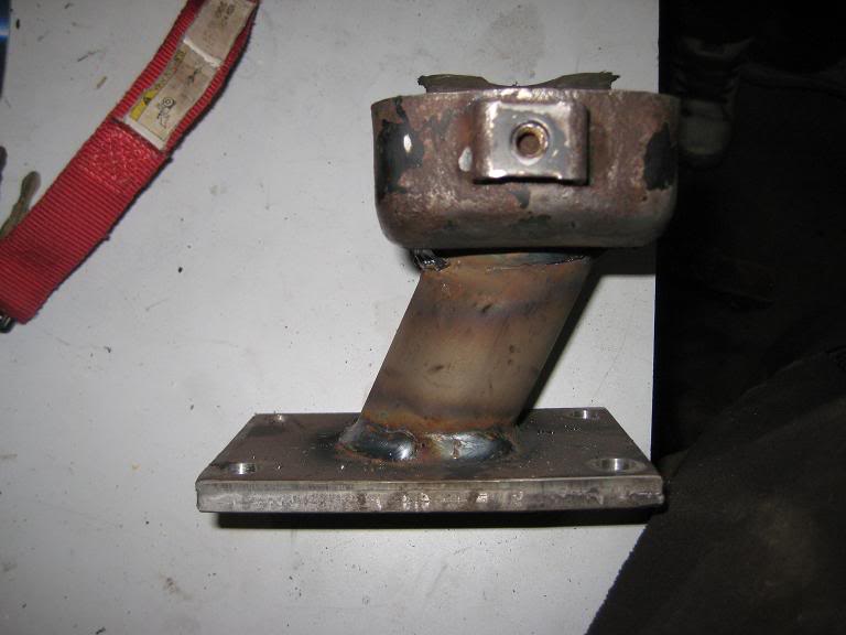

this was the end result, 3/8 plate, some DOM tubing left over from my rock sliders and the 3VZ rubber mounts

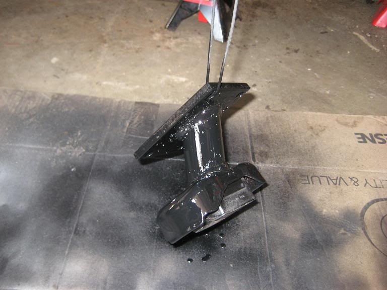

Painted the motor mounts

OK the flywheel!! i dont have pics but here is what i did. I had the back of the 3VZ flywheel machined to put the ring gear in the exact same spot as the stock flex plate, then i took it to the CNC to have the bolt holes cut. the bolt patter is almost the exact same except the 1UZ pattern is a tad wider so made a program to make the holes a bit more outward resulting in a slight oval look.. then i had the flywheel balanced and bolted it on with a 3vz HD clutch kit from Marlin

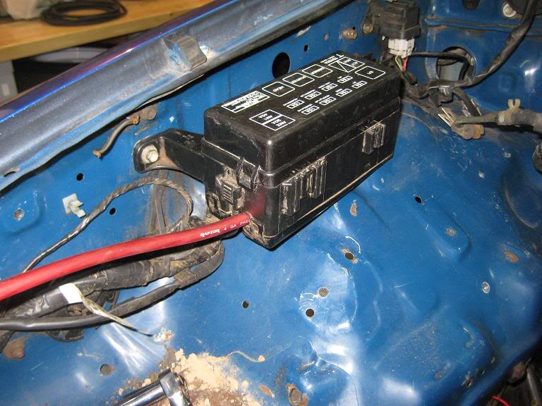

Ran a larger wire to the main fuse box

Drive line

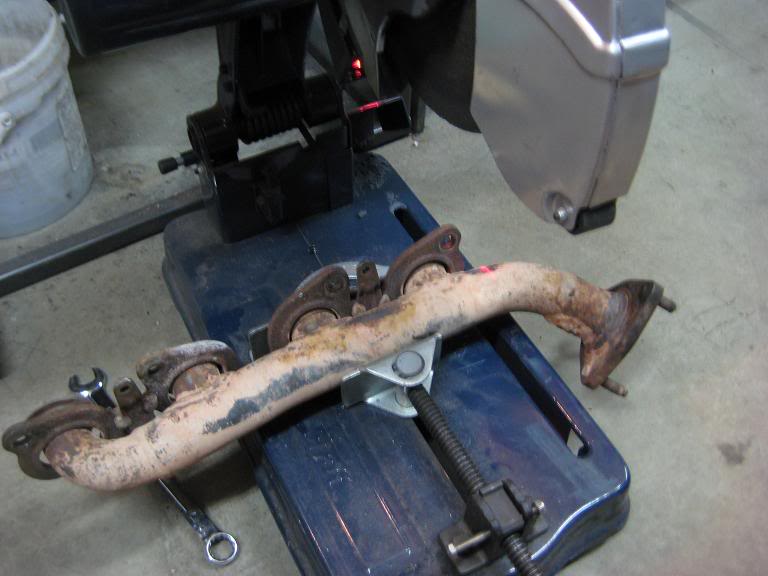

The stainless headers i have will not fit.. well the passenger side does fit but the drivers side wont because of the steering shaft, maybe if i had a body lift it would of worked but i dont want to run a body lift or make my truck any higher. So i found some 2001 Tundra manifolds bolted them on but i had to cut the driver side and rotate the flange as it was pointing right at the frame rail

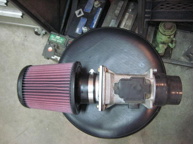

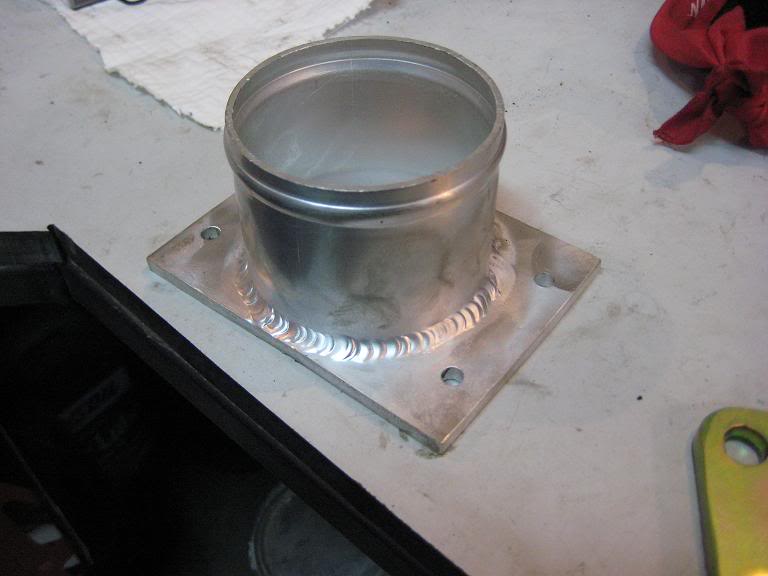

Made an adaptor to fit a cone filter on my MAF

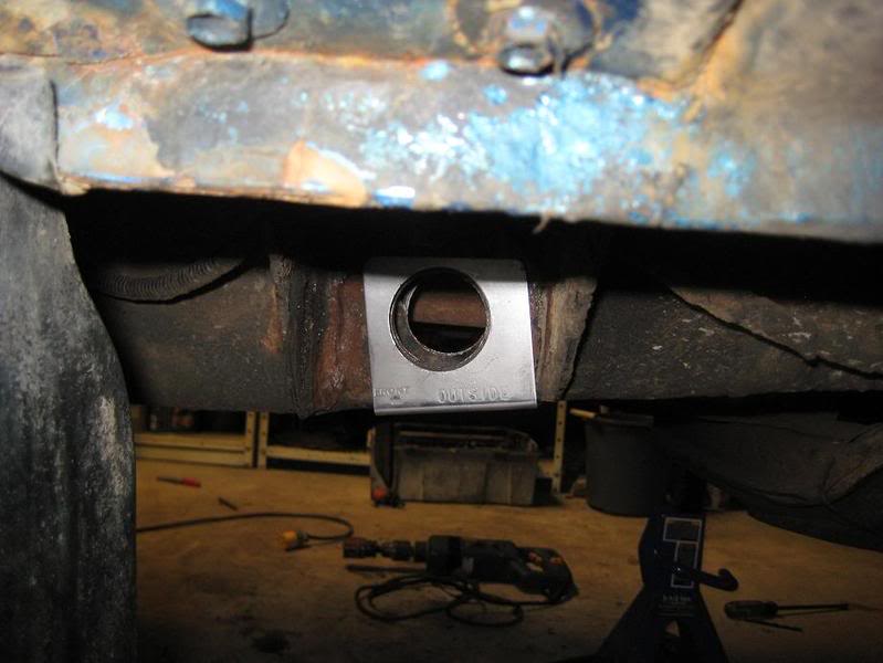

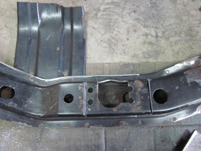

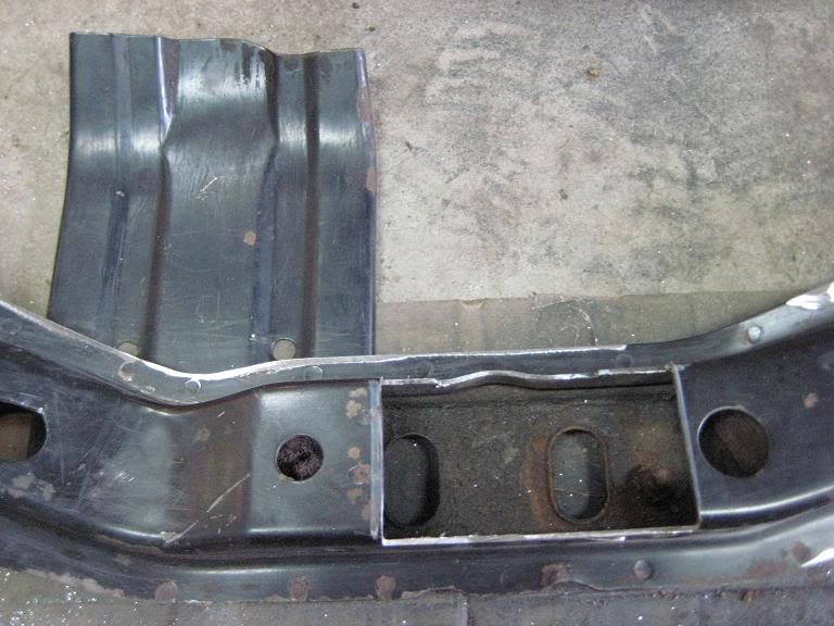

Started to cut up my cross member
Cut a 3/8 plate to weld in, its not square but the hole is where i need it

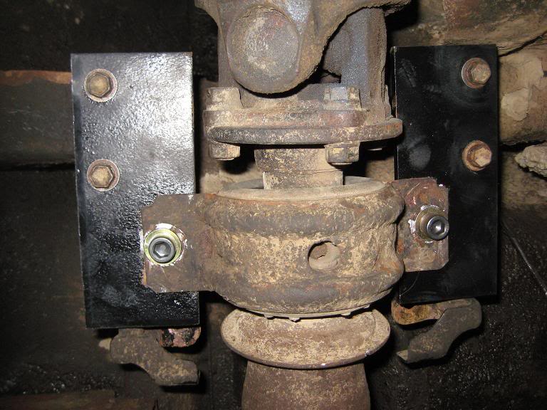

my whole driveline moved back about 1.5 inches so i also had to move the hanger bearing back.. more 3/8 plate

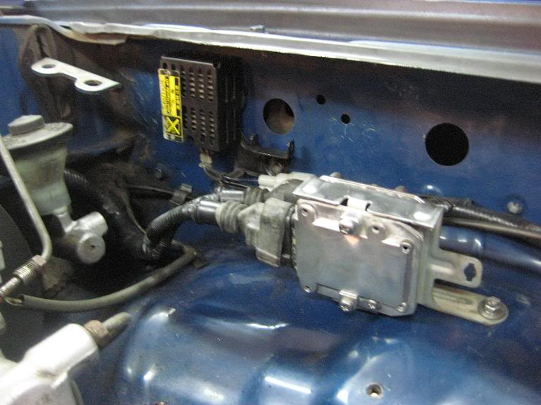

Mounted my ignitors and resistor box

Then started to work on my rear disc swap

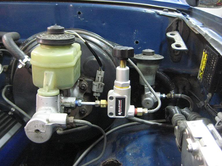

U can see my stainless braided clutch line I added in this pic behind my proportioning valve

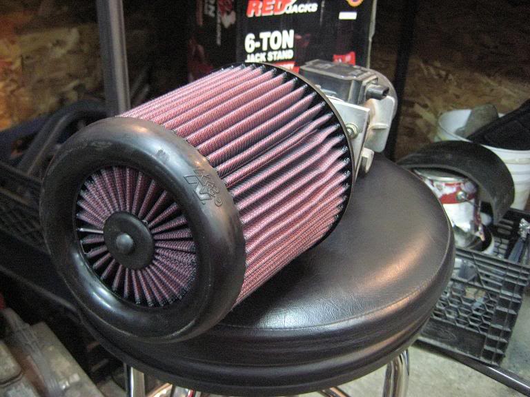

Got my air filter on the MAF
Picked up my rear rotors for my disc swap

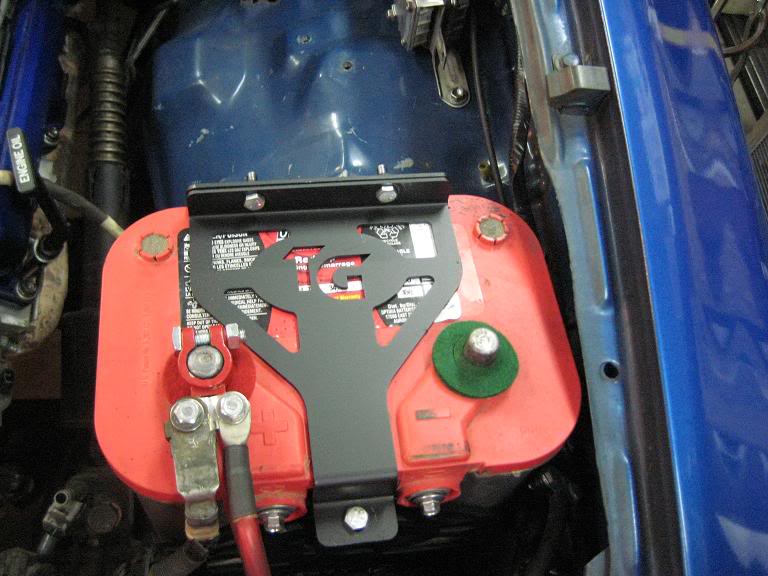

Mounted the battery box

Got my rad ends modded so it would fit

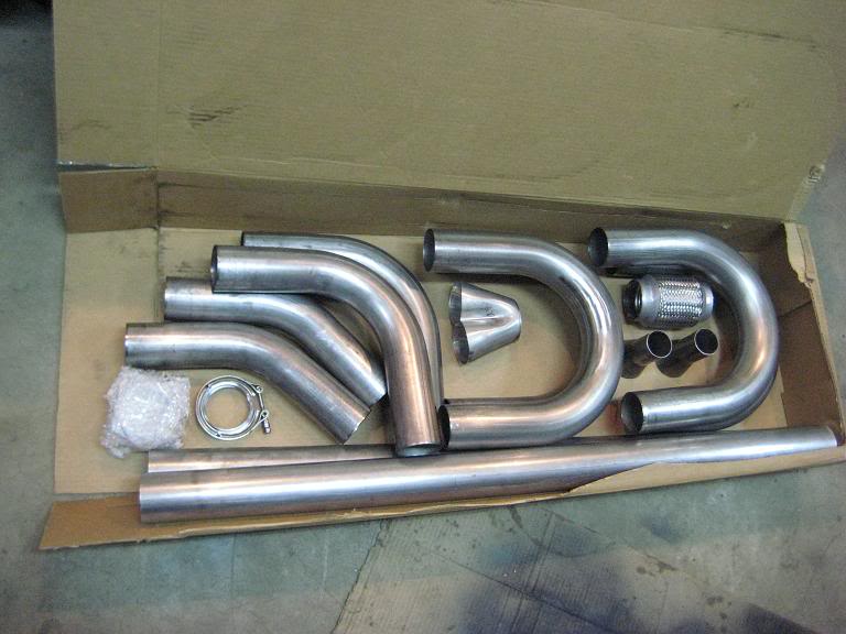

My exhaust piping, 409 stainless 3 inch mandrel bent, vband clamps, collector, flex pipe.
