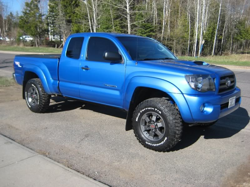

Was that your 2nd Gen I saw today?!

^ sure was

Looks good man!
Did you paint your grille yourself?! and where'd you pick up the sport hood?
Like the FJ wheels, I see blue in the front wheel wells, you running a pro-comp type kit?!

Yeah. The Taco looks great bro. Did you installed a leveling kit or only tires? Those wheels makes it look OEM but diffrent from others. Like a special edition hehe. Also, are those the stock healights? Mines are chromy?!?

The grille is new oem, the hood is new from T&T Auto and Mascarins painted it, the scoop is oem, the shocks are King coilovers front and King shocks rear. The headlights are factory with custom retro projectors and painted black.
I have all of my oem stuff i took off if u know anyone who wants anything. The shocks I took out are bilstiens.
