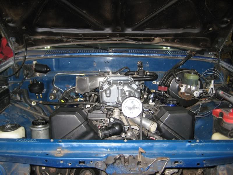

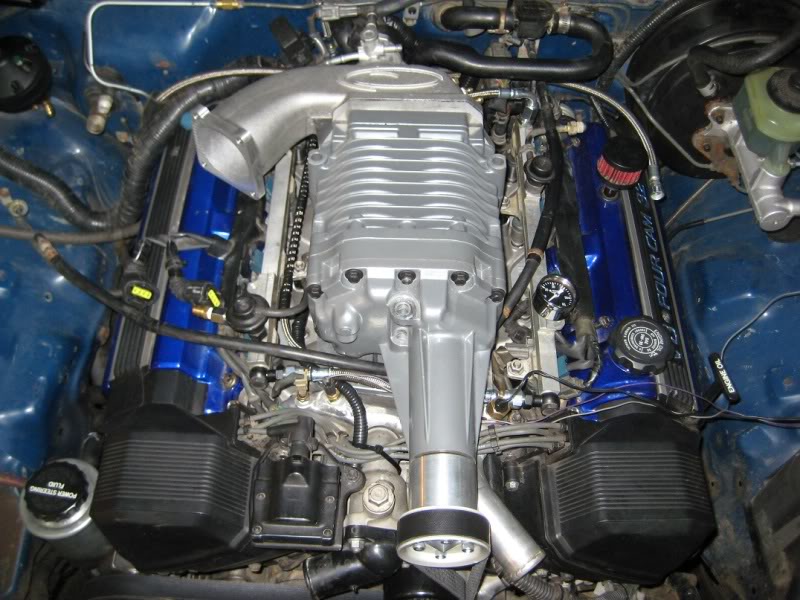

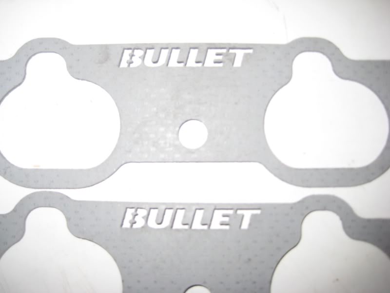

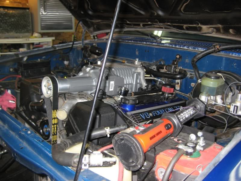

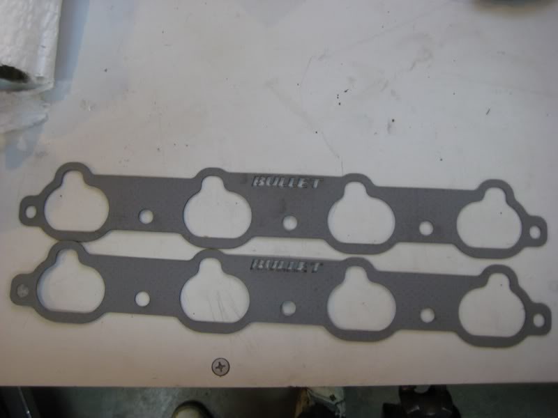

so here is a bit of an update of what i got done last night.
bolted manifold down, bolted M90 to the manifold, hooked up all the fuel lines and wiring, put in all the injectors and fuel rails, put in some sensors, put the intake pipe on the M90, routed throttle cable, put on the belt. i think thats it..
i thought it was cool that the gaskets said bullet

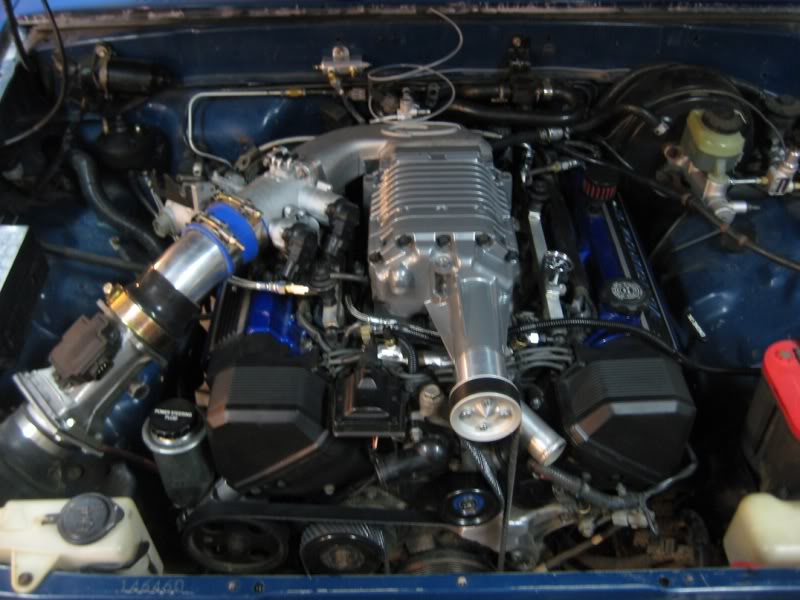

looking good man
you using stock injectors? .. did you tig weld that housing for the gauge,looks good ?
can you get a better pic of the back part of the supercharger installed ..like hows eveything looking between the supercharger and firewall.
thaks!!!!

Thanks RMA,
ya stock injectors with an FMU. Yes TIG welded thanks to my Miller
For sure ill snap some pics for you tonight.

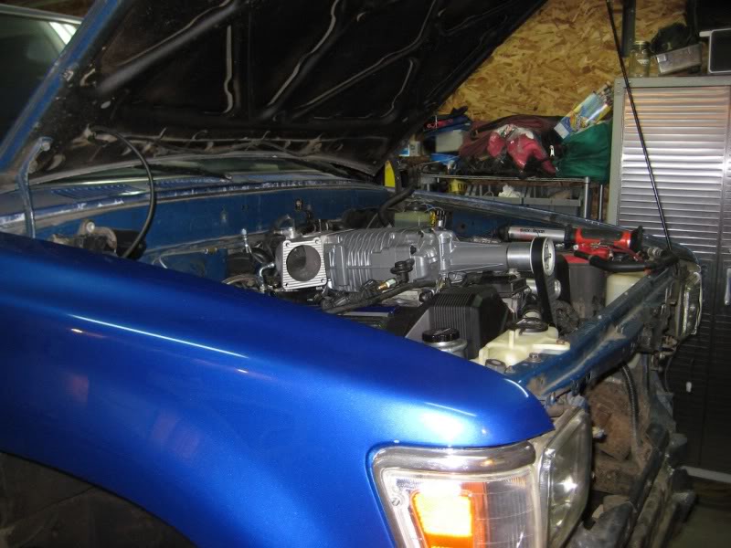

Wow, thats realy nice
The hood is still closing?

Yes the hood still closes no problem, which i am SUPER happy about as that was one of my main concerns.

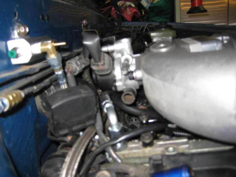

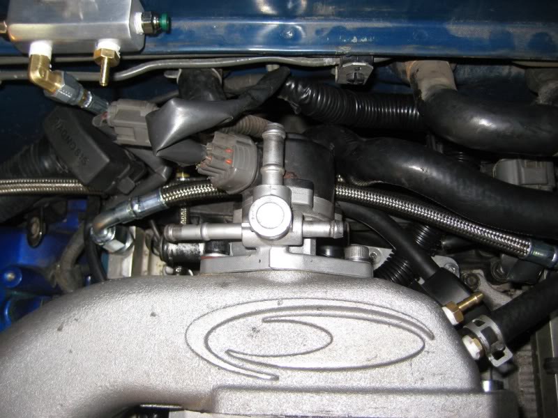

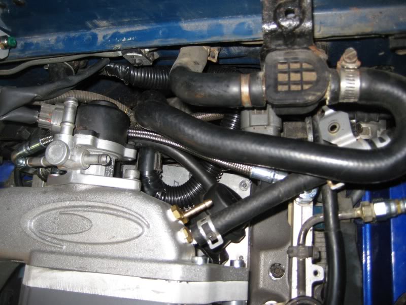

Here are the pics RMA

Thanks !! so you got the intake with the provision for the iscv.. Nice .. i know they sell with and without for the guys using the chevy or ford throttle bodies on these engines , those throttle bodies have the iscv on the throttle body .
