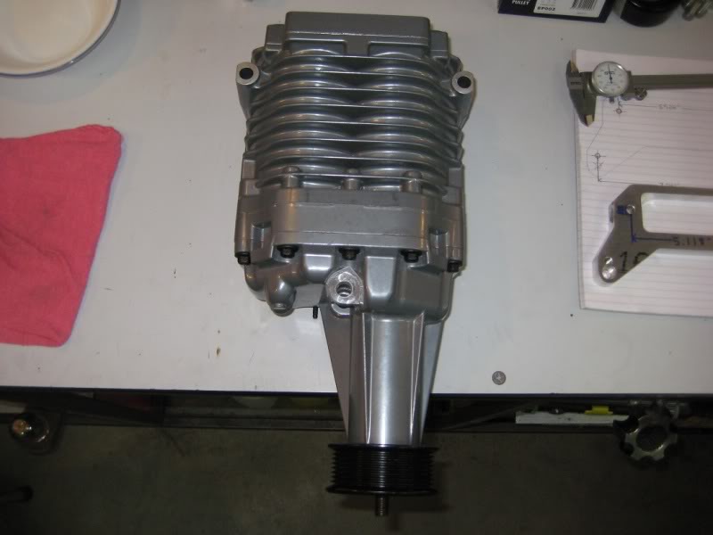

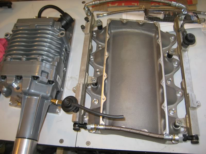

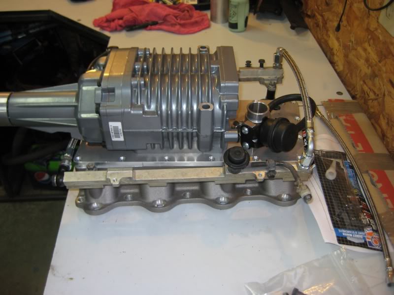

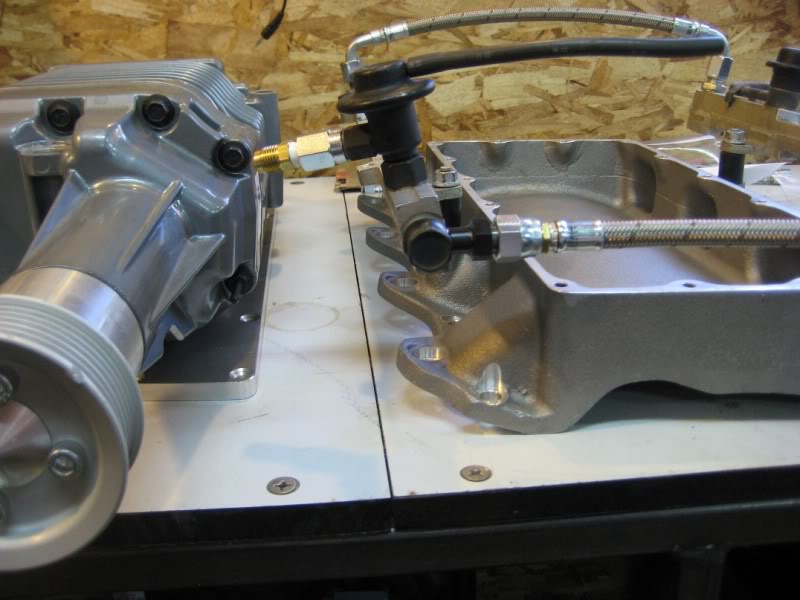

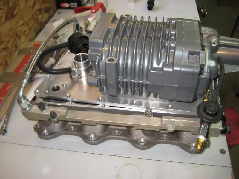

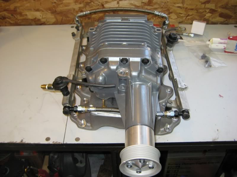

Id like to welcome the addition of an Eaton M90 supercharger! it is one of the late models and its brand new never been ran and Bullet parts.

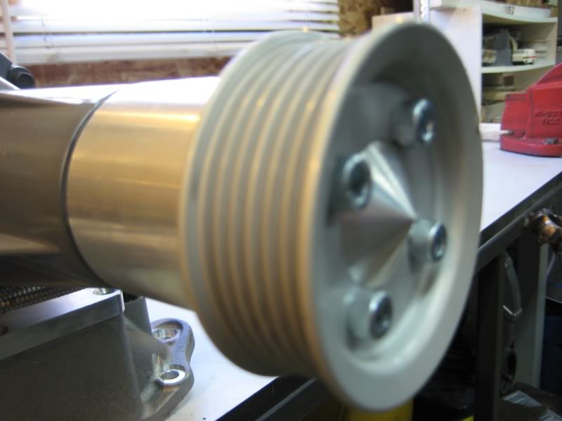

New pulley added

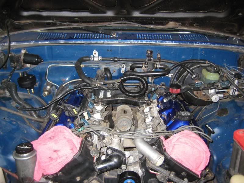

Engine bay

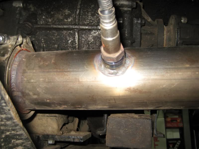

AEM Wideband

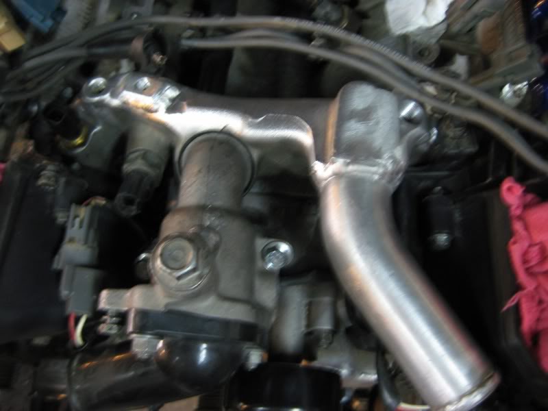

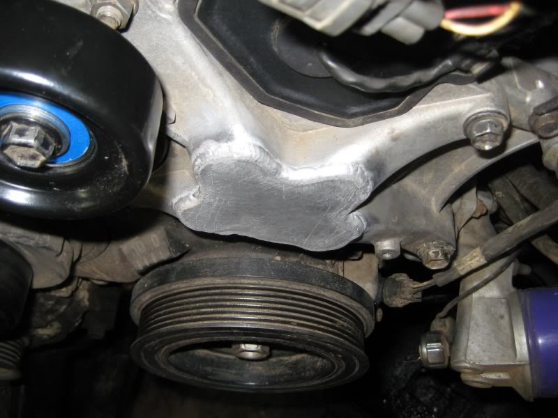

Modified coolant passage, spout turned and out of the way of the belt, added plate, drilled and tapped for the relocation of sensors that were in the way of the supercharger

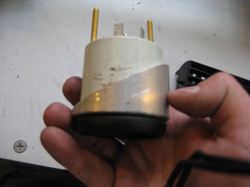

Had to cut off one of the pulleys and weld a plate on becasue i am not running A/C i need to run the belt straight up.

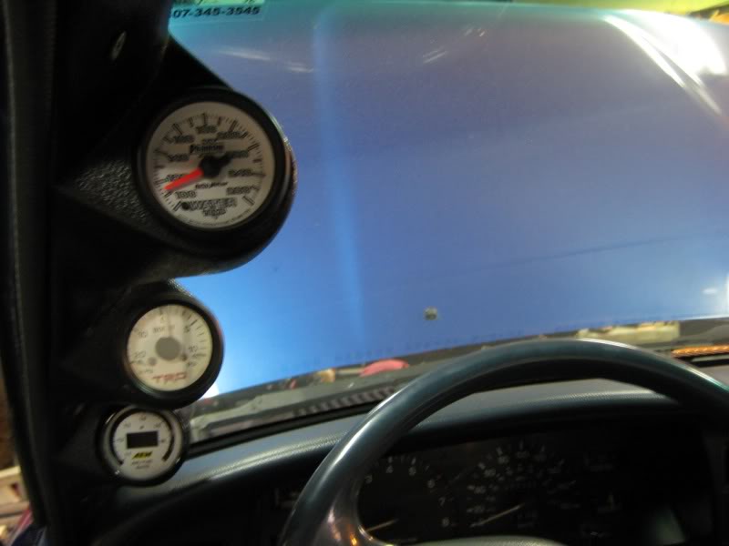

Gauges

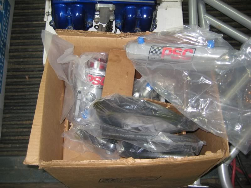

new PSC hydro assist

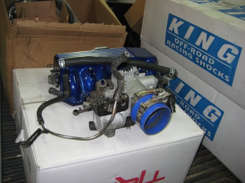

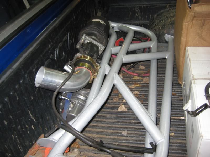

in the box of my truck sits the old intake and MAF

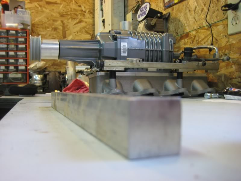

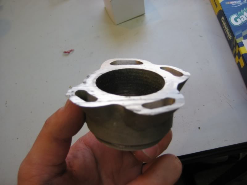

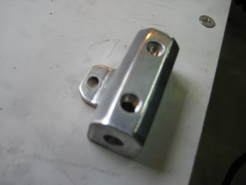

started to make my own vacuum block rather than buy one
here is the 1x1 square aluminum block
i didnt get pics but i have added a walbro 255 fuel pump and rising rate boost sensitive pressure regulator (FMU)
i am currently still working on it but im hoping to have it ready in a week.

Old Apr 22, 2011 | 06:56 AM
  #151
RMA's Avatar
RMA
Joined: Dec 2008
Posts: 2,505
Likes: 16
From: San Jose ,Ca
Danm !! which kit was that from bullet the ford ,gm,buick ? the supercharger i have looks a little different it was off a sc thunderbird .
Old Apr 22, 2011 | 07:01 AM
  #152
Yota 3.0's Avatar
Joined: Oct 2009
Posts: 136
It's the Ford kit but I had get a special adapter made because my m90 is one of the newer and rare ford m90's (is what Bullet told me). The intake adaptor they originally sent me looks like it was for your style (from looking at your pics)

man that intake looks super clean , they did a good job on that .. im gonna have to go the poor mans route ill be watching for sure .. thanks for the pics you posted .. more is always appreciated

did the pulley and snout piece come with the kit or was that extra?how much longer is that ?
Old Apr 22, 2011 | 07:15 AM
  #155
RMA's Avatar
RMA
Joined: Dec 2008
Posts: 2,505
Likes: 16
From: San Jose ,Ca
man i hope you dont mind all the questions ..
when you get a chance can you get some measurements of the intake ..
height ,width ,length ?

Yes RMA the pulley and snout part came with the kit
ill try to get some measurements for you this weekend.

I finished the vacuum block i was making

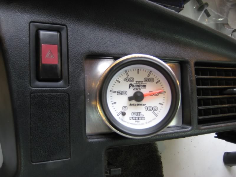

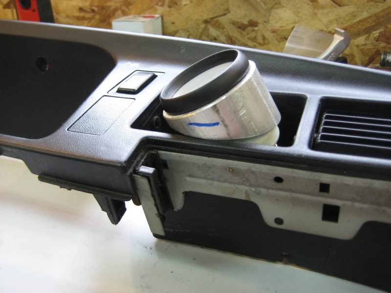

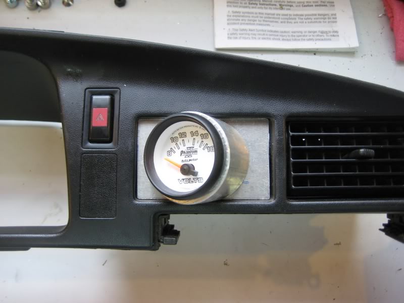

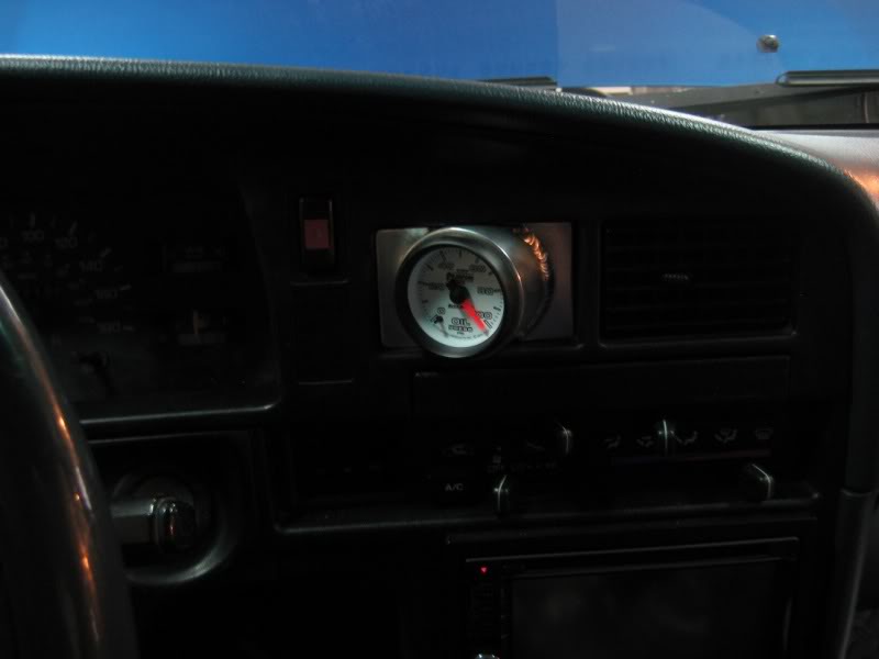

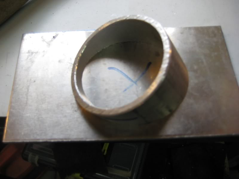

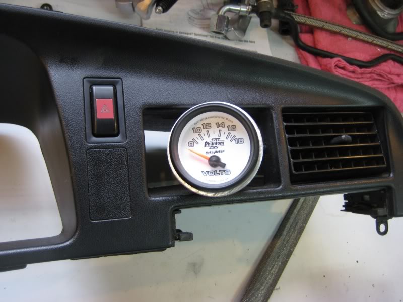

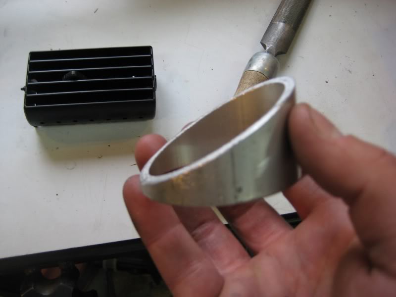

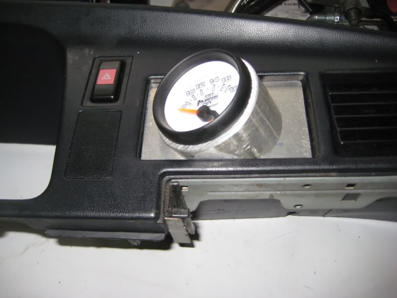

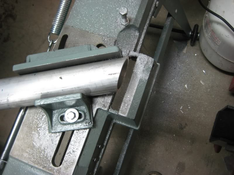

then i had to figure out where to put my oil pressure gauge so out came some more aluminum and the dash.
some band saw action
ended up with this
some mock up
some test fitting

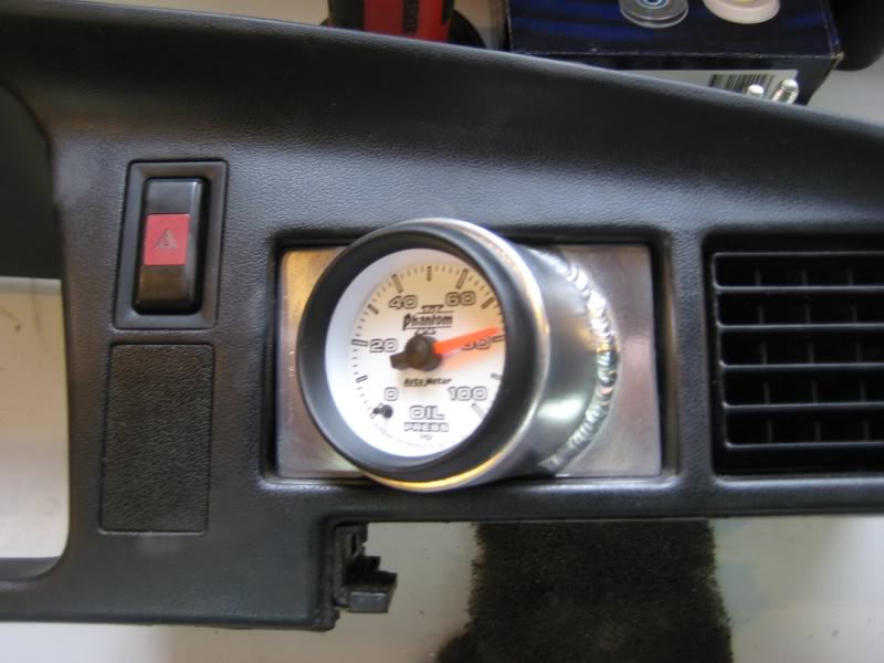

all welded up and some aluminum polish and its done!!
thanks for looking

The oil press gauge in the dash is not working?
Too bad you had to remove one vent trap to install that gauge. If you didnt had a huge double din radio, you could had it installed there.
But hey, nice work bro.

I believe the M90 supercharger is what they put on the 90's T-Bird Supercoupes. Anyways I was told stock 1UZ engine with an FMU are only good for around 6psi boost. A couple of people on Lextreme have done it with a Mustang supercharger. I cannot wait for the supercharger videos!!! Post more pics!
