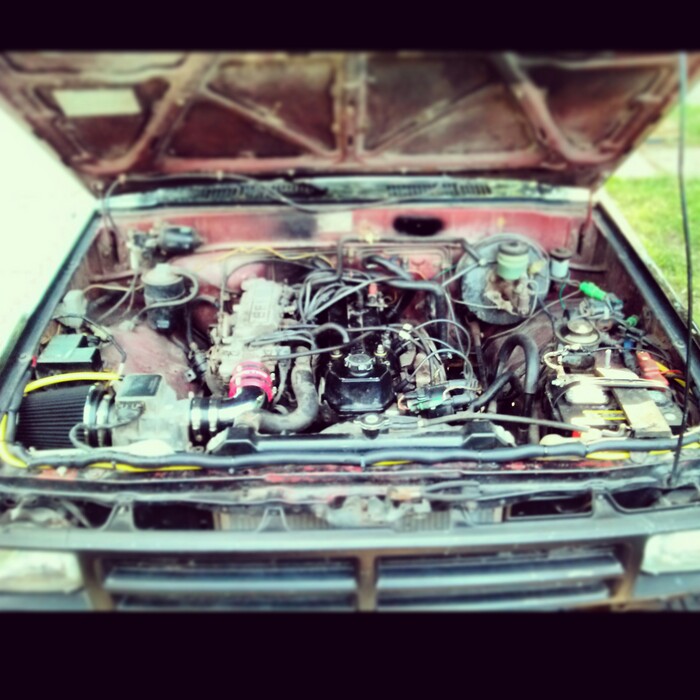

Originally Posted by Gizler00
Where's the pics!!
Oh. Sorry. Photo of my ugly engine bay.

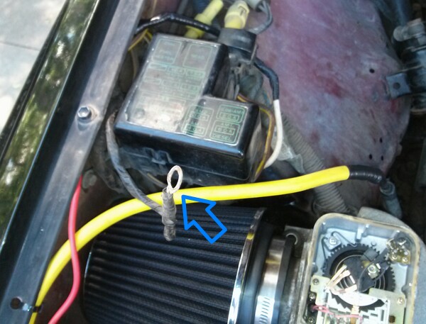

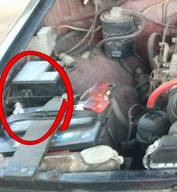

plz help
What do u guys have this wire hooked to? My guess is battery negative. It wasn't hooked up before I don't think. I found it under my battery stuffed down in there. I already have a wire coming from the box there that is connected to the batteries positive lead.

is that coming from fuse box???? I don't have that??
Old Jul 14, 2014 | 04:04 PM
  #250
crashburnoveride's Avatar
Joined: Dec 2012
Posts: 613
Likes: 33
From: Lincoln, NE
No, it comes out of the wiring just behind the box. Not from out of the box itself.
Old Jul 14, 2014 | 04:40 PM
  #251
julsruls's Avatar
Joined: Jun 2013
Posts: 451
From: Maine
Yes thats ground then

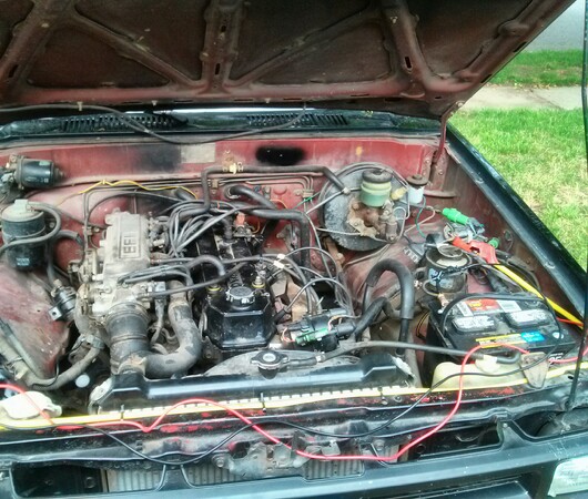

Juls you have that attached to your battery neg terminal? Heres an old pic of my battery. U can see it doesnt have any extras attached to the neg. Just 2 coming off of it going to body and block.
Maybe the dummies at Wal-Mart left it off then....
Old Jul 15, 2014 | 06:30 AM
  #253
julsruls's Avatar
Joined: Jun 2013
Posts: 451
From: Maine
No i have that attached to the fender there.
  #254
julsruls's Avatar
Joined: Jun 2013
Posts: 451
From: Maine
Ground to 4runner not battery
Old Jul 15, 2014 | 06:52 AM
  #255
Joined: Dec 2012
Posts: 613
Likes: 33
From: Lincoln, NE
Ok awesome thnx.

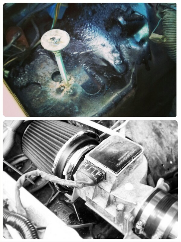

Super long story sorta short, I had to redo everything with the supra afm. Luckily I had my spare 22re afm to steal the circuit board to use. Turns out I wasnt careful enough the first time and screwed up the board. I found this legit write up today @ work that I unfortunately didn't find b4. Here: https://www.yotatech.com/forums/show...705&styleid=53
So I recommend following that if you're gonna try it. I still have some tweaking to do with the afm wheel, but it runs, no codes. Took it around the block twice and I can feel the difference. Sounds cooler too. Worth the $? I just love modding my truck so it's worth it 4 me.
To hold the afm I welded up a little post it sets on.
