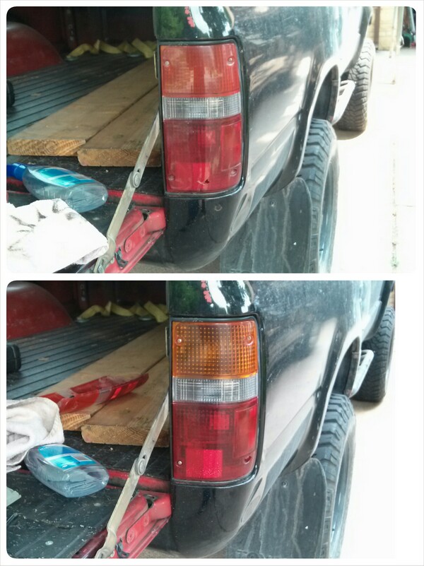

Went to upullit and saw an sr5 1st gen 4runner. I was all excited. Then I opened the door and the gauge cluster was gone. Damn. I might hafta start going every weekend. I was thinkin about just swapping the entire dash from a 3rd gen pickup over because I find sr5 gauges galore for 3rd gens, and I'm tired of not being able to use them! I did see a grey dash from a 91 and almost took it.... should have. I just don't know how it swaps over. And my dash is in like new condition. I snagged 2 good tail light lenses. One of mine had a hole in it and they look kinda dark.

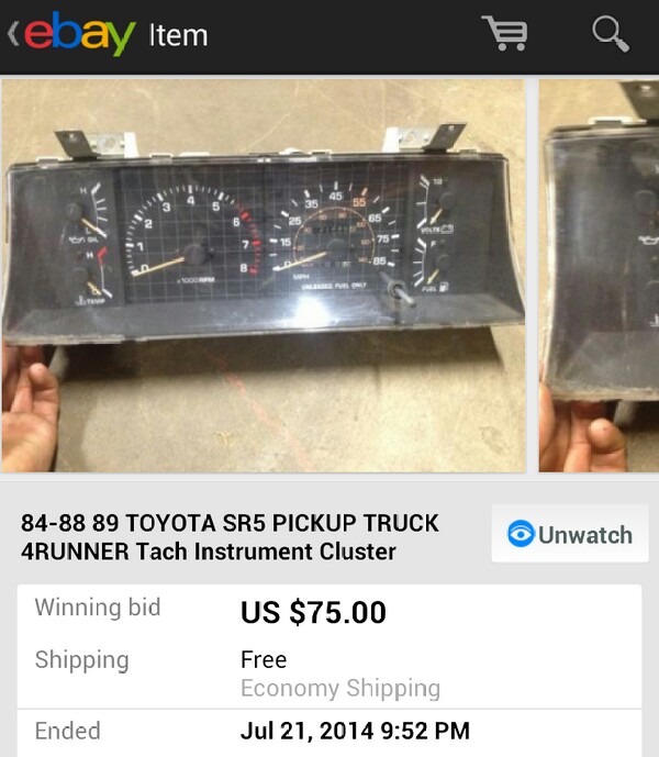

Woops! I put in a bid on ebay for an sr5 cluster totally not thinking I'd win. Idk y I even did it, but... I won it.
Doh! Oh well, aint as cheap as a junkyard find but its way cheaper than the $200 I've seen other ebay items listed at.

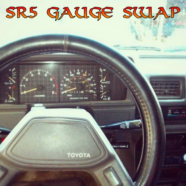

sr5 gauge swap
I recieved the gauge in the mail today. Cleaned it up and put it in. I wanted to wind the odometer, but the speedo needle didnt want to come off so instead of breaking my $75 gauge for that small detail I'll live with the 18k difference.
Of course we all know what it looks like, but I try & always post a pic with an update. Wow though, this mods been on the list for 2 years now. Finally done. Feels good.
I did have trouble removing the oil light sensor thing so I could replace it with the pressure sender. Its in a tough to reach spot and I just said hell with it just leave it unplugged. Anyone got tips for removing that?? Other than that all else works great. Speedo is good (gps verified) so I'm happy!

FYI the sr5 gauge uses 3 bulbs to light the main gauges while the base model uses 2. So if your running special colored LED's like me you'll need to order another one. My advice is use superbrightleds.com they arent the cheapest, but the quality is worth it. I've had only bad luck with ebay cheapos. Now, off to find that special socket!

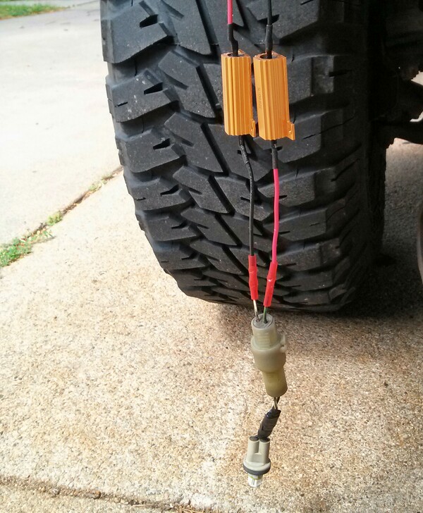

Put in some resistors I had laying around for my motorcycle led turn signals to stop the fast blink of my trucks front turn signals that I put in the corner lights, but it didnt work. must not be enough resistance for these smaller bulbs. Hmm...

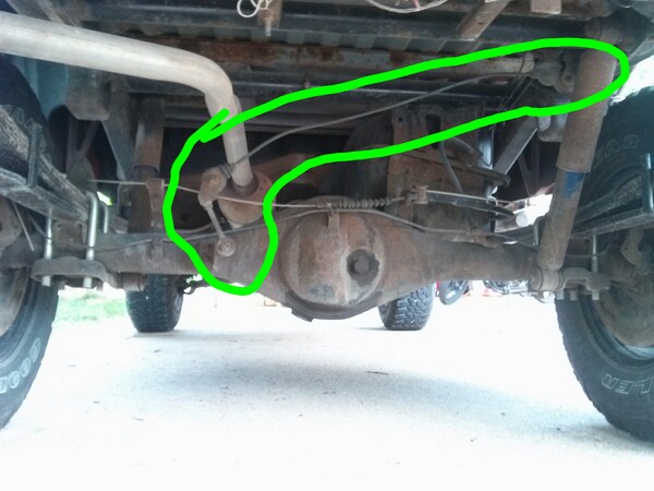

What is this?

Originally Posted by crashburnoveride
What is this?
That's the rod for the brake load sensing proportioning valve. LSPV. , just came to me. I forget what the acronym for it is. I know some guys eliminate it. I'm not well versed in how it actually works, or what purpose it serves

Thanks. Did some quick research.
Lspv - the load sensing proportioning valve senses the load of the vehicle (extra weight placed in the back) and applies an effective pressure to the rear brakes to compensate.
So that's actually pretty cool. I see plenty of axles without it, and was gonna chop it off. However, I do towing and hauling a lot so it's staying. Looks like I might want to make sure its calibrated right.

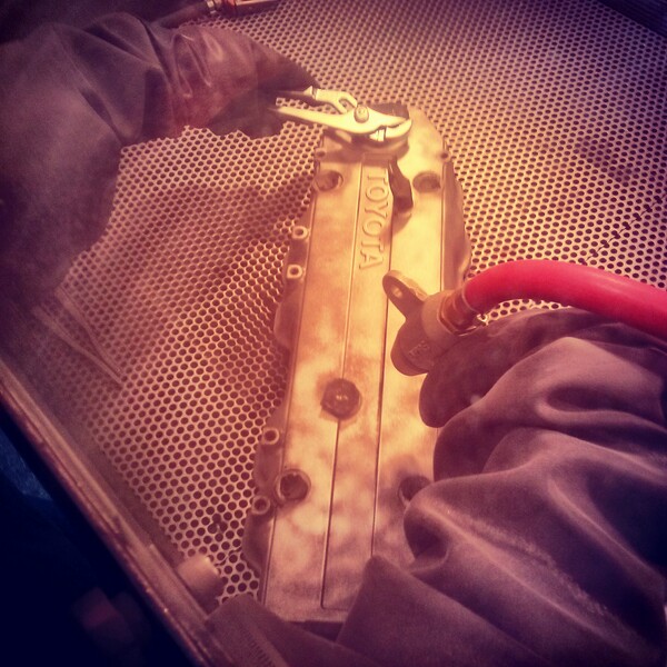

My first time blasting something. It reminded me of mission impossible 2. When he's handling those viruses in the lab. Haha. Im thinking of clearcoating it I like the blasted aluminum look.

Oh yah. It was pretty cool. I love the secret perks of my job! I have it painted and on the truck, but no pics yet probably tomorrow.

Nice score on the SR5 gauge cluster, I can never find them for that cheap! For your turbo blink LED turn signals you can remove a resister from your turn signal flasher relay, that's what I did on mine:
Post # 255
https://www.yotatech.com/forums/f199...3/index13.html
****EDIT: JUST NOTICED YOURS IS AN 88' YOUR FLASHER MIGHT BE DIFFERENT, NOT SURE****

For your turbo blink LED turn signals you can remove a resister from your turn signal flasher relay, that's what I did on mine.
Hmm.. I'll look into that.

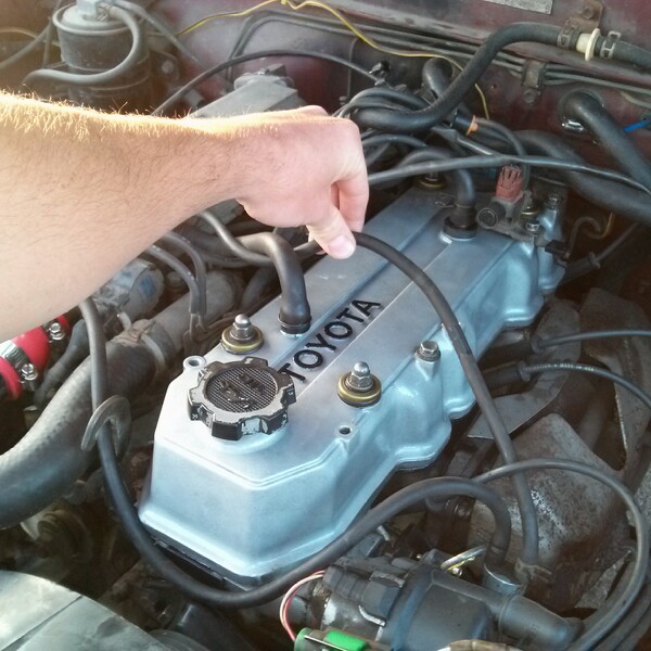

More pics:
Looks like silver paint, but its just clear coated.

VC came out great!
Old Jul 31, 2014 | 06:33 AM
  #280
julsruls's Avatar
Joined: Jun 2013
Posts: 451
From: Maine
really brightens up engine bay. looks good
