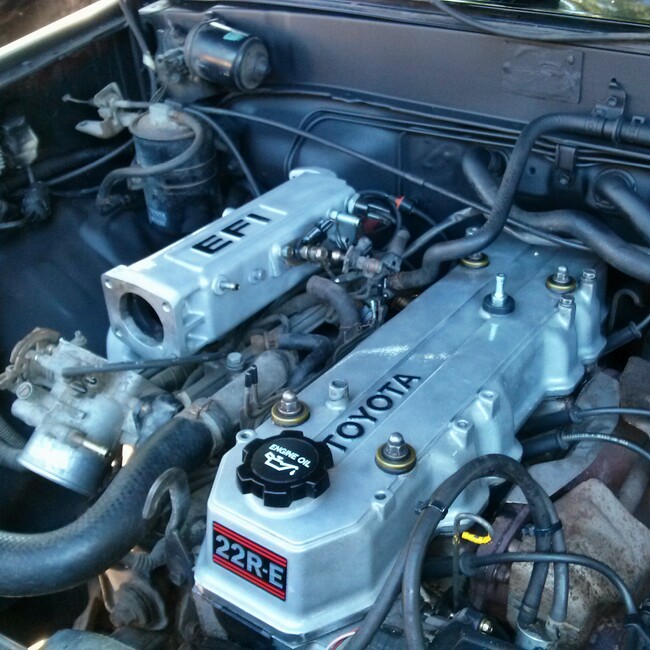

What a shame.. I was so close to being done with the later upper manifold swap. Painted engine bay and everything!

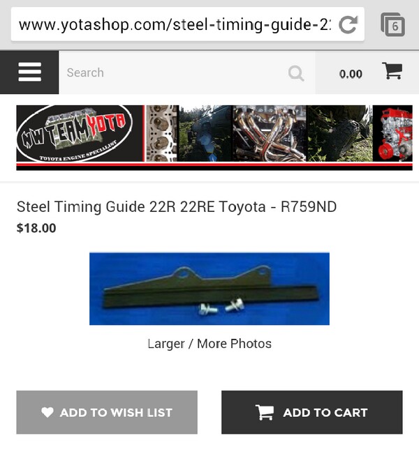

I bought the first part for my engine overhaul today. My chain and sprocket look brand new so I found just the metal guide for $18. Ships free. Dont need to drop $56 on a whole kit.
I started cleaning and organizing my garage because I wanted to have a nice work space and place for all the parts. Hopefully begin the tear down this week! I've always had my suspicions about a HG leak with my truck since I bought it, and it does burn a decent amount of oil. So I'm looking forward to see what I find and then doing things the right way and having some peace of mind. Maybe I'll pickup an OT shift and buy an engnbuilder street RV head!

Very nice.
It might not be a bad idea to just replace the whole timing kit. Especial since you are going to have to take it off to to the teardown anyhow.
My luck I would leave it, replace the guides, and then have the gain blow on me 500 miles after the fix.
Even if you decide to not do the chain, I would consider doing the tensioner.
I might even have some extra new sprockets. I will have to look. If I do they are yours.

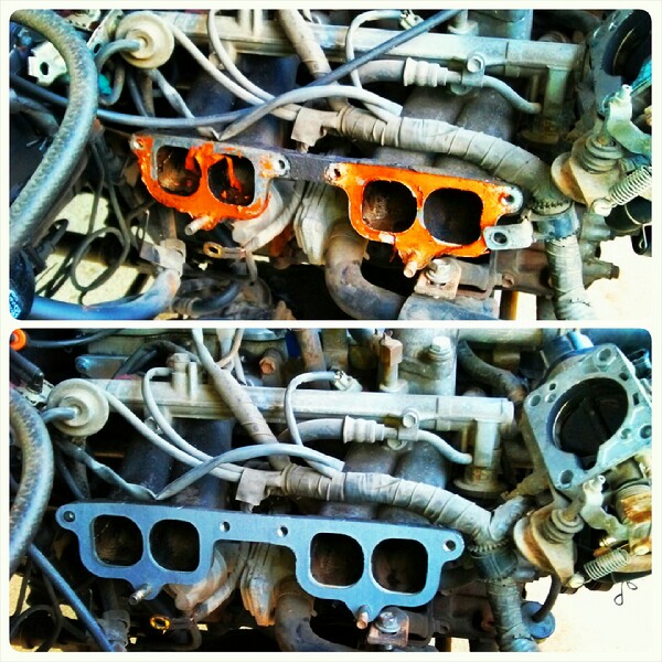

Old orange rtv gasket from PO, and the fancy new felpro.

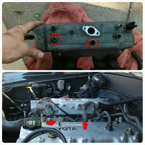

It's missing the 2 vacuum ports circled in red on the old one. So I guess I could put a mini filter on the valve cover, but not sure what to do with the other hose. Thoughts?

Ok, so apparently that vacuum hose is part of the air flow valve or AFV. I read the later style throttle body has this built into it so when you do this swap you can remove the AFV. Less crud. Sweet. But, I'll hafta go get a $30 junkyard TB to use as the valve cover vent tube (VC front vacuum line) also hooks to the later TB. Problem solved, but I still gotta figure out removal of the AFV....

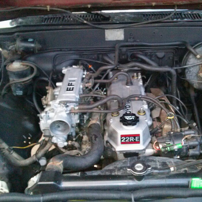

Ooooook, I got a 91 throttle body. Cleaned it. Blasted it. Painted it, and installed it. All in 4 hours! I only have one more coolant hose to reroute and I'm done. Progress pic!
After I figure out that hose I can swap out my cracked rocker assembly for the one Gizler sent me (awesomeness) and be back on the road. Its amazing how my engine bay has transformed.
