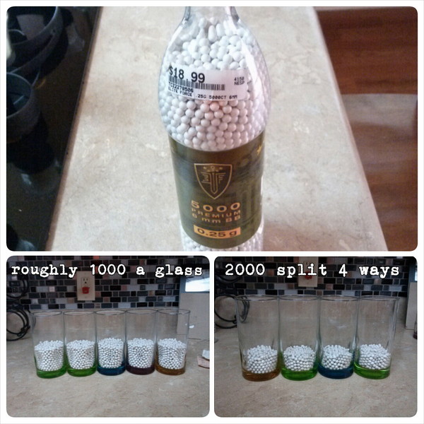

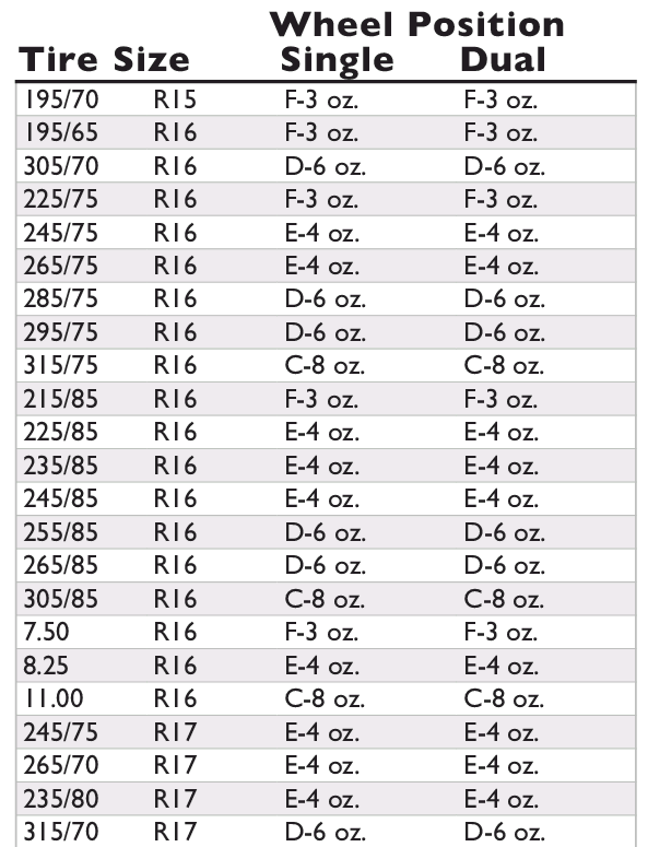

Ok, well my tires were never balanced. I blame that for my passenger front bearing degradation. Whether it's the cause or not. I was always planning on trying the airsoft pellets for balancing. I don't fancy spending $40 for a shop to do it when a rock can so easily knock off the weights. So I did some research, and found a chart to tell me how much weight in pellets I needed for my tires.
I have 245/75r16's so I need 4oz of pellets in each tire. I went to hobbytown and bought the high performance pellets. I only needed 2,000 but 5,000 is all they had and it was the same price as 2,000 from online with shipping and all. Plus I wanted to start this project today. So I spent about $19 for 5k of the .25 gram pellets. 4oz = 113.5grams which comes to 454 pellets/tire. Going over is ok, go under and it wont balance so I will be using roughly 500 in each tire. Instead of counting my life away I split the beads into 5 equal amounts. Then took 2 of the cups and split that in 4. Equals 500 each. Give or take.

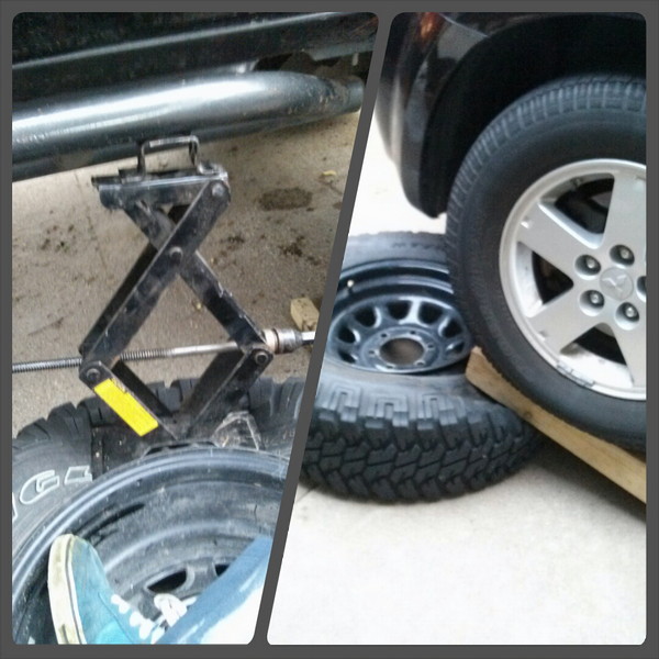

So for half the cost I can balance all 4 of my tires, and have enough for my next set. Well now that my pellets were ready I took off a tire. Deflated it, and tried to break the bead.
With these 2 methods I was still not able to pop it off! You've got to be kidding me! Since I need my truck tomorrow I threw in the towel and filled my tire back up. Grrr.... Giz if your shop has the tools to easily pop the tire off the rim maybe this is something we can do in 30 minutes or something when I come up for that grille. Frustrated...
