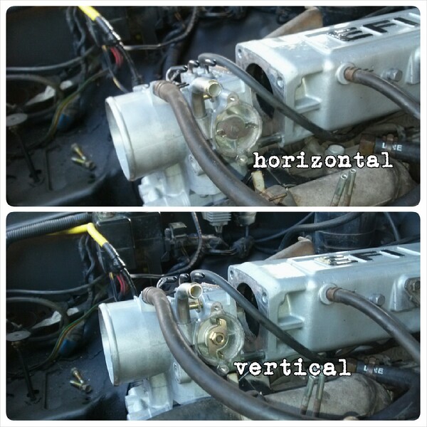

To get your old tps to fit on the newer TB you have to swap out the horizontal tps thingy (real technical here) for the earlier verticle one or the tps wont fit. Here you can see the difference.

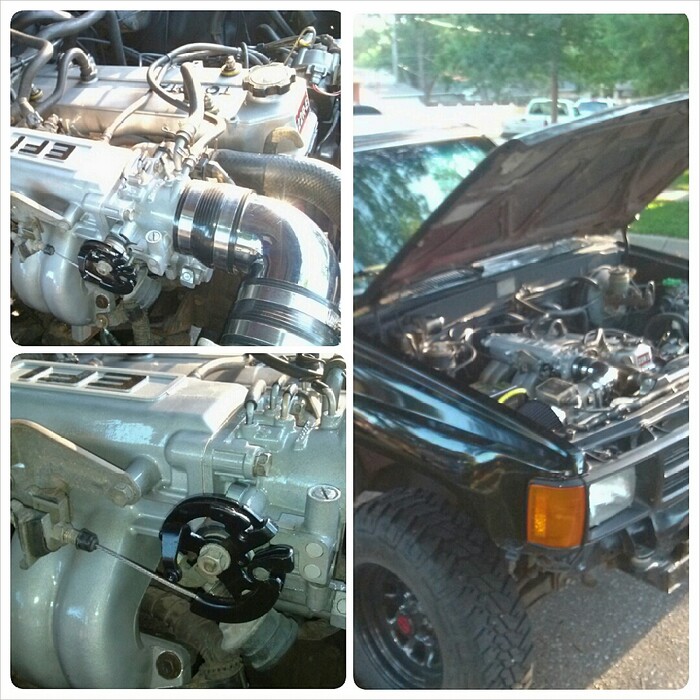

I got it running and it idled kinda high at 2k rpm, plus it was spewing coolant out so it seems I need a smaller hose than what I bought. Cheap fix. I cranked the idle screw fully clockwise and it dropped to 1700-1800 ish rpm. Hmmm... I wonder if I have the coolant hoses mixed up... any other ideas? Well, heres a pic of it all buttoned up.
I can't stop now I'll have to blast and clear coat the AFM too. Cheers.

Looks good bud. Coming along nicely. Glad I could help with the rocker.
Nice to know that you can swap the sensors like that.
On the rpm, is the return spring setup on the TB the same as the old TB. Could it be sticking? Take a peek at the adjustment for that on the side left side of the TB. Mine sticks sometimes and has the same symptoms.
You probably already did this... But did you setup the TPS according to 4crawler site? Or FSM?
Just a thought

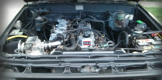

Trucks finally driveable again! Pretty excited. Haven't replaced the rocker assy yet but the intake mods are done and working.
Drove it around for a bit. Couldn't really tell a difference in performance, but I didn't really expect to. Worth a try though and I'm mainly glad I got to repaint everything. It looks awesome now. Something I'm proud to pop the hood for.

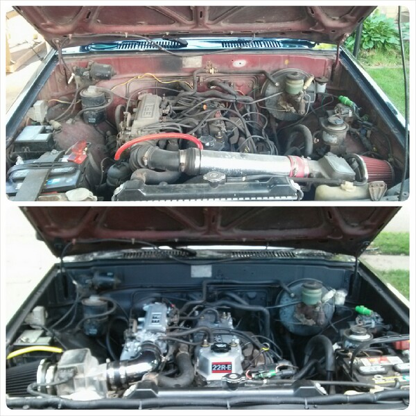

Another b4 and after:
I did buy a 22re motor from Gizler over the weekend so the plan is to change out the cracked rocker on my current engine, and then build up this other 22re all winter. Then transplant it in spring. Oh yah!

Looks way better. Nice job!

Nice work Pat. The engine bay looks so much cleaner. I'm jealous of your nice shiny 22re sticker. I need to get me one!!

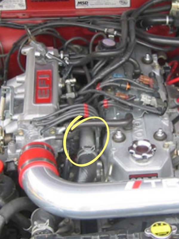

What is this piece called?
Thermostat housing.

Ok good. Thats exactly what mines doing now. Before it was almost 3k! I guess I'll jump those terminals and see if it idles down to see if the tps is working correctly. I ordered roger browns TPS allen screws cuz I'm lazy and that way I can adjust it without removing the TB.
Originally Posted by Gizler00
Thermostat housing.
I discovered the passenger side bolt for this is just sitting in the hole completely loose. Either wrong bolt or totally stripped out. Another gift from the PO.

I hear you on the PO stuff. Always interesting what you might find.
Bolt could be broken in the intake also. If so, easy fix. I have an extra lower intake if you have troubles with that bolt and need to swap one in.

that being loose/broke, im surprised it hasnt lost coolant or overheated. this may be your idle issue. if air gets in the system the steam may hit the coolant sensor and spike the temps that the ecu sees and attempts to compensate for.
Well, when I drained and refilled the coolant during my cam install I never ran it with the radiator cap off. I just read about that method of releasing air bubbles today....

That could totally be it.
I always fire it back up with the cap off, and raise the front up higher than the rest of the cooling system. Let it run like that till operating temp.
