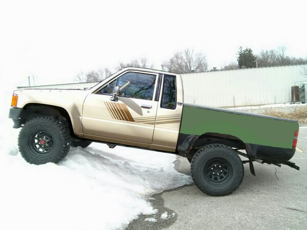

Dreaming at work... pasted an ext cab over my truck to see how it'd look. I'd love to do this someday and bob the front of the bed.
@twisted My little welder wouldnt be enough for a sas and having my DD out of commish for so long right now just doesnt work. Eventually that axle will make it under though... feel free to donate to my sas fund!

Haha, if you were closer I'd donate labor haha

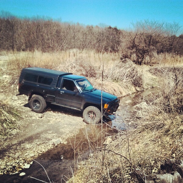

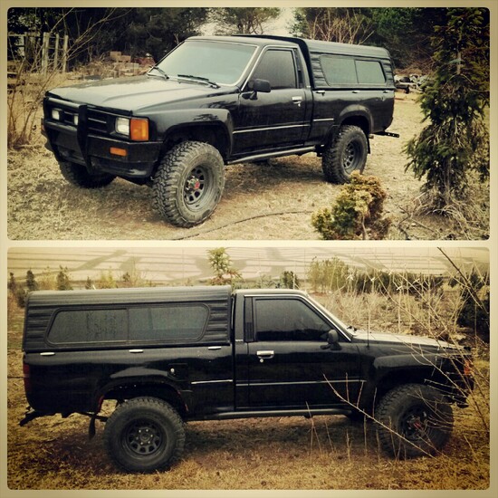

What's up guys!? The wife and I got back from our first trip to Tuttle Creek ORV in Kansas. Also the first time we've officially wheeled the truck. I didn't see any other Yotas out there. We had a great time! Although, I can see how wheeling with friends and their rigs would be even more fun we still enjoyed ourselves. Just couldn't attempt the more sketchy things in fear of breaking something or getting stuck with no help. Since I don't have a winch yet. YET. The Spartan locker did not disappoint. Here's some pics:
We drove into the creek and followed it up for a while. Stopped for a photo op.

I feel like the pics don't do it justice. Maybe everything looks bigger from the drivers seat!

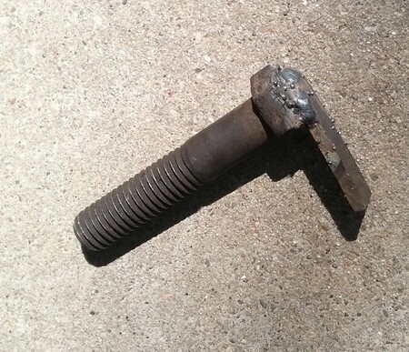

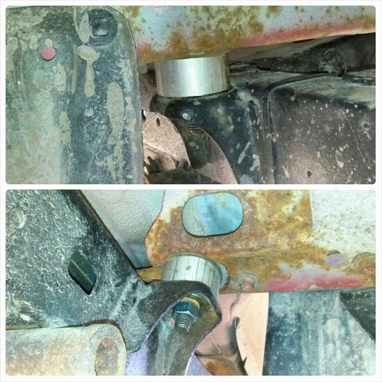

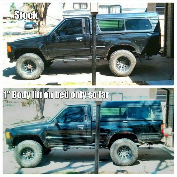

I got the bed 1" body lift on today. Didn't start on the front because I'd like to take the truck to work.
Had to weld tabs on the bolts because as most of you know you can't get a wrench up in there. Worked great.

And a picture of it all tightened down.
Looking forward to finishing it up tomorrow. Progress!!

Are those aluminum spacers?
Old Apr 8, 2014 | 01:46 PM
  #136
crashburnoveride's Avatar
Joined: Dec 2012
Posts: 613
Likes: 33
From: Lincoln, NE
Yah they are.
