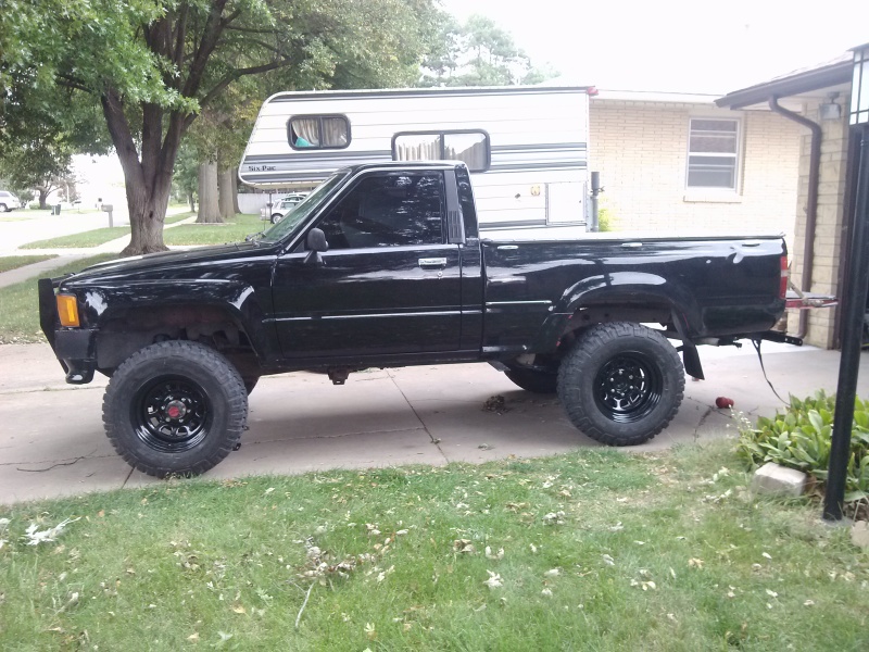

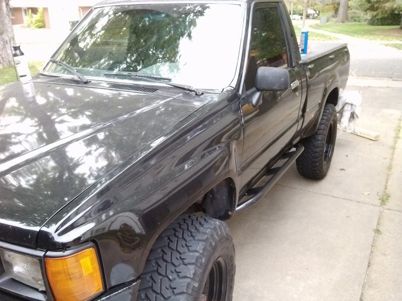

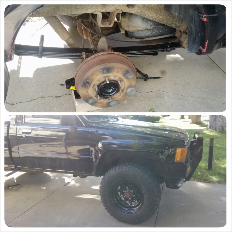

Putting on the new 16" rims and 245/75r16's. I sprayed so paint on the leafs and since I dont have center caps I covered that area too.
I think they look badass and Im one step closer to being tuttle creek ready. I think Im still leaning towards a rear detroit or grizzly locker. Despite it being my DD.

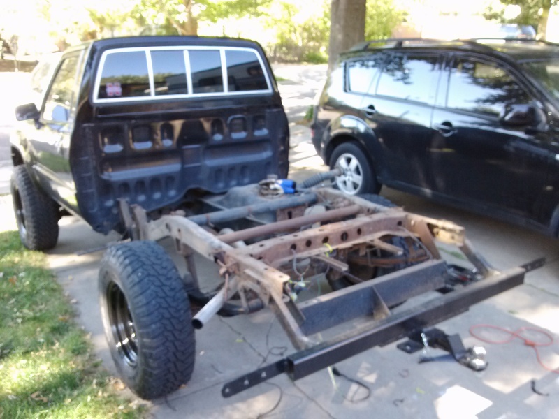

Doin work on the truck this weekend. Wire wheeling the frame and coating it in rust stopping stuff. Then painting it.

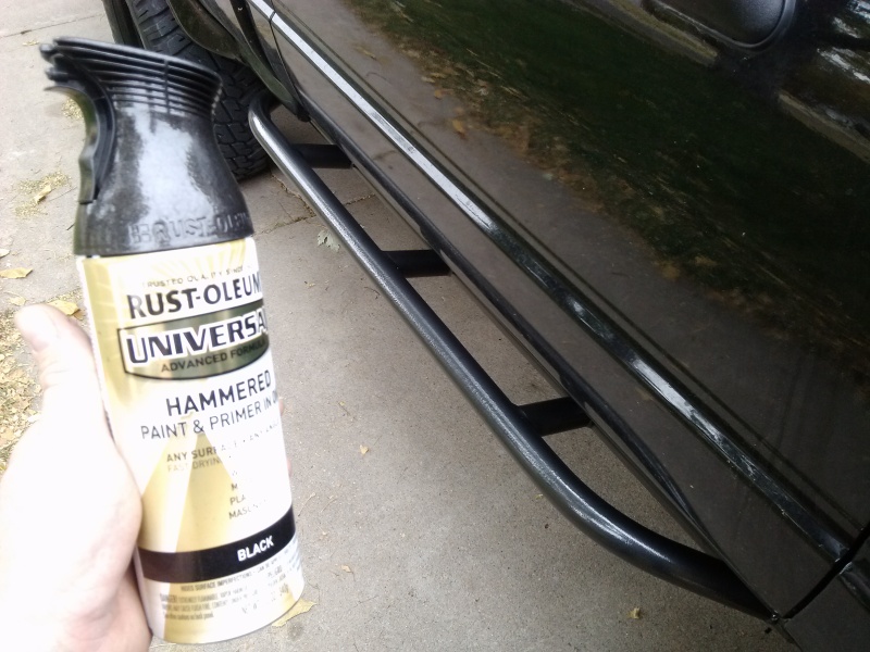

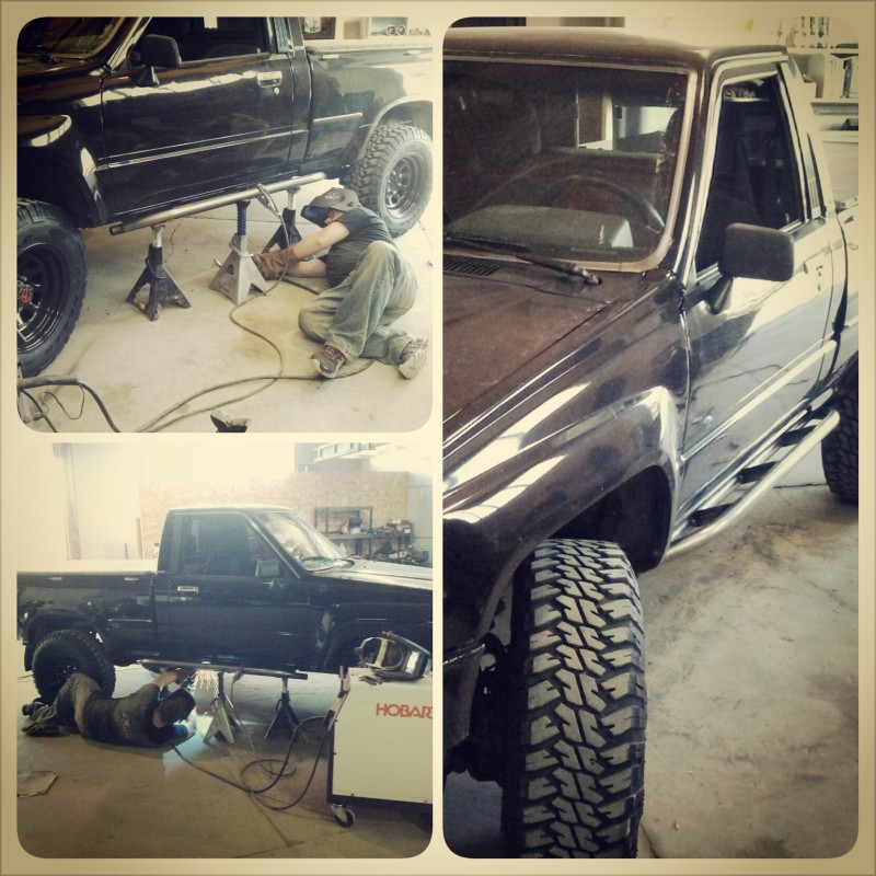

Update: Met a cool local dude who wheels a badass yota and has a shop. So we got the sliders on. He welded em up for me.
I painted them today with this rustoleum product. Its awesome because it sprays well upside down and in any other position. It said black but came out more gun metal gray if u ask me.

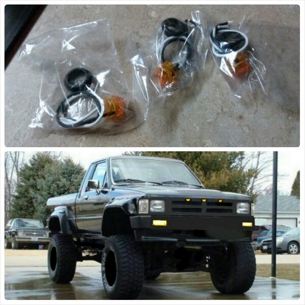

Been a while since I've posted. Winter sucks. But I got a package in the mail. Thought I'd share what Im doing. Im getting clear corner lights and moving the turn signal bulbs there with LED replacements. Then where the old turn signals were will be LED running lights. And finally I'm adding a look like the ford raptor with 3 mini LED's on the upper grill. Heres a concept design pic.

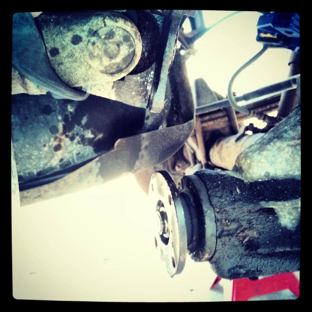

Havent made progress on the lights but I am in the middle of tackling the spartan locker install. So far its been a huge pain in the ass. Maybe 5 hours total and I still cant get the pins out to remove the parking brake or the bolts out of the rear driveshaft... I got pissed and cut the rest of the driveshaft bolts off. Still have to punch em out but thats tomorrow. Seriously tho I hate seized bolts so damn much!!!!!!!!

After cutting 2 driveline bolts and smackin it with a hammer it finally came off. Pita

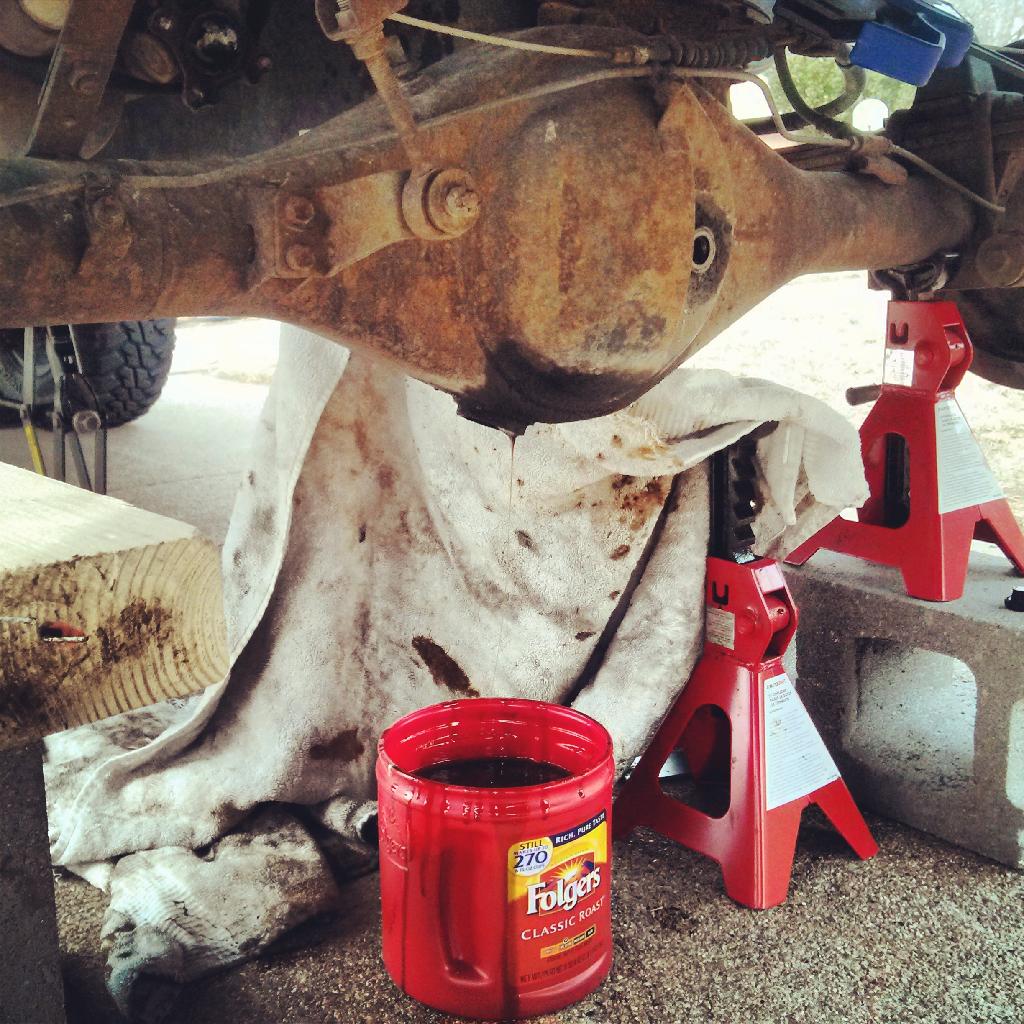

Drain fill bolts didn't give me much of a problem.

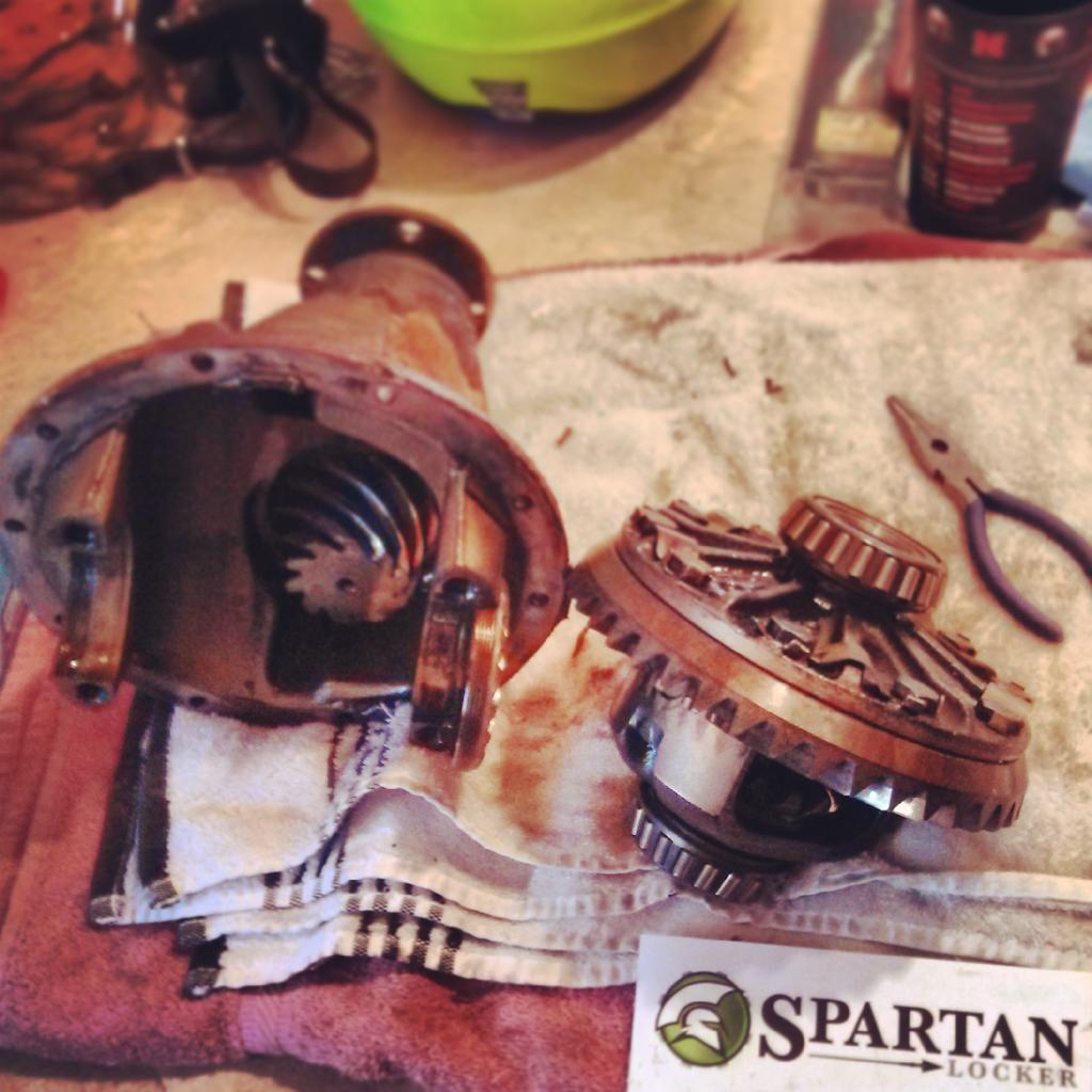

Third finally out!
Old Mar 24, 2014 | 02:59 PM
  #91
crashburnoveride's Avatar
Joined: Dec 2012
Posts: 613
Likes: 33
From: Lincoln, NE

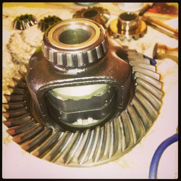

I saw a video of a spartan install where you didnt have to pull the carrier and was hoping it would be that easy. Wrong.
Old Mar 24, 2014 | 03:05 PM
  #92
Joined: Dec 2012
Posts: 613
Likes: 33
From: Lincoln, NE

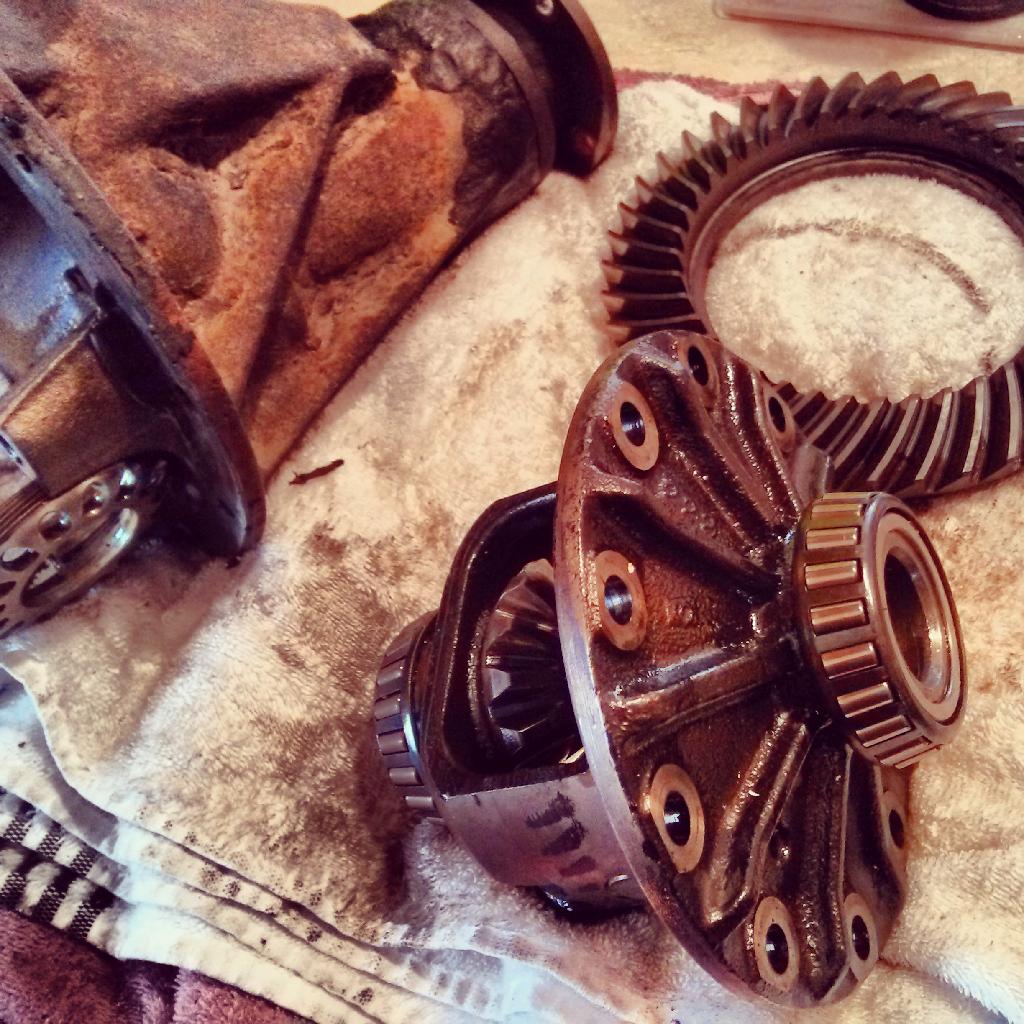

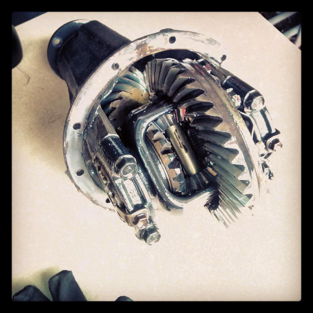

In fact you must pull off the ring gear as well. Right now I'm stuck here because the little pin won't come out allowing me to pull that rod to remove the spider gears. But I'm learning alot as I go and I'm super close to getting the locker in.
