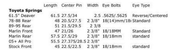

Another question. Found a guy selling 2 spring packs from a 93 for a good price. I guess theyre a bit longer than my 88's but the same width. You think they'll bolt on no mods? Or possibly use a leaf from them and add to my existing pack? Im probably gonna buy em and figure out how to make it work... $50 for two full packs. So do u guys know anything about 3rd gen springs on 2nd gen trucks?

That's great he got back to you on the cam. I really think it made a noticeable difference the more miles I out on this engine.
I would imagine that they would fit if they are slightly longer. Might just give a steeper hackle angle. I could be wrong. But for that price, I would buy them.
I was thinkin to get the pin holes to line up just cut the leafs down at the ends as needed. Since they're longer it should be no problem!
Old Apr 17, 2014 | 09:27 AM
  #164
Gizler00's Avatar
Joined: Aug 2007
Posts: 3,276
From: Pennsylvania
Sounds like it should work.

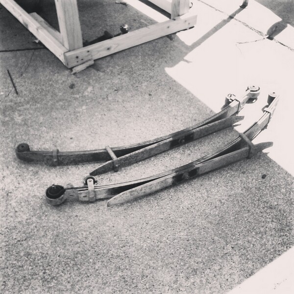

Ok, well I drove 30 minutes to buy those leaf springs off a 93 pickup. $50 bux. 2 full packs.

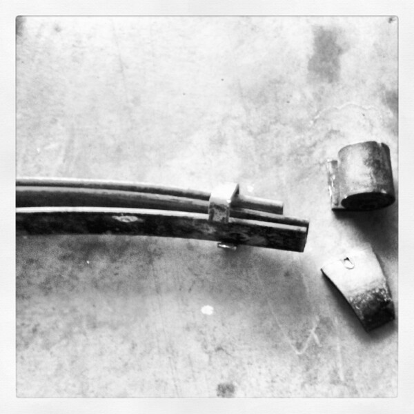

I cut off the ends so I can use all of the leaves (leafs?) someday if needed in my current packs. I plan on replacing the broken leaf plus adding one to each pack. See how that lifts it and make hauling the camper easier.

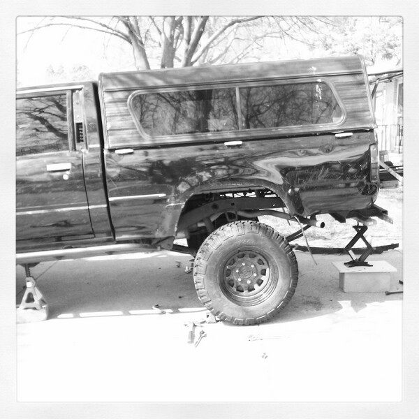

Trucks up and passenger side pack out. Driver's is being stubborn! I got tired, gave up for the day and cracked open a beer. Haha. Thankfully I got the motorcycle to fall back on.
Probably work on it again tomorrow.

Good deal. Pretty shirt drive to get them also. That's always nice. I sometimes have a hard time factoring in drive time and fuel to go get something that's a good deal. But typically if I can get there in 2hrs or less it's a go for me.
So did you put a few of those leaf's in your existing packs then?

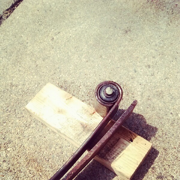

Ok. Wtf! This bolt is so stuck in here I don't know what else to do. I had to cut it to get it off the truck. I can't hammer it out of there!! Aaarrrgh.
Old Apr 20, 2014 | 10:16 AM
  #170
twistedyota's Avatar
Joined: Nov 2008
Posts: 1,212
From: Napa, CA
Looks and sounds like the bolt it rushed to the metal sleeve inside of the bushing, you might have to remove the bushing and get a new one and def a new bolt

Bushing is stuck too. I might just set it on fire and burn the bushing out. The only thing I can think of...
Old Apr 20, 2014 | 11:09 AM
  #172
Gizler00's Avatar
Joined: Aug 2007
Posts: 3,276
From: Pennsylvania
That's what I would do. I just had to do that on the frame swap/SAS build we are doing at the shop. Heated them up and hit them out. You ruin the bushings but the bolt will come out

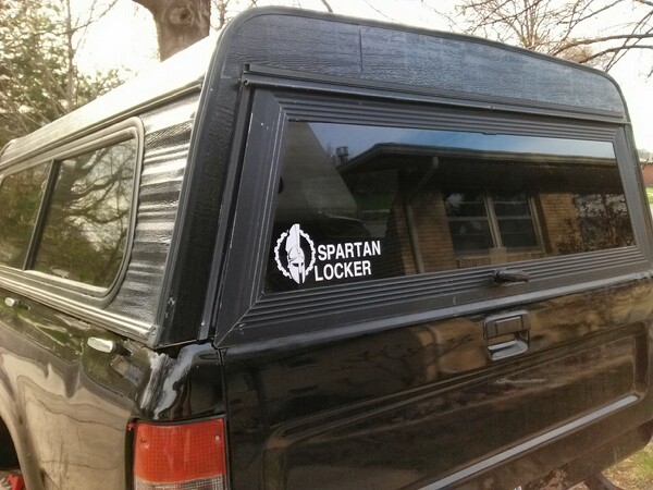

Worked on the leafs a lil bit. Also put on my new custom Spartan Locker decal. The sticker I had blew off in the power wash. Still gotta rep my locker.
Old Apr 25, 2014 | 06:55 PM
  #174
Gizler00's Avatar
Joined: Aug 2007
Posts: 3,276
From: Pennsylvania
Heck yeah man!!

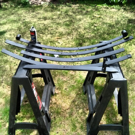

One pack is flap wheeled, painted and ready for assembly. Haven't tried again to free that bolt, but I guess thats next.
