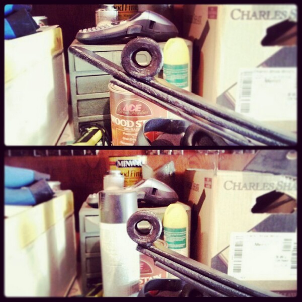

The springs that were on the truck were not stock. They stuck out some. So I trimmed em up and now it looks normal. I'm sanding down the next pack today. Well, starting on it.
Before, after:
Damn rust.

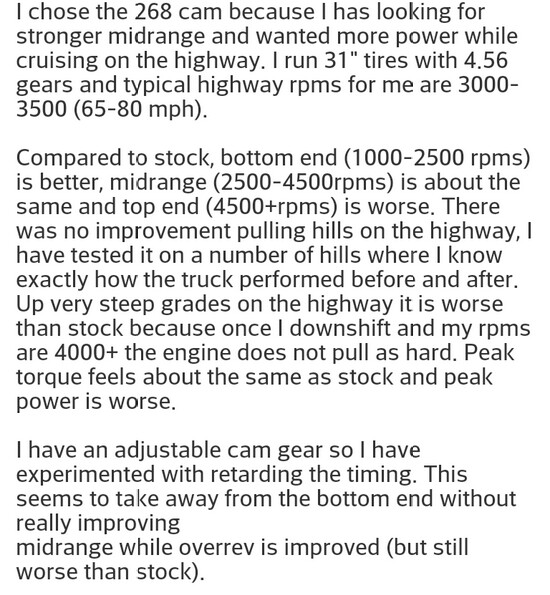

So I sold my old rims for $200 and now have the money for my camshaft. I thought I had decided on the engnbldr 268. Then I read crap like this:
I could order it this second, but now I dont know if I should get 261 or 268. Yes i wanted to pull up hills better on the hwy. But I dont wanna burn out my clutch wheeling either! I also feel like I'm annoying Ted from engnbldr with my stupid questions. Arrrgh. What to do?

So I sold my old rims for $200 and now have the money for my camshaft. I thought I had decided on the engnbldr 268. Then I read crap like this: I could order it this second, but now I dont know if I should get 261 or 268. Yes i wanted to pull up hills better on the hwy. But I dont wanna burn out my clutch wheeling either! I also feel like I'm annoying Ted from engnbldr with my stupid questions. Arrrgh. What to do?
He probably would have seen better results with the 261 cam. His experience with the 268 would have been different with 33's also.

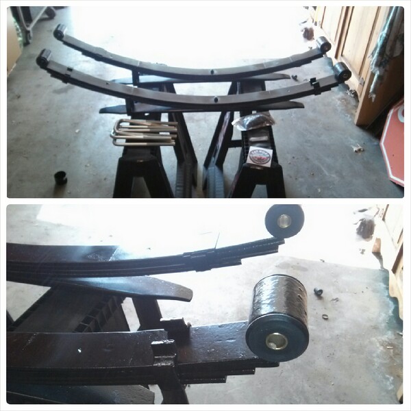

Painted, packed, and brand new bushings.
The U-bolts finally arrived. I've got them under the truck but still have to tighten everything down. Hopefully tomorrow after work I'll have a rolling truck again. Miss it so much!!!

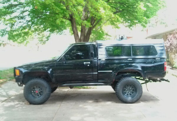

Sometimes you just have to skip work and work on your truck. Got it all put back together. A slight lift but I didn't measure before so idk how much now.

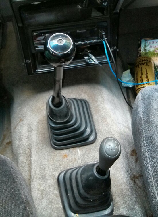

Got a new transfer case shift nob too, my old one didnt have the pattern on it. Enough of these little changes and the interior will be nice.

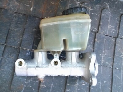

So does anyone have any good methods for cleaning out that master cylinder? I flushed warm water through it, sprayed brake cleaner in it... still dark and cloudy. Can I submerge it in some magic chemical for a while??
Old May 19, 2014 | 06:00 PM
  #196
94mackyota's Avatar
Joined: Aug 2013
Posts: 43
If you sprayed brake cleaner in it you may have ruined the seals on the piston. I learned that the hard way....had to get another one.

Oh. Well, I took the reservoir off before the cleaner was sprayed.

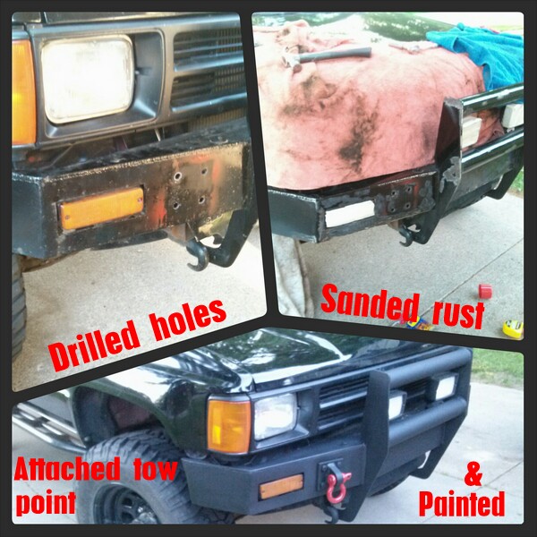

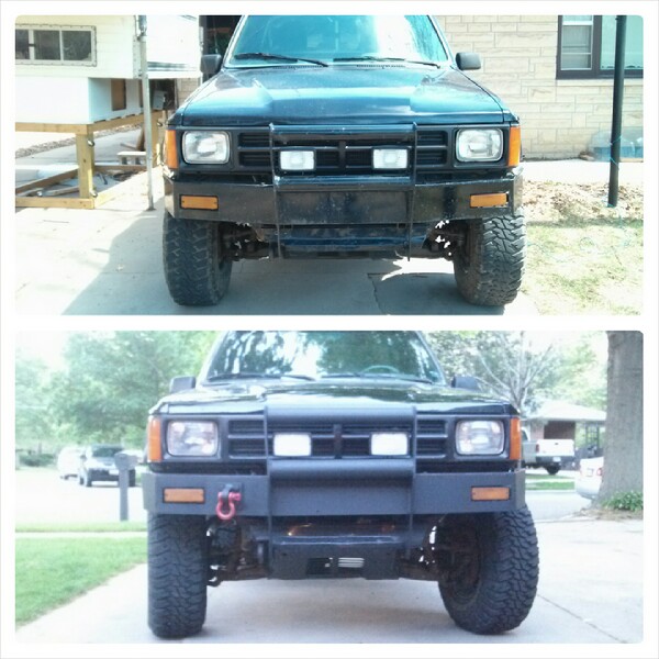

The work I did today.
Still have to add the other tow point, but the bumper looks much improved. Here's a before and after...

I have used Brake cleaner spray in the past to clean a master out as well as other brake components. It evaporates fast and usually does not harm the rubber. However, I have experienced some swelling in certain applications.

Looks great man. I like the red color contrast against the flat black. Plus I love an upgrade that is totally useable. Can always use more tow hook/lashing/recovery points.

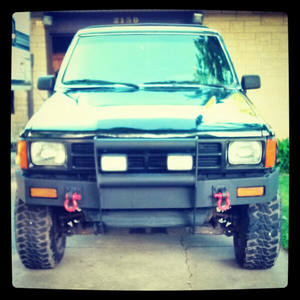

Lookin gooooOOOoood now...
Everyone enjoi their holiday weekend.
