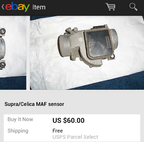

Well, I did some research and everyone says a supra MAF is a good mod.
So I just bought one. It's from a 1985 and I have a spare AFM to swap the guts out into the supra's. I'll show the process of course. :-)

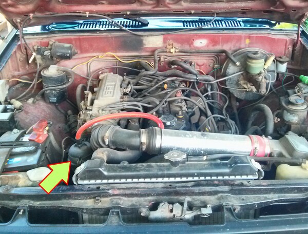

So, who knows what this is called/does and what happens if removed?

I beleive thats emissions crap that can be removed. I did an egr delete on my runner, it really cleans upp the engine bay.

That canister is the resonator that hooks up to the stock intake tube. The smaller one that clips to the larger intake tube.
The older 22re's don't have that.
I would imagine you could remove it without any issues

Its a pain to work around, alot more room if removed.
Sweet. That suckers gone!

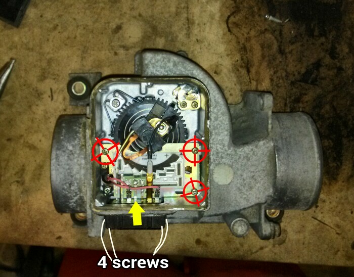

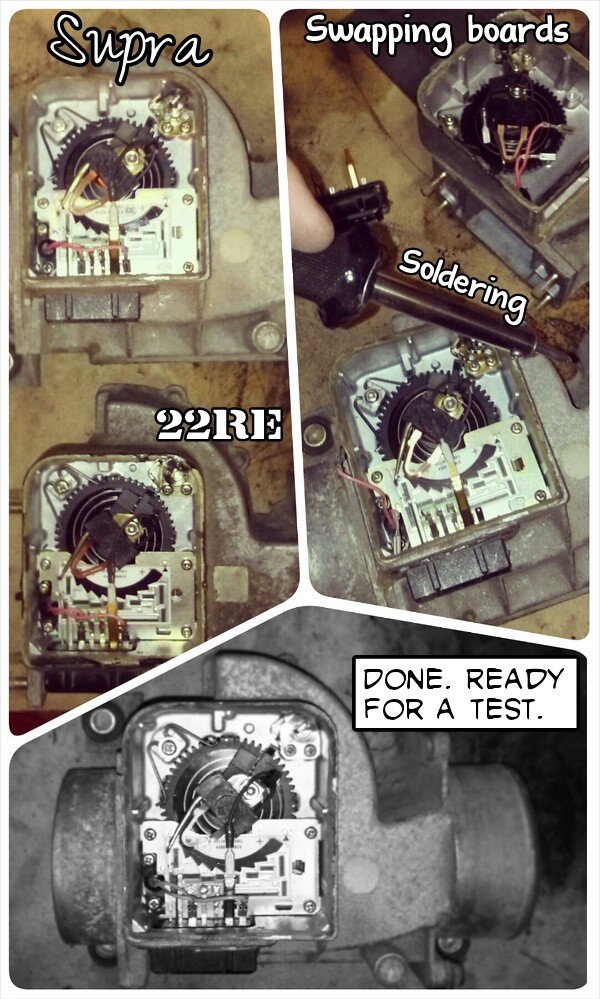

Well, heres what I did last night.
In case anyone wants to do the mod I'll save you some headache. You only need to unscrew the 3 screws in red. Pull the 1 black and 2 red wires off their leads. Carefully break the solder on 3 leads (yellow arrow) then remove 4 screws on the front plastic plugin port. Pull the port out. Now you can carefully pull out the circuit board. Then just swap the other board in. Tighten screws. Solder those 3 connections back on. Connect wires. Presto. I unscrewed a bunch of unnecessary crap so hope that helps someone.
Can't wait to install it.

Originally Posted by julsruls
Why not just swap afm??
Only 1982 Supra MAF's are plug and play. Instead of scouring the earth for an expensive 82 I bought a cheap 85 and swapped the circuit board. I know it looks identical but the part numbers on the boards r different. Thats why. :-)
