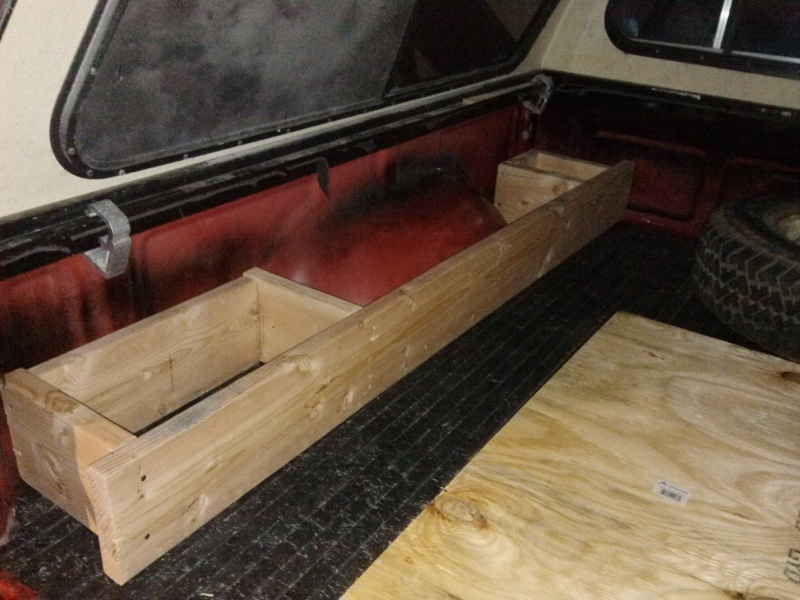

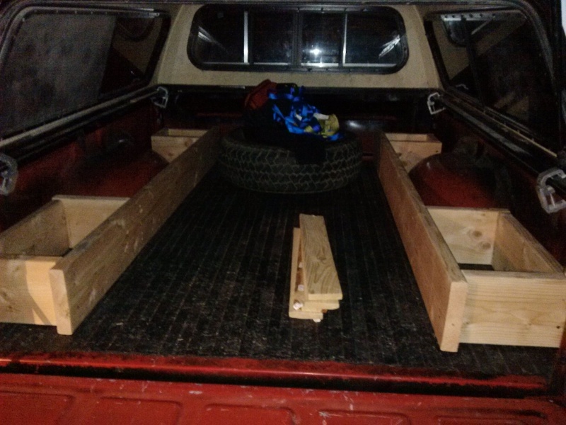

Today I started the build for my camping platform.
I'll finish it by this weekend. I can't wait to go out and use it. I'm going to rig up some kind of window air conditioner somehow. Still working on that part....

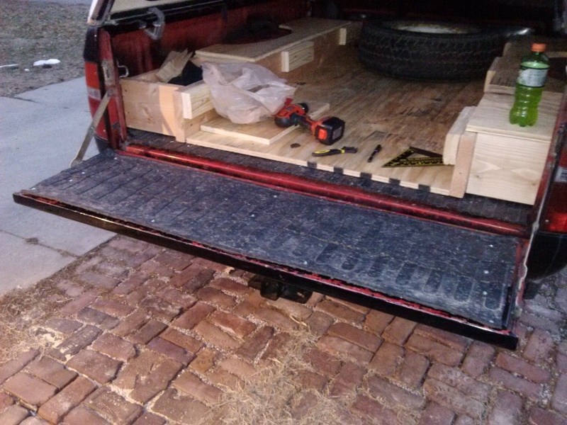

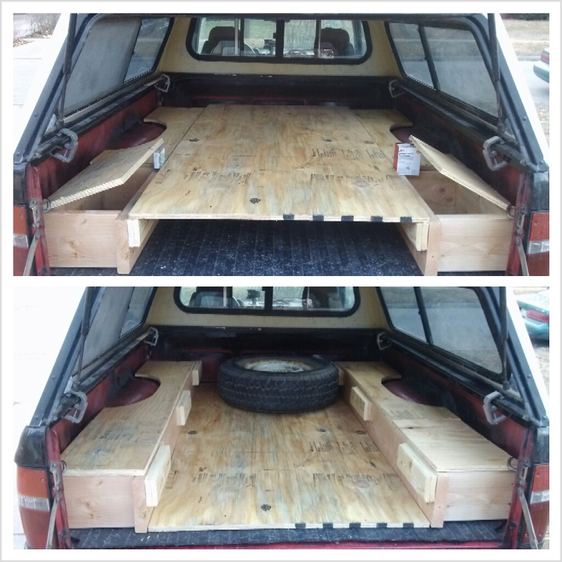

Worked on the truck for 5 hours today. It got up to 51 degrees thankfully! Nice day. So I finished the camping platform. I wanted to save as much head room as possible so I cut out the wheel well and it's flush so it saved a few inches.
I may still carpet it or paint it or something, and the compartment doors still need hinges.
Then I used the leftover rubber mat scraps to screw onto the tailgate. Turned out well I think.

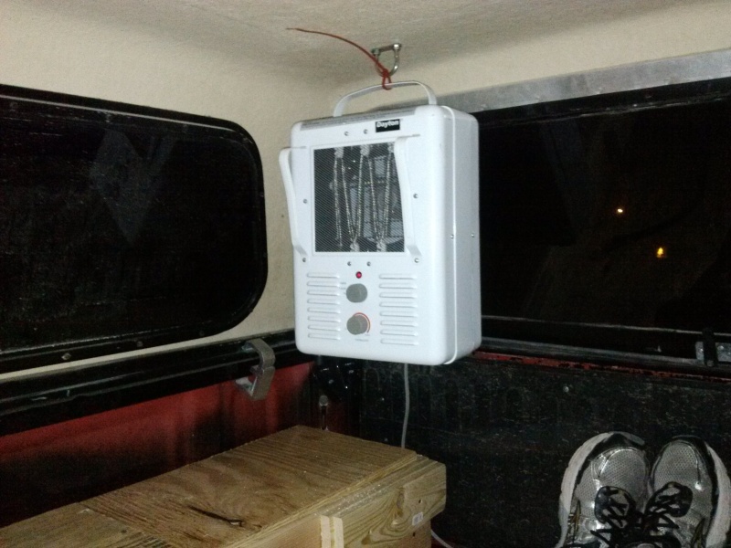

And also put in a little hook to hang my heater from so it won't tip over and kill me in a fiery death. It's stainless steel and I used rubber washers to keep a water tight seal.

Nice bed build! I'd like to build a removable one for my 4runner however I see stability going out the door that way. .
Old Feb 9, 2013 | 04:16 PM
  #28
crashburnoveride's Avatar
Joined: Dec 2012
Posts: 613
Likes: 33
From: Lincoln, NE
Thanks! Mine is in 3 pieces so it can be loaded and unloaded by one person. It's solid as heck too. Doesn't move around while driving because it fits so snug in there. You can do it!

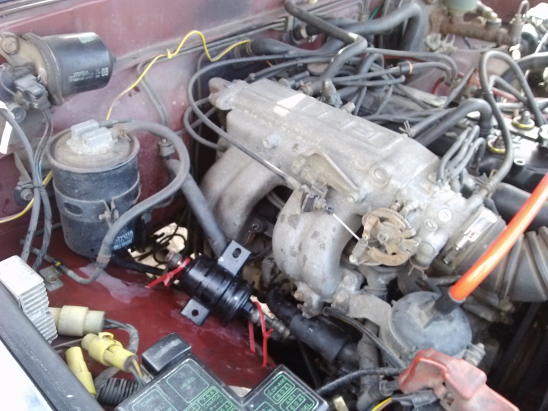

Im currently in the process of replacing the fuel filter and HOLY BAWLS!!! This sux! So all I did was pull it up through and fastened it crudely with zip ties. That will hafta do for now. Im probably buying a new topper tonight and needed a running truck to get it.
So it turned out that I had a user error when I tested my MAF. I put the new one in anyways and just have a spare I guess. After the fuel filter replacement my truck still sputters/shakes under hard throttle. So on to the next part of the guessing game. Learning on the way tho!

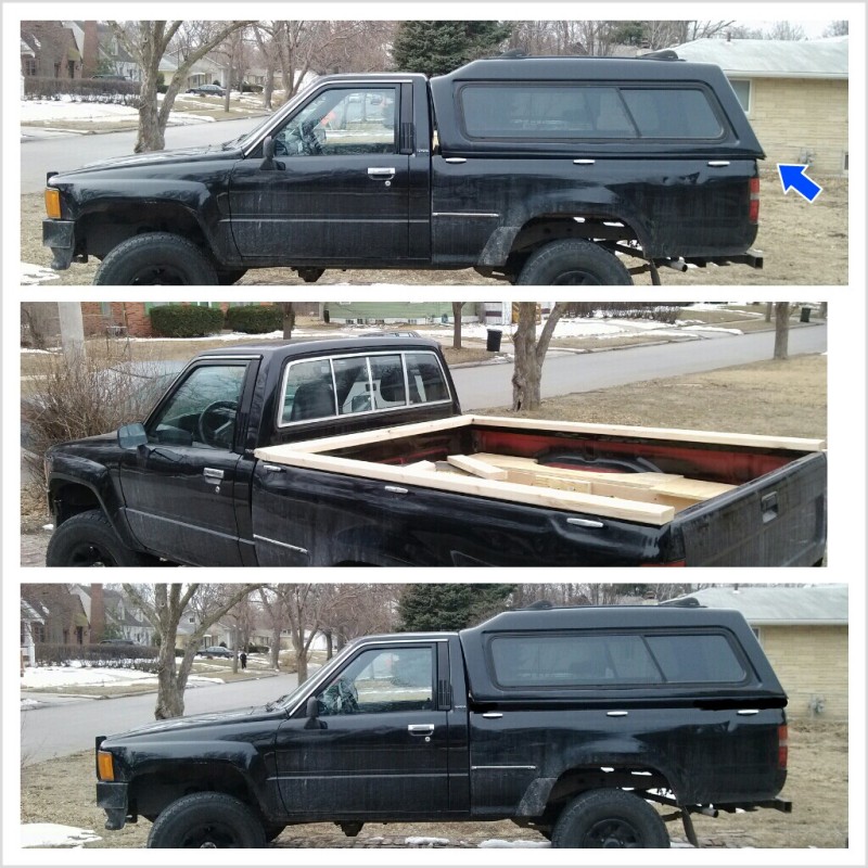

And the topper i bought didnt quite fit. Hung over the back too much. Some 2x4's to raise it enabling it to slide forward the bit it needed and its alot better. The wood will be painted black.
End update.
