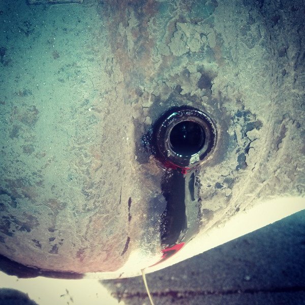

So otw to work this morning when coming to a stop, out of gear, I heard a loud *clank clank clank* from around 10mph to 3ish mph. "Oh hellll nahhh" Its hard to hear where its coming from with my loud ass tires (lets be honest the entire truck is loud) so I was hoping it was just my locker being extra loud because water/mud got into the axle last weekend. So I drained it.
Oil was already dark dark green, and I just installed this diff idk 6 months ago? I can't remember. Anyways, replaced oil. Test drove. Same sound. Dang. I always try and listen to my truck and I think I'm used to what sounds it normally makes. Well, on the tuttle drive I started to notice that when I'd take it out of gear at speed a loud drone or rumble sound would occur, and that seemed new to me. But I could be paranoid too... I just hope changing my trans oil didnt screw something up. I read some people think that stirs up shavings/debri and can damage it more. I dont know anything about the truth of that. But it's dark and I'll investigate more tomorrow. On a positive note a buddy helped me move the project motor downstairs.

Sometimes my rear locker makes a racket.
My trans input shaft bearing makes noise like you described.
I also had to tighten the stake nut on my transfer case. The nut that holds the flange on where the driveshaft bolts to. Maybe check everything out.

Thanks for the input Mark. Drove it around a little more yesterday. It only clanks on deceleration in neutral. If I downshift into 1st and let it slow through where it normally clicks, it is quiet. Pointing me back to the locker. I'm thinking (hoping) it's my rear tires being too uneven in wear. And the Tuttle drive wore on em different making the locker disengage while moving straight in neutral. So hopefully today I can test each tire and put the closest pair in the back. Gotta price those battery powered impacts though. Swapping 4 tires with a regular jack and hand tools sucks!!!

Oh man, LOVE my new tools!!! Pulled each tire. Checked each one's diameter. Put 2 closest in the back. Buuuut, still clicking extra loud. I'll have someone coast it slowly so I can make sure the noise comes from the diff.

Could it be u-joints? Mine only made noise when letting off the throttle

Grease the u joints

Good call on the u-joints guys.
If you need to replace them, we can press them out at the shop. Take no time at all.
