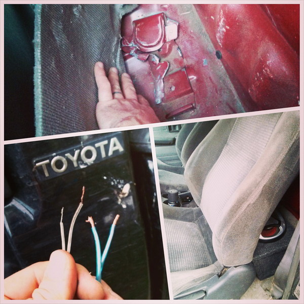

So the previous owner wired up the rear speakers with this super small wire. The speakers would crackle loud when I tried to turn up the volume. I was hoping replacing the wire with 16 gauge would solve it and I could blast tunes down to tuttle next weekend. Also I got out the sledge hammer on that random bracket behind the driver seat so I could stuff the speaker box back there.
Speakers work great now!
I hate fixing stuff from the previous owners.
Looks like that Sledge did a good job of gently manipulating that bracket to move out of the way.

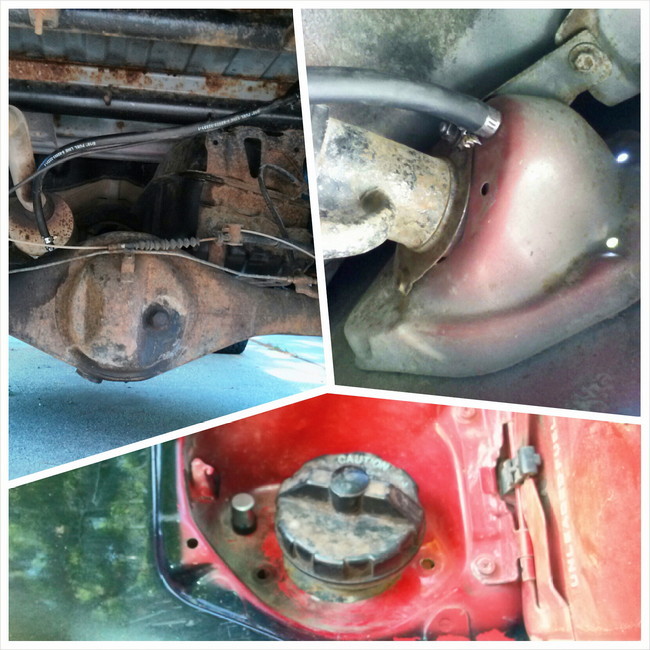

My diff breather extension fittings showed up.
Still waiting on the pinion seal. Should come tomorrow I hope.

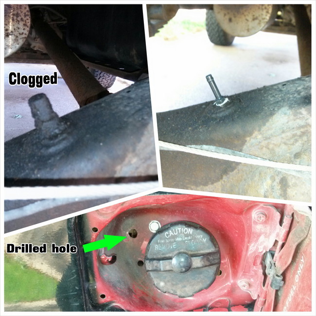

I would have thought 4wheelparts would be faster. I thought I needed to replace my pinion seal but my rear diff did not have a breather on it, therefore it was clogged. Stuck a tiny screw driver in it to clear it and ran a tube from that opening to the top of my frame and it never leaked again. Although, I do like how yours goes to the gas cap.
