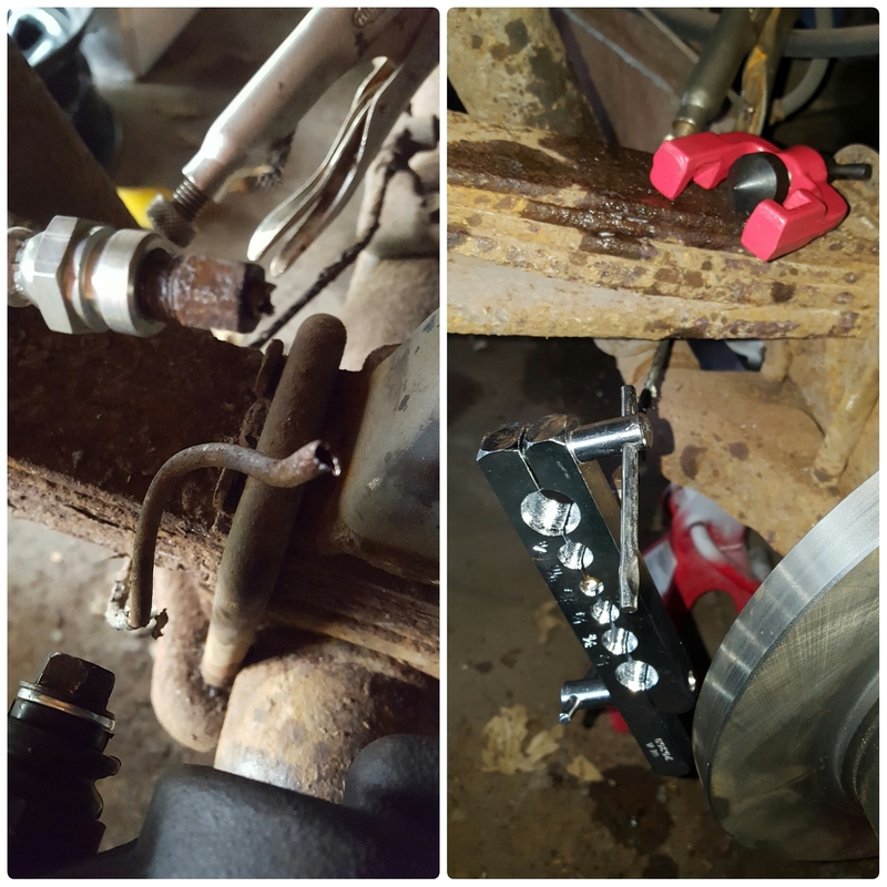

So I was moving the brake hard line about to button up the passenger side disc swap and the line broke in half. I thought I was doomed. That putting a new fitting on it would be hard. But apparently a $10 flare tool and a few minutes is all you need.

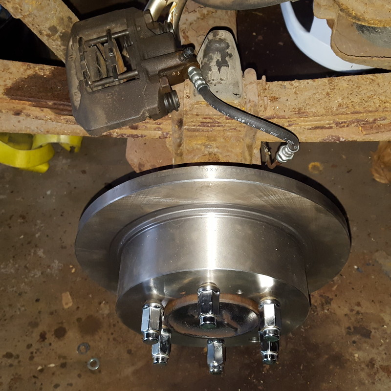

So that was awesome. And I got the soft line on and rerouted the hardline to the front of the axle under the spring.

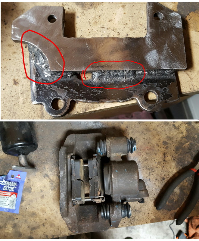

I put some more weld on the bracket in a few spots. Looks better I think. Before I was just moving the weld straight. This time I did circles. I still need more practice. The other caliper got rebuilt with new sleeves and bushings.

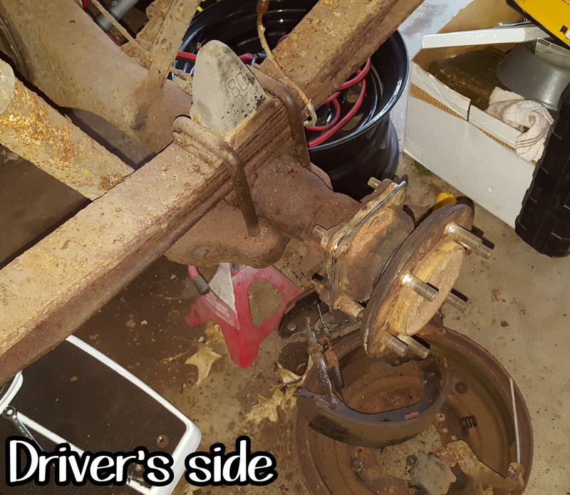

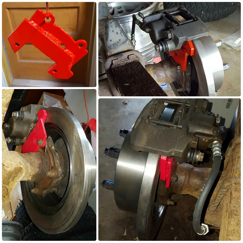

Brackets getting some paint and I tore apart the drivers drum brake so I can knock out that side next!

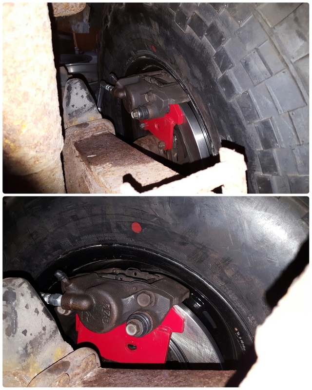

Yeeeaaaah booyyyyy...
One side is done. Clears the 15" steel wheel no problem.

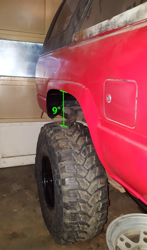

When I do the chevy 63 spring swap I think I'm going to have to go spring under axle (sua) because I don't want or need any more lift.
I think 9 inches is already too much gap. I don't see any other options than sua. I already have the springs. Obviously I'm aware it effects ground clearance. I guess my rig will be more unique then!

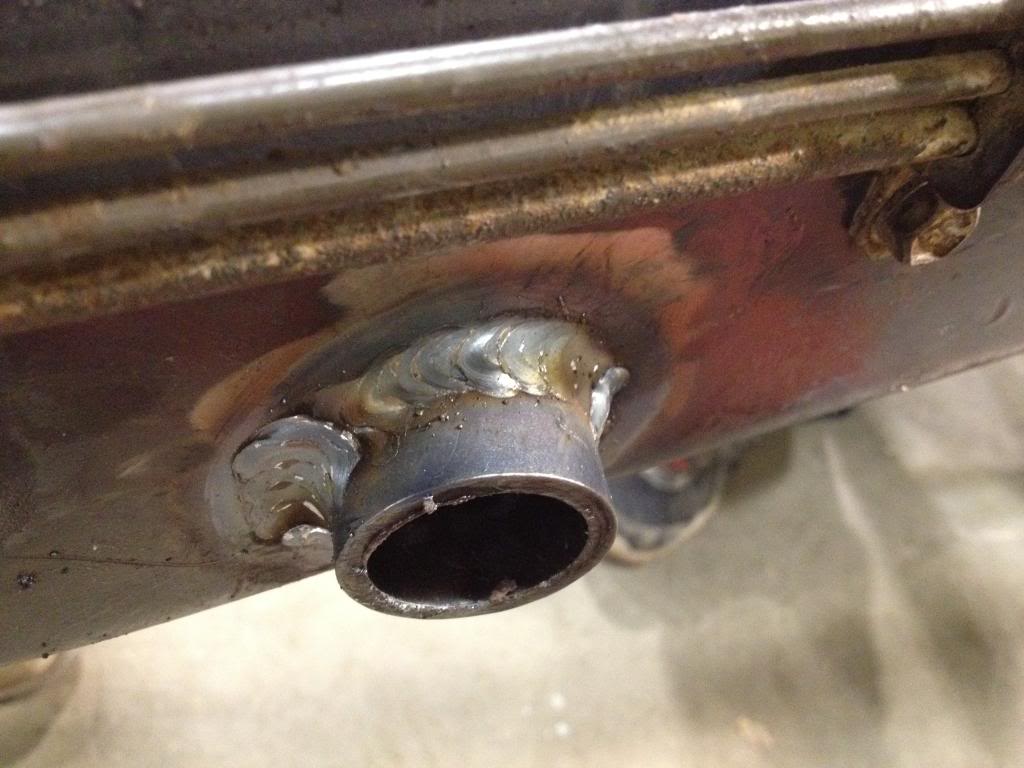

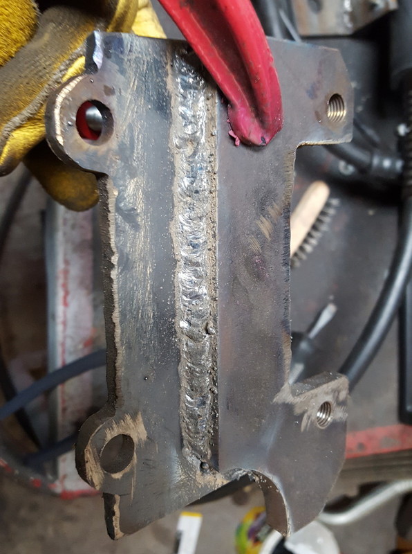

I think this weld on the drivers side bracket is much better.

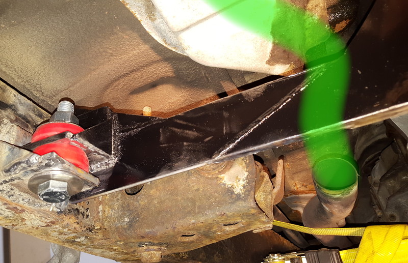

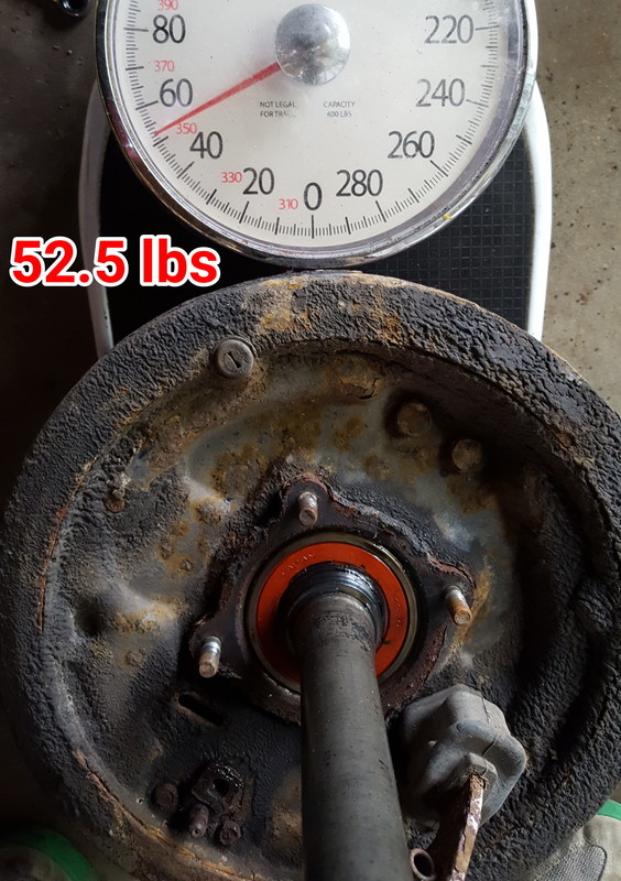

Did this just because I was curious...
So not only do you get brakes that are ten times easier to service but you shave a few pounds as well.

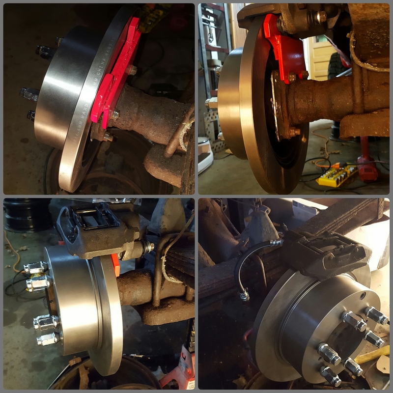

Rear disc brake conversion is complete. Driver's side is done.
On to the next item on the list...

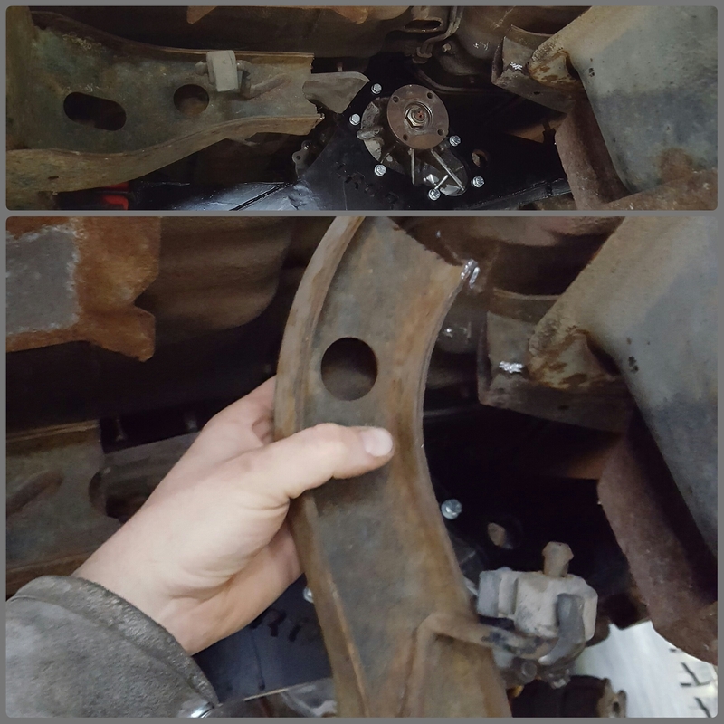

Got a little crazy today.

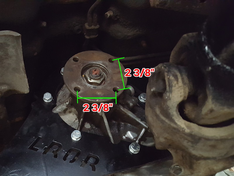

Woops cut something off there! Glad I didnt die from an exploding gas tank. I used a cutoff wheel and my sawzall too. So I was excited to bolt the driveshaft in and found this...

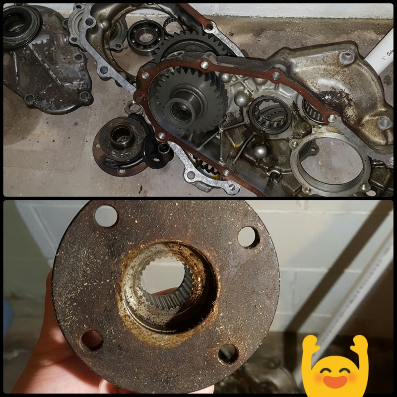

Bummer. I started looking at triple drilled flanges from trailgear and they run about $40-$50 shipped. And my budget is super tight until I sell some rims and tires I have laying around. Then I remembered I had a pile of transfer case parts from making the doubler in my basement.
The front output flange obviously goes to a cv and I measured it. It matches! So I'm going to try and swap them out. It should work. Fingers crossed.

when youre welding, go slower and make half moons, or C's. see if it makes a difference. did you take any measurements of the brackets?!
Old May 3, 2016 | 08:18 PM
  #159
Gizler00's Avatar
Joined: Aug 2007
Posts: 3,276
From: Pennsylvania
^^^^^Exactly!
Like This.
