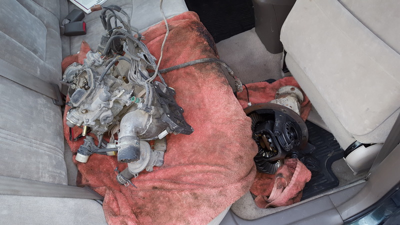

I bought an open 4.10 diff from a guy today and got a carb'd intake manifold too. So I could DIY a propane setup. Hmmm...

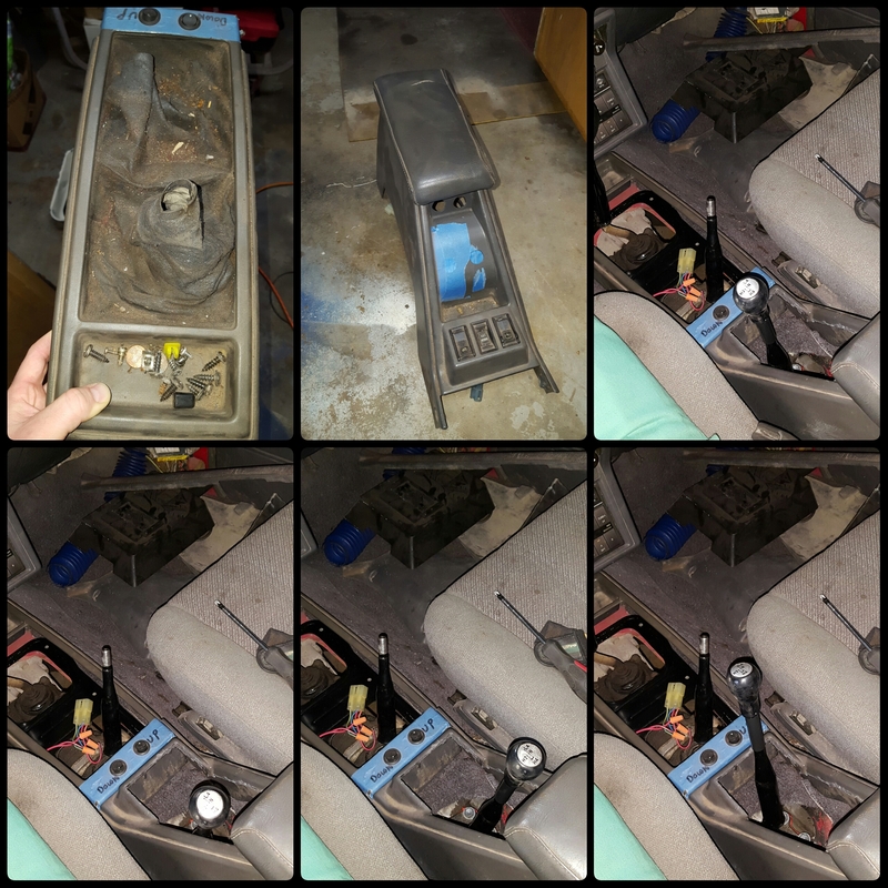

Playing around with the interior the other day. Trying to see how I can still use it with the extra shifter.
The old leather boot is trashed. I threw a shifter extension on the rear stick. I'm not sure if I like it or not. Would definitely be a clean look with new leather and I'd hafta do a custom boot for the back one, but the knob gets real close to the console in 4hi. Maybe just use the front piece, adapt a cupholder tray to it somehow and ditch the arm rest console.

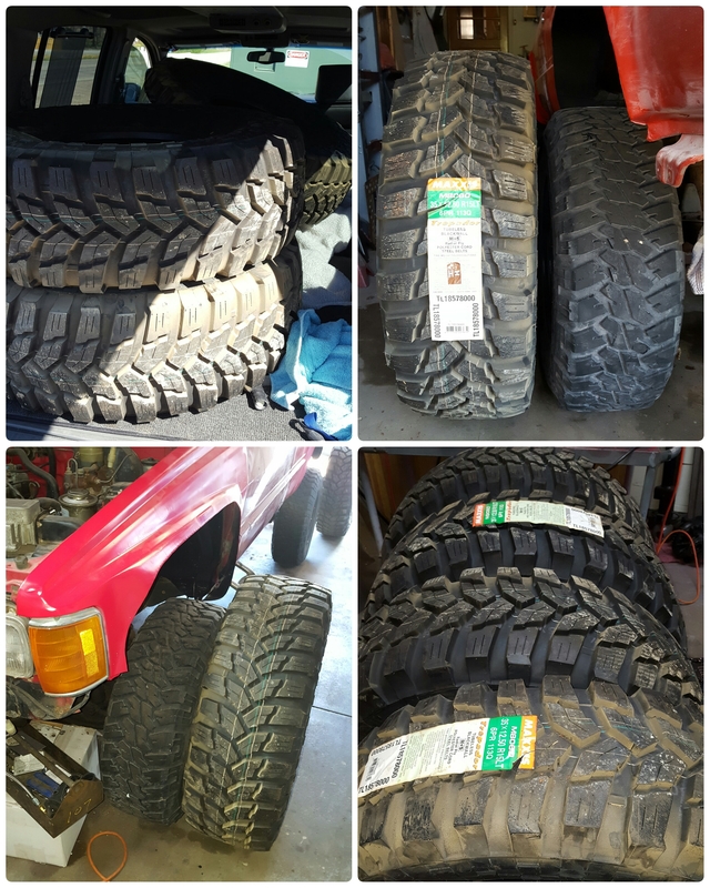

Bought some new tires today. Maxxis Trepadors. Excited to mount them up!
35/12.5r15 so I'll be putting them on my alloy rims. Might polish them up first.

Old Apr 4, 2016 | 11:51 AM
  #106
rustED's Avatar
Joined: Sep 2010
Posts: 2,716
From: Tri-Cities, Wa
Nice looking tires, did you and Mark get them from the same supplier?
Oh Yes!!! Glad you made it there!!
Yes ED. We got them from a tire distributor in Firth, NE.
http://www.yournexttire.com/
Even with an online purchase that is shipped, they are very very inexpensive.

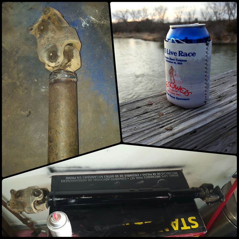

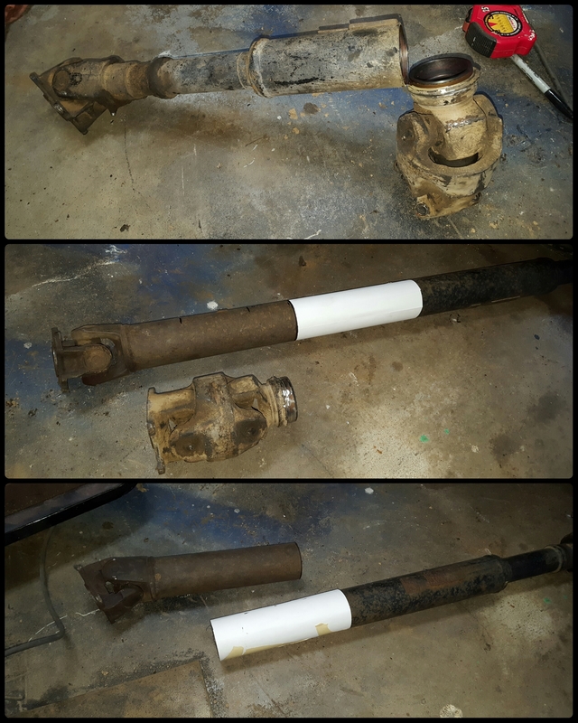

While I'm shortening the rear driveshaft to work with the dual cases I'm upgrading as well. I bought a front driveshaft off Craigslist a while ago to steal the CV from.
Used the ol' paper taped on the pipe trick for a straight cut. Burned the CV onto the shortened pipe and sprayed some paint. Oh and a picture of a beer. Because beer.
Might work more on the runner tomorrow.

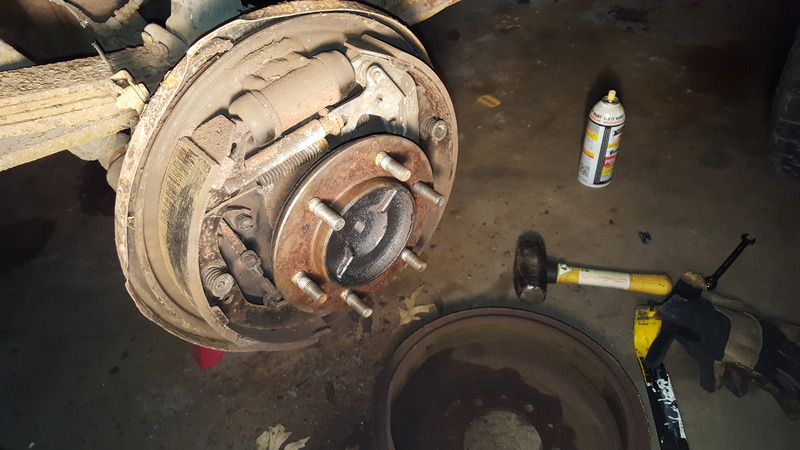

My passenger drum brake was seized up bad. I've never worked on drum brakes before. It was real difficult to get the cover off. Sprayed PB in the stud holes. Wacked and pried it off. Hurt my back somehow.
But its off. Im seriously considering a disc conversion. Found a thread using 2001 montero sport rotors and calipers. Seems easy enough. Eff drum brakes. I'm going to the junkyard this week on a Montero hunt. My new 15x10 wheels come in Tuesday. Mounting my tires Wednesday.

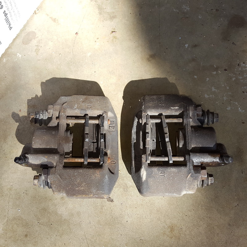

Got em.
$45. Rotors are $75 from parts geek. That should be about it as far as cost goes. Here we go...

Your new tires and wheels are going to look sweet when you get them mounted up!
Nice score on the calipers. Will the emergency brake still be functional with this swap?
