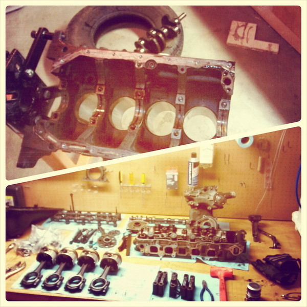

Definitely not in any kind of hurry, but I finally got my spare motor completely torn down.
Can't wait to build it back up!

Looks great and you made some good progress on the engine teardown. Its always a good idea to keep stuff organized like you have it there on the bench. Makes reassembly very easy.

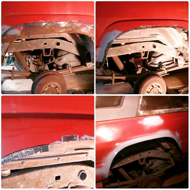

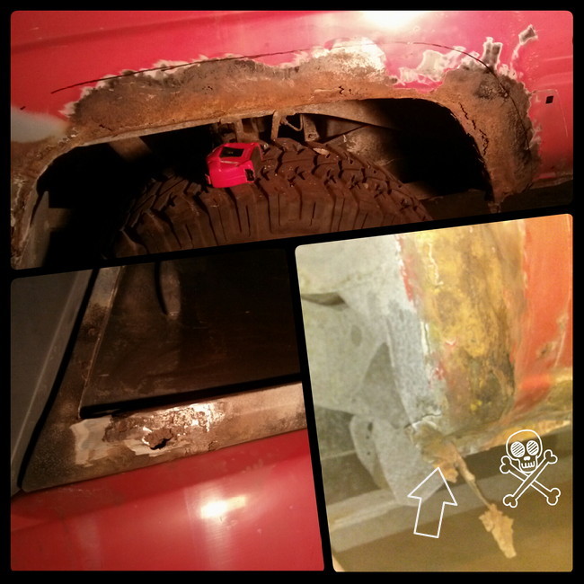

Decided to work on the rust a bit today. I don't know what to do about the "L" trim on the top. It is rusted clean through in spots, and already has bondo all up in it. On the passenger side rear wheelwell, behind the plastic piece, was a good hole with a bunch of fur and other crap in it that was most likely a dead mouse. So thats neat. I measured out a 3.5" cut line which clears most of the rust. That'll make room for the 35's.

Go back and look at my thread. I would tub it like I did. I can help you with the process. Not very difficult. Took some time and a lot of messing around on my part to figure out the best way to do it. But now that I have I would do it in half the time.

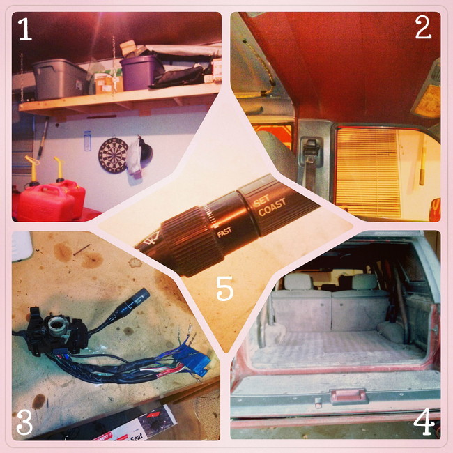

1) Built a new shelf to get more crap out of the way in my small garage. Everything except the grey tote up there is spare yota parts I got with the 4runner. Also have 4 steel rims, found a cruise control cpu box, and other crap. Some I dont even know what it is.
2) Interior was swapped from fugly red to grey. Minus the roof liner. How hard is it to uninstall the liner without ruining it? Because I'd like to swap my grey one from the pickup in. Didnt see anything in fsm about it. Any help?
3) I threw this away days ago cuz at first glance I thought it was just a regular spare set, and I try to not be a hoarder because I lack the space.
5) Browsing the interwebs today I discovered the cruise control "buttons" were on the wiper controls. Today was also trash day. Uh oh. Luckily I didn't get around to putting out that specific can and dug it out. Like I suspected it actually was an sr5 control. Phew!
4) Vacuumed the cargo bay. Actually looks ok!
In other news I heard friday or Saturday may reach the 50's!? Haven't verified this claim, but if true... runner work shall be done!!

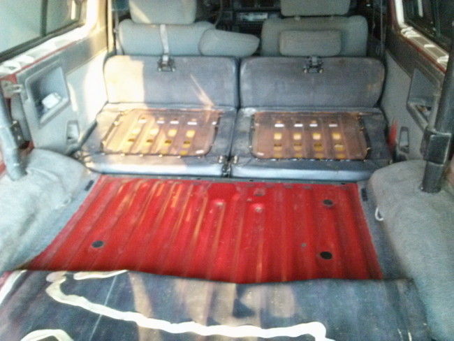

Pulled up the carpet. Thought it'd be rusty like under the rear seats, but thankfully I saw shiny red paint.

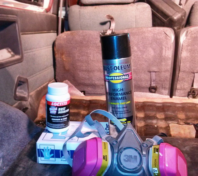

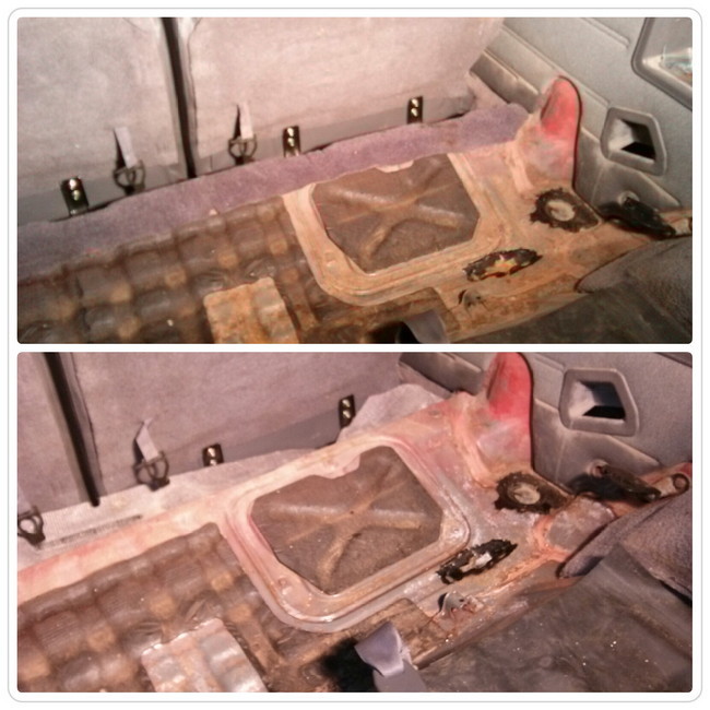

I picked up this stuff called naval jelly today. Supposed to kill rust. Had to give it a try. I wire wheeled what I could and slapped on the jelly.
Here's a b4 and after. It actually did clean it up more than I expected. It's drying now.

I cut just under the 3.5" line and then cut notches, bent the notches inward, and will weld the patch in from the inside. From what I've read thats easiest. Feelin pumped about how its turning out so far!!

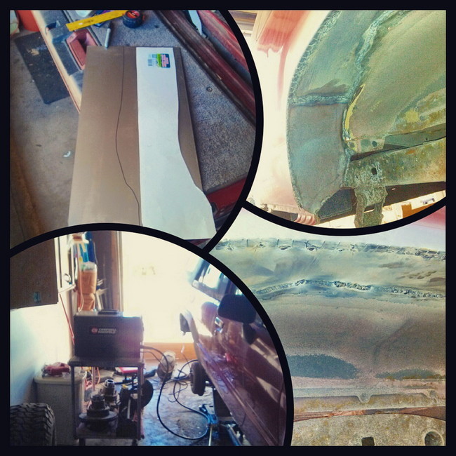

Did more work today.
It's actually a ton of work. I think I put in 10 hours today. However, I do tend to work slowly. Gotta figure out what to do in the bottom rusted out corners still, but then this sides done! Soon to be rust free!!
